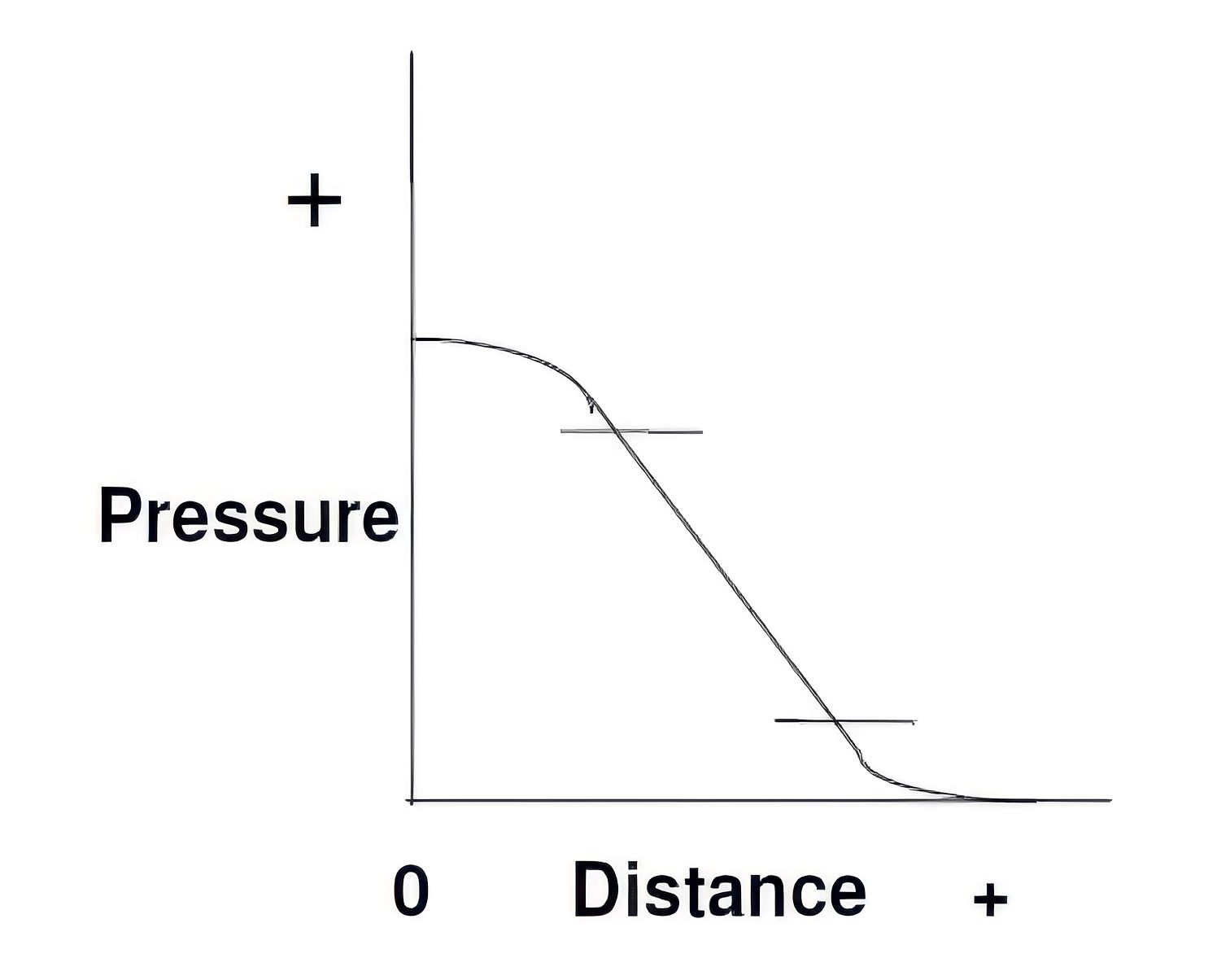

A simple visual of this is based on the Pressure-Distance curve (right). The very center of the curve is “true pneumatic zero.” This is where nominal mastering systems live. By setting the air tooling and master reference combination to the central position on the curve, it is officially in the most linear part of the curve, where the error is well known. Single master systems are calibrated around the true zero position, thus ensuring both precise and accurate readings.
The Pressure – Distance Curve
ID Polarity = D - to +,
hole size increases as pressure decreases
(90% of air gage applications)
OD Polarity = D + to -,
cylinder size decreases as pressure decreases
(10% of air gage applications)

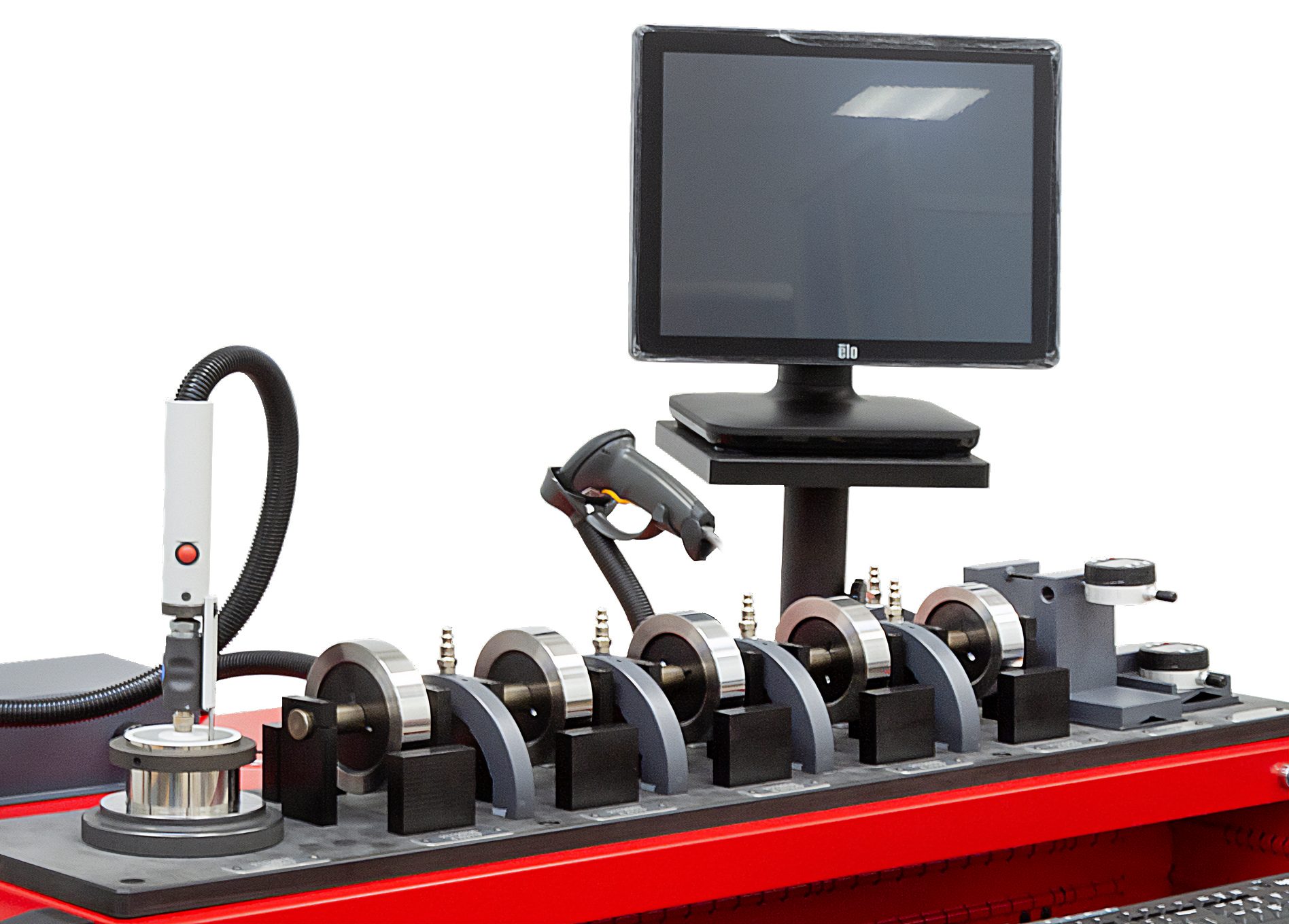

An industrial machine featuring rotating components, a monitor, a barcode scanner, and a probing tool.
Figure 2: Example of a portable air gaging station using air snaps, air plugs, and more.

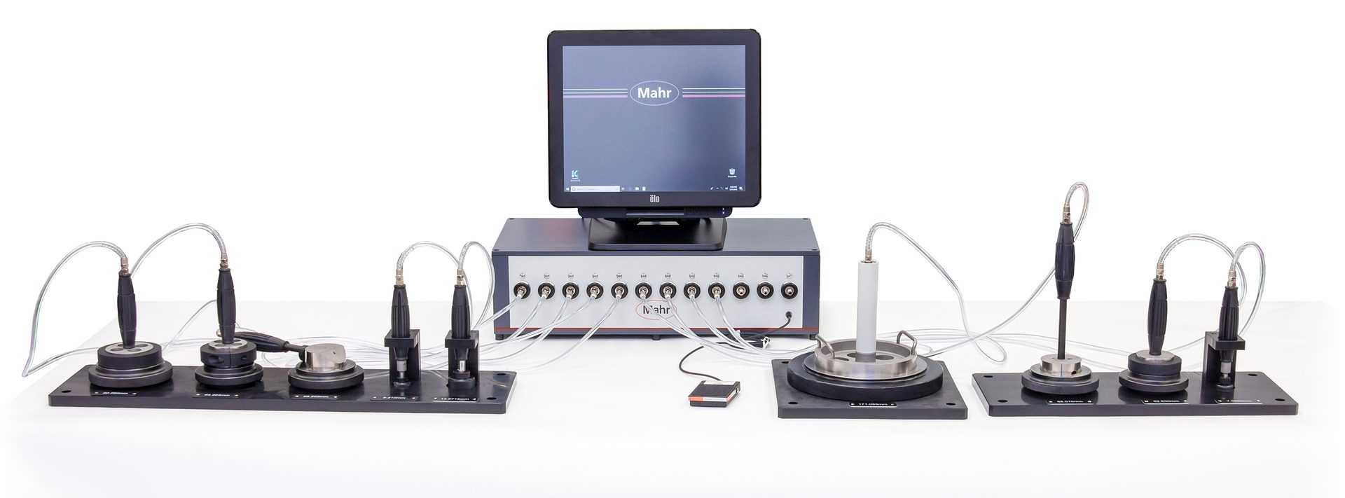

A Mahr multi-channel measurement system with a display, control unit, and several precision probes.
Figure 4: Example of a multi-tool benchtop air system
