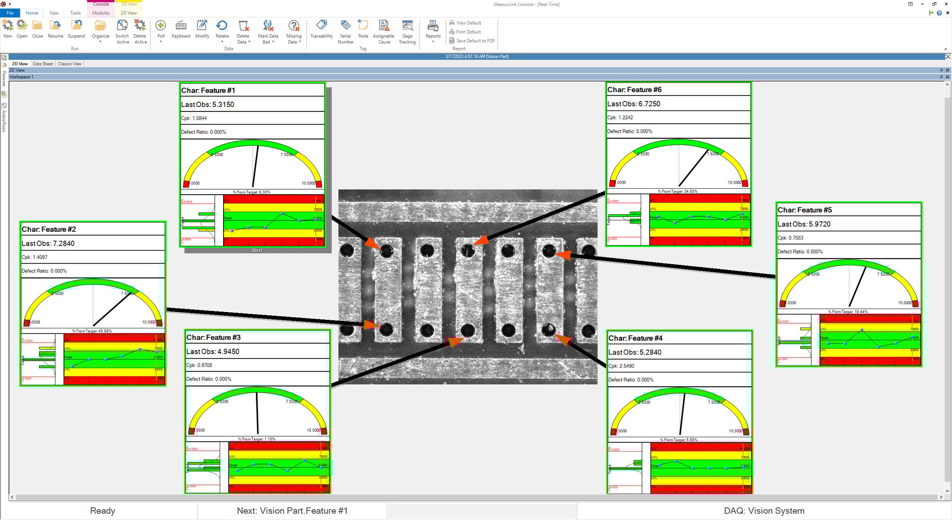

A real-time measurement dashboard highlights each feature’s performance and Cpk values, enabling operators and managers to quickly spot trends, prevent defects, and optimize processes.

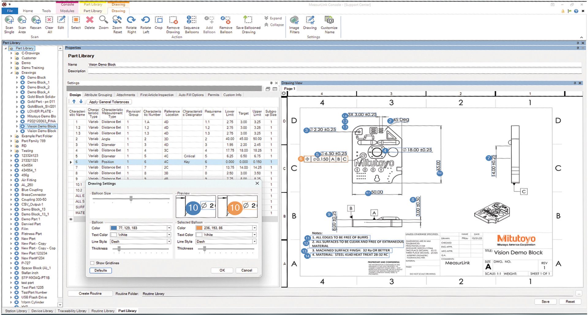

Automated OCR ballooning links each dimension and tolerance from the print directly to real-time inspection data, ensuring faster, more accurate traceability for every measured feature.
