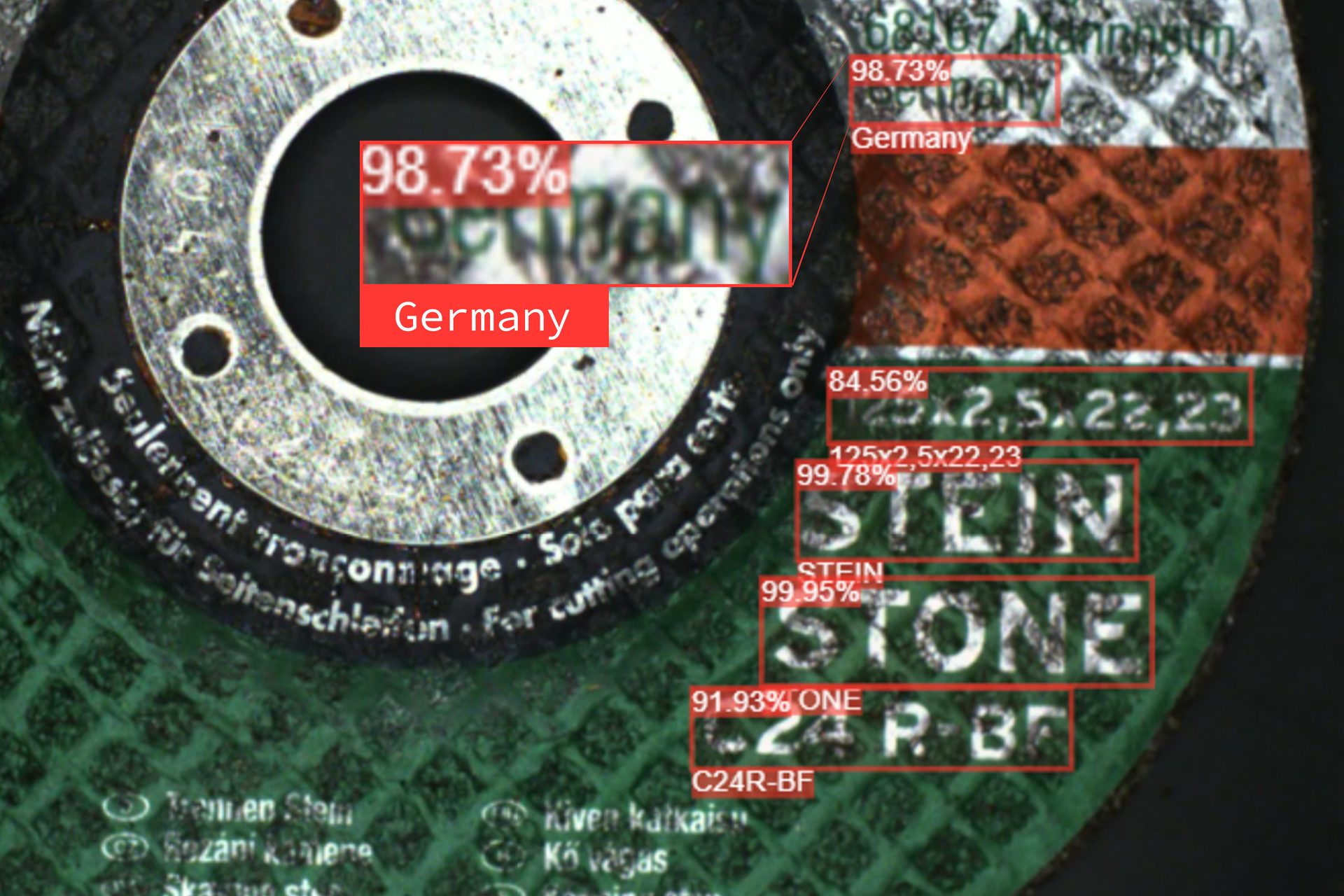

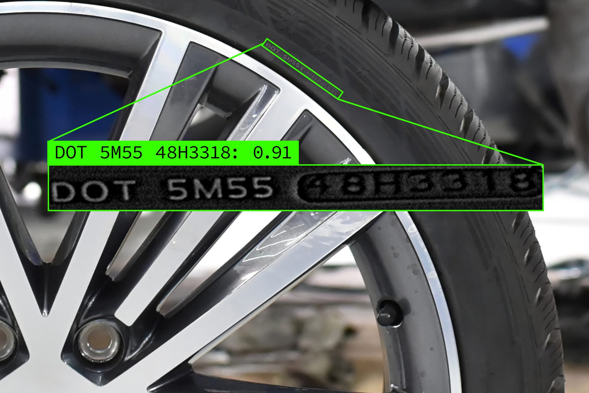

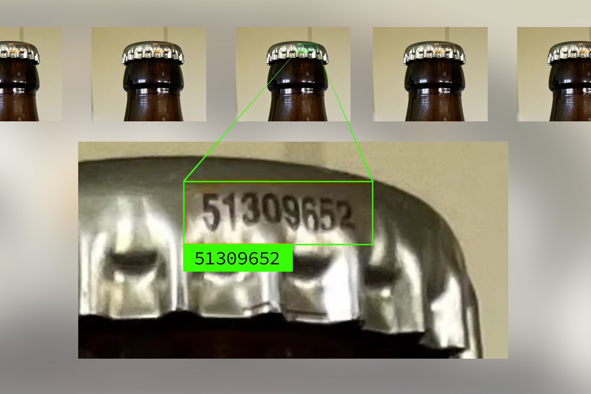

Figure 1: OCR systems should read reliably from the outset in different applications, even without fine-tuning. For example, tire markings with little contrast, heavily deformed and small numbers on crown caps or information on separating discs with considerable overprinting, even with a highly inhomogeneous background.

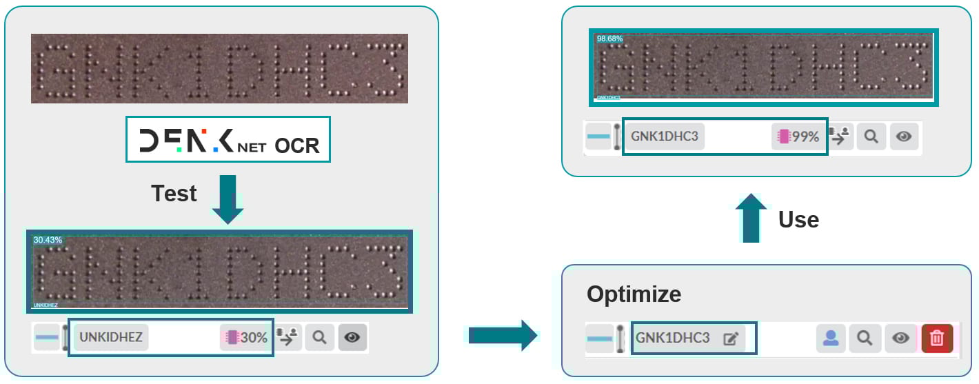

Simple correction and retraining
If the OCR fails to read characters, regardless of whether the reason was an error or an unknown character, font or language, it is important that the user can correct the reading results or train any new characters with little effort. However, this fine-tuning is not simply a matter of “continuing to train” the network. Imagine, for example, that the OCR model has been trained with 2 million images and the user now wants to introduce something new to the OCR model with a few more images of his own. What weighting should be given to such information in the model in order to make a difference without changing everything that is already there? And this is precisely where the provider’s expertise is required to expand the AI in such a way that this type of adaptation does not negatively impact previous stable recognitions. An example: An OCR has problems with numbers for some reason and the user only annotates numbers in subsequent training processes, never letters. The aim is to achieve an intelligent “knowledge backup” to prevent this network from only being able to read numbers successfully at some point because it thinks it does not need to read letters.
A well-designed training system therefore generates additional synthetic data for all new image data during fine-tuning in order to further train and weight the network to the right extent. This prevents the OCR from losing its previous capabilities, no matter how long it continues to be trained. However, such complex processes during “retraining” are better hidden from the user under a simple user interface and are processed quickly and efficiently in the background using sufficient system resources so that the user is not kept waiting for long periods of time. In the best case scenario, however, the basic capabilities of the OCR model are so good that little or no additional training is required.
Fine-tuning is designed to quickly improve the reading quality of an OCR system with less user interaction or expert knowledge required
Figure 2: Fine-tuning is designed to quickly improve the reading quality of an OCR system with less user interaction or expert knowledge required.
