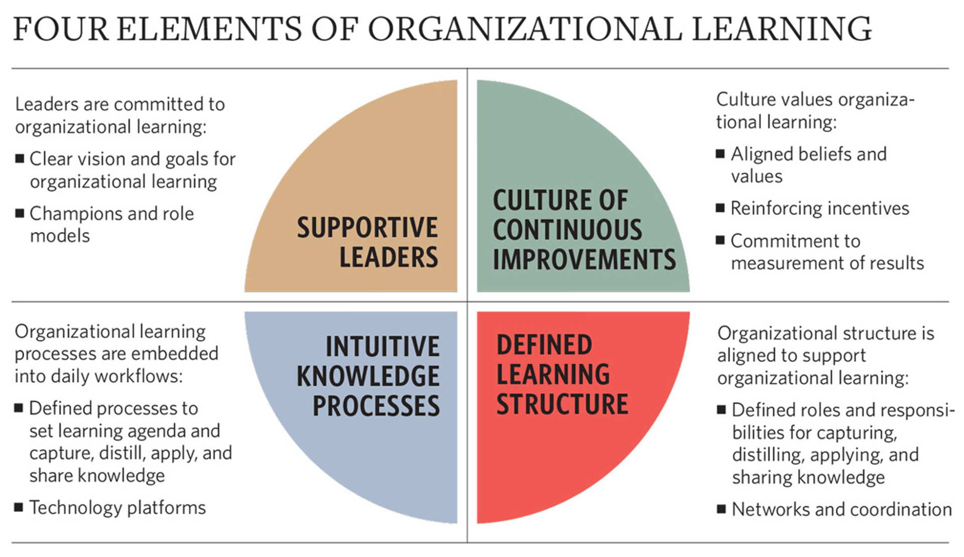

Four Elements of Organizational Learning
The four elements of organizational learning support the requirements of organizational knowledge. They present additional actions that an organization could implement to address the issues presented and others the organization is dealing with.
There are more issues and many more actions that may be taken to address the issues. I hope that this article provides you with a better understanding of why organizational knowledge is a key requirement for an effective organization and management system to fulfill its purpose.
