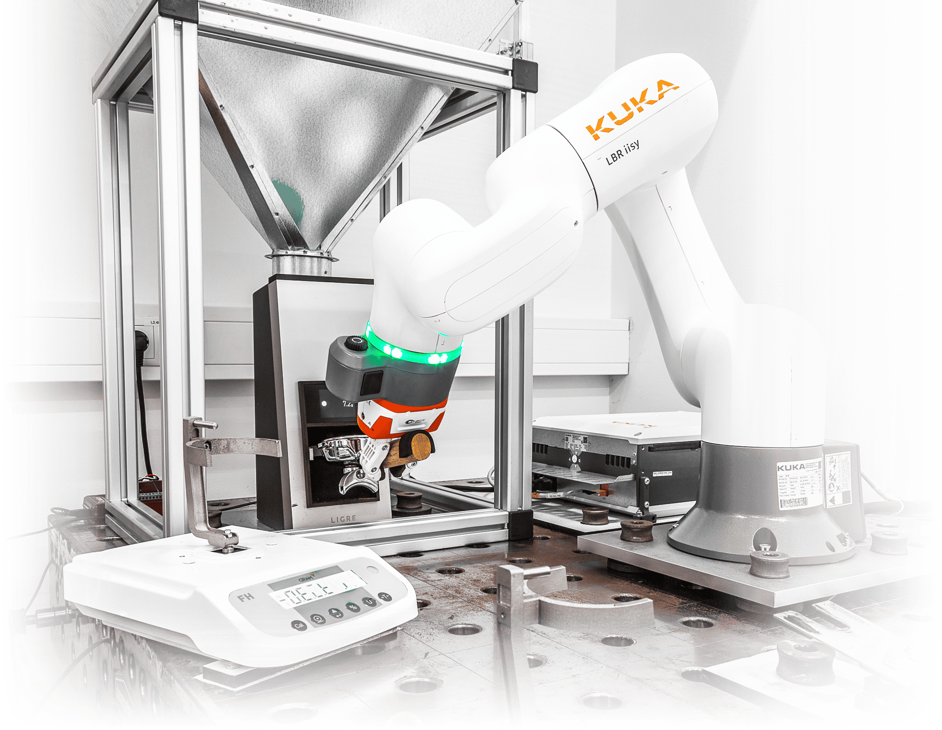

Once the Niederndorf R&D team had a design they believed capable of meeting these criteria and built a prototype, they needed an economically viable means to test it. Determining long-term performance under a variety of operating conditions would require both radical acceleration of the testing process, as well as extremely precise repeatability. The results needed to be incredibly reliable to validate the grinder’s operation and provide findings that could be incorporated into future product designs.
The R&D experts at Gronbach quickly came to an agreement that an automated robot solution was the only way to achieve cost-effective quality control using a test setup. The Niederndorf facility already had multiple industrial robots from KUKA Robotics in use, leading the team to evaluate whether KUKA offered an option that would work for their specific application. The LBR iisy cobot seemed to fit the bill.
Featuring six axes of motion, a 3-kg payload and 600-mm maximum reach, the LBR iisy provides ready-to-use automation out of the box. The cobot integrates intuitive features and an operating system that allow users of all skill levels to quickly and easily teach it to perform tasks with precision and repeatability. Additionally, despite its relatively low cost, the LBR iisy incorporates high-grade joint torque sensors in every axis, providing certified collision protection to ensure safe operation alongside employees.
Research, Workwear, Researcher
Caption
“The cobot solution is an invaluable benefit for the necessary flexibility in a test laboratory,” said Peter Kopfensteiner, research and development, division appliances at Gronbach. “Other industrial robot solutions with complex safety structures were not an option owing to the high expense for a test series like ours, mainly because the costs were entirely disproportionate to the relatively short period of use.”

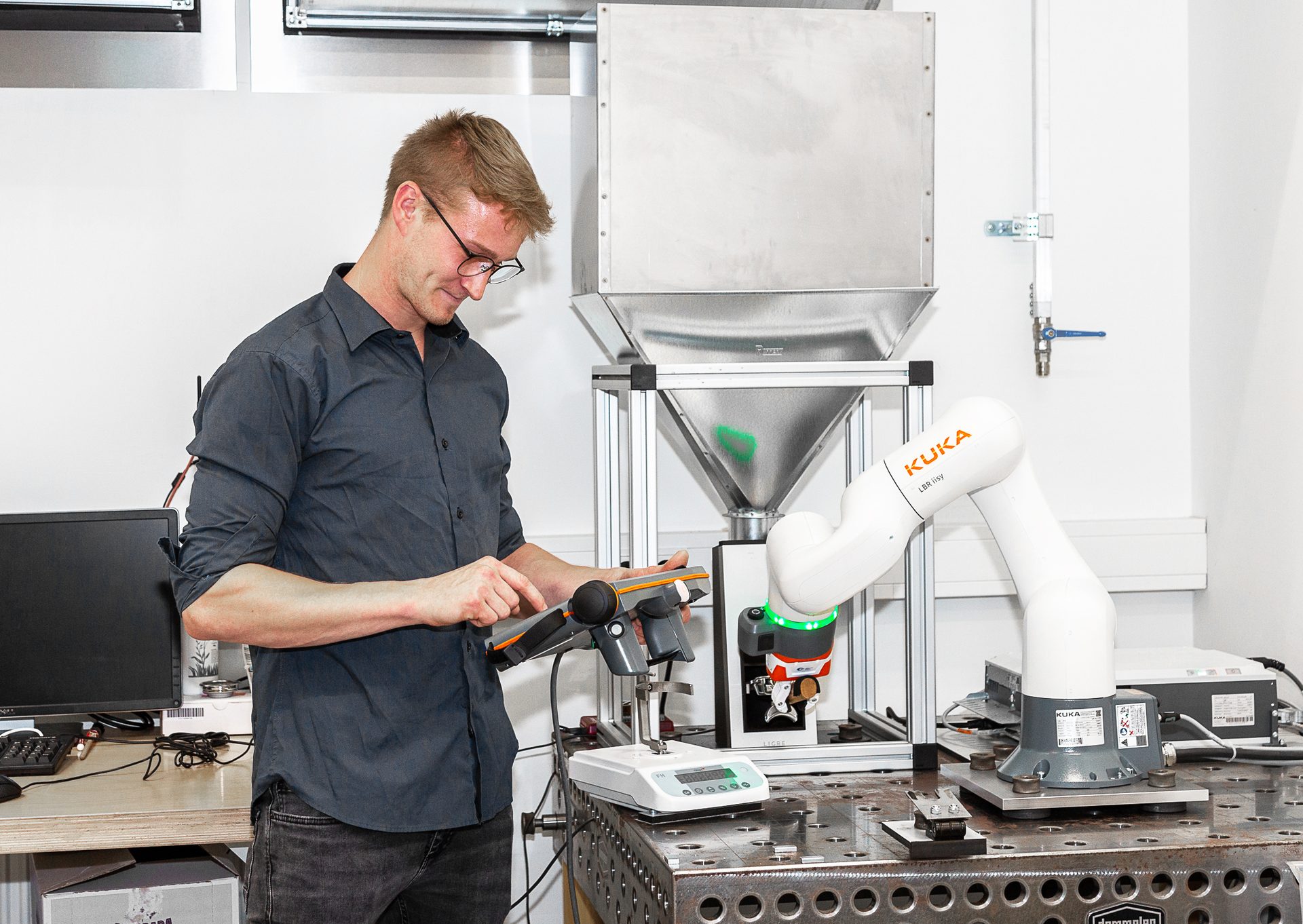

Once the R&D department acquired the LBR iisy, they quickly set it up and trained it to perform a series of steps. The cobot would initially move the siji’s portafilter to a precision scale to obtain a tare weight. It would then move it to the grinder and wait for the grinding process to be completed. From there, it moved it back to the scale and recorded the net weight of the amount of coffee ground. Lastly, it would empty the portafilter before starting the process anew.
The Gronbach R&D team was particularly impressed with how easily the process was programmed once the cobot was in their testing lab. The LBR iisy features a Teach button that streamlines programming through human-robot interaction.
“You can guide the cobot manually to teach it the desired movements and waiting times,” explains Michael Reindl, account manager at KUKA Robotics. “It’s very easy, with just the press of a button. This allows for flexible application options and it can be commissioned and operated quickly and reliably, whether by automation experts or robotics beginners.”
Over the span of two months, the cobot performed this sequence 55,000 times, validating the performance of the design of the siji coffee grinder.
“Our aim was to test the grinder’s simulated service life to gain insights into wear and accuracy,” explained Dipl.-Wirt.-Ing. Alexander Fahringer, technical development and test engineer at Gronbach. “The grinder worked so well that it indicated practically no wear and tear after simulating ten years of use, so it would last for significantly longer.”
