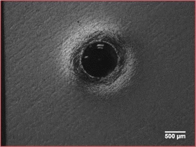

Figure 1 - Visible material deformation around a hardness indent
An important choice for any application is the question of whether the hardness test can be performed directly on the surface of the coating, or whether a cross-section of the coating needs to be made. If a coating has a relatively rough finish, the variability in contact area when applying an indent may be high compared with the total indent size. This would introduce scatter in test results. Using a higher load to create a larger indent reduces the variability, but it is important to make sure that the indent is not affected by the substrate material. The coating must also be significantly thicker than the depth of indent, each impression has an associated deformation zone (Figure 1). If this deformation zone is deeper than the coating, the resultant hardness reading will be affected by substrate hardness. Both ASTM and ISO standards provide guidance on suitable minimum thicknesses for a given test type and load, as this can be up to fifteen times the depth of the indent for some materials.

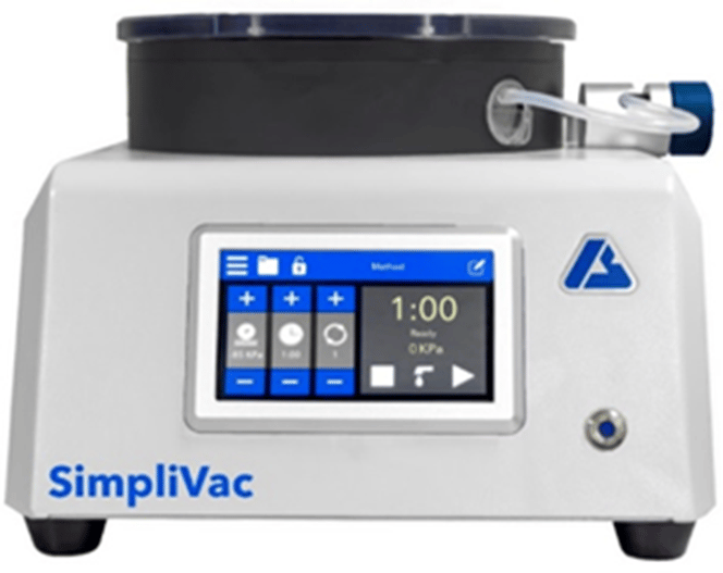

Mounting: After cleaning and drying the cross-section, it should be mounted using a low viscosity epoxy. Best results are found when mounting under vacuum (Figure 3), to ensure penetration of the epoxy into cracks and voids. Multiple vacuum cycles are far more effective at ensuring penetration of the epoxy than extended times under vacuum. For particularly hard coatings, additives can be used in the epoxy to provide extra edge support through the preparation process.

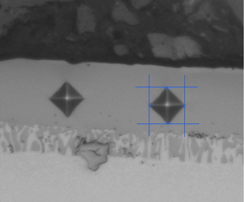

Hardness testing on prepared cross-sections is almost always done using low load optical hardness testing, such as Vickers and Knoop. As the testing is now being done perpendicular to the surface/substrate, it is important to use indents that are small enough such that the deformation zone around the indent does not interact with the boundary. As with depth restrictions, recommendations are made in both ASTM and ISO standards, and are typically 2.5-3x the width of the indent. As these methods use optical systems the indents can be accurately placed, and it is much easier to be sure of meeting these criteria.

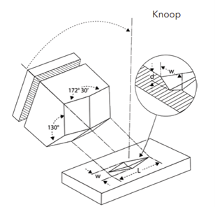

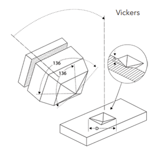

Vickers testing uses a pyramidal diamond indenter (Figure 5) and is the most commonly used scale. However, the Knoop indenter (Figure 6) uses an elongated pyramidal shape that is both longer and shallower than the Vickers indenter. In both cases, selection of load allows very small indent sizes to be achieved. To minimize variability from optical measurement systems, indents of 20 microns or greater in the measuring diagonal are preferred. The big advantage with the Knoop indentation is that the ideal 20-micron minimum size (on the elongated diagonal, L) can be achieved, whilst the smaller width of the indenter (w) allows indents to be placed closer to edges or to each other. This is often the ideal method for measuring thin coatings, multiple layers and variation in hardness through the thickness of a coating, although typically Knoop hardness values should only be compared when made at the same load.

Some coatings are not homogeneous and may contain multiple phases or porosity. Even as a cross-section, these coatings can be difficult to assess with small, visually measured indents. Figure 7 shows such a coating, with a Vickers indent carefully placed inside a smooth, reflective area. To test in this way would be time consuming, and still likely have significant variability, as the volume around the indent is not constant. In these cases, a Superficial Rockwell test is preferred. Faster testing would allow a larger number of indents to be made in the same amount of time, and the bigger indent size will reduce variability in test results.
