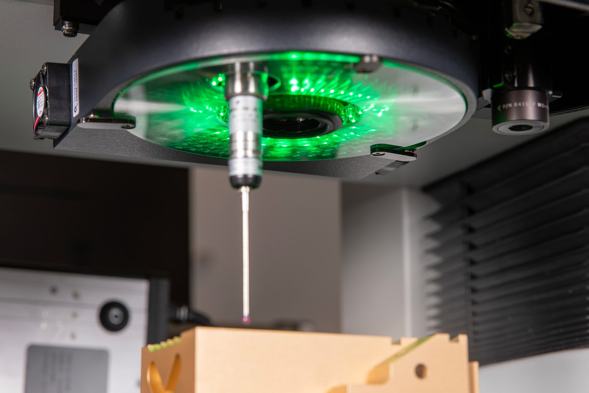

Complementing the optics, the system will also feature both contact probes (touch trigger and scanning), and non-contact laser and micro-probes. The combination of optics, contact, and non-contact sensors provide complete 3D measurement data output from a single system.
While optical systems are highly productive, they cannot be relied on to measure every single feature of a complex-shaped part – this is why modern multisensor measurement systems will feature contact probe options. A touch trigger probe will measure features of a part that are difficult to image, or surface boundaries that are inaccessible to optics.

By contacting the part, retracting, and moving to the next point, touch trigger sensors find data points one at a time. A variety of different styli configurations, tip materials, and lengths allow operators access to the specific features of the part being measured. Depending on the nature of the application, ruby, tungsten, or Teflon tips may be selected, along with straight single probes or multi-tipped star probes.
For parts with deep bores outside of the focus range of the video sensor, a touch probe is the idea sensor – reaching the surface and achieving accurate measurement.

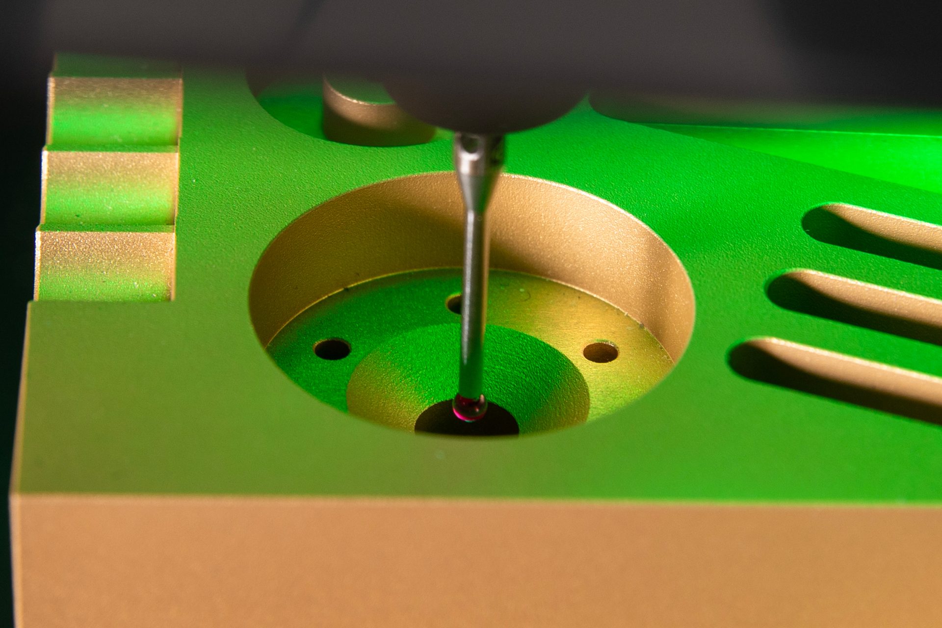

Like the contact nature of touch probes, scanning probes are designed to make continuous contact with the surface of the part to gather high-density point data. These probes are ideal for achieving accurate profile or surface measurements. Scanning probes collect hundreds or thousands of measurement data points as they move across the part’s surface.
A scanning probe can greatly reduce programming and measurement run time versus single point probing, increasing measurement throughput while delivering accurate results.
CMM probe with red tip measuring a green and gold machined part.
Deep bores are easily accessed and measured via touch or scanning probe.

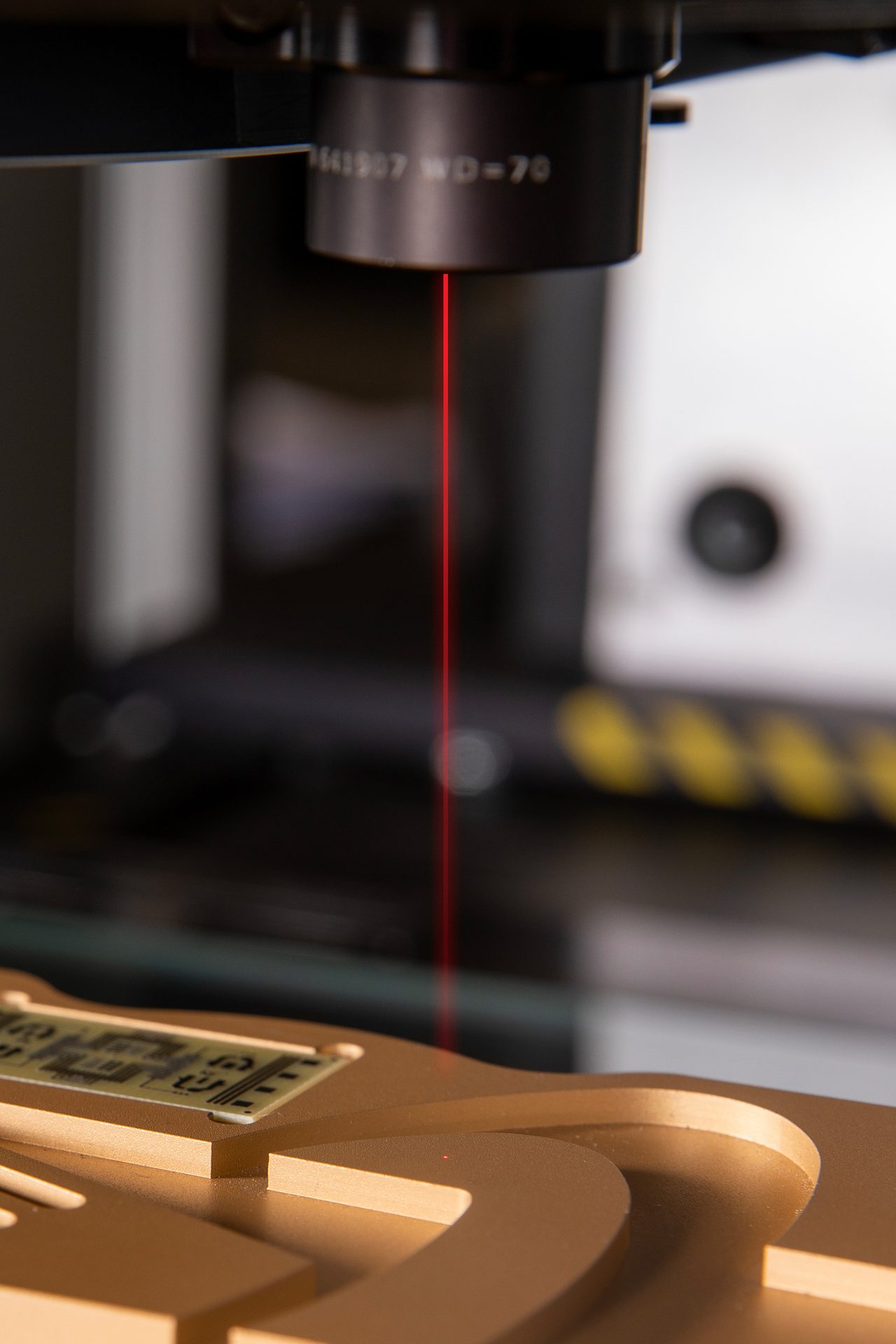

Along with video as the primary sensor, multisensor metrology systems feature a selection of non-contact laser sensors.
Laser sensors gather points from surfaces and can be used to make fast contour and dimensional measurements on a variety of difficult to measure materials and surfaces. Laser scanners provide accurate measurement of part features that may not be accessible by other measurement methods, including tactile probes.
Laser sensors can be added to the system in an on-axis configuration with a through-the-lens (TTL) laser, or off-axis in the form of a laser pen or range sensor.
A TTL interferometric laser that is on-axis and non-triangulated, with a very long working distance, can measure deep inside recessed features that are not accessible by any other sensors. There is no offset between the optics and laser in a TTL configuration, which can be advantageous when switching between video and laser or if the part is particularly large.
A side-mounted triangulation laser can achieve extremely high resolution even on specular surfaces that scatter laser light, while chromatic white light probes can achieve Z height measurements with sub-micron accuracy and measure surface height changes on transparent, translucent, fragile, or even liquid surfaces.

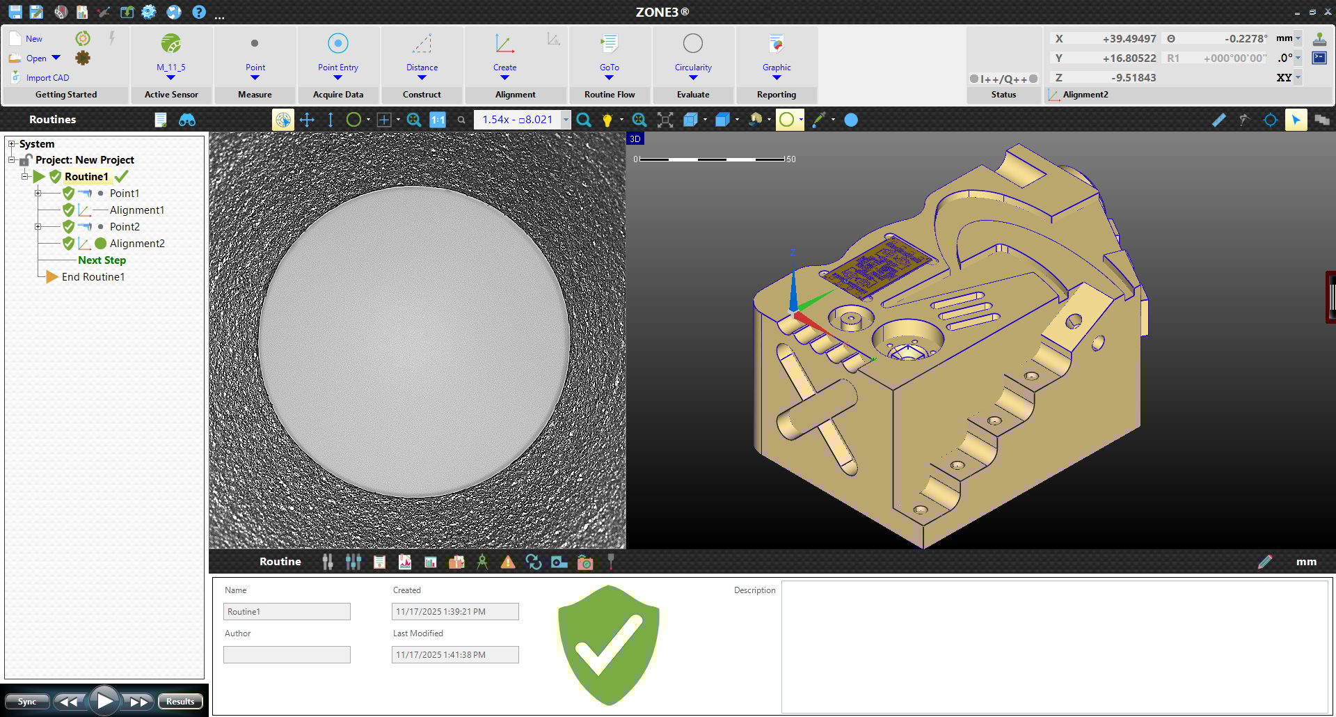

While hardware is extremely important, it’s no use without robust software.
Since a multisensor system is inherently designed to use a variety of sensors to deliver full measurement results, the best systems feature software that calibrate all available sensors and automatically generate measurement routines – making programming a breeze and optimizing routines for maximum efficiency.
Software that is unified and offers 3D CAD capabilities, CAD with PMI, GD&T functionality, and regulatory compliance is essential and removes the need for operators to learn multiple standalone software packages for each individual sensor. These software packages offer clean, simple user interfaces and allow for easy graphical reporting of complex measurement data.
Metrology software (ZONE3) showing 2D and 3D part views, plus measurement routine steps.
Metrology software that allows intelligent programming from CAD models eliminates the need for multiple software packages for each individual sensor.

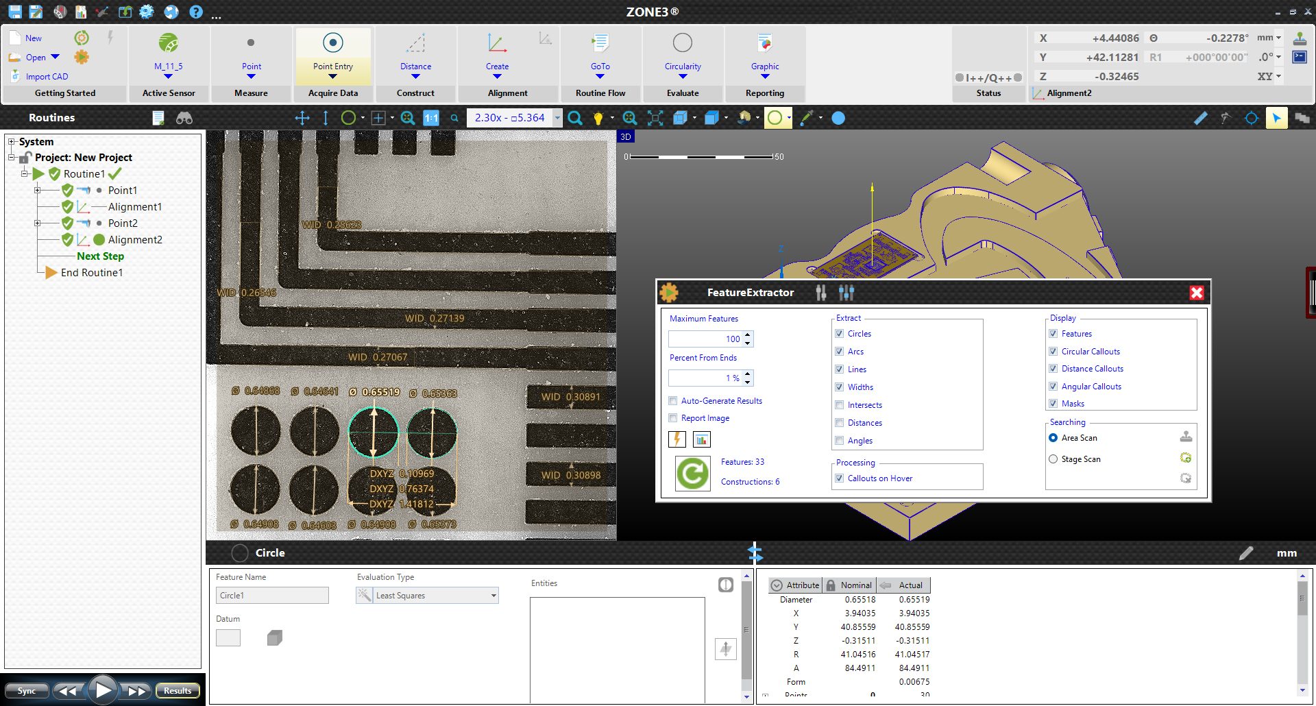

Intelligent feature extraction is another. System users can place their part or parts on the stage, and all measurement decisions can be made with zero input. Automated decision making in the software can be a great benefit to organizations that struggle with the ability to train or retain skilled users of the metrology systems.
ZONE3 metrology software displaying a circuit board, 3D model, feature extraction dialog, and measurement results.
Intelligent features like automatic feature extraction immediately discover the part’s features and display results graphically.
