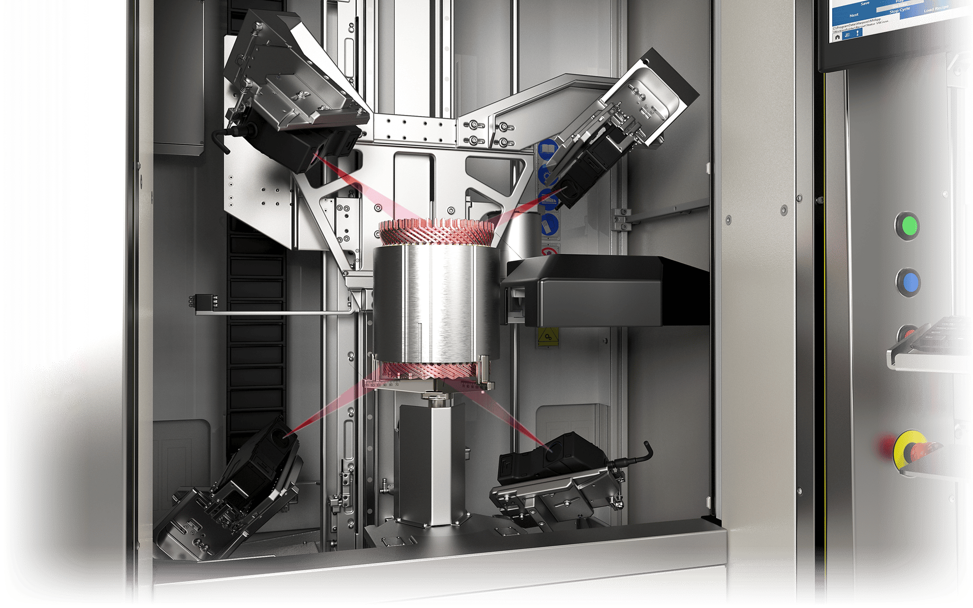

In all operations, it is necessary to verify the correct positioning of components inside the stator in order to carry out the correct welding of the terminals. And, once the welding has been carried out, it is necessary to verify their shape and correct positioning.
Carrying out these checks is not possible using traditional contact systems, so measurement systems have been developed based on 3D laser reconstruction of the surfaces to be inspected. Other specifically-developed measurement algorithms allow the conversion of information contained in point clouds, composed of millions of data that convey height measurements, distances, angles, etc. Point cloud analysis also allows you to evaluate the quality of the weld based on its shape.
