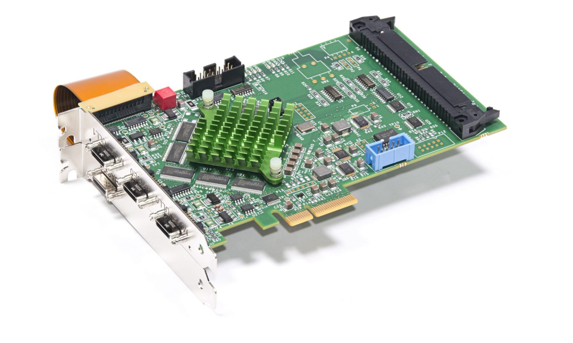

Camera Link Frame Grabbers
When smart cameras were first introduced, many in the machine vision industry assumed that the era of the frame grabber had passed. Smart cameras use USB or Ethernet to connect to the PC, therefore eliminating the need for a frame grabber. Yet even the most advanced smart cameras have proven to be only appropriate in low-end applications— the cabling alone limits the data rates for these cameras. For fast, high-quality imaging with maximum design flexibility, a frame grabber is required, especially in industrial inspection.
Unlike a smart camera system, Camera Link frame grabbers do far more than simply capture images from a video stream. Camera Link frame grabbers can:
- Pre-process and compress data before transmitting it to the host PC.
- Precisely synchronize camera triggers and strobe lighting to start image acquisition.
- Connect with proximity sensors and motion encoders.
- Control camera exposure, among other functions critical to a successful vision application.
So, what should you look for in a Camera Link frame grabber? First, make sure that the frame grabber supports the camera’s mode (base, medium, full, Deca), tap configuration and pixel depth. Also, if you are using PoCL, verify that your frame grabber and cable supports it. If not, you will need to use a power supply for the camera. These are the very basics. Depending on the application you’ll also want to consider Camera Link frame grabbers featuring:
- Scatter-Gather Direct Memory Access: This type of DMA moves image data into host memory without consuming CPU resources, leaving the CPU 100% available to process incoming images. The DMA engine will also cache scatter-gather instructions so when access is blocked, the engine can continue to run and move image data into host memory, meaning no images are lost during times of heavy memory and bus traffic.
- The DMA engine should be able to DMA into completely fragmented host memory buffers and not only into contiguous pre-boot allocated host memory, giving you greater control over the system.
- Factory support for both Linux and Windows. There are many reasons why designers chose to deploy their application on Linux over Windows: stability, transparency, and costs. Choose a frame grabber supplier that supports both.
- Support for DMA into GPU memory on both AMD and NVIDIA platforms. GPU processing is one of the best solutions to deal with today’s high-speed cameras, and this support will make the image movement side of an application simple and easy.
- A simple, easy to use and learn Software Development Kit (SDK) to get images into an application from the frame grabber. The SDK should have enough power and flexibility to help you get an application written quickly and efficiently, plus offer APIs that let you program the boards at many different levels, from low level hardware control to high level board-generic circular buffer management.
