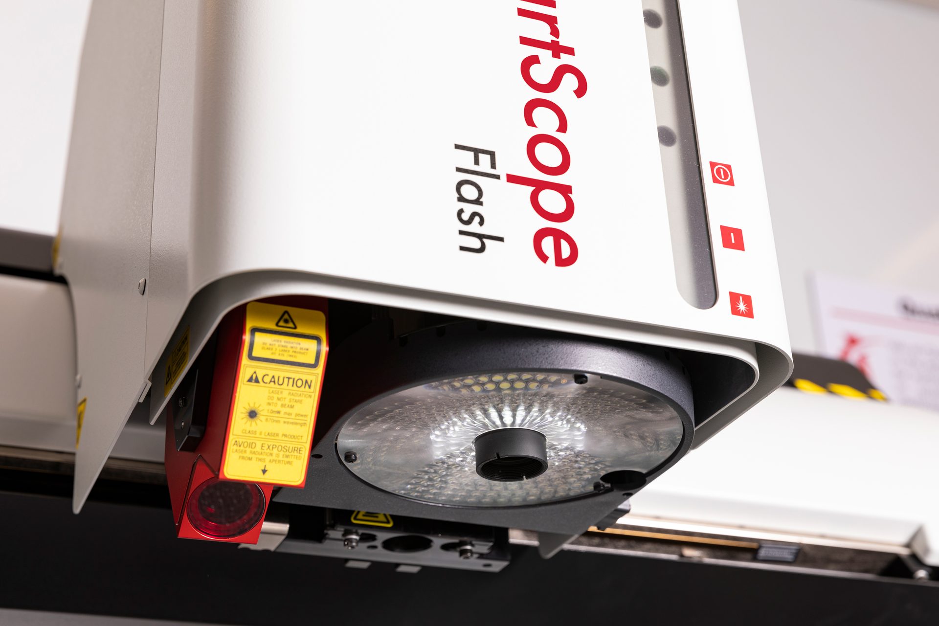

Optics: The Core of the System
Modern multisensor metrology systems offer strong optical systems at their core. Optical metrology is fast and does not require physical contact with the part being measured. Video measurement provides high accuracy and repeatability when detecting features, orienting parts, and measuring edges, dimensions, angles, and surface profiles.
LED Ringlight surrounding the optical system of an OGP SmartScope ZIP Multisensor Measuring System.

Laser Sensors: Noncontact and High-Accuracy
A modern multisensor metrology system will feature one or a selection of laser sensors, which gather points from surfaces and can be used to make fast contour and dimensional measurements on a variety of materials and surfaces when scanned. Laser scanners provide accurate measurement of part features that may not be accessible by other measurement methods, including tactile probes.
Most multisensor systems are offered with a variety of types of lasers, equipped to perform high, surface, and contour measurements. A laser might be on-axis in a through-the-lens (TTL) configuration, or may be off-axis in the form of a laser pen or range sensor.
A TTL interferometric laser that is on-axis and non-triangulated, with a very long working distance, can measure deep inside recessed features that are not accessible by any other sensors. There is no offset between the optics and laser in a TTL configuration.
A DRS laser side-mounted on a multisensor measuring machine.
A side-mounted triangulation laser can achieve very high resolution even on specular surfaces that scatter laser light, while chromatic white light probes can achieve Z height measurements with sub-micron accuracy and measure surface height changes on transparent, translucent, fragile, or even liquid surfaces.
Lighting and Motion for Full Part Coverage
Any modern multisensor system will come equipped with systems that provide light that is programmable for both direction and incidence angle, illuminating parts to achieve easy, accurate measurements.
The inner rings of an LED lighting system illuminate the part from above, almost “square on.” The outer rings provide oblique lighting, ideal for chamfered edges and blended radii. By selecting different rings, users control the angle of incidence of the illumination.
Each ring is also divided into sectors, allowing users to specify the direction of the light. Any combination of rings and sectors can be selected to create just the right illumination for any application.
LED Ringlighting provides options to light features of parts from different angles and intensities.
