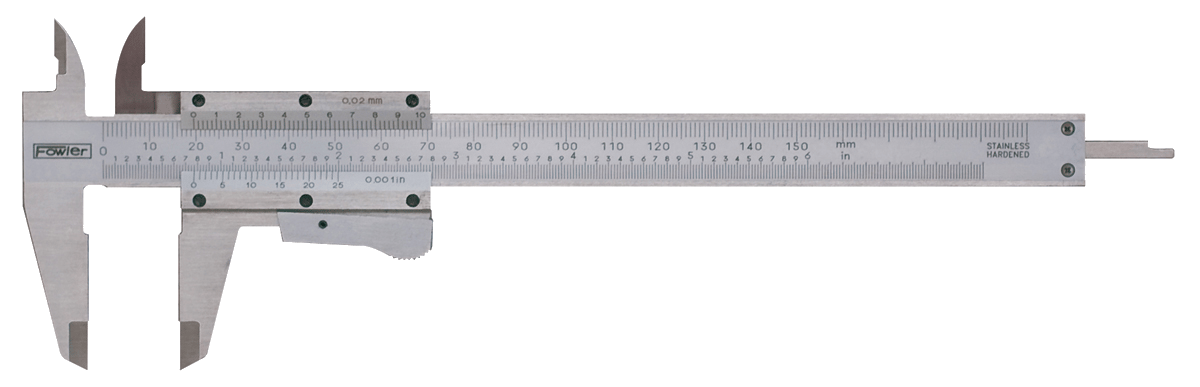

In the 1630s, mathematician Pierre Vernier invented the Vernier caliper, which uses the Vernier scale to take accurate measurements between two graduated markings on a linear scale by using mechanical interpolation, thereby increasing resolution and reducing measurement uncertainty.
These calipers consist of a pair of jaws. The left jaw is attached to a beam with a fixed scale and the other attached to a sliding carriage with a Vernier scale. To read a Vernier caliper, one must add up the values from the fixed scale on the beam and the finer Vernier scale on the carriage (which can measure to 0.001” or 0.02 mm).
Vernier calipers remain the most commonly used type of caliper today due to their accuracy and precision as well as their versatility (equipped with both internal and external jaws, a depth rod and step measurement feature). Thanks to its ubiquity, Vernier calipers are also low-cost. These calipers are typically made of stainless steel, which results in high durability and longer use.
However, due to the incredibly small values on the Vernier scale, measurements may be too small to read for some, and even require a magnifying glass. Users must also know how to take readings i.e. the lower range of the fixed scale plus the Vernier scale reading. For even higher accuracy and to avoid human error, especially in high-tech machining, users should consider digital Vernier calipers.

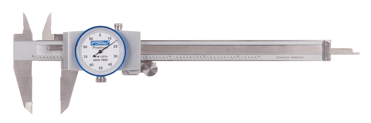

Dial calipers are similar to Vernier calipers but feature a dial gage, which allows easier reading. They utilize a rack and pinion mechanism, where a gear-toothed rack is used to transfer linear motion (from the slider) to a rotary motion (the pointer or hand on the dial).
Dial calipers are as accurate as Vernier calipers, for each graduation of the dial equals 0.001” or 0.02mm. When reading a dial caliper, the user reads the scale on the main beam before adding on the dial gage measurement for a complete measurement.
Besides being easier to read than its Vernier counterpart, dial calipers are also long-lasting due to being analog and not requiring batteries like their electronic counterparts. However, dial calipers do not have a wide range of measurement, with 12” or 300mm being the typical maximum range available although extra-long versions of 18” and 24” are now available.
Due to the rack and pinion mechanism, which is susceptible to foreign matter entering and can become misaligned, dial calipers need to be cleaned and calibrated regularly.
