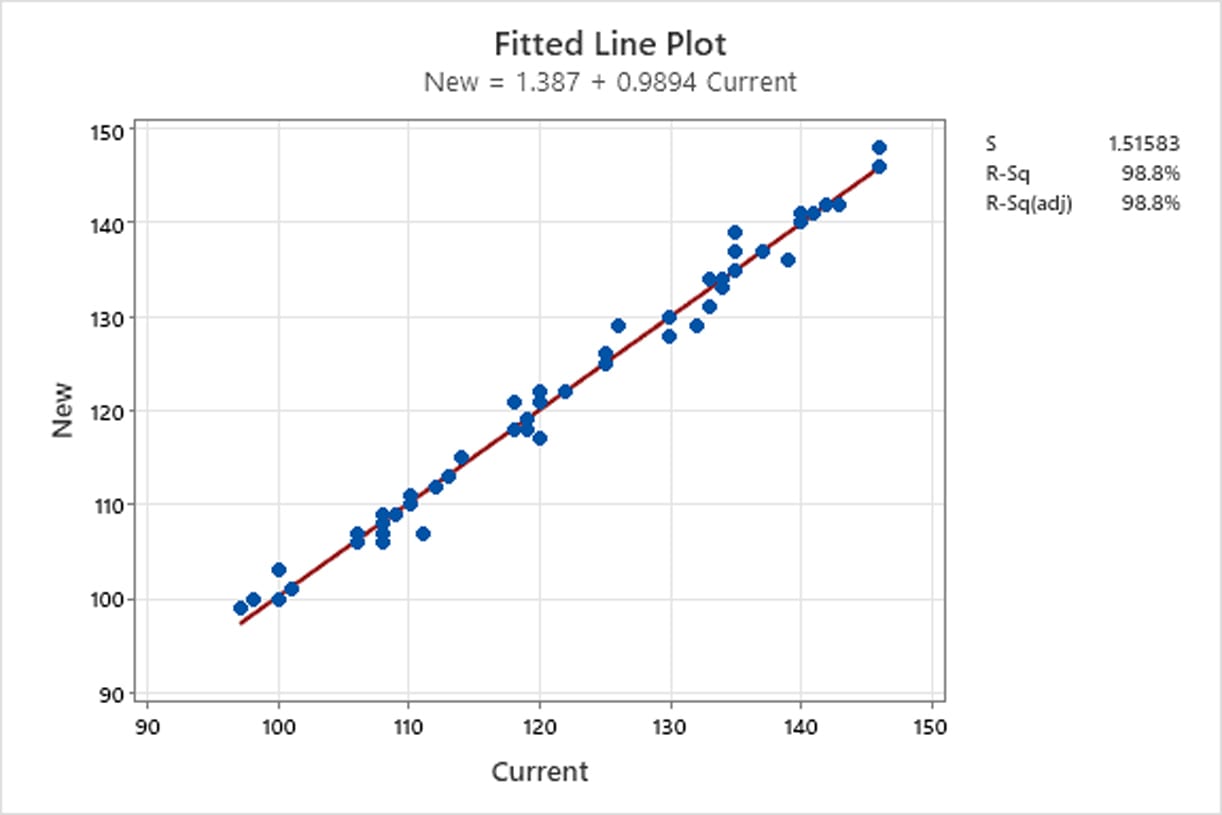

Suppose there is a medical device manufacturer that wants to determine if their blood pressure monitor is equivalent to a similar model on the market. To verify that the two instruments provide comparable measurements, the manufacturer selects people that represent a range of values where the measurements need to be comparable. Then, they measured the people with both instruments. The company obtains systolic blood pressure readings on a random sample of 60 people using the two instruments and records the data. Shown are a sample of the 60 rows, where each row represents a measurement using the Current and New instruments.
In this case we designate the Current readings as the predictor (or X) variable and the New readings as the response (or Y) variable. Fitting a regression line to this data shows that the Current measurement device readings predict the New measurement device readings quite well. The R-squared statistic indicates that the Current measurement device explains 98.8% of the variation observed in the New measurement device.
The regression equation is:
New = 1.387 + 0.9894 Current
Fitted Line Plot
It appears from this data that the Current measurements can certainly predict the New measurements quite well. In practice, we see engineers use predictive models to confirm that a new device can measure as well as a current device. There are other applications as well; there are situations when a faster measurement is needed. For example, some parts or samples must be measured using laboratory measurements before they can be shipped. But laboratory measurements can take hours, depending on the process. A measurement method that provides immediate results can be used to predict the laboratory measurements, providing operators and engineers with immediate feedback of potential problems.
The simple linear regression approach is good when we can assume there are no errors in the horizontal, or X direction. For this example, this would imply that our current measurement system contains no error. In the case of measurement systems, we know that assumption is not reasonable—so using simple linear regression is not the best statistical approach. But no worries, there is another approach that is just as easy to use.
