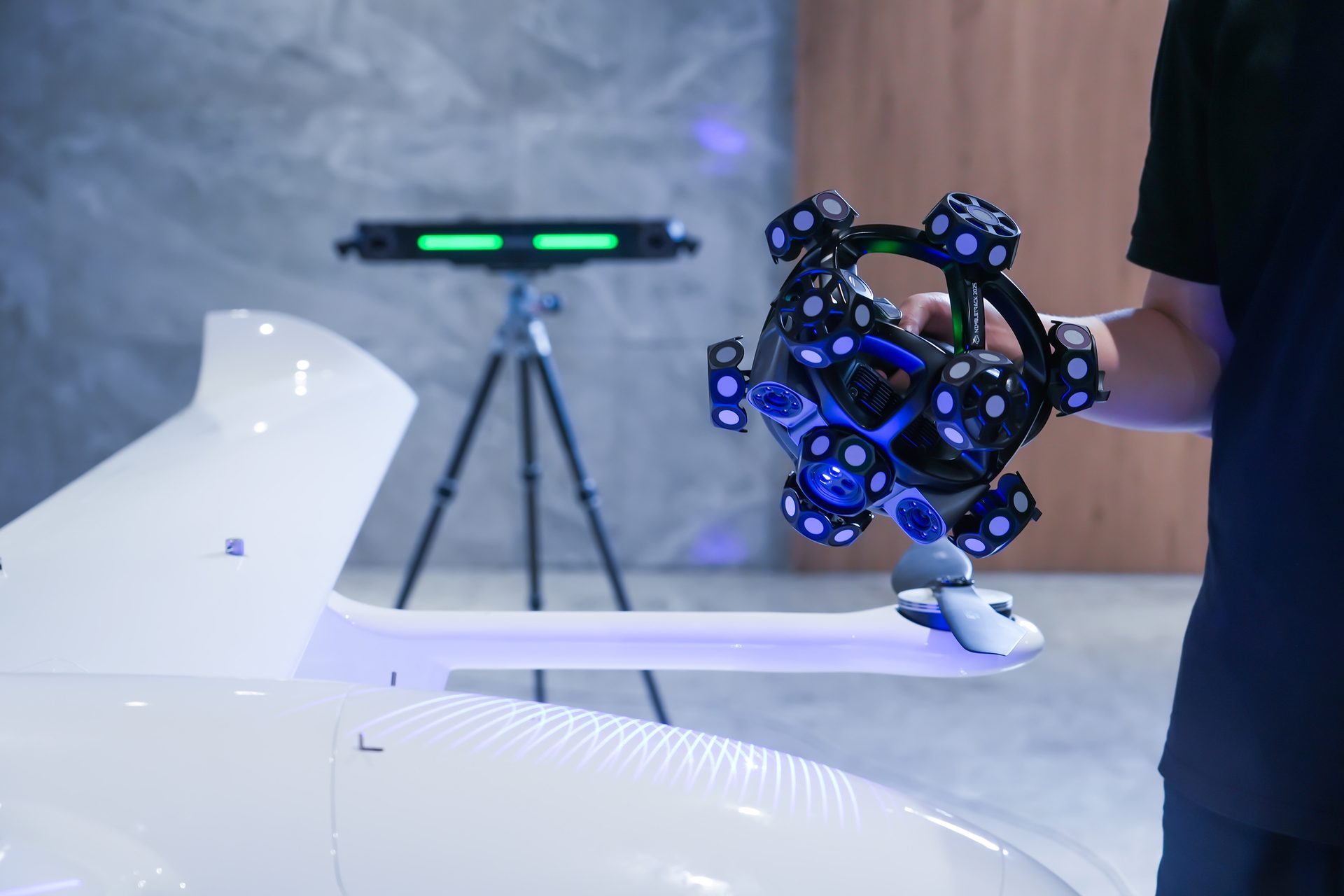

Handheld 3D scanner used on a white drone/aircraft part, with a green tracking system.
The NimbleTrack wireless 3D scanning system is highly compact and agile, which is designed to redefine the precise 3D measurements of small-to-medium-sized parts.

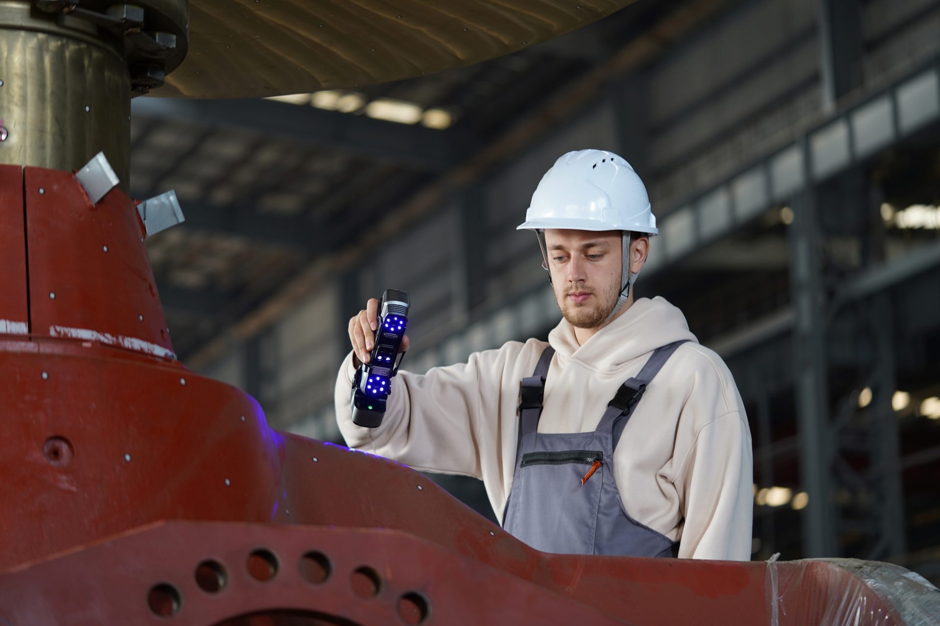

Worker in hard hat 3D scanning a large red industrial component with a handheld scanner.
The SIMSCAN-E is a 3D scanner that combines a lightweight design with performance.
