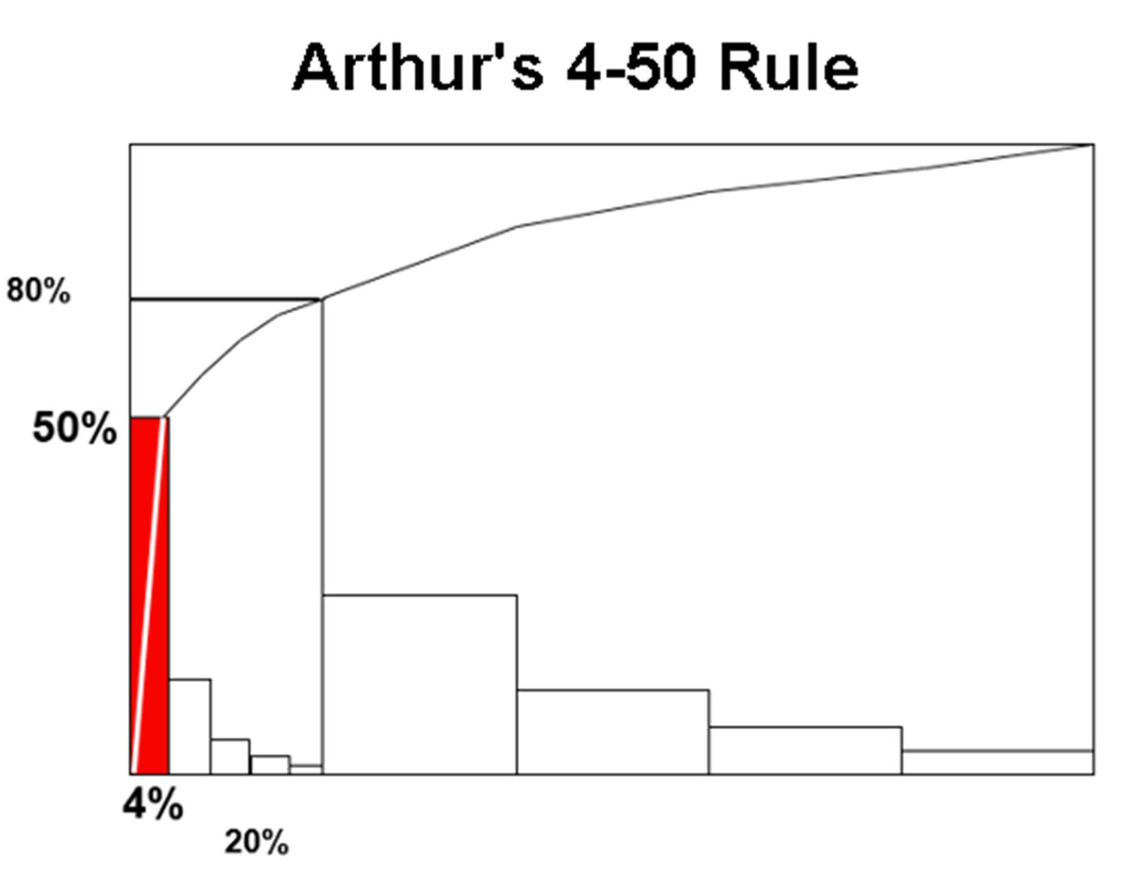

In the late 1800s, Vilfredo Pareto observed that 20% of Italians held 80% of the wealth. This has since become known as the 80/20 rule—20% of what you do produces 80% of the benefit. Similarly, 20% of any business produces 80% of the mistakes, errors, waste and lost profit. Where Vilfredo Pareto thought it only applied to wealth, Quality visionary Joseph Juran generalized it to all phenomena, especially defects. Juran actually gave this rule a name: Pareto’s Rule. Juran later said he wished he’d named it “Juran’s Rule” so that he would have gotten credit for it.
Over the years, working with data from industries as varied as manufacturing to healthcare, I have found that Pareto’s Rule doesn’t go far enough. Since the 80/20 rule is a power law, the distribution also applies within the 20%. So as little as 4% contributes over 50% (Figure 1).

In America, 4% of population holds over half the wealth. Four city blocks out of 100 have over half the crime. This means that when you boost patrols in those four blocks, crime goes down. Four percent of Boy Scouts become Eagle Scouts—the superstars. This is true of any sport or job. Four percent will become the stars.
Having learned from Juran, I call this Arthur’s 4-50 rule.

This is Arthur’s 4-50 Rule—4% of anything produces 50% of the benefits or problems. The dark side of the 4-50 rule—the 50% at the other end will produce only 4% of the benefit or problems.

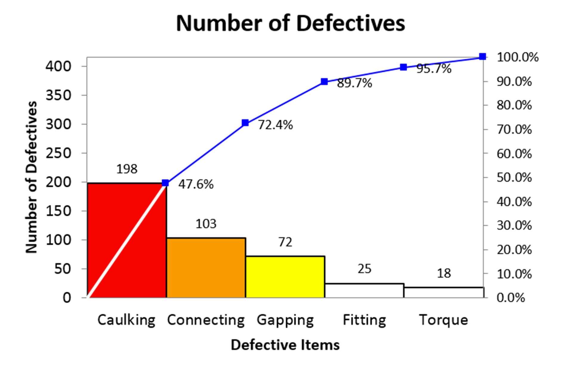

While Juran named Pareto’s Rule, I believe that Dr. Kaoru Ishikawa invented the Pareto Chart. His Guide to Quality Control (1968 pgs.42-49) shows the first Pareto chart—a sorted bar chart and a cumulative line chart. (Note: He called it a Pareto Diagram.) Here’s an example (Figure 2, pg. 43):
Pareto chart showing number of defectives by item. Caulking is most frequent (198, 47.6% cumulative).
Figure 2.

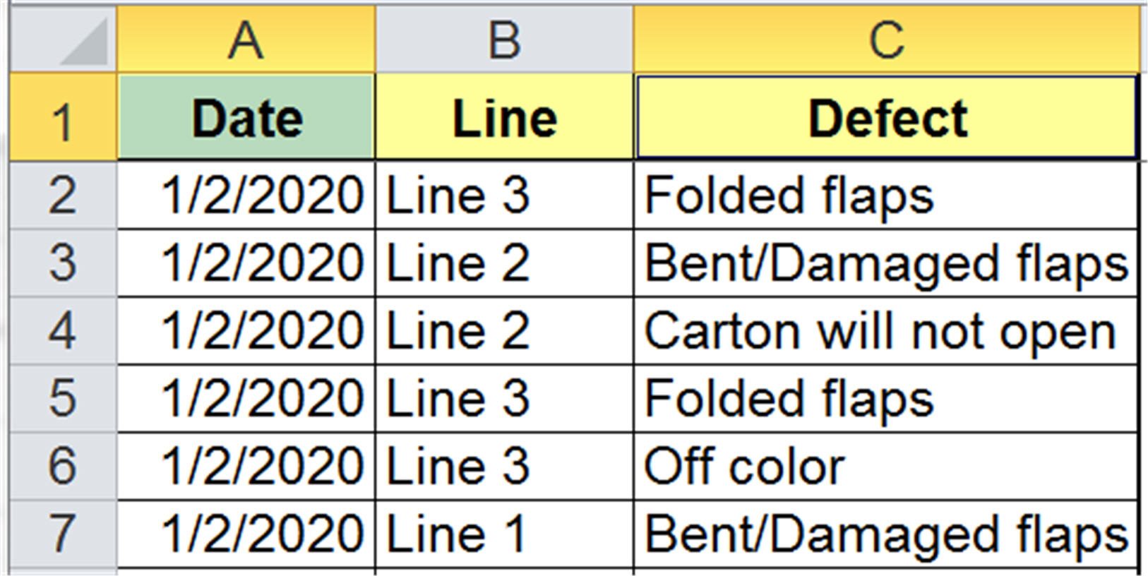

Using defect data that looks like that shown in Figure 3, it’s possible to use PivotTables to start drilling down into data to find the 80-20 and 4-50 rule. This data shows the when, where and what of packaging defects.
Excel table with Date, Line, and Defect columns, listing production issues.
Figure 3.

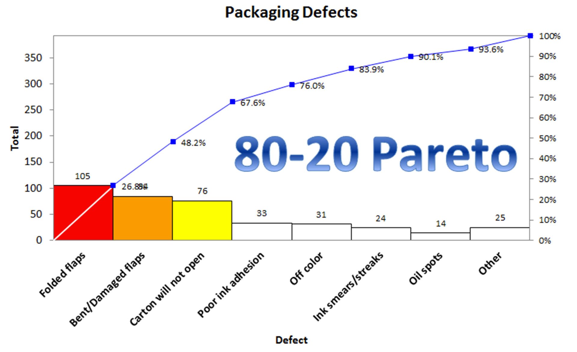

Pareto chart: Packaging defects by frequency and cumulative percentage.
Excel data: Product defects and their total counts, with "Folded flaps" at 105.
Figure 4.
Figure 5.

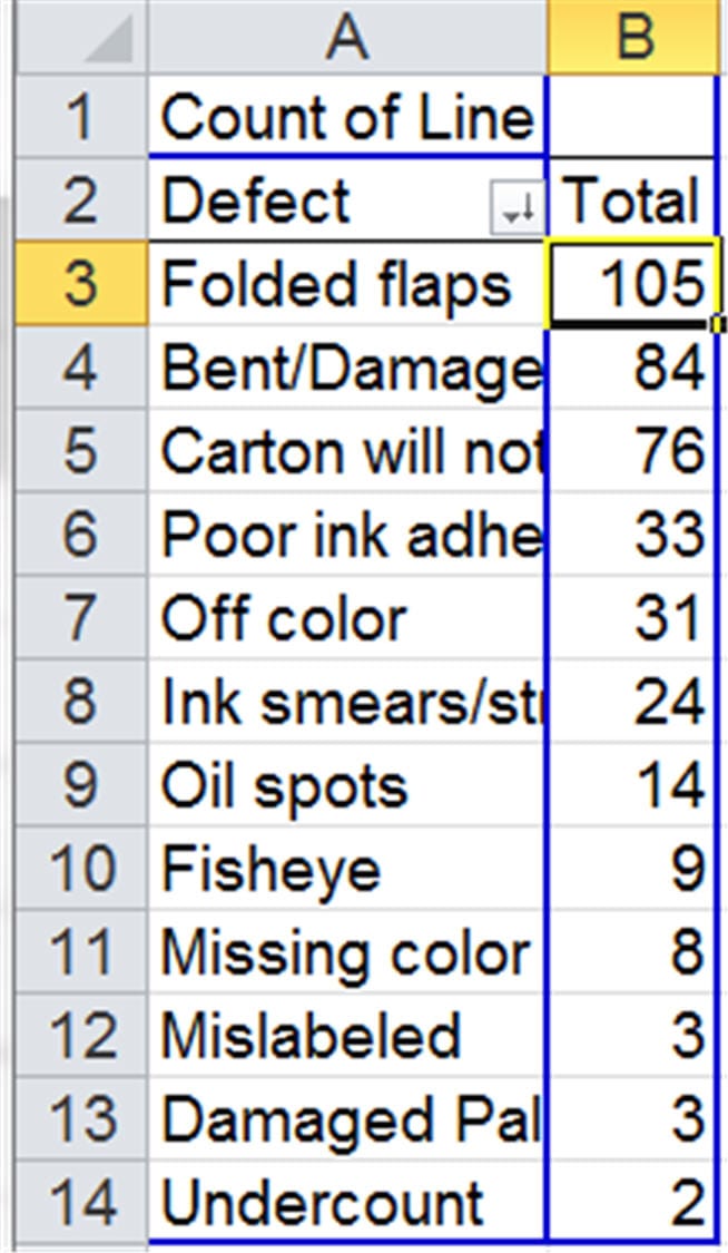

Using PivotTables, one can summarize the number of times each type of defect is found in packaging (Figure 4).
Which can then be turned into a high-level, 80-20 Rule Pareto Chart (Figure 5).

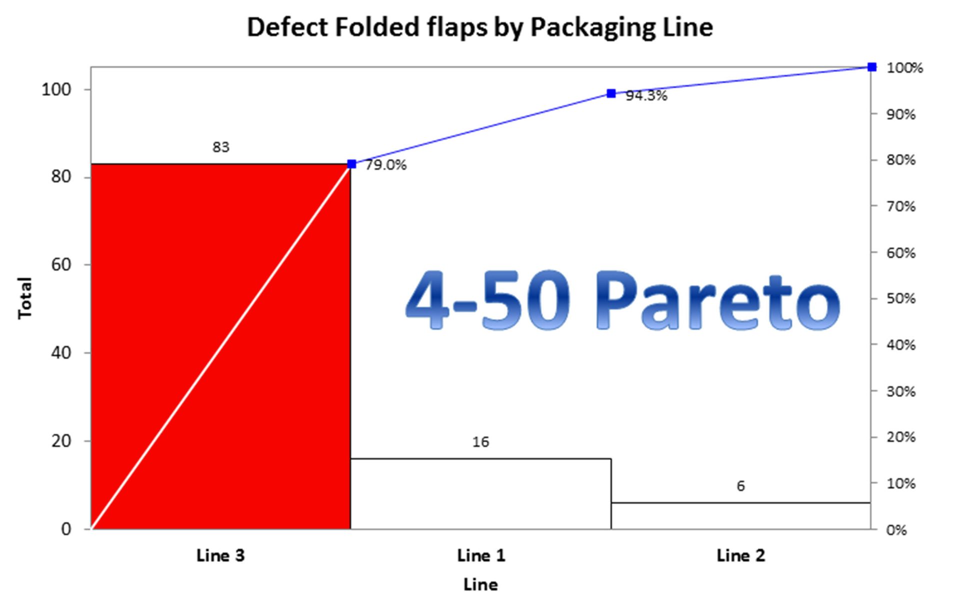

Pareto chart: Defect Folded flaps by Packaging Line. Line 3 (83 defects) accounts for 79%.

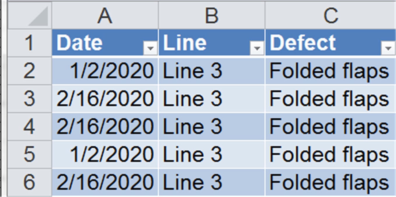

In Excel, if you double click on the 105 for Folded Flaps, Excel will pull all of the data behind that sum (Figure 6).

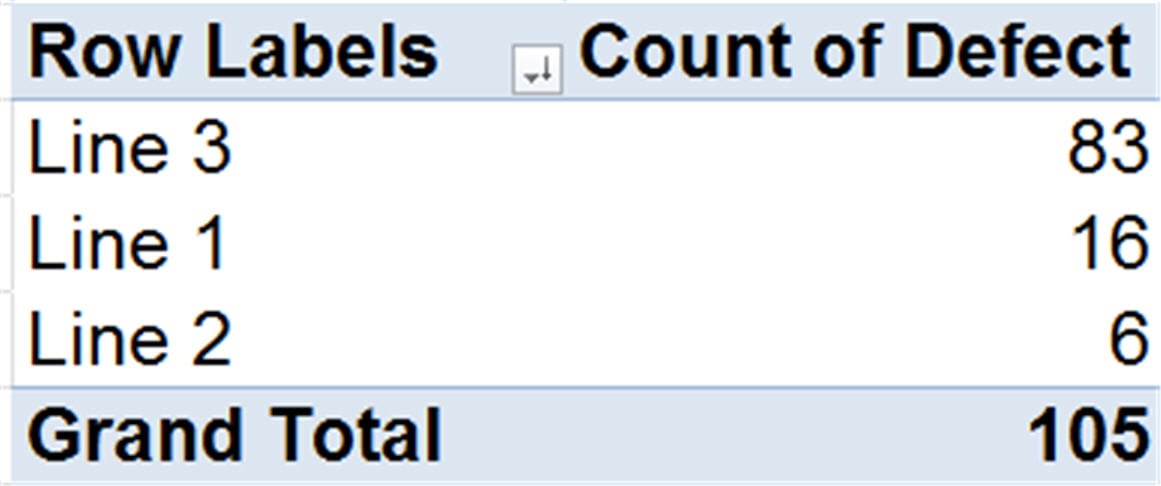

Then, we can use another PivotTable to summarize where the Folded Flaps defects are found (Figure 7) and create the 4-50 Rule Pareto chart (Figure 8).
Line 3 creates 79% of the Folded Flap defects. At this point, we know who should be on the root cause analysis team—people on Line 3 that know something about Folded Flap defects. We don’t need people from Line 1 or 2.

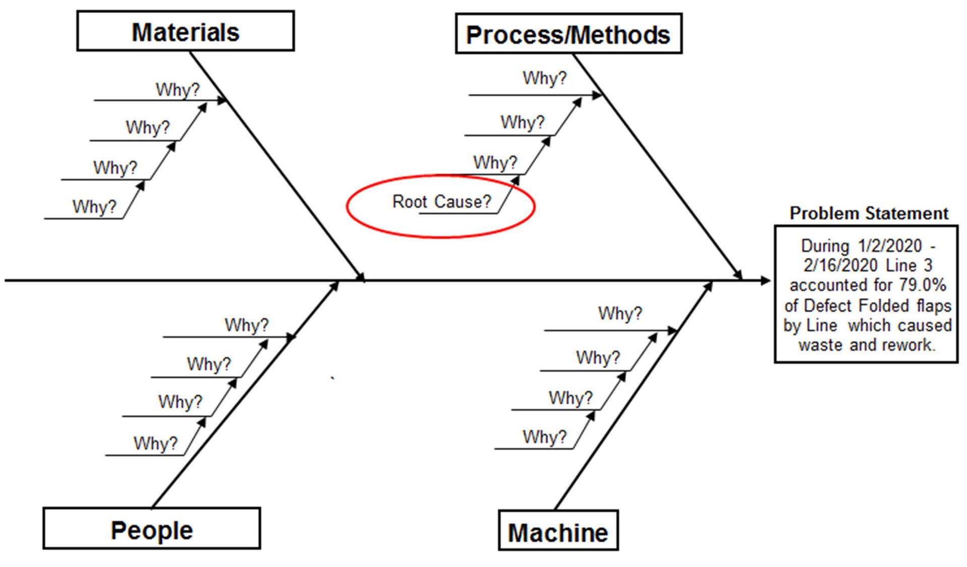

By narrowing the focus to the big bar on the 4-50 Rule Pareto chart, I have found that we often end up with a minnow-bone diagram (Figure 9), not a fishbone or whalebone diagram. This simplifies root cause analysis. It can often be done in an hour or two, not days. I have also found that whalebone diagramming is a sure sign that the problem hasn’t been laser-focused to the 4-50 Rule. Go back and drill down.
Fishbone diagram for root cause of 79% defected folded flaps on Line 3.
Figure 9.
It is also possible to drill down into the other two big bars on the 80-20 Rule Pareto chart—Bent/Damaged Flaps and Carton Will Not Open to tackle the other key problems in packaging. These three bars account for 67.6% of all packaging defects. Fix these and dramatic improvements in productivity and profitability are ensured.
