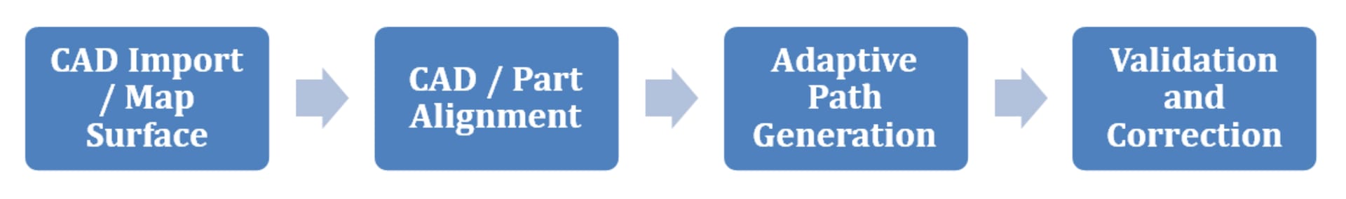

The adaptive process follows four main steps:
Advertisement for MAX Manufacturing & Automation eXchange 2026. Register at theMAXevent.com.
Flowchart of CAD data processing: Import, Alignment, Path Generation, Validation/Correction.
Fig 1. Adaptive scanning workflow diagram

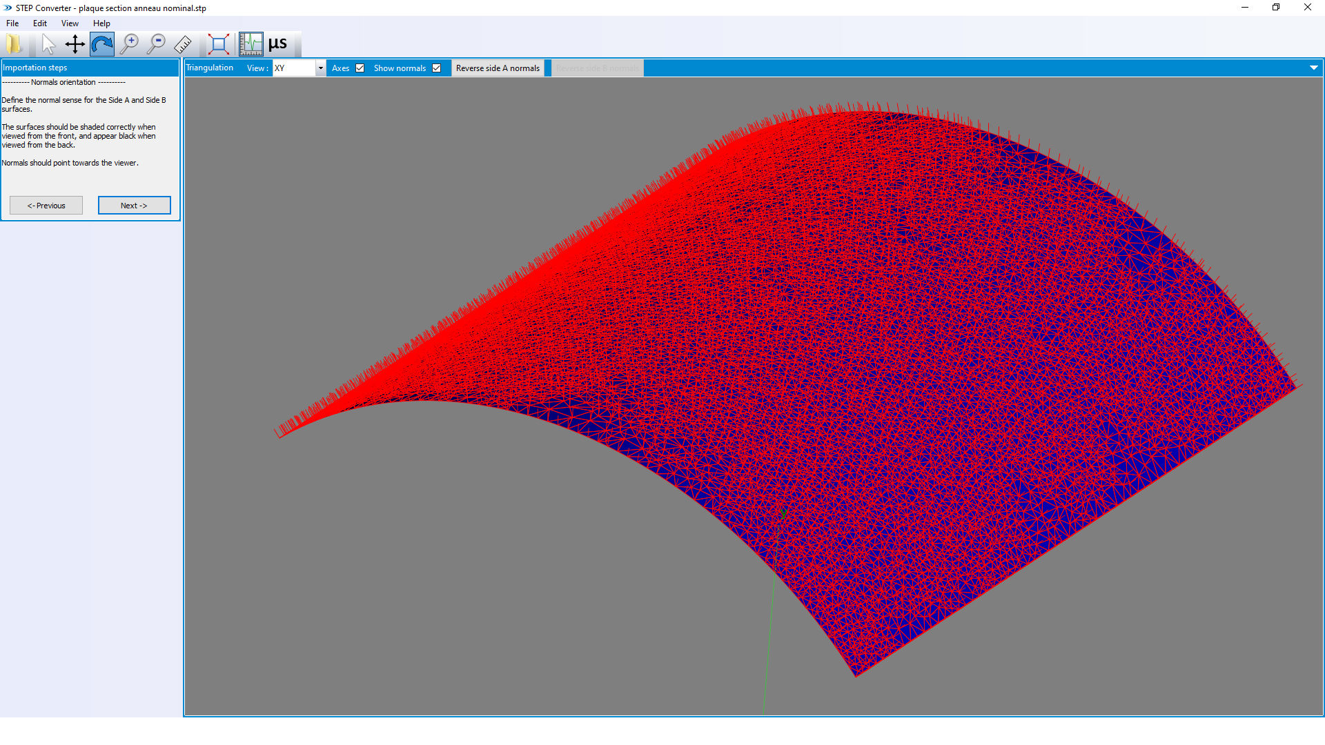

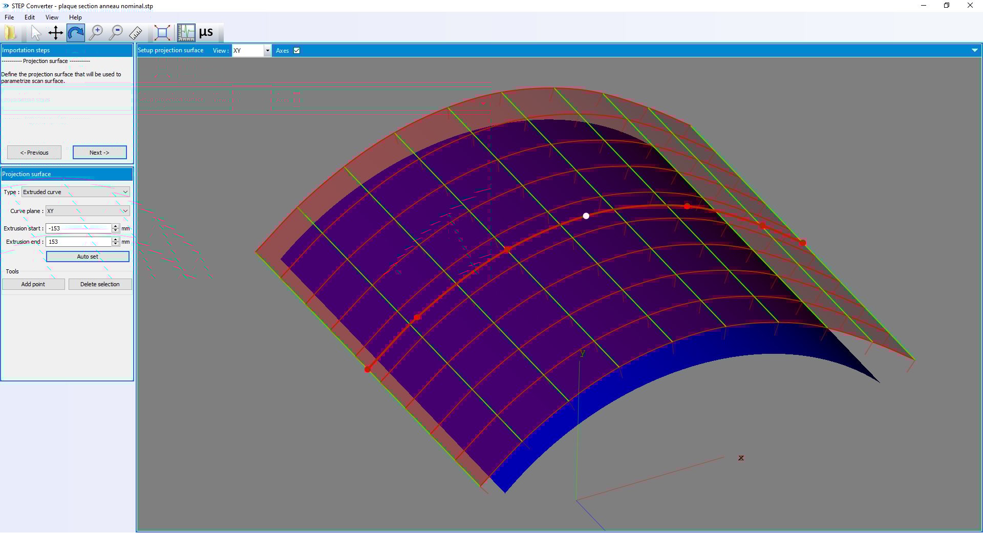

1. Surface / CAD Import: Using the scanner’s 3D control software, the CAD model of the inspected part is imported, forming a grid of points which is then interpolated and optimized to produce a smooth digital surface. Local surface normals and curvatures are computed, defining and optimizing how the ultrasonic probe should orient itself to remain perpendicular to the CAD surface while maintaining its stand-off distance. When no CAD data is available, a rapid surface-acquisition routine is performed to create the surface.
CAD software displaying a 3D curved surface with projection settings, grid, and control points.
Fig 2. imported Surface/CAD: import steps converted to scanning trajectories
STEP Converter displays a 3D blue, triangulated curved surface with red normal vectors. UI shows normal orientation.

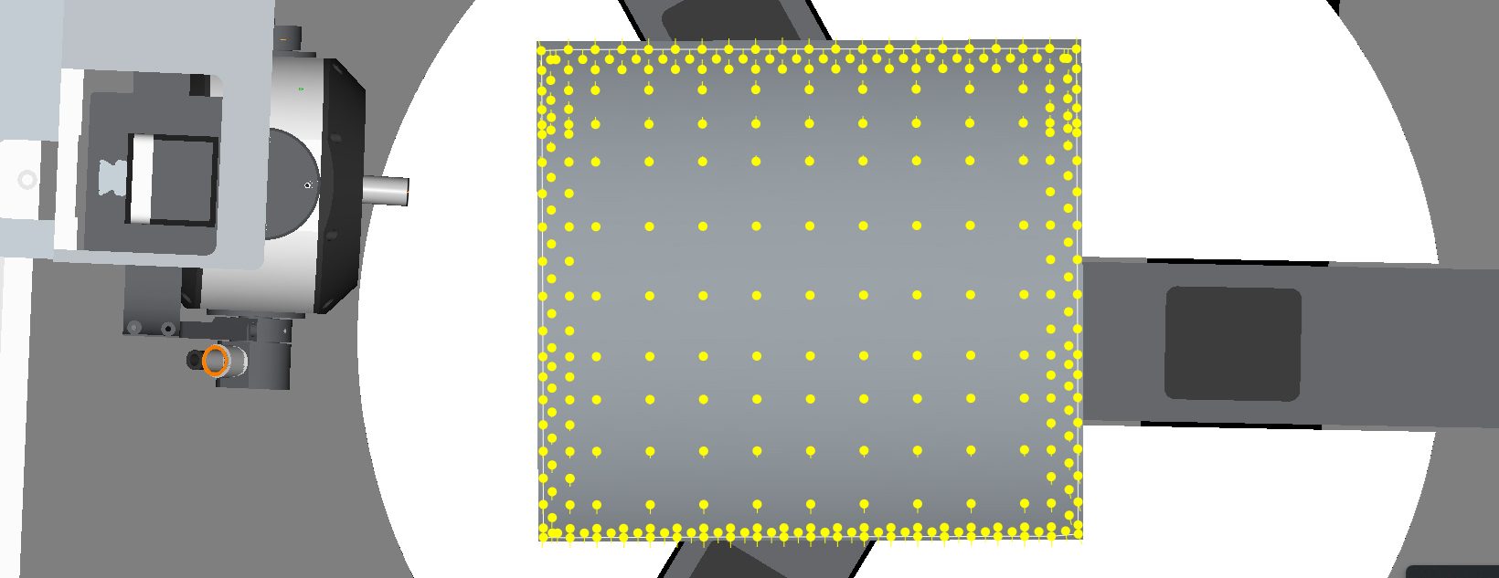

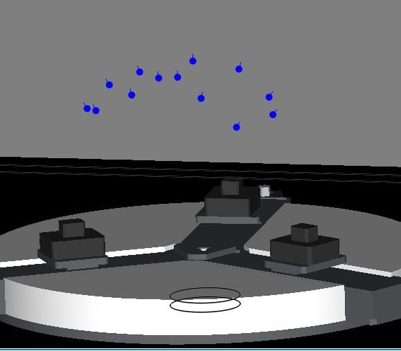

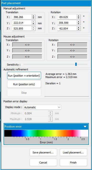

2. CAD / Part Alignment: To align an imported CAD model with a physical part, users can begin by teaching the part and generating a set of points representing sections of the geometry of the tested part. To ensure the good alignment, points located near the edges of the part are often excluded from the dataset, as these regions may contain distortions or measurement artefacts resulting from curvature or boundary effects.

Part placement dialog with manual & mouse adjustments, automatic refinement, and error visualization.

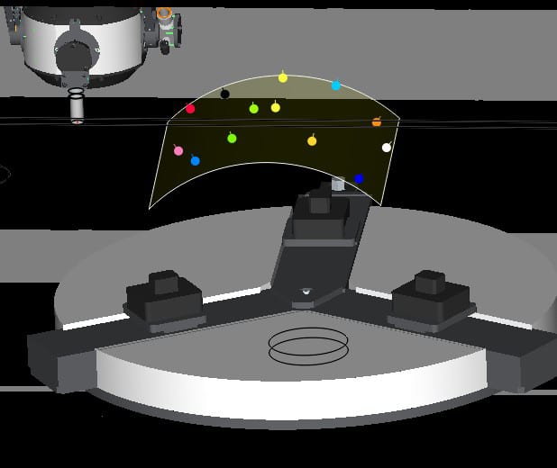

Fig.3 Positioning of a curved carbon composite part in the UT system
Subsequently, the 3D software performs interpolation and optimization of the digital surface, determining the appropriate path in accordance with the model’s curvature and aligning the component precisely with the computed CAD surfaces.
Robotic arm scanning a curved surface, displaying measurement points and tool paths in a CAD rendering.
Fig.4 Carbon fiber curved plate scan paths after alignment with its CAD model

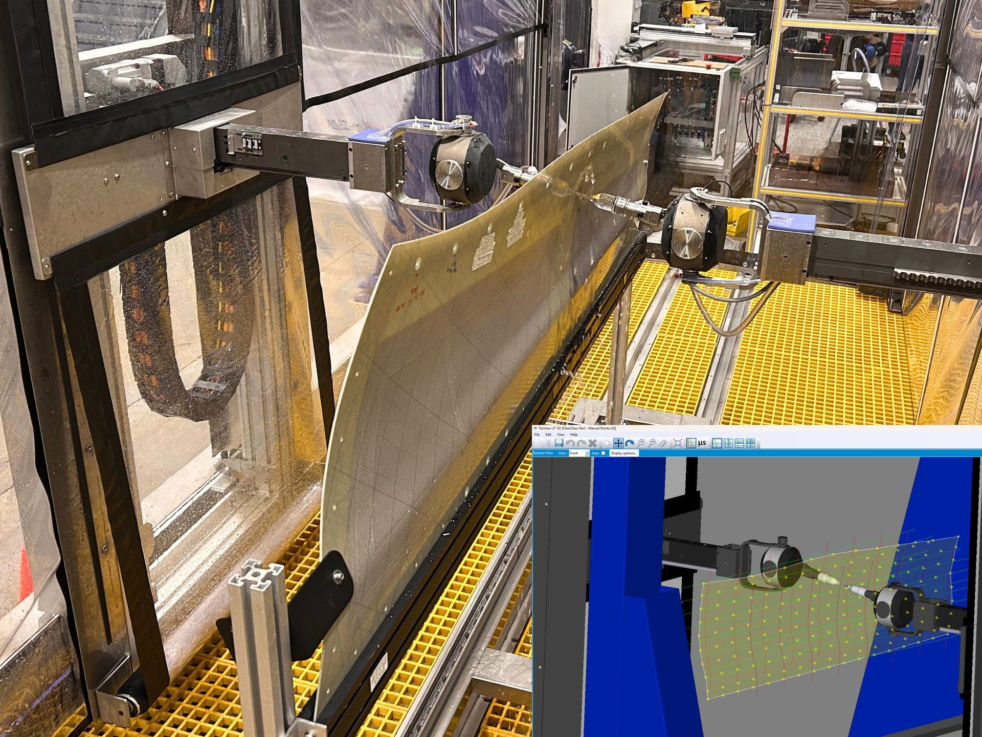

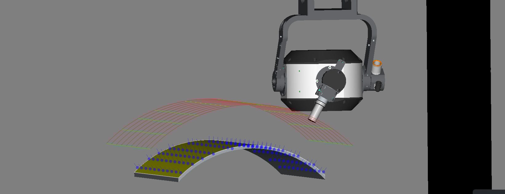

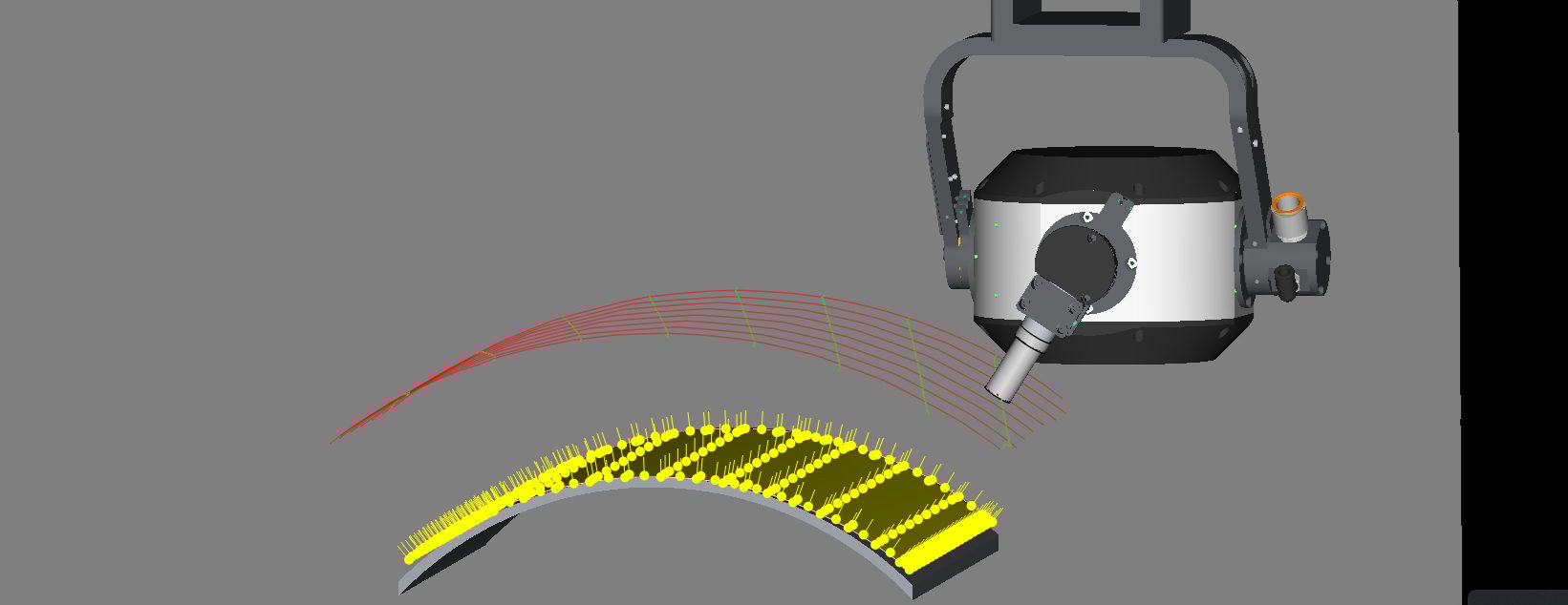

3. Adaptive Path Generation: If the CAD model from a preceding step does not accurately represent the actual part, signal losses may occur in regions where improper entry angles arise. To address localized or overall deviations from the nominal CAD geometry, the adaptive path generation process recalculates scan paths so that they precisely conform to the true contour of the inspected component. The procedure initiates with the automatic acquisition of reference points along a grid defined by the CAD file boundaries (as illustrated by the yellow dots in Fig. 5), each point being optimized automatically through probe angle adjustment; in the absence of a CAD file, this operation can also be performed manually.
Robotic arm with nozzle scanning a curved surface, showing red scan lines and yellow data points.
Fig.5 Reference point grid (above) and scan path (below) obtained for a carbon fiber curved plate using the Adaptative Scan Path tool
CAD rendering of mechanical components flanking a gray surface with a yellow dot grid.
Based on the reference points data, the software reconstructs a continuous 3D surface path and computes a parametric representation of its curvature. It then interpolates between the measured points to generate smooth and accurate scanning trajectories that maintain both the desired probe angle and constant stand-off distance.
4. Validation and Correction: Before scanning, the calculated adaptive path can be simulated in the 3D software to visualize the scanner axes trajectories and to confirm scanning trajectories, probe angle and constant stand-off distance stability. During inspection, amplitude feedback can fine-tune gain and validate the probe beam alignment in real time.

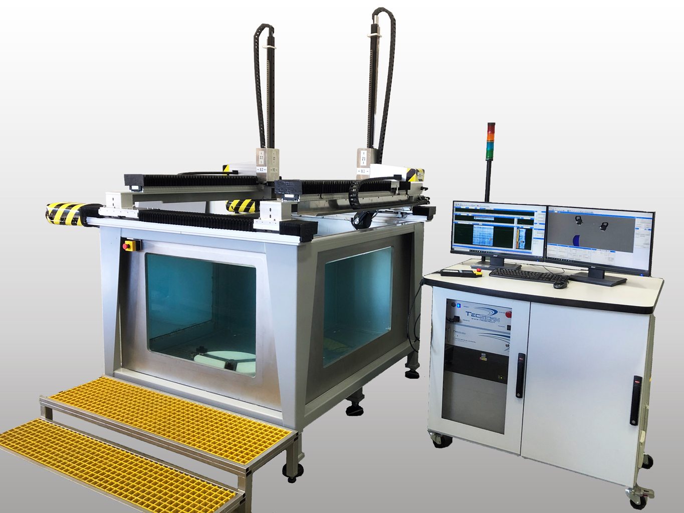

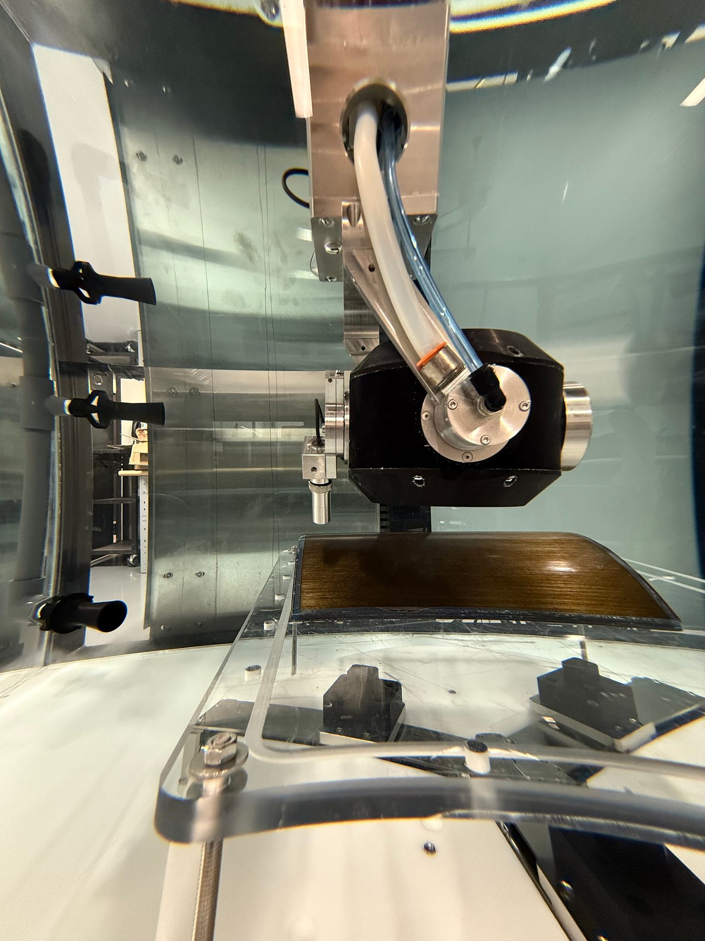

A comparative assessment was carried out on aircraft samples: one constructed from fiberglass featuring honeycomb sections, and the other from carbon fiber reinforced polymers (CFRP). The initial scanning procedures utilized a water gantry system, while subsequent tests were conducted in an ultrasonic immersion tank. Both platforms incorporated 3D scanning capabilities and specialized control software to evaluate the effectiveness of the developed adaptive scan path algorithm.
A TECScan industrial robotic inspection system with an overhead gantry, immersion tank, and dual-monitor control.
Fig. 6 Automated ultrasonic Gantry and immersion tank with 3D scanning capabilities and control software

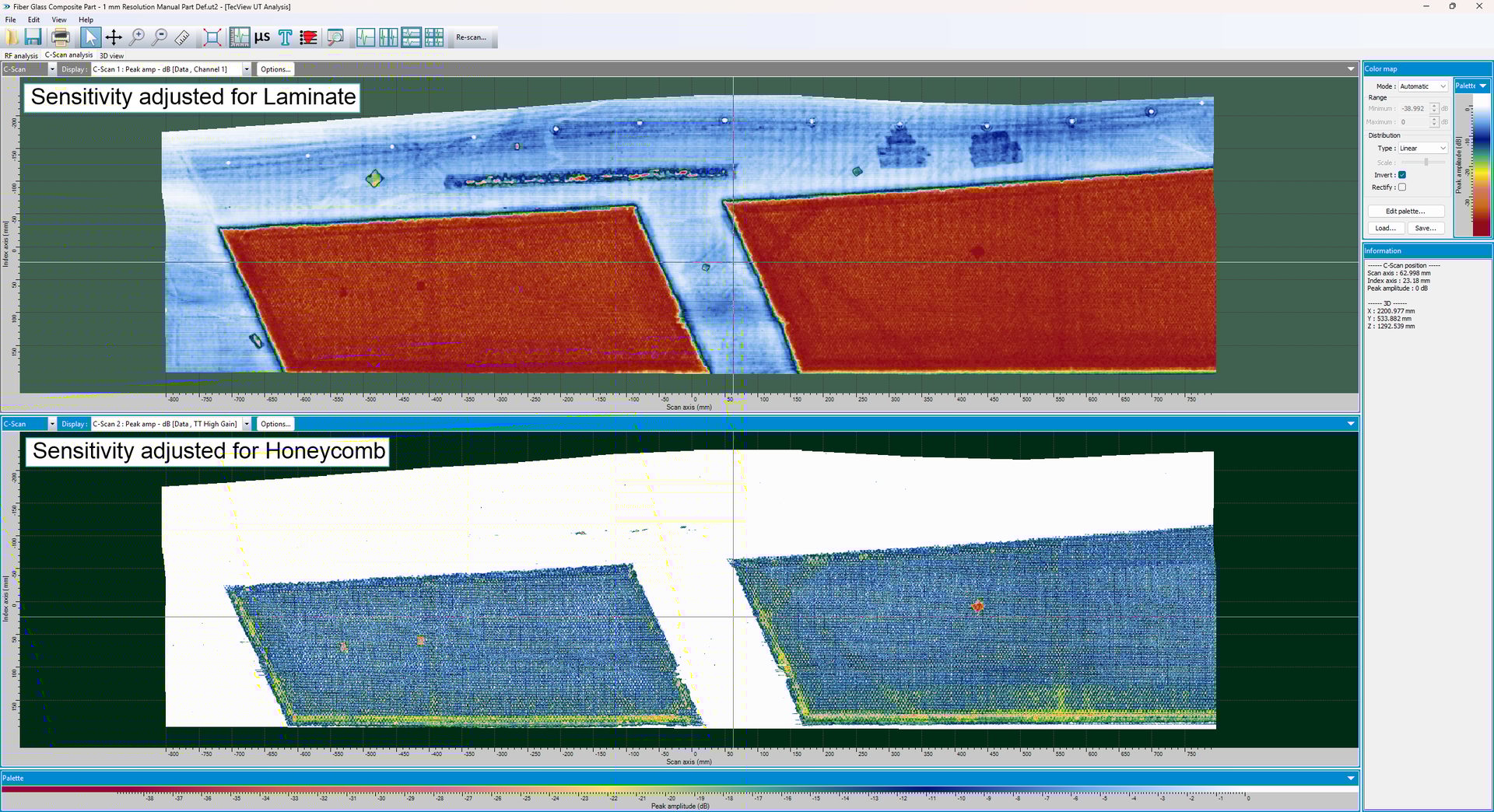

Figure 7 displays the C-Scan of the large fiberglass part featuring two honeycomb sections and multiple curvatures, scanned using the gantry system. As the CAD model was unavailable, the general geometry of the part was automatically mapped via a rapid surface-acquisition process, after which the adaptive scan path was employed for complete part scanning.
Two ultrasonic C-scans comparing laminate (top) and honeycomb (bottom) sensitivity settings.
Fig.7. C-Scan of front wall signals of large composite component using surface-acquisition map
The obtained C-Scans are representations of the amplitude of signals transmitted through the part, collected from separate transmission channels, with sensitivity adjusted for both the laminate (top) and honeycomb (bottom) regions. Employing the adaptive scan path made it possible to scan this complex component while ensuring a consistent response across both laminate and honeycomb sections, a result unattainable with simple scan patterns.

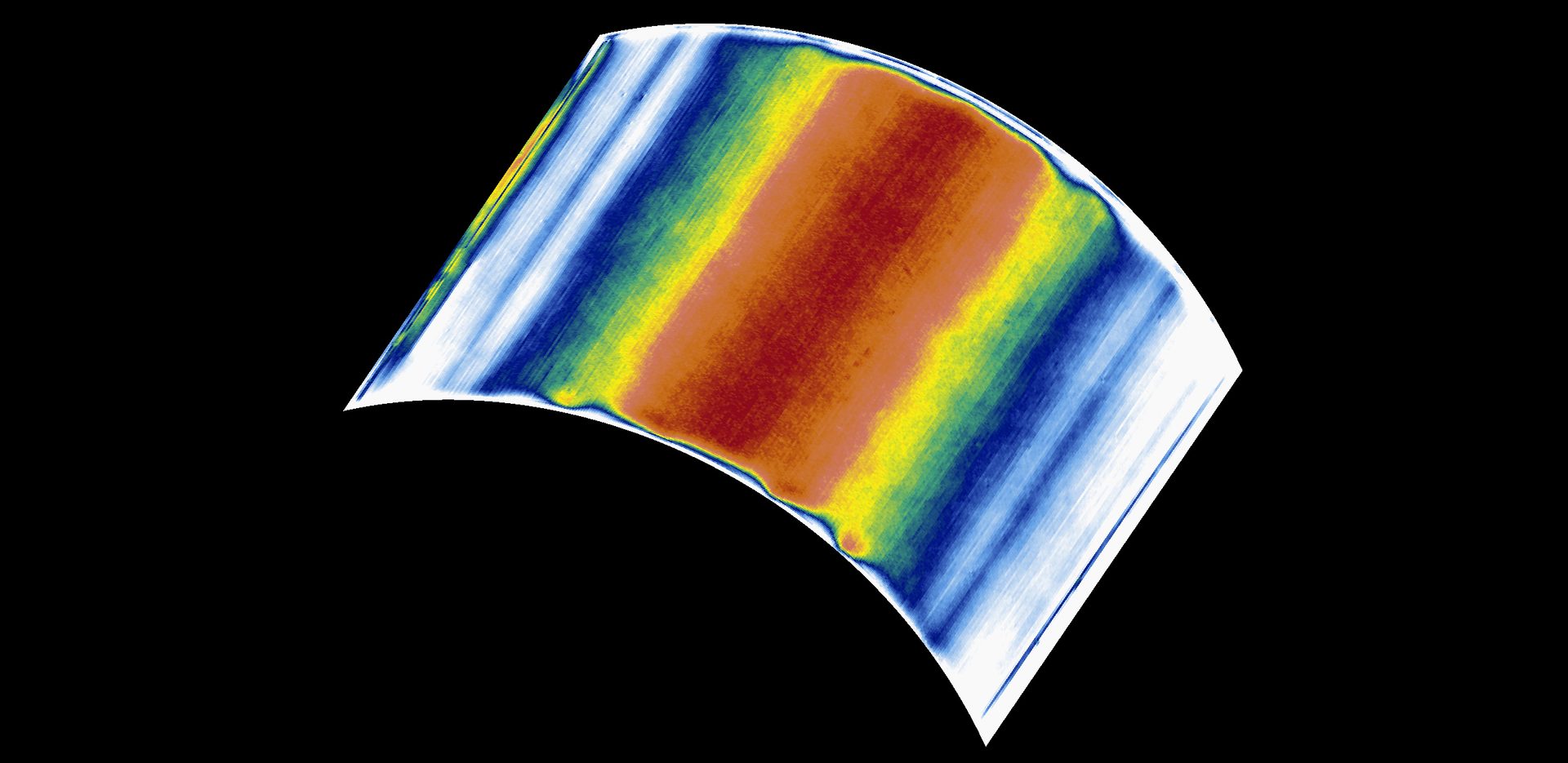

The second series of tests were conducted on a curved composite part in an immersion tank using the 3D control software. Figure 8 presents the part C-Scan of the front wall signal for the first scenario, where trajectories were based on the imported CAD model of the part. In the C-Scan results, we can see the edge imperfections and overall deformation after curing, which caused deviations from the CAD model. Comparing front wall signal amplitudes between scans, a consistent amplitude along the C-Scan would be expected on such a smooth surface if the scan accurately follows it. However, the surface echo C-Scan obtained using the imported CAD-based trajectories shows a 23.18 dB variation for the top 95% of recorded amplitude values, indicating significant inconsistency.

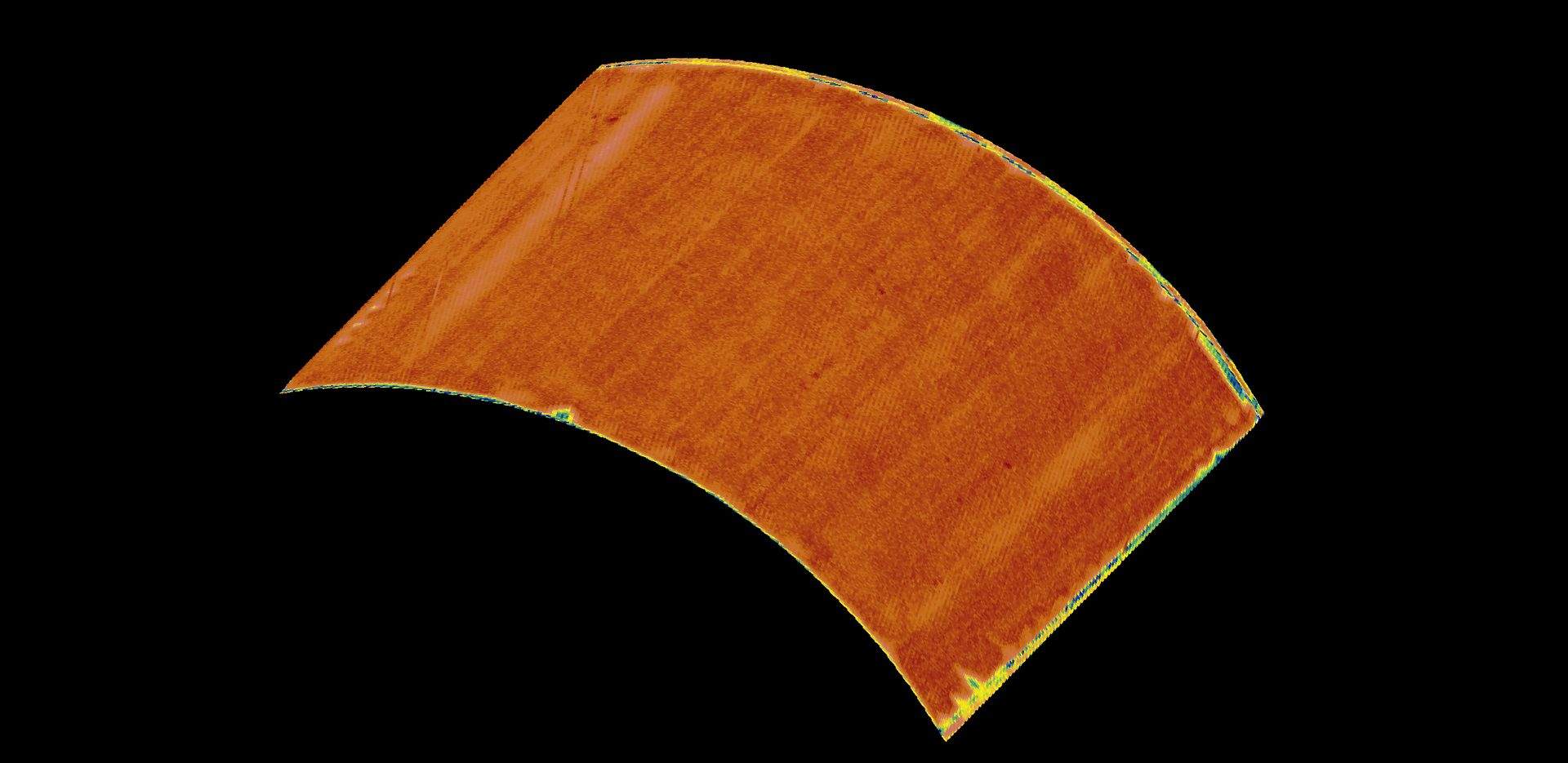

Using the same ultrasonic parameters as pervious scan, the same part was later scanned utilizing the adaptive scan path algorithm. As illustrated in Figure 9, the C-scan data obtained after generating new paths showed improved front echo stability, with total variation measured at 1.86 dB among the top 95% of the highest amplitude values.

The results indicate that while the CAD-based scan path exhibits strong performance at the central region of the component, it experiences significant signal degradation towards the periphery. Conversely, the adaptive scan path demonstrates consistent amplitude across nearly the entire surface.
Maintaining a stable front surface echo amplitude is essential for effective inspection, as it reflects precise control over the ultrasonic beam entry angle. This aspect is especially critical when evaluating porosity in composite materials or detecting flaws based on amplitude within a material, since both processes are highly sensitive to uncontrolled variations in signal amplitude.
