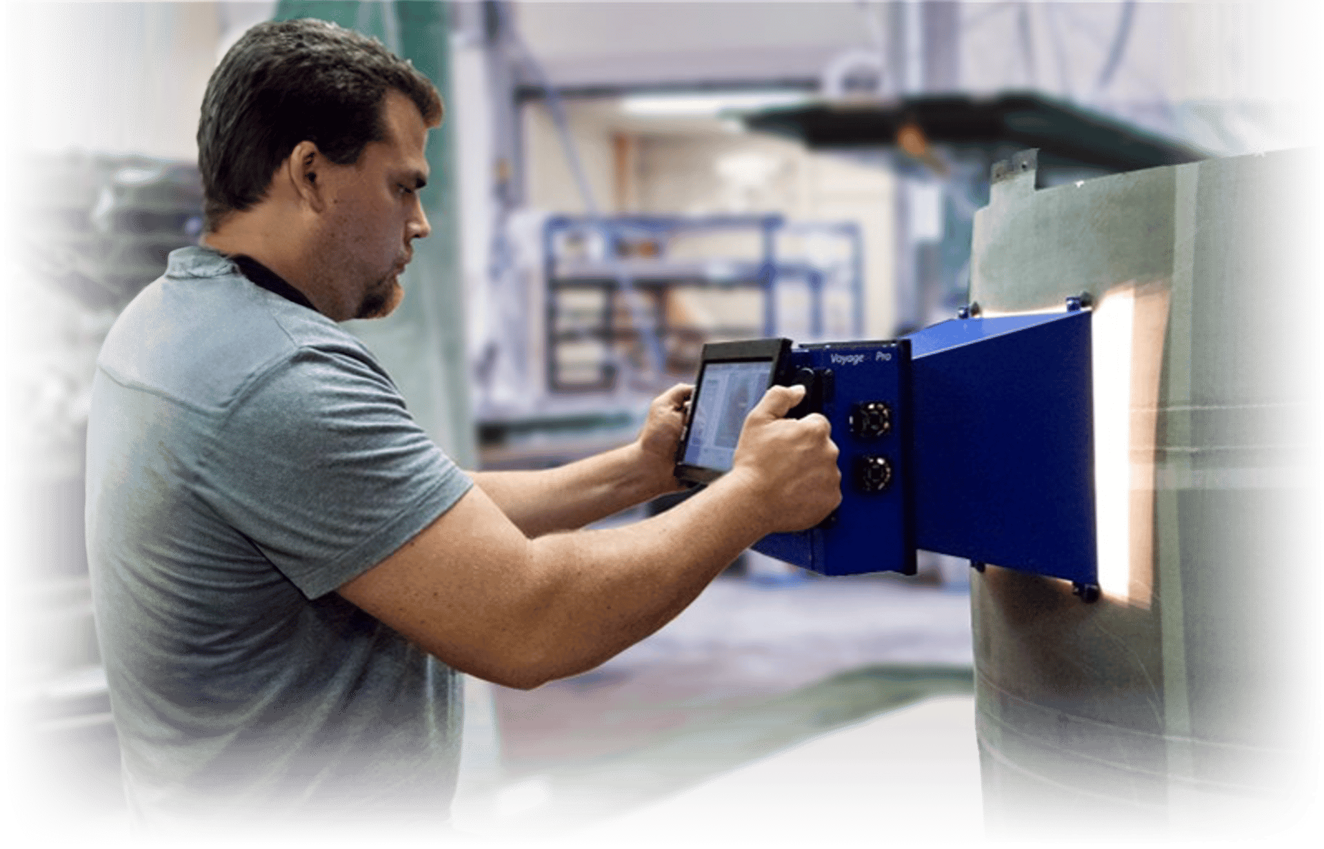

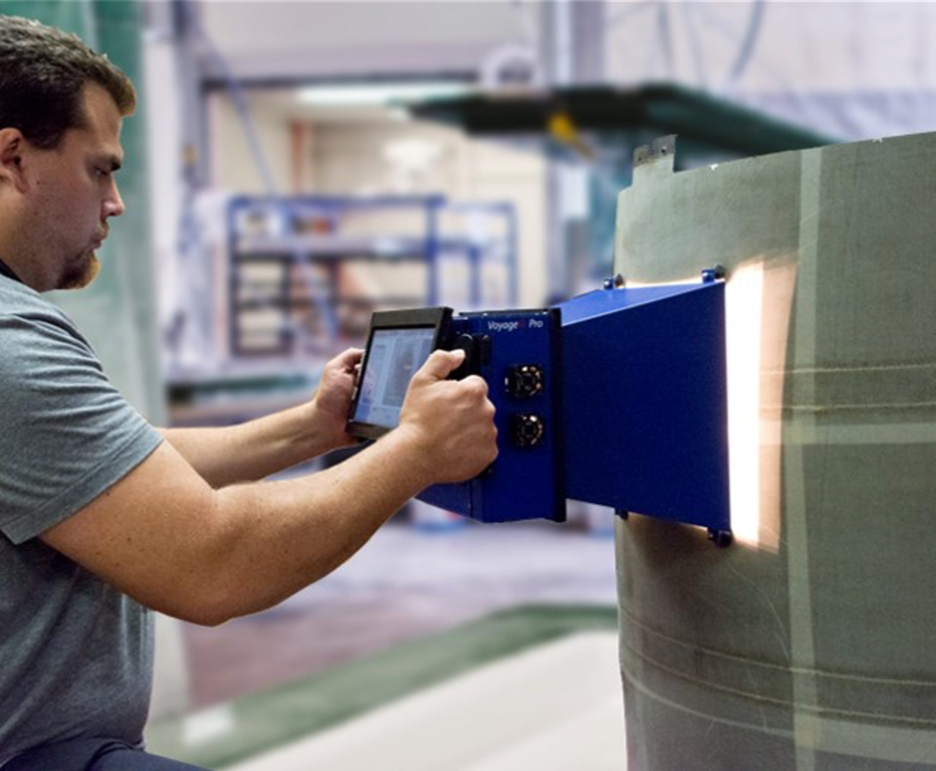

1-	An Active Thermography system combines an IR camera that measures surface temperature with excitation and processing components to detect subsurface defects. Modern systems (right) integrate all functions into a single handheld unit.
An Active Thermography system combines an IR camera that measures surface temperature with excitation and processing components to detect subsurface defects. Modern systems (image at top of story) integrate all functions into a single handheld unit.

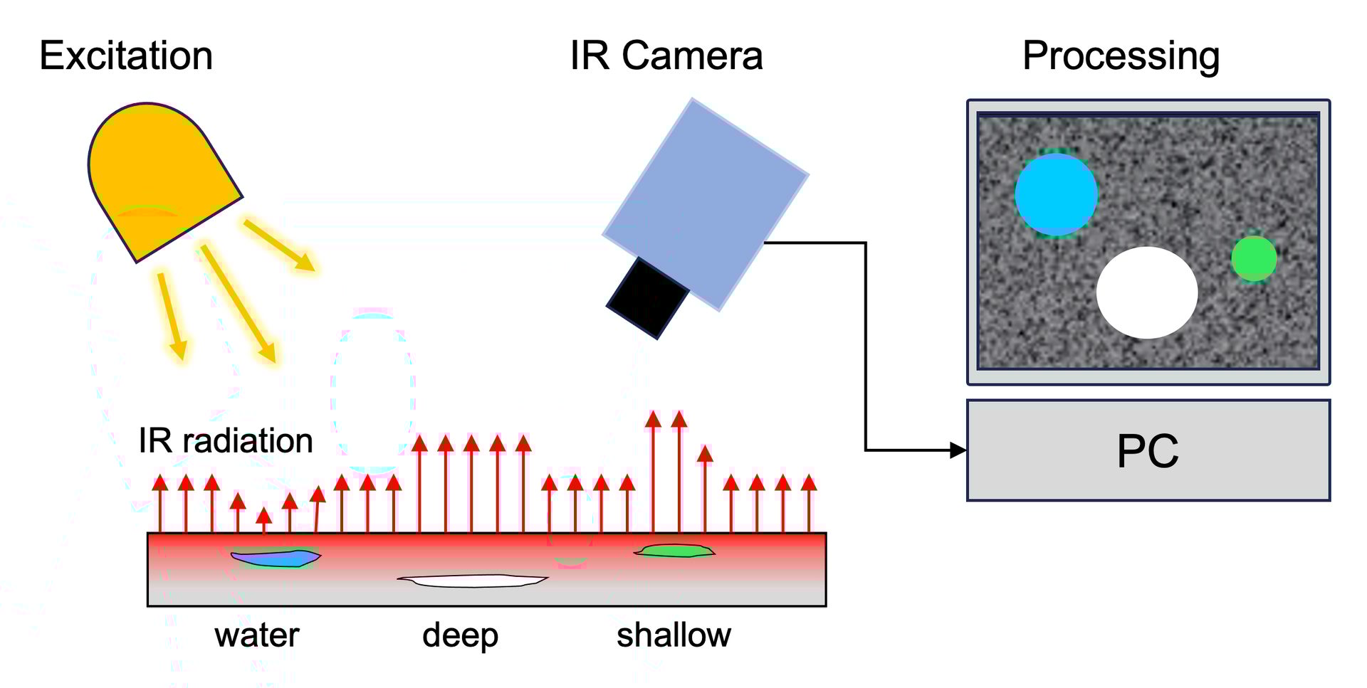

Used alone, an IR camera has limited utility for QC / NDT applications. In addition to the IR camera, which measures the surface temperature of the part, detection, measurement or characterization of subsurface defects or material properties requires thermal excitation of the part under test, as well as processing and analysis of the image output data from the IR camera. Taken together, excitation, temperature measurement, and processing functions comprise an AT system, which can be as simple as a human inspector using a handheld IR camera and heat gun or even the sun and his/her eye, brain and experience to interpret the camera images to find water trapped in an aircraft control structure, or as complex as the fully automated flash thermography systems used to test spot welds, measure coating thickness or evaluate solar cells in modern manufacturing. For reliable and accurate AT results, it is essential that each of these system functions are appropriate for a particular application, and that they function properly individually, and together as a system.
Excitation: A transient thermal excitation is uniformly applied to the surface of a part using light, forced air, direct contact or electromagnetic radiation. The excitation may be a brief pulse from a flashlamp or laser that lasts for a few milliseconds or less, or a longer one lasting several seconds from a heat lamp or hot air gun. The excitation may also be modulated or scanned across the surface of the part, either in close proximity or at a standoff distance of several feet. Optical sources are most widely used in industry as they are relatively easy to control spatially and temporally. For a particular application, the source must couple effectively (e.g. be absorbed, and not reflected) and operate on an appropriate time scale. As an example, heat transfer in an aluminum part occurs in milliseconds, appropriate for a flash or pulsed laser source. However, in the same part in fiberglass, heat travels the same distance in several seconds, so that a heat lamp could be used effectively.
Temperature Measurement: An IR camera measures IR radiation from the surface of an object, which is a function of its temperature. It does not “see through” most industrial materials, but it can be used to infer subsurface structure when it is used with a thermal excitation source to heat the surface of a sample. Cameras vary in sensitivity (usually expressed as Noise Equivalent Temperature Difference, or NETD), wavelength range, frame rate and the number of pixels in the focal place array sensor. The “best” camera for a particular application is one where the wavelength is sensitive to temperature change in the material of interest, the frame rate is high enough to capture the cooling response to the stimulation being used, and the pixel density is sufficient to detect the minimum required defect size. Uncooled microbolometer cameras are small, inexpensive low-maintenance devices that operate in the 8-14 mm spectral range. They measure the change in resistance as IR radiation is absorbed by an array of small sensors, which is then correlated to temperature. However, measurement or detection of deeper, or subtler, defects may require the greater sensitivity of larger, cryogenically cooled cameras, which are quantum devices that collect incident IR photons, operating in either the 2-5 or 8-14 mm range.
Processing / Analysis: Modern AT systems use a dedicated PC to process data from the IR camera and present it in a format where it can be analyzed by an inspector or automatically with additional software. Widely used processing approaches techniques (Thermographic Signal Reconstruction, Principal Component, and Pulse Phase) analysis all provide consistent, repeatable results with significantly greater sensitivity than unprocessed images from the IR camera. In most cases, the techniques offer similar performance, however they may vary in terms of processing time, quantitative measurement capability and ease of interpretation.

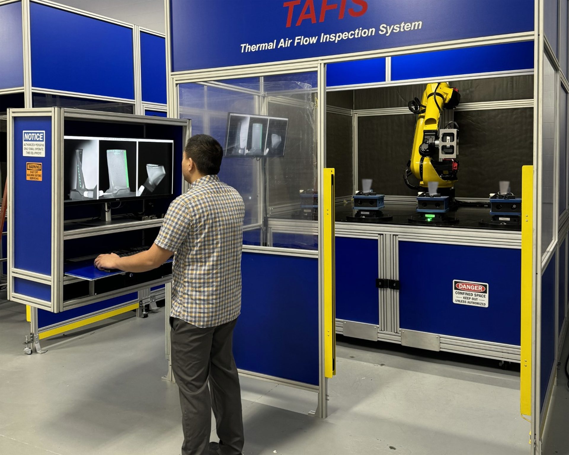

Technology, Machine
An operator reviews results of an automated AT inspection of aircraft turbine blades.

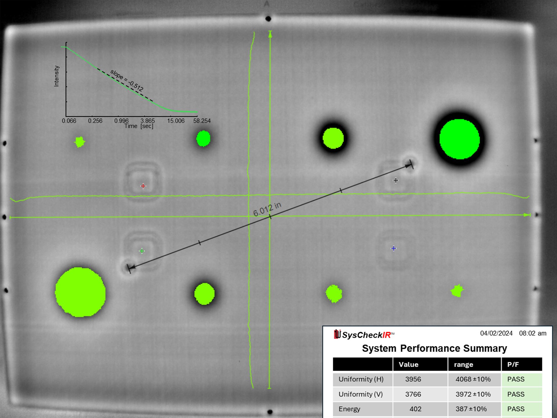

3-	A System Performance Validation (SPV) kit uses an engineered reference sample and software installed on the AT system to provide a daily summary of critical system parameters.

One recent answer has been the use of a System Performance Validation (SPV) kit, which incorporates a reference sample and dedicated software for use with the AT system. Unlike an NDT reference standard, which is constructed to mimic a particular defect or condition (e.g. void, crack, inclusion), the validation standard is engineered to allow measurement of specific AT system performance metrics that should remain invariant for a properly functioning system. Ideally, the baseline settings for acceptable performance are established by the manufacturer or during initial acceptance of the AT system. The SPV test, which requires only one to two minutes, would be run daily, or at the beginning of every shift, generating a report grading the state of all critical system functions as PASS or FAIL, with a numerical value indicating where they fall relative to the acceptance range. Daily reports may be logged so that system performance can be tracked over time and maintenance (e.g. replacement of lamps, camera calibration) can be scheduled without interruption of normal production.
