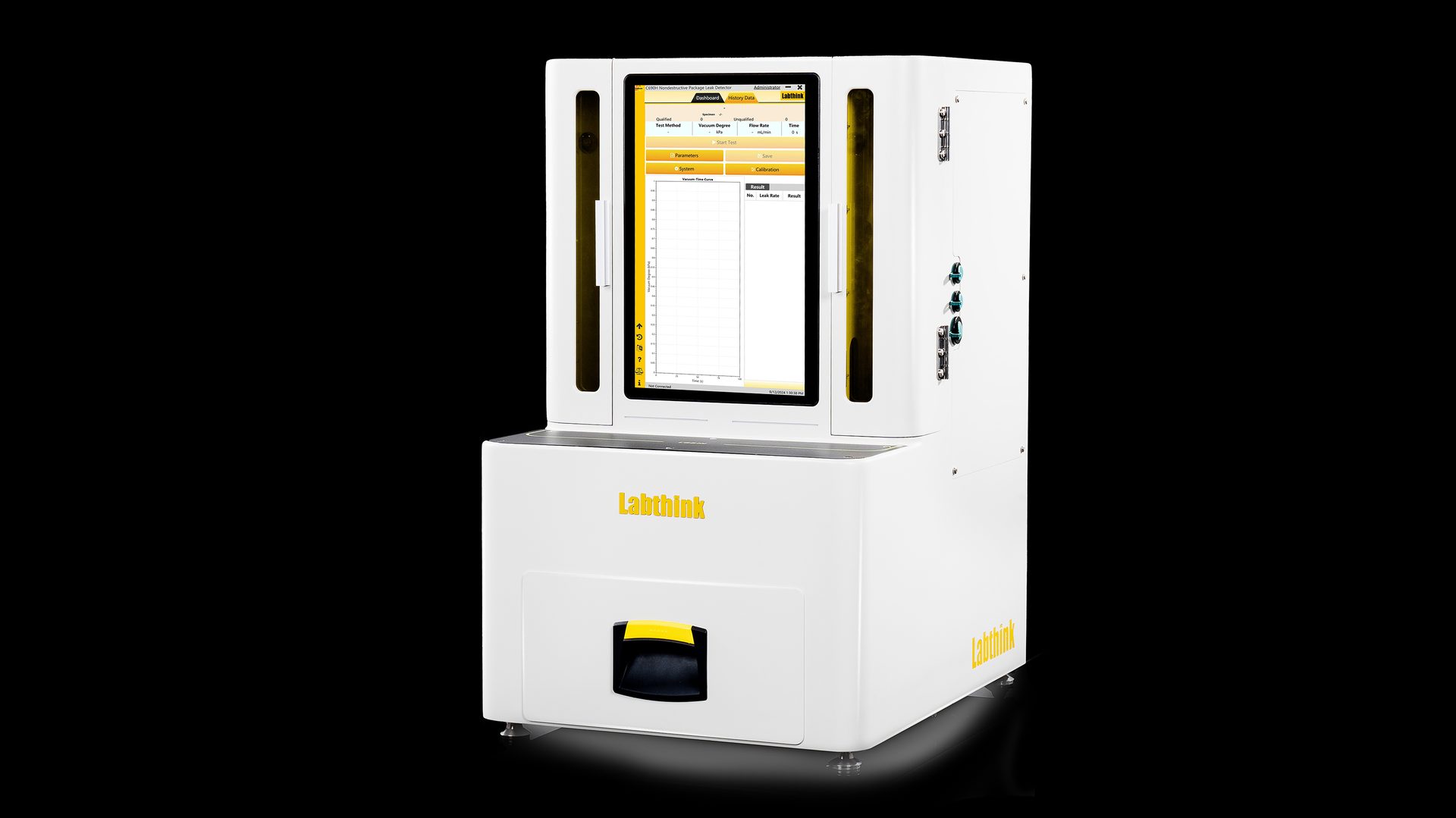

Labthink’s brand new automated vial batch leak tester. Leaking vials are automatically segregated for further inspection.

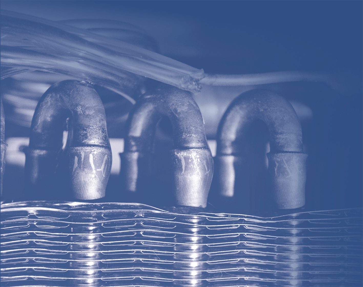

In the HVAC sector, robotics are transforming testing processes. The complexity of modern HVAC systems, with their numerous connection points and seals, demands increasingly sophisticated testing methods. “In HVAC, emphasis is on robotic leak testing using automated sniffer probes. HVAC products have an exceptional number of joints, and ensuring each is leak tested is critical,” says Thomas Parker, automotive leak testing sales manager at INFICON. “We see an increase in the use of forming gas for sniffing applications.”

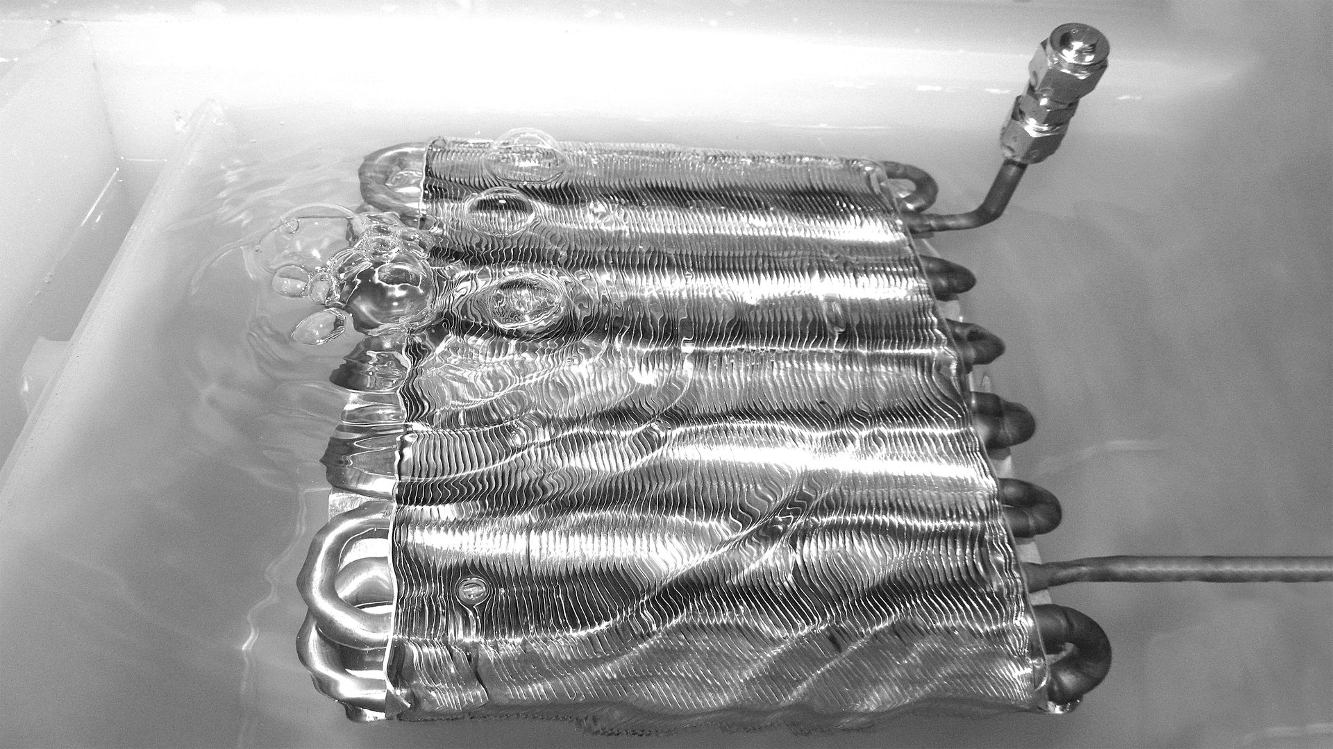

HVAC/R systems are composed of multiple parts and pieces, each requiring validation prior to comprehensive system leak testing to ensure product quality and durability. Source: Inficon
Once an industry standard for leak detection for welded steel fuel tanks, dunk tanks are insufficient for discovering emissions in a timely and well-documented manner and cannot deliver operator-independent inspection at modern line speeds. Source: Inficon

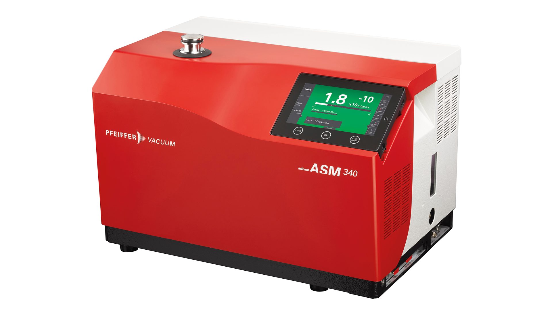

Multipurpose helium/hydrogen leak detector. Source: Pfeiffer-Vacuum

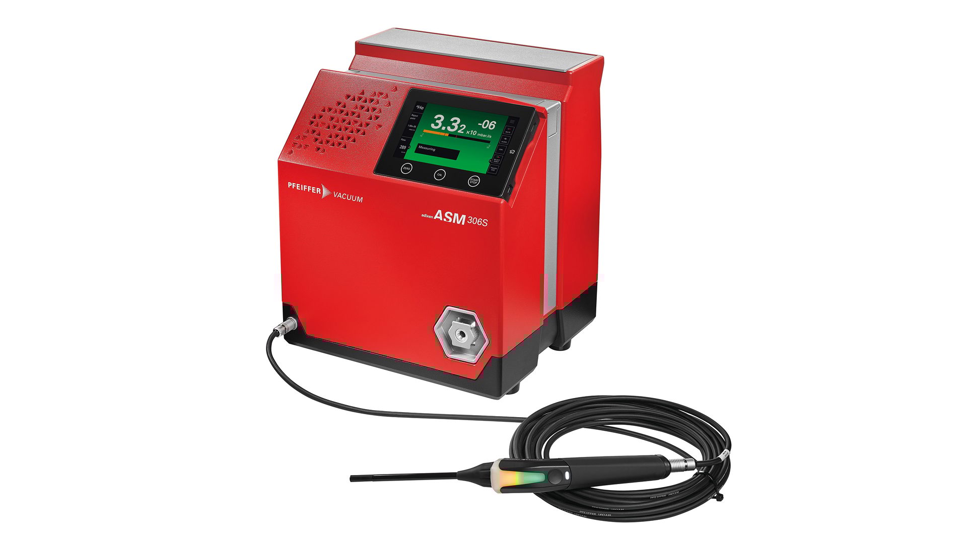

Sniffer leak detector that can detect helium or hydrogen. Source: Pfeiffer-Vacuum

Opening Image: Labthink’s brand new automated vial batch leak tester. Leaking vials are automatically segregated for further inspection. Source: Labthink
