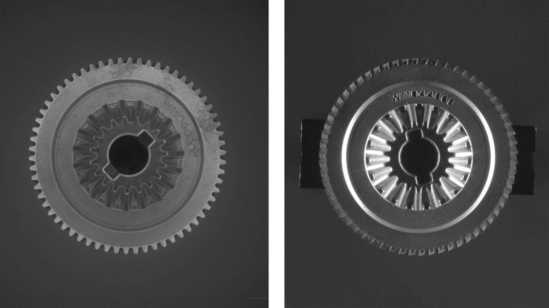

Different types of machine vision applications require different lighting setups. An optimal lighting setup must highlight the features to be detected relative to the background and must help create repeatable images regardless of part or product variation. Figure 1, for example, shows the same part with two different lighting setups. On the left, is a “good” image of a beveled gear captured with a dark field ring light, while the image on the right shows an image captured with a linear dark field setup, which produced linear effects on two sides of the gear. The image on the left shows sufficient contrast, allowing the software to clearly see teeth of the gear, along with the character printed directly on the part.
Figure 1: The image on the left uses a ring light dark field implementation while the image on the right shows a linear darkfield setup, which does not produce sufficient contrast needed for a machine vision system.

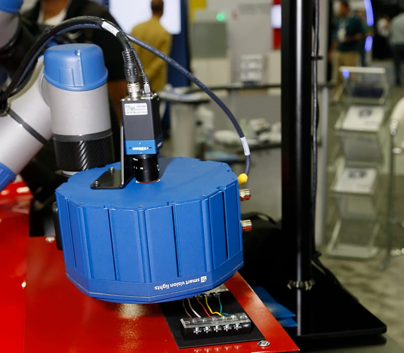

More complex or specialized machine vision systems also require specific lighting implementations. For example, flexible cobot-based inspections can use a multi-functional light to avoid having to change over lights in between inspection types (Figure 2), while food inspection applications may require shortwave infrared, washdown lights, or both. No matter the application, all machine vision systems require proper lighting, including deep learning.
: A multifunctional lighting unit attached to a machine vision camera performs an inspection during a tradeshow demonstration.
Figure 2: A multifunctional lighting unit attached to a machine vision camera performs an inspection during a tradeshow demonstration.

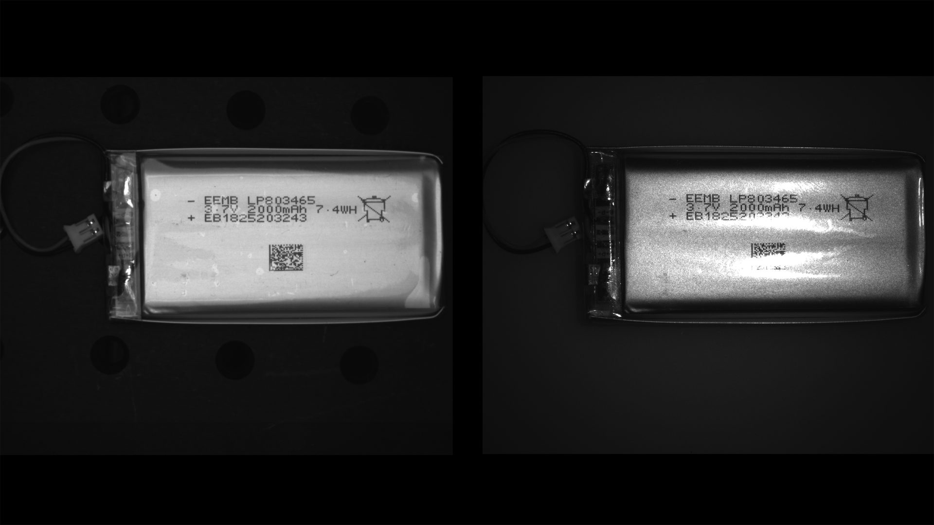

Deep learning today is a powerful tool that has found success in many machine vision applications. The technology can help fill the gap where rules-based algorithms cannot suffice, in areas including optical character recognition, assembly verification, image classification, defect detection, and more. Finding success in a deep learning application involves a thorough application analysis and proper system setup. It is said that if just 10% of the data in a deep learning model is inaccurate, optimizing the model after the fact involves three times more data. It is critically important, as a result, to ensure that a data set comprised of high-quality images is used to program the model. As a result, once again, an optimal lighting setup is required.
Figure 3: A dome light implementation (left) provides ample contrast for the system to identify and read characters clearly printed on a battery, while a spotlight setup (right) created reflections and glare that would be unusable by the machine vision system.
Incorrect lighting puts the reliability and success of a system at risk, and machine vision cameras and software algorithms cannot make up for inadequate illumination techniques in any type of application, even deep learning. Cliché as it may be by now, “garbage in, garbage out” still rings true. If you expect to train a deep learning model on bad images, the deep learning solution will not work. Simply relying on ambient illumination and not matching the correct lighting setup to the application can lead to light pollution, poor quality images, and the “garbage” referred to in the popular adage.

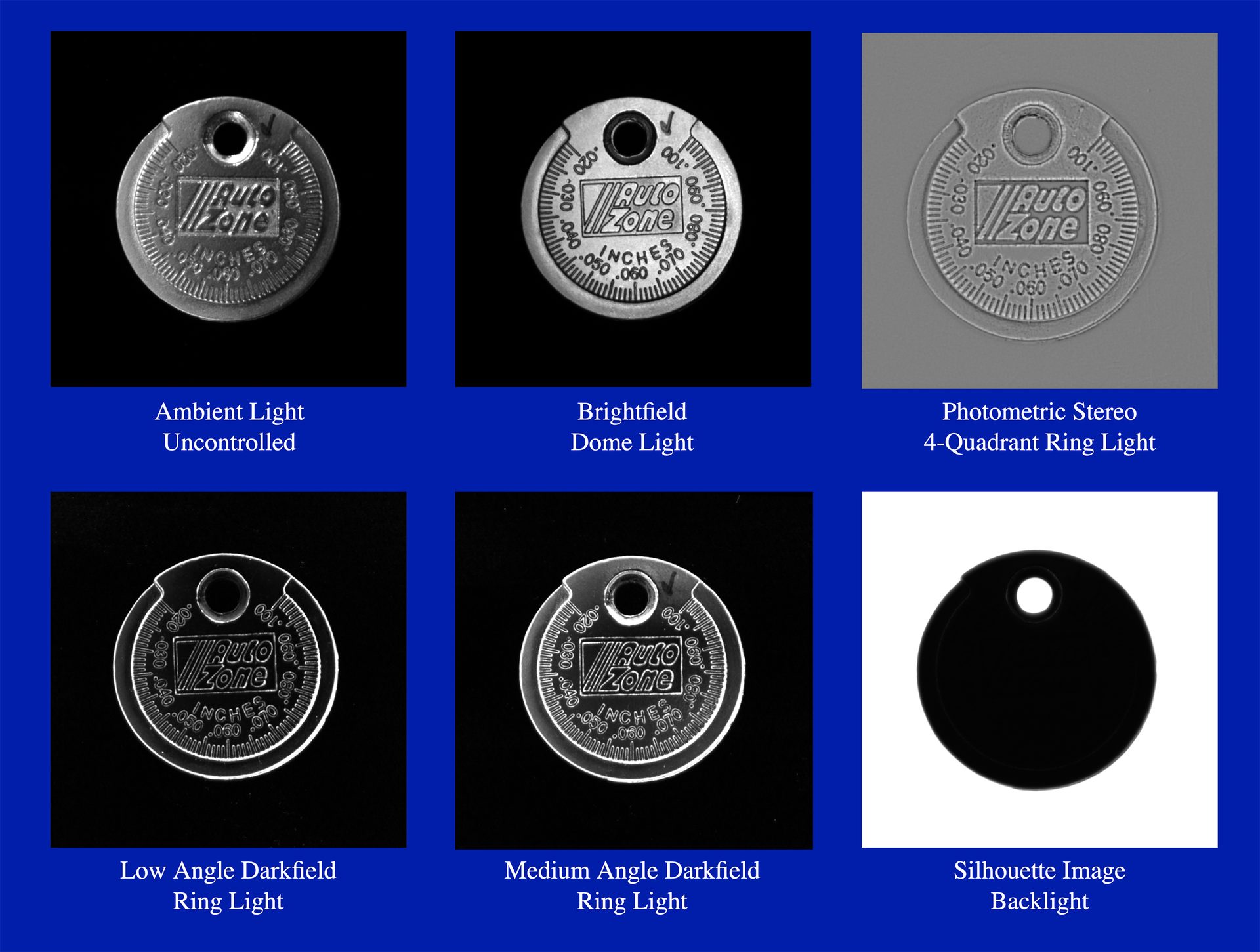

Ultimately, different light means different images. Figure 4 shows the same spark plug gap tool, but with different lighting setups: front lighting, diffuse lighting, bright field lighting, dark field lighting, low angle dark field lighting, and backlighting. While the backlight image works great for measuring the diameter of the tool, for example, this would be virtually unusable for a surface defect detection application.
Figure 4: Choose the machine vision lighting implementation that best shows the features that must be inspected. Different lighting = difference results.
