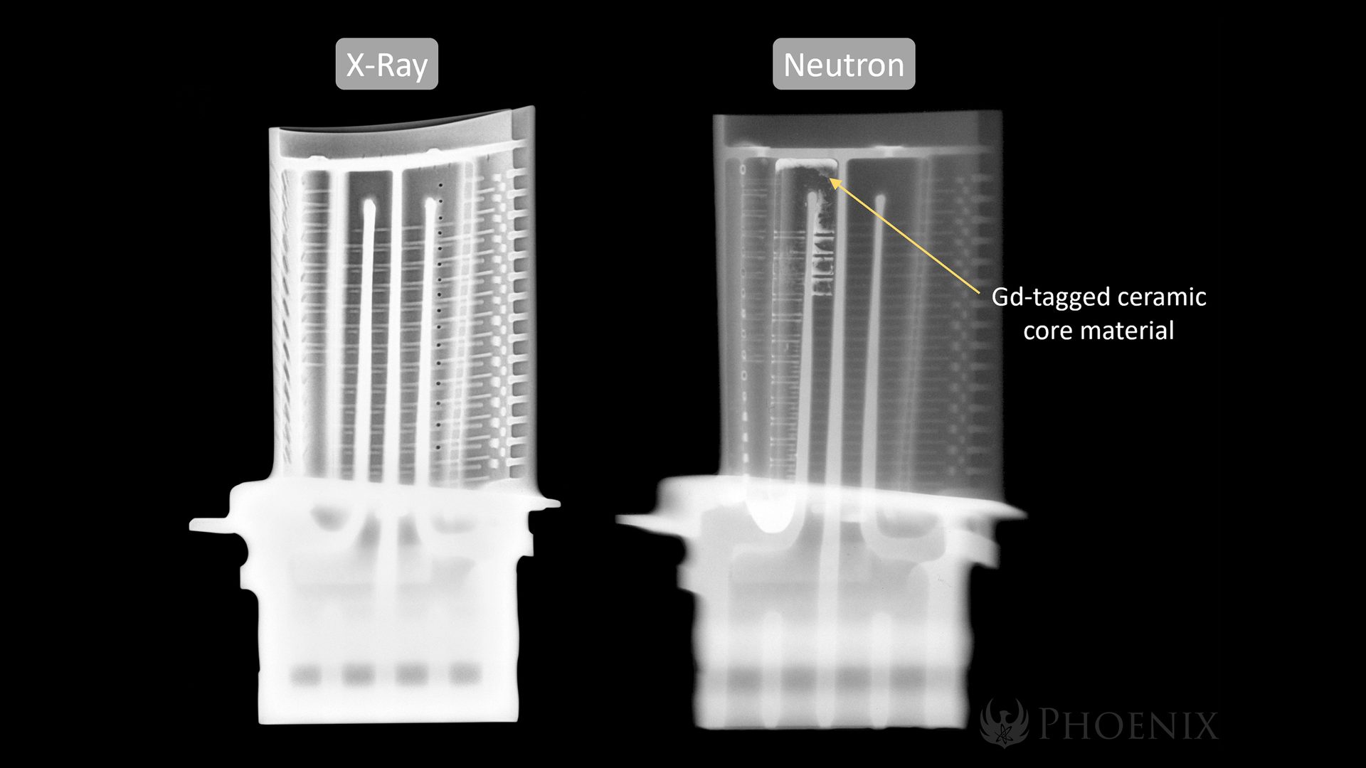

Just as doctors use both X-rays and MRI scans to see different aspects of the same injury, aerospace inspectors need multiple ways to examine valve assemblies. What makes neutron imaging so valuable is how differently it interacts with materials compared to X-rays. While X-rays interact with electrons, neutrons interact with atomic nuclei, creating remarkably different views of the same component.
This difference produces some surprising but valuable results. Some metals that typically block X-rays, such as aluminum, appear almost transparent to neutrons. Meanwhile, materials containing hydrogen - such as plastics, water, and organic matter - show up in sharp contrast. Even heavy metals like lead, which stop X-rays completely, allow neutrons to pass through with minimal interference.
Gadolinium-tagged turbine blade shows highlighted ceramic core material in neutron image that is invisible to x-ray.
These unique properties transform how inspectors can examine valves. They can now see through metal housings to check polymer seals, detect trapped moisture or cleaning fluids, spot organic contamination, and verify the proper installation of composite components. Components that were previously difficult or impossible to inspect can now be examined thoroughly while fully assembled.

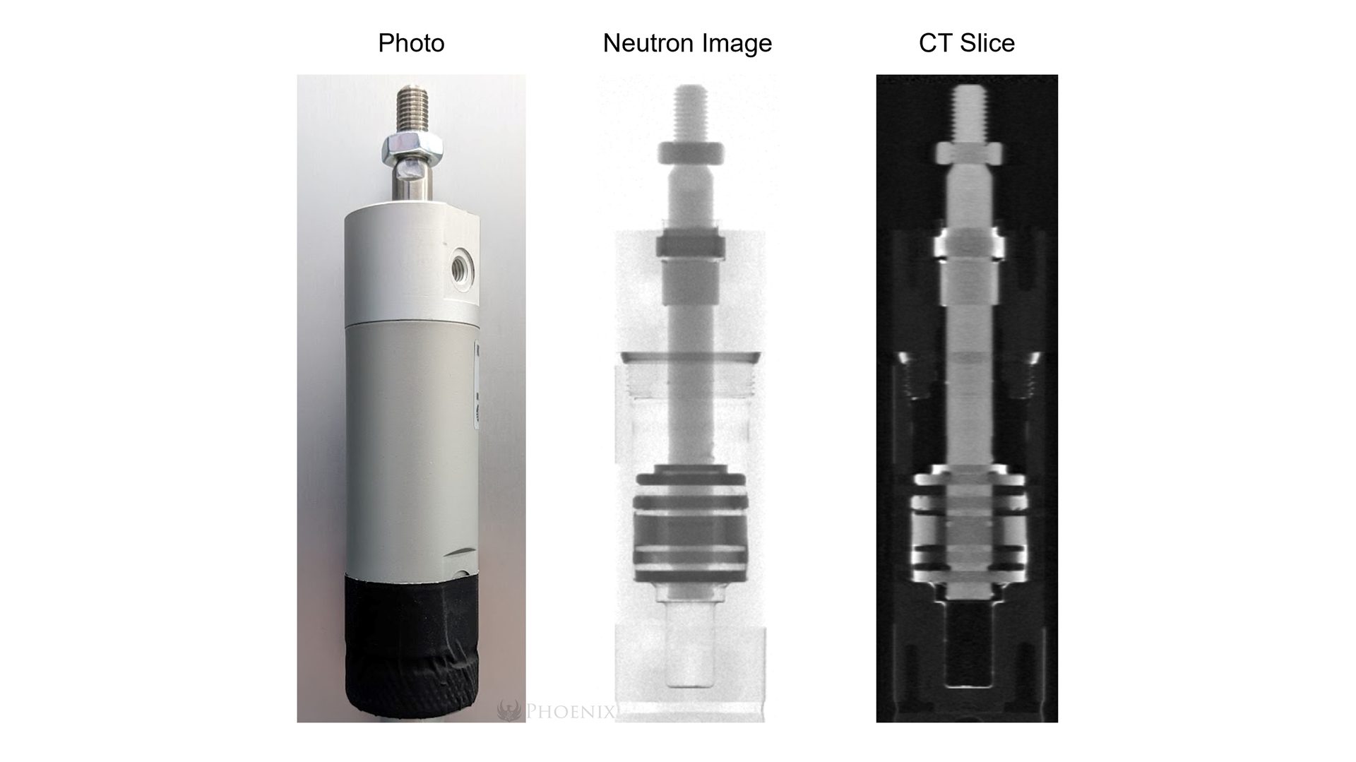

The technology is equally valuable for examining seals and interfaces, as demonstrated in the following pneumatic actuator inspection.
Neutron CT scan of aluminum pneumatic actuator. Left: Photo of actuator taped to CT stage. Center: A single neutron image from the scan. Right: Frontal slice of the CT reconstruction.

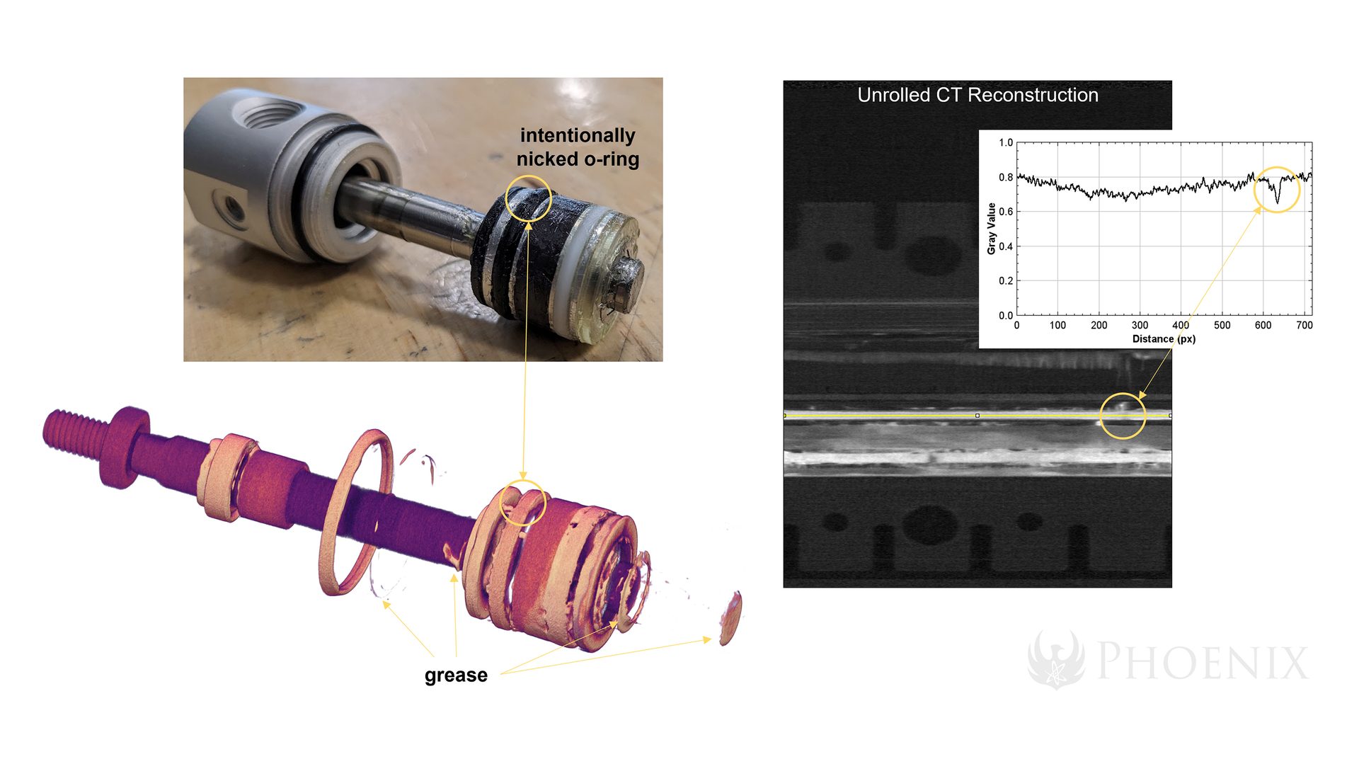

Engineers created a detailed 3D model by capturing hundreds of neutron images as the component rotated through a complete 360-degree cycle. The resulting visualization revealed not only the position of every O-ring through the aluminum body, but also the distribution of lubricating grease on internal surfaces. Most importantly, it uncovered a damaged O-ring that other inspection methods had missed. Using advanced analysis tools, inspectors could precisely map the defect’s location and severity by virtually ‘unwrapping’ the circular seal to examine its entire circumference.
Analysis of actuator nCT reveals damaged o-ring that is invisible in 2D imaging.
