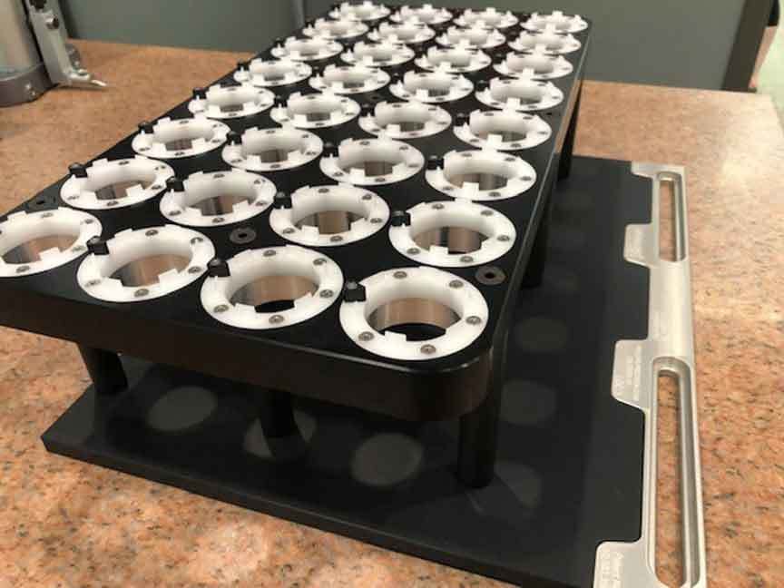

Standard Fixture Components
Designing fixtures using standard fixture components is more likely attainable in-house on CMMs, vision systems, DCC CMMs, optical comparators, and for gage arms. Standard components include vises, v-blocks, spring clamps, lever hold-downs, centers, collet chucks, stops, rails and specialty clamps are readily available. For the stage, one piece grid plates are still available from some suppliers. However, modular quick-swap plates provide faster part swaps, the ability to load the table with a variety of parts, allow inspectors to create fixtures that can be moved freely from one machine to another and for high repeaters… add the fixture to the job box. All benefits that mimic the fixture techniques that improve productivity on the shop floor and enhance the value of all equipment.
Like any industrial tooling, there’s no one-size-fits-all. What’s available off the shelf can be combined and integrated for the optimal solution. Most tooling is designed to accept ¼-20 and M6, which means a clamp from one supplier will work with another supplier’s plates, and so on.
Typically, CAD files of plates and clamps are readily available to import into design software (Onshape and Solidworks, for example) so that inspection fixtures can be built in sync with part production. Whether at the work cell or in the metrology lab, multiple fixtures holding a variety of parts for each shift can be loaded quickly and be removed and replaced as production requires.
Multiple repeat fixtures built using standard components. Modular fixturing can make a large gantry CMM work both big and small.

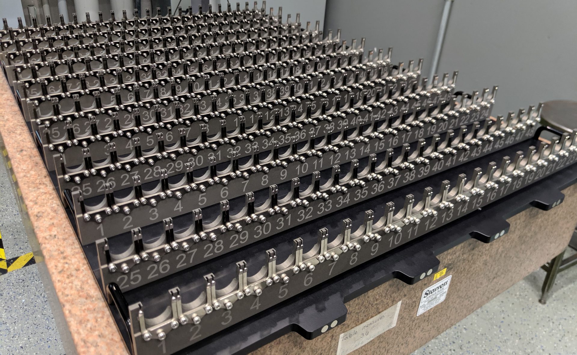

24 station production CMM fixture with dynamic stops for positioning.
Custom Fixture Anatomy
Basic components of an inspection fixture include the base (plate) and the part furniture or nest, rest/contact points, and can include clamps, stops, vacuum, magnets, and pneumatics. The most difficult skill in fixture design is to accommodate all the criteria while keeping it as simple and fail-safe as possible. Not all parts can be inspected using a single fixture. For more complex parts with several critical features, multiple fixtures or indexing features within the setup may be necessary. The most important aspect of a well-designed fixture is to hold the part securely and repeatably without distortion. Unless the requirements are to measure while constrained to remove distortion. For example, a large injection molded part would most likely need to be clamped at specific points to remove distortion. Finally, marking the fixture with part number, job and station numbers ensure fail-proof loading, increasing speed and accuracy.
When designing inspection fixtures for high production injection molds the number and size of parts in the mold should determine the number of stations in the fixture(s). As an example, in a 16-cavity mold, it may be more efficient to build two 8-up fixtures – to have one on deck measuring while loading the second off-line. This method optimizes the runtime of the inspection equipment. Of course, the measuring area of the inspection equipment will drive the size and number of fixtures.

280 station CMM fixture built in segments for high production injection molded part.

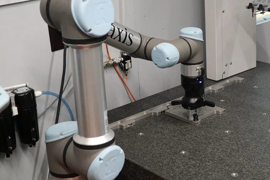

Teach universal cobots to load and unload inspection setups.
Robotic Applications
By design, modular fixture plates provide a perfect platform for industrial robots when the application suggests the plate moves with the parts. A secure docking rail offers a repeatable location for parts fixtured on individual plates. Grippers or end effectors are designed for the type of cobot or robot arm. Then the design will either accommodate the movement of the plate with parts or to move the individual workpiece. Automating inspection processes using “teachable” industrial robots can improve reliability and throughput and catch production errors early.
