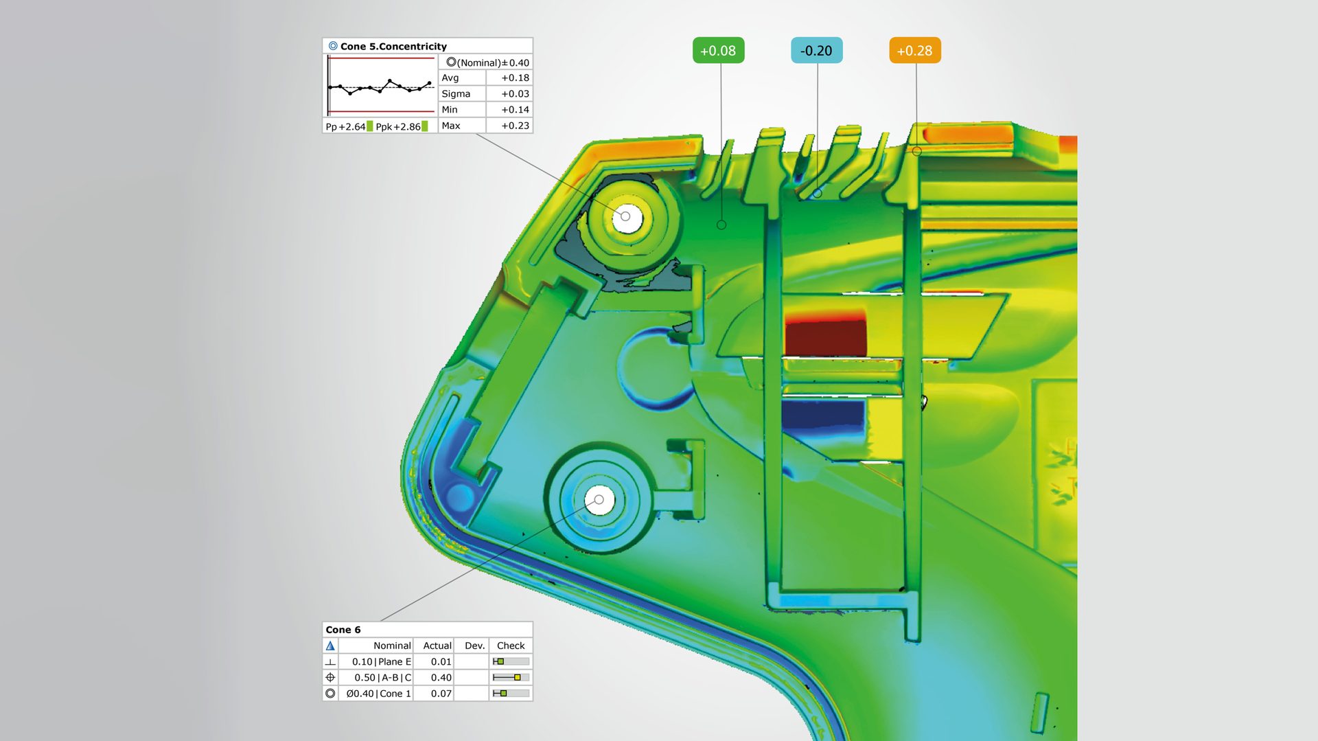

3.	Injection molding with GD&T

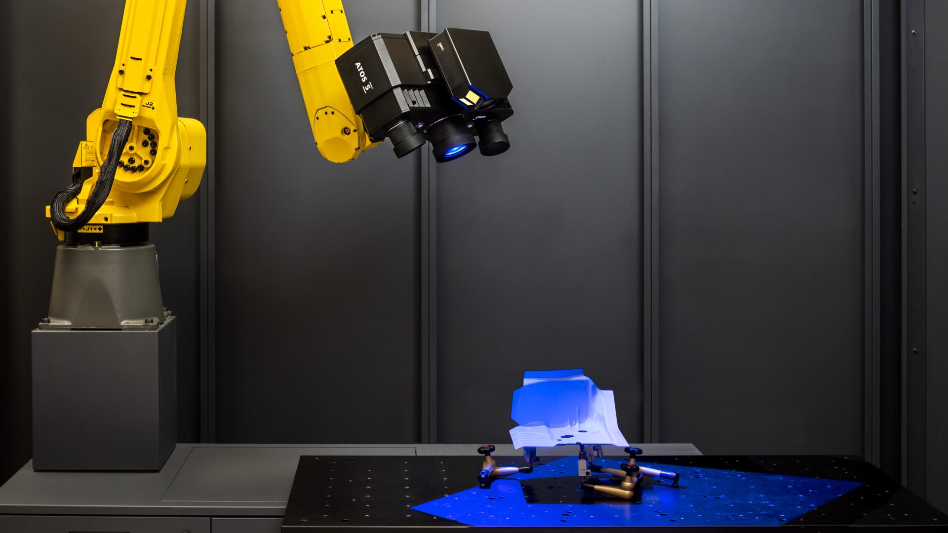

5.	Automated blue light 3D scanner for digital twin creation

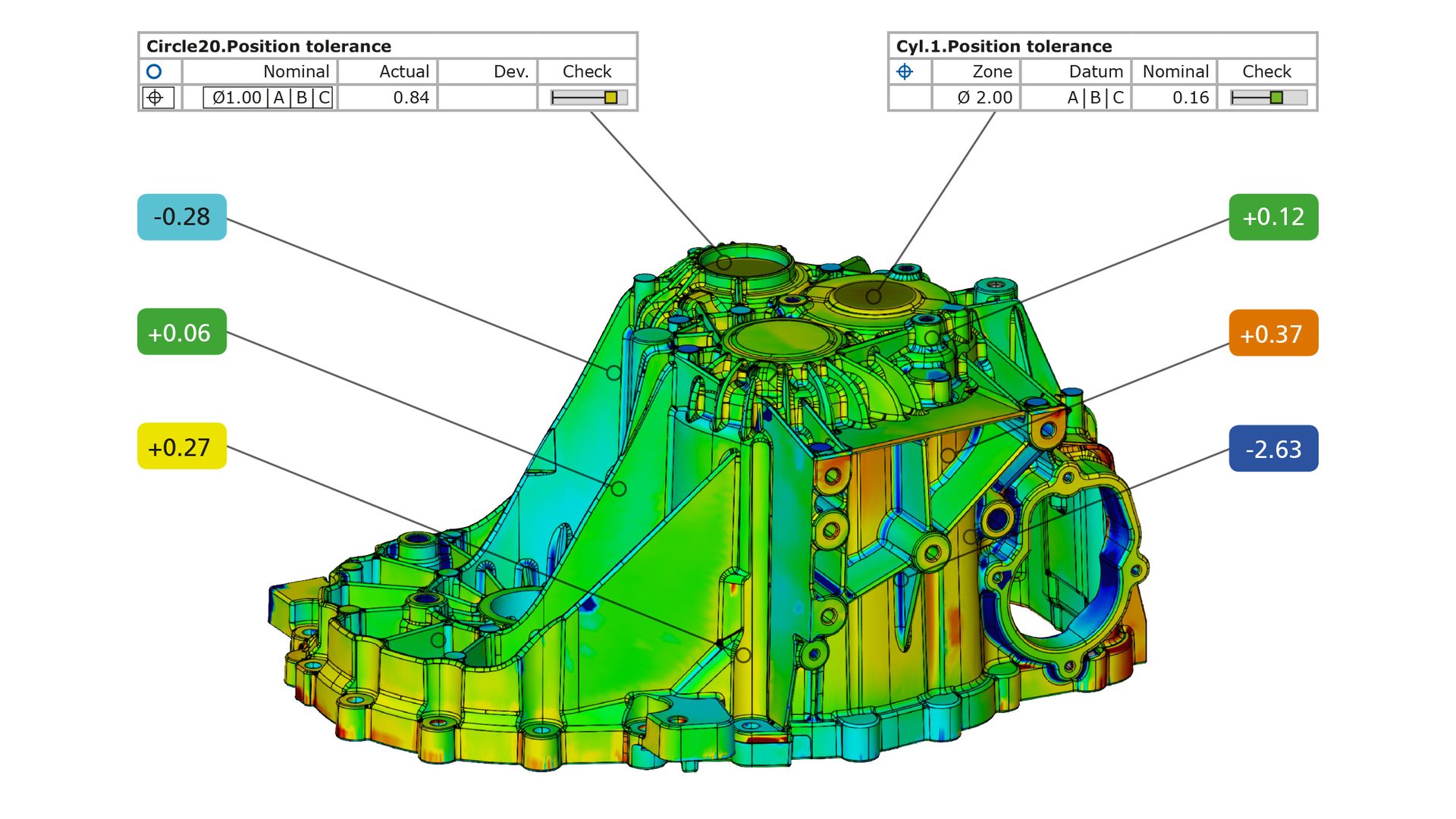

4.	Digital twin data of automotive gearbox housing with GD&T

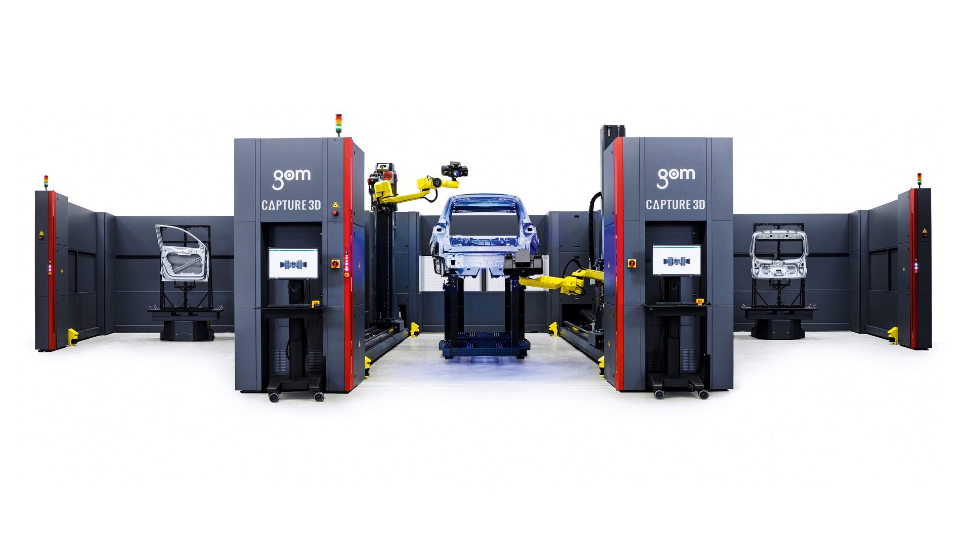

7.	Automated 3D scanning in the automotive industry

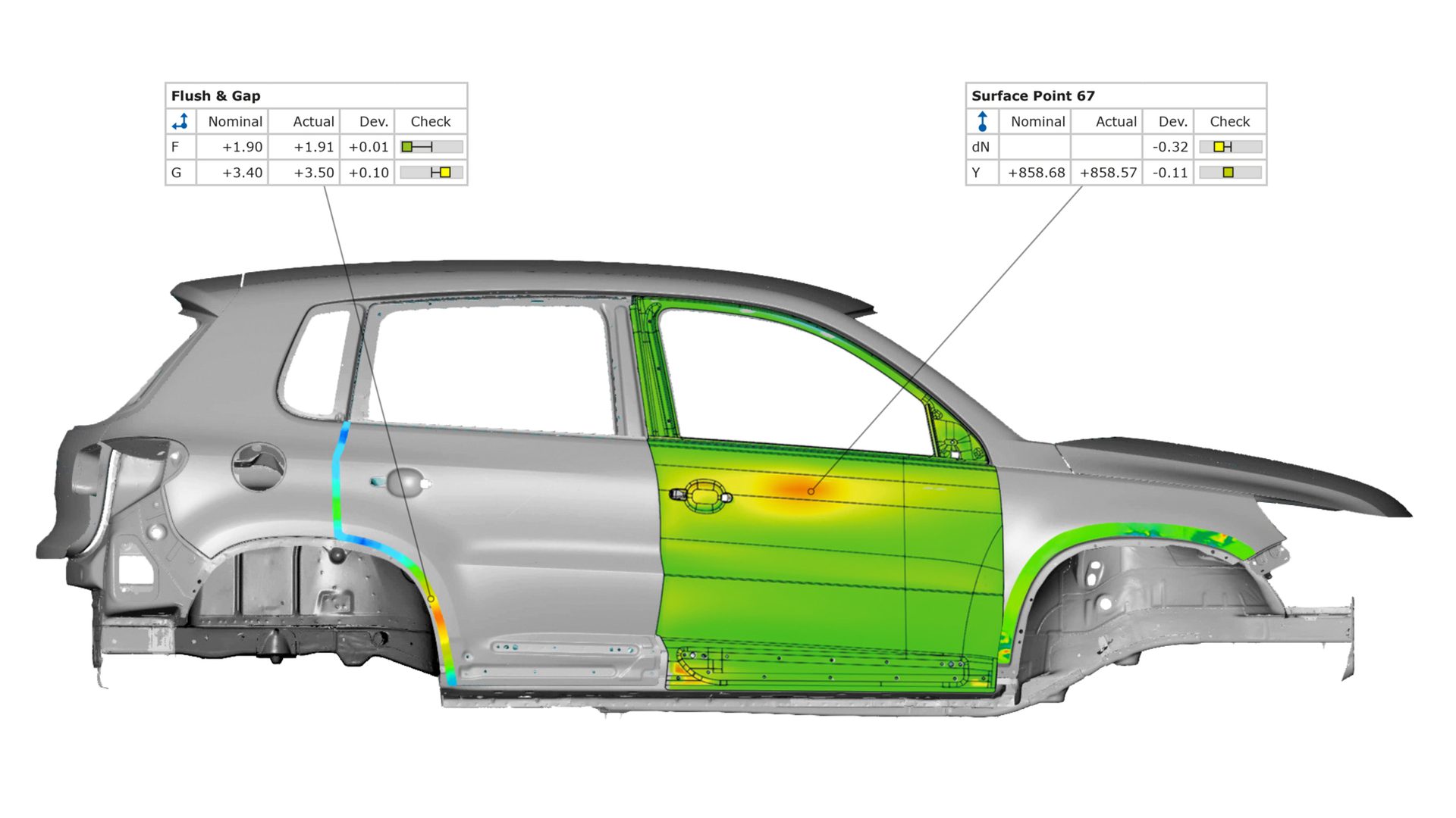

Digital twin data helps automotive manufacturers avoid rework, delays and wasted production time by digitally assembling components to ensure they will fit upon physical assembly.
6.	Digital twin data of automotive car body
