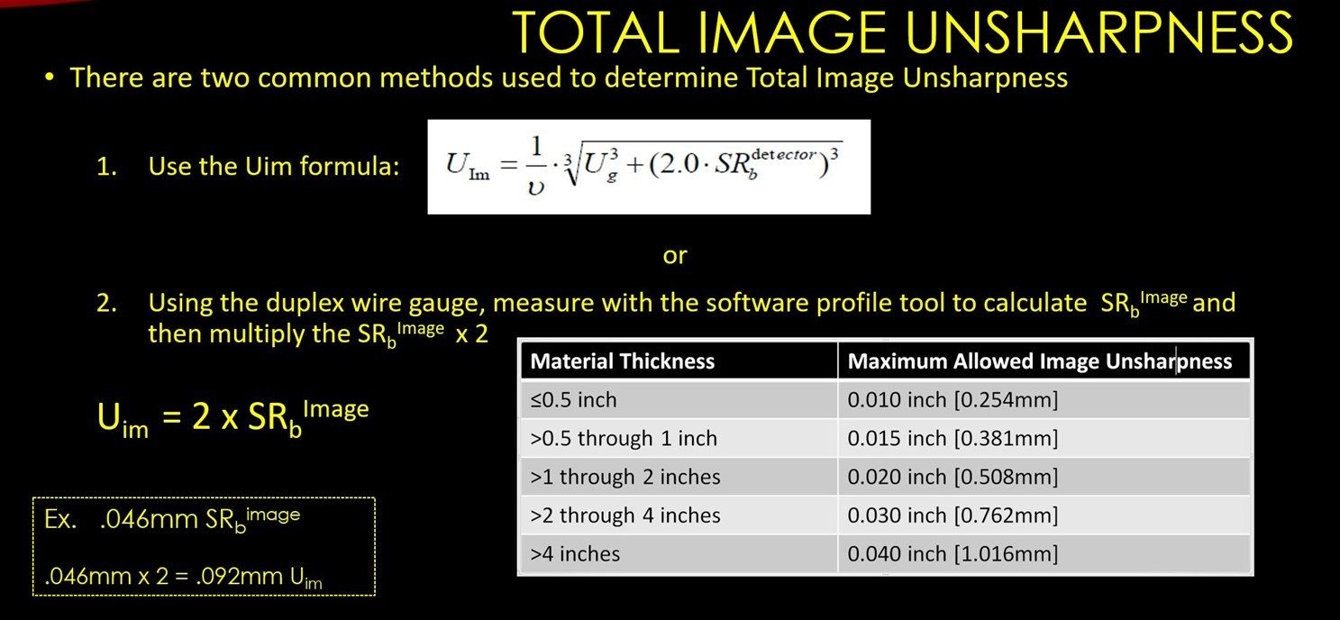

Image Unsharpness
One of the most critical calculations used in the film radiography process is known as Geometric Unsharpness (Ug). Ug is the measurement of the blur (aka penumbra) in a film radiograph. If this measurement is above the value stated in the standards, the radiograph will lack the definition or sharpness required to find flaws. This measurement is calculated by knowing the source to object distance (SOD), object to film distance (OFD), and focal spot size of the X or Gamma Ray source.
Ug is still a factor with digital radiography, however there are more image attributes that also need to be considered. We must consider (Ug) Geometric Unsharpness, but now we need to know the (SRbdetector) basic spatial resolution of the detector, and what the geometric magnification (Distance from the top of the part to the detector) is. We refer to the combination of these attributes as Image Unsharpness (Uim). This calculation/formula is new to an experienced film radiographer.
There are two common methods used to calculate this measurement. Method One is to use the Duplex Wire Gauge per ASTM E2002 or Method Two is to calculate with the Uim formula listed in ASTM E2033 & E2698. If radiographers are not aware of this requirement and use only the (film) Ug formula, they could produce a digital radiograph that is missing the definition or sharpness required to locate flaws.

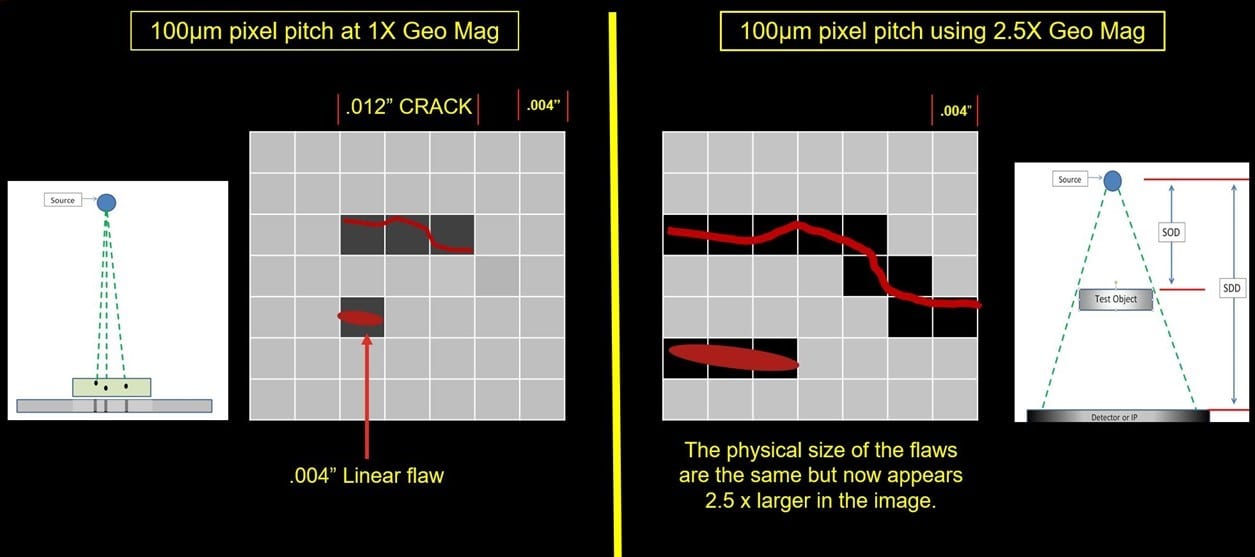

Pixel Coverage
When using CR or DDA it is important to know if you have enough pixel coverage for the flaw size needed to discern. When purchasing a DDA System pixel pitch is extremely important value to consider.
If pixel coverage is not sufficient, you may be able to use geometric magnification to achieve pixel coverage and Uim that’s required. Again, to use geometric magnification a mini or micro focus X-Ray tube will be needed.

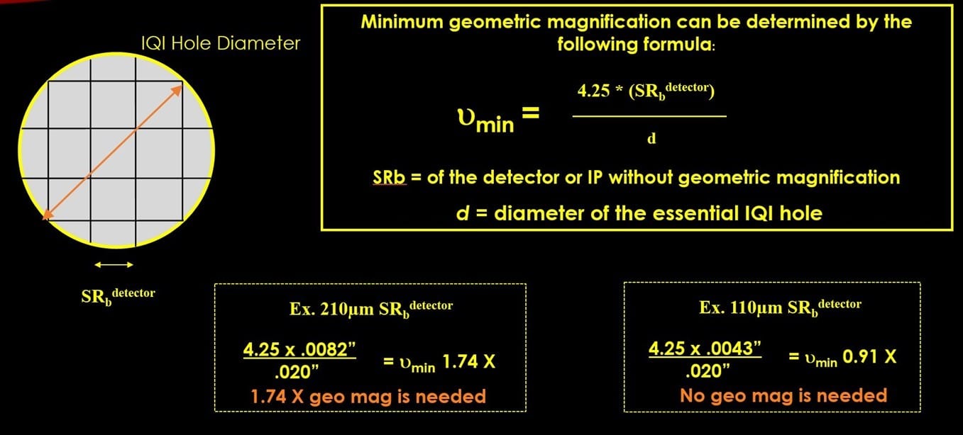

ASTM E2736 has a recommendation regarding the minimum number of effective pixels to cover the longest dimension of a defect. The recommendation states that >6 pixels covering the longest defect is the best practice if available. Keep in mind that the SRbdetector is the measurement used for this recommendation and not the pixel pitch or CR scan resolution.
Font
Text from ASTM E2736. Source: ASTM
Many aerospace manufacturers use the 3x3 pixel matrix rule to determine if it needs any geometric magnification to compensate for the lack of pixel coverage. Basically, a 3x3 pixel matrix needs to fit inside the smallest penetrameter essential T-hole size. If this is not achievable, geometric magnification will be required or you will have to select a CR or DR system that has a smaller SRbdetector measurement.
