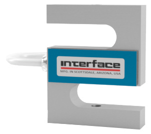

Environmentally sealed Interface S-Type Load Cell for extreme environments
Extreme Temperatures
Force measurement products used in field testing can also experience extreme temperatures, both hot and cold. For instance, testing space components in a vacuum also means simulating the cold temperatures found in space. While in the oil and gas industry, downhole components will experience extreme heat, in addition to corrosive environments. Load cell manufacturers can develop special strain gages with enhanced temperature compensation for either environment. In addition, special cables or even solder must be used to handle these temperatures, especially heat, or else they can melt. It is critical that the temperature within the environment you’re testing is explained to the manufacturer, or you will not see the most accurate results, while also risking damaging your sensors.
Ruggedization of sensors solutions, in its many forms, is critical to real world force testing. Load cells and other force solutions have progressed to be able to provide reliable and accurate data in any conditions. When selecting a load cell that fits a project’s environmental needs, pay close attention to material, and ensure it is rated for the environment in which you will be performing the test. In addition, custom solutions are available from many manufacturers for more extreme or unique environments.
