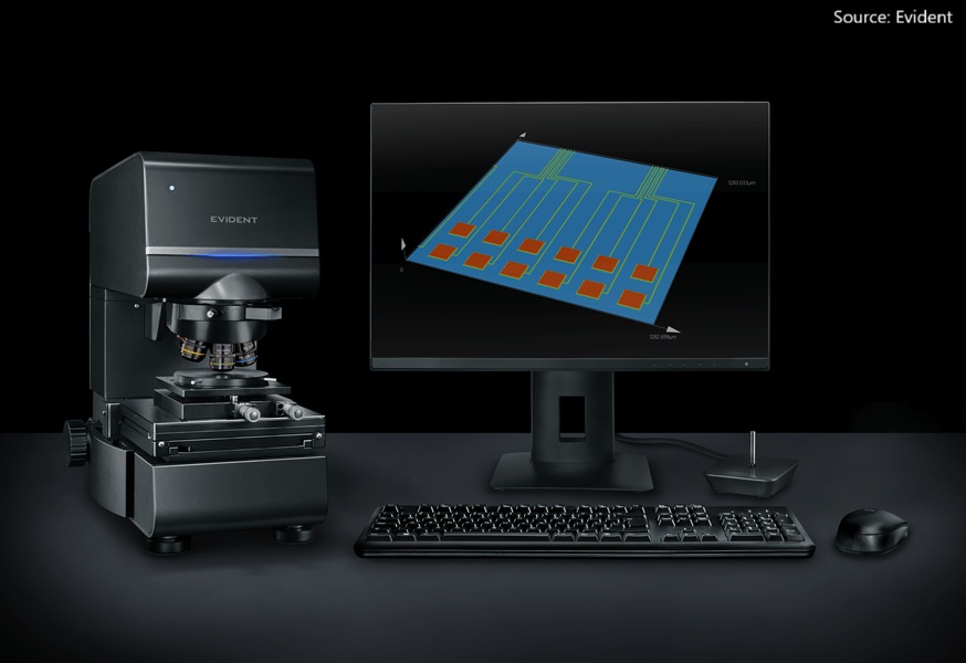

Evident 3D Optical Profilometer
Evident announced the launch of its LEXT™ OLS5500 hybrid 3D optical profilometer, an award-winning platform that sets a new standard in precision surface measurements. Uniting laser scanning microscopy (LSM), white light interferometry (WLI), and focus variation microscopy (FVM), the OLS5500 helps labs move seamlessly from first discovery to final decision with precise surface detail, traceable accuracy, and smart automated workflows.
Evident microscope, monitor displaying a 3D chip model, keyboard, and mouse on a dark surface.
Designed for R&D, quality assurance, and quality control, the OLS5500 is world’s first 3D optical profilometer to offer guaranteed accuracy and repeatability for both LSM and WLI measurements, ensuring consistent, high-precision measurements across surfaces. Guaranteed measurement noise levels in accordance with ISO standards also ensure high-resolution capture of subtle topographic changes. For larger regions, the OLS5500 guarantees the accuracy of stitched image data for both LSM and WLI.
Built on more than a century of optical innovation, the OLS5500 offers exceptional precision imaging with in-house engineered optics. LEXT objective lenses maintain clarity and shape fidelity throughout the field of view to support accurate measurements, while high NA WLI optics expand the field of view for up to 40 times faster measurement throughput compared to conventional LSM. The system’s smart automation, intuitive interface, and PRECiV™ software integration help users of all levels move efficiently from observation to inspection and measurement.
“Our goal was to build a 3D optical profilometer that bridges the gap between exploratory research and high throughput surface metrology,” said Cindy Zhang, VP of Product Management, Materials Science at Evident. “By integrating laser scanning, white light interferometry, and focus variation technologies, the award-winning LEXT OLS5500 enables labs to move seamlessly from fine structural insights to production ready measurement.”
During its pre-release, the OLS5500 3D optical profilometer received the Good Design Award 2025 from the Japan Institute of Design Promotion, recognizing its precision in measuring a wide range of surface types.

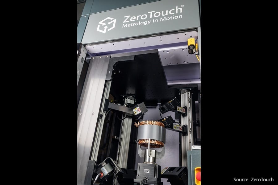

ZeroTouch ZT-EV Solution Suite for Electric Vehicle Stator Measurement
ZeroTouch® presents the ZT-EV solution suite: our latest advancement in electric vehicle stator measurement.
Designed for high repeatability and throughput, ZT-EV delivers precise gaging across three stator configurations:
ZeroTouch Metrology in Motion machine inspecting an electric motor stator.
  • Stator stack
  • Stator stack with paper inserts
  • Stator stack with hairpin assemblies
Combining advanced sensor technology with ZeroTouch’s patented metrology expertise, ZT-EV ensures uncompromising quality and seamless integration into modern EV production environments.
Key Features:
  • High-resolution measurement across all stator types
  • Real-time data for process control and traceability
  • Sub-minute scan cycles
  • Load capacity up to 65 kg
  • Point cloud generation for post-processing
  • Digital twin creation
  • Large measurement envelope
  • Automation-ready integration

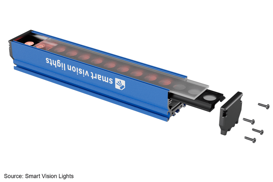

Smart Vision Lights Configurable LSR300 Linear Light 
Smart Vision Lights (SVL) launches its Configurable LSR300 linear light, which has interchangeable OptiCard lens modifiers and optic windows for on-site customization.
The Configurable LSR300 offers three OptiCards for narrow, medium, and wide beam angles along with three optic windows: clear for maximum intensity, diffused for even illumination, and polarized for applications that require glare reduction. A simple end-cap removal allows systems integrators to quickly swap out components to shape the beam to match the application needs. 
Exploded view of a blue Smart Vision Lights industrial bar light, showing internal components and screws.
“Flexibility grows increasingly important in automation and machine vision applications over time, and the Configurable LSR300 was designed with this in mind,” said Steve VanderZwaag, president and CEO. “Instead of testing or deploying different lights, this product allows for quick but fine-tuned beam angle and light characteristic adjustments on the spot, where and when you need it.” 
The IP50-rated Configurable LSR300 features a built-in driver; a working distance of 200–2000 mm; three rugged and easily interchangeable OptiCards; and wavelengths of WHI, 470 nm, 530 nm, and 625 nm. In addition, the light features Multi-Drive™ functionality, offering both OverDrive™ and continuous mode functionality for a variety of machine vision applications. The light is designed for simple adjustment, easy reconfiguration, and durability for both lab and field use. 
“Whether it’s in a lab or on the factory floor, beam angles can be changed in just seconds by removing the end cap and OptiCard and sliding in the new OptiCard into its pre-aligned position, and optic windows can be adjusted as needed,” added VanderZwaag. “For example, if the application involves glare or shiny materials, the polarized optic window can slide in above the OptiCard to provide a clear image.”

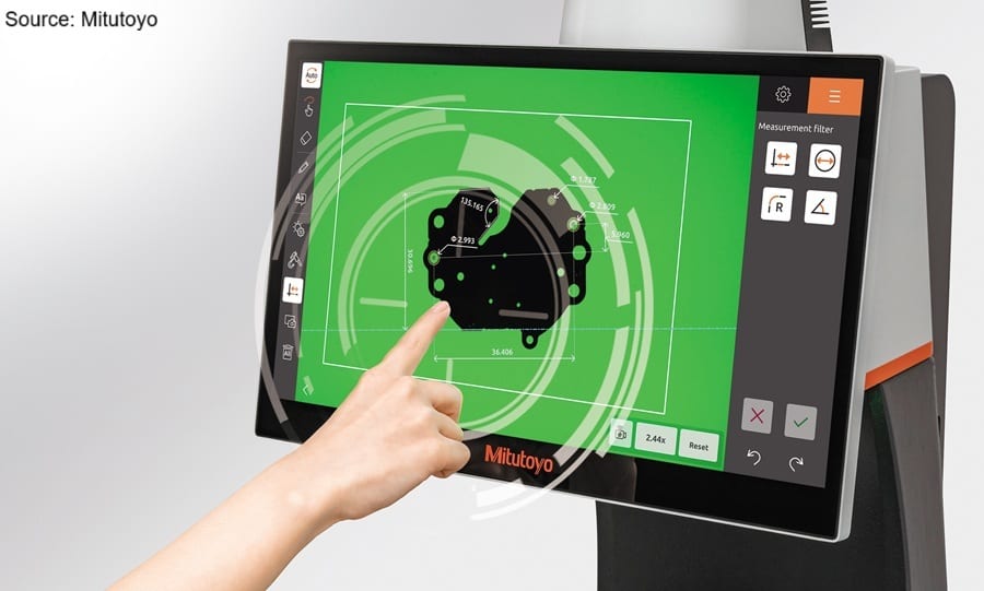

Mitutoyo QM-Fit Measurement System
Mitutoyo America Corporation introduces the QM-Fit Smart Vision System. The QM-Fit represents a step forward in optical metrology. The system features a wide field of view that can intelligently recognize part geometry, allowing measurements to be initiated automatically by extracting shapes displayed on the 15.6-inch intuitive color touchscreen. By combining streamlined operation with advanced automation, the QM-Fit delivers precision measurements with simplicity.
Hand touches a Mitutoyo touch screen displaying a technical drawing with measurements.
The QM-Fit is an all-in-one measurement system which allows you to view more of your parts under the high-resolution 20-megapixel color camera, combined with a telecentric lens that provides accurate imaging. The QM-Fit has an integrated computer and touch screen that delivers fast, effortless results. Automatic Element Detection instantly identifies multiple features, by automatically recognizing a workpiece, determining its alignment, and performing measurement routines.
Enhanced accuracy backed by NIST traceability:
  • Results can be displayed in mm, µm, inch and µinch
  • Measurement accuracy ± 0.000394", ±10 µm
  • Repeatability 2σ ≤ 4 μm
  • Accuracy guaranteed temperature range: 20±1 °C

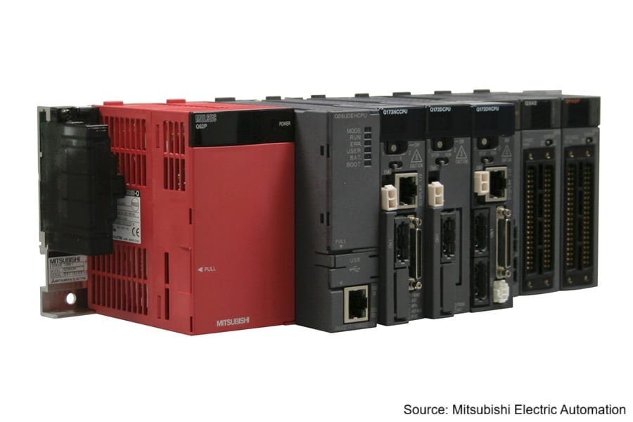

Mitsubishi Electric Automation Integrated Machine Analytics (IMA) C70 Adapter
Mitsubishi Electric Automation, Inc. (Mitsubishi Electric Automation) has announced the release of its Integrated Machine Analytics (IMA) C70 Adapter, a cutting-edge solution designed to empower manufacturers with real-time visibility into critical machine data. Fully compliant with MTConnect standards, the IMA C70 Adapter enables seamless integration with supported MTConnect client applications, allowing users to monitor, collect, and visualize equipment status remotely.
Mitsubishi Q Series PLC system with a red power supply and gray CPU and interface modules.
IMA C70 Adapter is designed for use with Mitsubishi Electric’s C70 control platform, a rack-based system built for large-scale, high-speed, and complex manufacturing environments. This solution is ideal for industries such as automotive, aerospace, industrial machinery, electronics, and metalworking.
“The IMA C70 Adapter is a game-changer for manufacturers looking to optimize their operations,” said David Simak, product manager (service) at Mitsubishi Electric Automation. “Enabling real-time access to machine data empowers teams to make faster, smarter decisions that improve efficiency and reduce downtime.”
Once installed, the IMA C70 Adapter communicates real-time system data to the MTConnect agent, translating it into MTConnect format. This data is then sent to the client application for graphical and numerical display, enabling informed decision-making and improved productivity.
The system requires a Windows 8 or newer PC, a direct Ethernet connection, and a Mitsubishi Electric C70 Series NC.

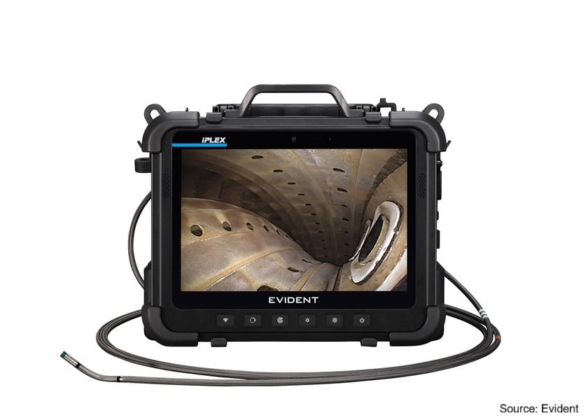

Evident IPLEX One Remote Visual Inspection Platform
Evident has launched IPLEX One, a next-generation remote visual inspection (RVI) platform designed to unify inspection teams and applications with a single scalable system. IPLEX One represents the first new product launch for Evident following its recent acquisition by Wabtec Corporation.
Evident iPlex industrial borescope displays machine interior on screen, with flexible probe attached.
Driven by Evident’s Swoptix™ multiview technology, IPLEX One allows users to instantly switch between NF/FF and D/S focus without removing the scope, cutting down on inspection time and reducing wear on tip adapters. The platform also offers monocular 3D modeling powered by Evident’s exclusive 3DAssist™ software, which lets users create detailed 3D images from a single optical path—no stereo tip required. Engineered to stay operational when and where it matters most, IPLEX One is drop-tested to MIL-STD-810G standards, IP65 rated for dust and water, and engineered to perform in rain, snow, and extreme temperatures. It’s also designed for long shift use, with a lightweight compact footprint; a balanced, ergonomic design focused on portability; a modular, cable-free setup; and a 10-inch anti-reflective touchscreen.

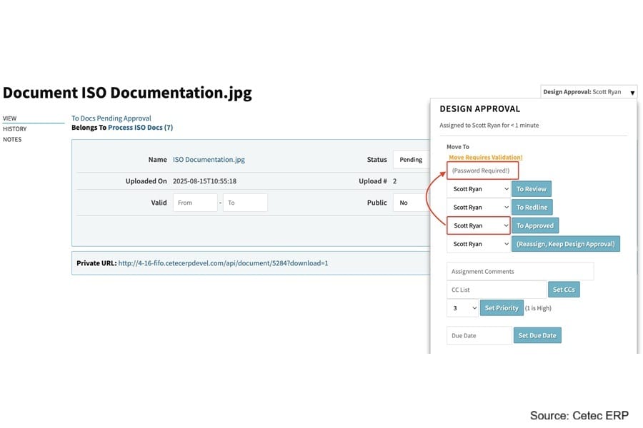

Cetec ERP Software
Cetec ERP released versions 4.19 and 4.20 designed with new capabilities to support the day-to-day compliance and quality needs of medical device and life science companies. The updates deliver greater control over regulated processes, quality tracking, and supplier oversight — all within a single integrated ERP system.
Document 'ISO Documentation.jpg' pending approval, with a popup displaying workflow actions to approve it.
One of the new features is a customizable Device History Record (DHR) document that is automatically generated and tied to the order, work order, and invoice. This consolidated record captures the complete manufacturing history for each device, making it easier for manufacturers to prepare for audits and meet documentation expectations under FDA Quality System Regulation and ISO 13485.
A new “Require Validation” option in workflow stages prompts password reentry before an object can advance. For companies operating in regulated environments, this adds an important safeguard for electronic authorizations and supports secure sign-off requirements often associated with FDA 21 CFR Part 11.
The Corrective Action Report (CAR) module now supports user-defined fields, allowing quality teams to capture additional details during investigations and follow-up. This added flexibility strengthens Corrective and Preventive Action (CAPA) programs by making it easier to track, analyze, and retain the information that matters most for compliance and quality improvement.
New home page dashboard widgets give real-time visibility into inspection results. A pie chart displays inspection failure codes while an “Inspected vs. Rejected” widget shows quantity metrics, yield percentages, and PPM. These tools help quality managers identify trends and address issues before they escalate.
  • Vendor Performance with Custom Metrics – Expanded tracking options for supplier performance, supporting more comprehensive supplier quality management programs.
  • Work Instructions on Order Splits – When orders are split, completed work instructions now carry over to the new line, preserving the continuity of production records for audit purposes.
“For manufacturers in regulated industries, compliance and quality are constant priorities,” said Taylor Wagen, COO at Cetec ERP. “These updates are about giving teams more control and clarity over their processes, so compliance isn’t a separate burden — it’s simply part of how they run their business in Cetec ERP.”

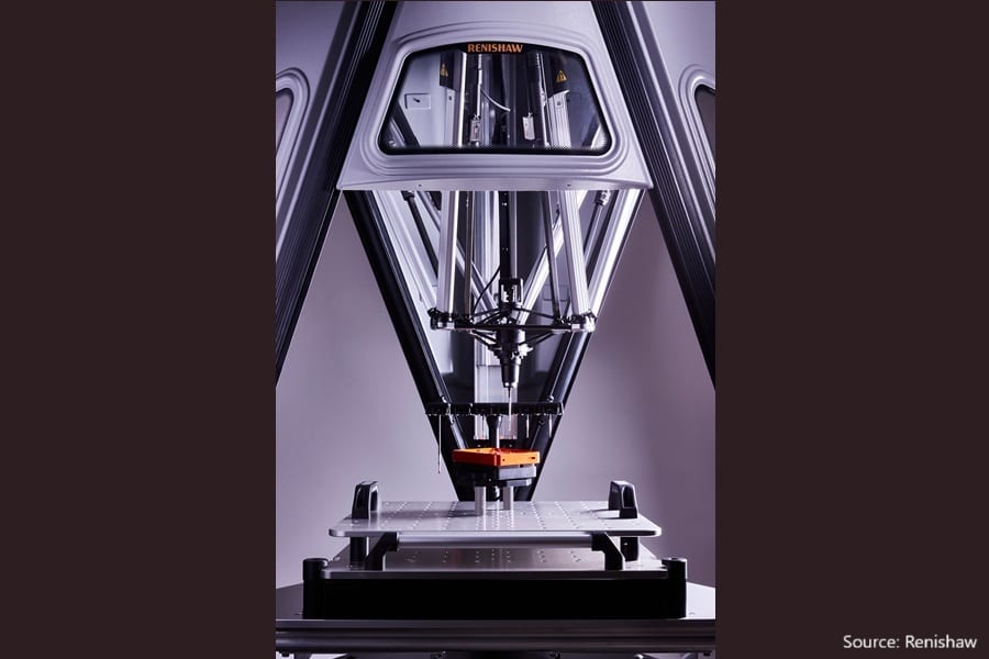

Renishaw Equator–X 500 Dual-Method Gaging System
Renishaw announced the launch of its latest solution for shop floor process control – the Equator–X™ 500 dual-method system. This product allows users to select the optimum inspection method – Absolute or Compare – to address a variety of process challenges, effectively deploying two systems in one.
The EquatorX system is designed to address situations where product variety and frequent design changes require measurement systems capable of speed, flexibility and ease of use to keep pace with machining capabilities. Key benefits include increased throughput, with high-speed measurement that increases inspection capacity; fully traceable inprocess verification of parts on the shop floor, with continuous validation of the production process; and the flexibility to select the optimal measurement method for each application with a single device.
A Renishaw precision machine uses a probe to inspect an orange part on a platform.
The optional Absolute or Compare measurement modes address the demands of fast-paced manufacturing environments with different requirements.
In Absolute mode, the Equator–X system measures parts at scanning speeds of up to 250 mm/s, significantly improving the inspection capacity and throughput for manufacturers of small to medium batch sizes and high part variety. This mode is particularly useful for first-off verification next to the machine or even at-line 100% inspection.
In Compare mode, the Equator–X system delivers an ultra-high scanning speed of up to 500 mm/s and is ideal for inspecting large batches of the same component when cycle time is a priority. It also provides a high-speed measurement option where varying thermal environments present a challenge.
The Equator–X 500 gage is a hexapod structure with independent drive and metrology frames. High-speed motion is achieved without compromising metrology thanks to design features such as carbon fiber metrology struts, linear motor drives and the industry standard SP25M scanning probe.
The system can be deployed as a standalone shop floor device or integrated within a fully automated cell, offering unrivalled flexibility to adapt to evolving demands and variable shop floor conditions.
The standard software platform for the new Equator–X 500 system features an intuitive and featurerich operator interface coupled with Renishaw’s latest MODUSTM IM metrology software applications.
This comprehensive suite of software tools delivers outstanding convenience and robust performance for programming, reporting and operation, simplifying complex tasks and enhancing user experience.
