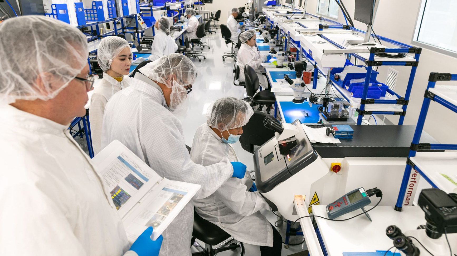

Technicians in protective gear work on a cleanroom production line with microscopes and other equipment.

We knew from the start that the success of this initiative would depend on starting small, learning quickly, and demonstrating value early. Our Costa Rica facility was the ideal pilot site. Not only is it one of our most advanced and high-volume locations, but it also has a strong track record of embracing new technologies and driving process improvements.
We partnered with MasterControl to implement the eDHR platform and began by mapping existing workflows into a digital environment. Every data entry point, approval, and verification step had to be translated into the system without compromising the regulatory rigor our products demand.
Cross-functional collaboration was key. Teams from Quality, Operations, and IT worked side by side to align on definitions, assign responsibilities, and define success criteria. This close collaboration helped build ownership, minimized resistance, and ensured the new system reflected real-world needs.
By the end of the pilot, the Costa Rica team hadn’t just adapted to the system, they had embraced it. Operators reported spending less time on paperwork. Supervisors gained real-time visibility into production. Quality teams were able to review records as they were created, dramatically accelerating release timelines. The facility became a proof point for what was possible, setting the standard for future rollouts.
