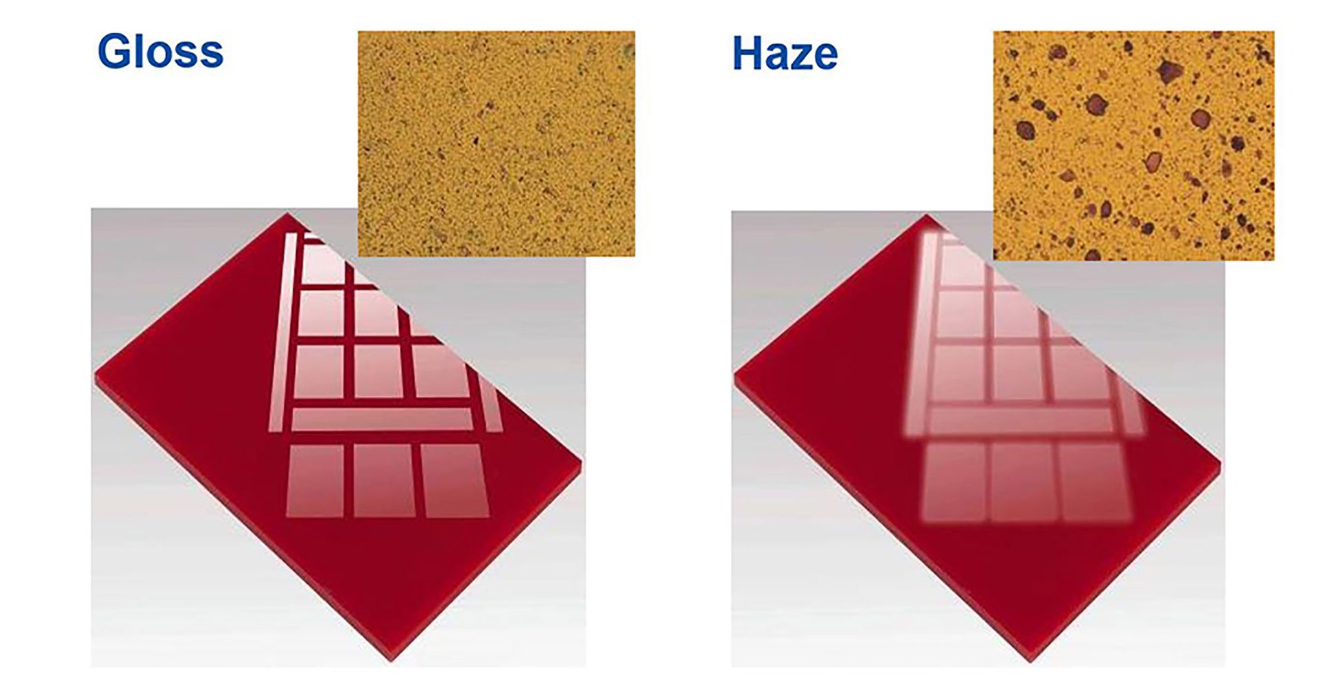

Gloss vs. Haze: Red panels showing clear vs. blurry window reflections, with speckled textures.

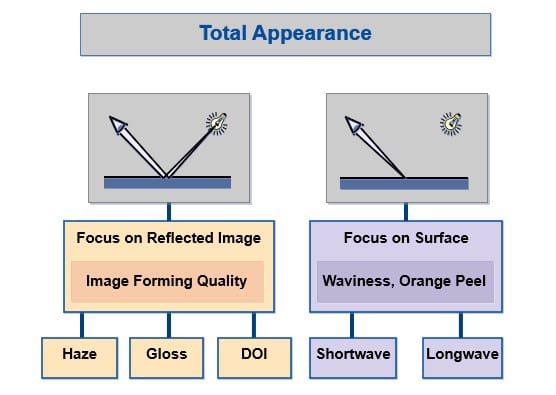

To guarantee good quality assurance, it is necessary to define appearance with objective, measurable criteria. We evaluate a surface by how it reflects light and the quality of the reflected image. The surface can appear brilliant or dull (gloss). When there is additional light scatter this quantifies (haze) and when focusing on the quality of the reflected image this determines the distinctness of the image (DOI). When focusing on the surface, we gain additional information about the structure’s size and form. We see these structures as a wavy pattern of light and dark areas. This waviness is often referred to as orange peel. These key factors work together to create the overall perception or the “Total Appearance” of the surface.
Flowchart: Total Appearance factors - Reflected Image (Haze, Gloss, DOI) & Surface (Waviness).

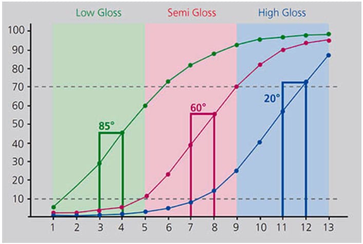

Gloss measurements are recorded as a value of gloss units (GU) or reflectivity (%R). The GU scale traditionally goes from 0-100 GU based on a specialized black glass standard, with a refractive index of 1.567 being the standard at 100 GU. With gloss measurement, different angles correlate better to different surface finishes; therefore, it’s essential to follow guidelines set by international standards when determining testing conditions.
The 60° illumination is used as a general geometry for a wide range of applications with gloss values between 10 and 70 gloss units. If gloss data is higher than 70 GU or lower than 10 GU, this measurement geometry is no longer effective in showing differences as shown by the flat portion of the curve (see figure below). Thus, the 60° geometry would show little or no difference in this range, while visually there is a clear difference.
Line graph showing gloss measurements at 85°, 60°, and 20° across Low, Semi, and High Gloss ranges.

Reflection haze is the additional scattering of light that reduces clarity or sharpness of the surface.
As light interacts with the surface or coating, it can scatter resulting in a milky effect and increase haze. This effect can stem from a variety of factors, ranging from formulation to application, resulting in reduced perceived quality of the final product. The reflection haze or DOI can be measured to quantify the quality of the reflected image. The measurement principle of these instruments is to quantify the sharpness of the reflective image correlating to our visual impression of the surface quality.
