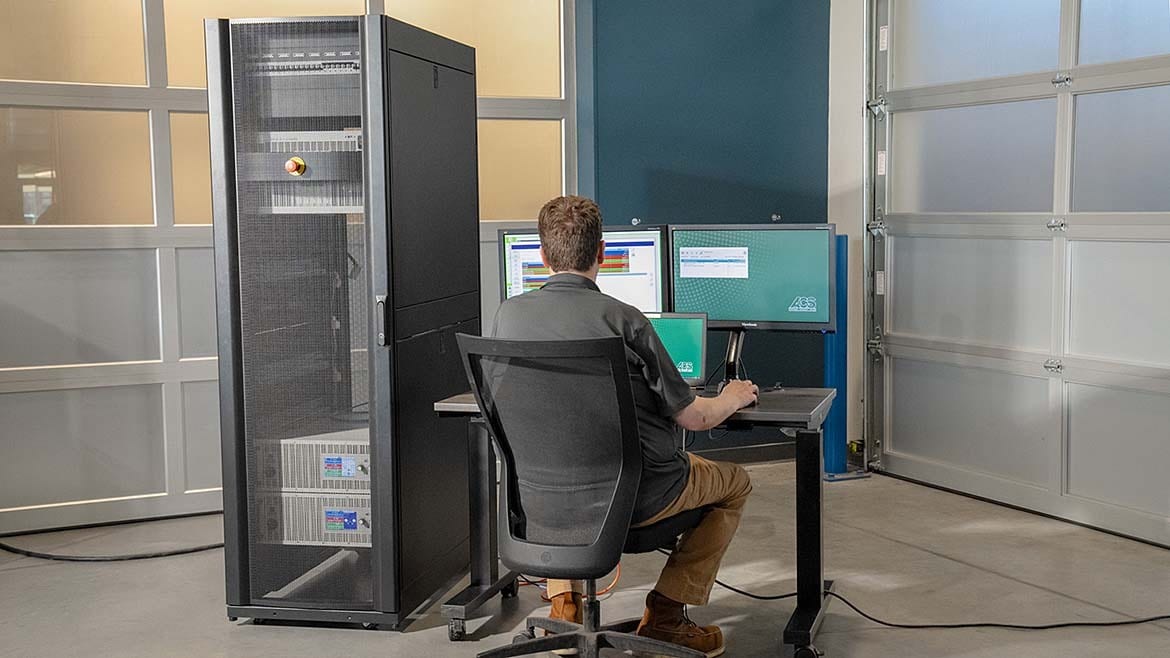

During the design phase, digital twins enable rapid prototyping and more accurate testing of new configurations in a virtual environment. This allows for cost-efficient remote commissioning and helps identify potential issues early on. Tools are also making it easier to update digital twins as new equipment is introduced. For example, machine manufacturers are starting to provide digital twin schematics that can be uploaded directly into a plant’s virtual model, allowing teams to quickly simulate new equipment before it’s even on the factory floor. This level of virtual integration streamlines the entire process and minimizes errors that could compromise quality.

Man works at computers next to a server rack in an industrial setting.

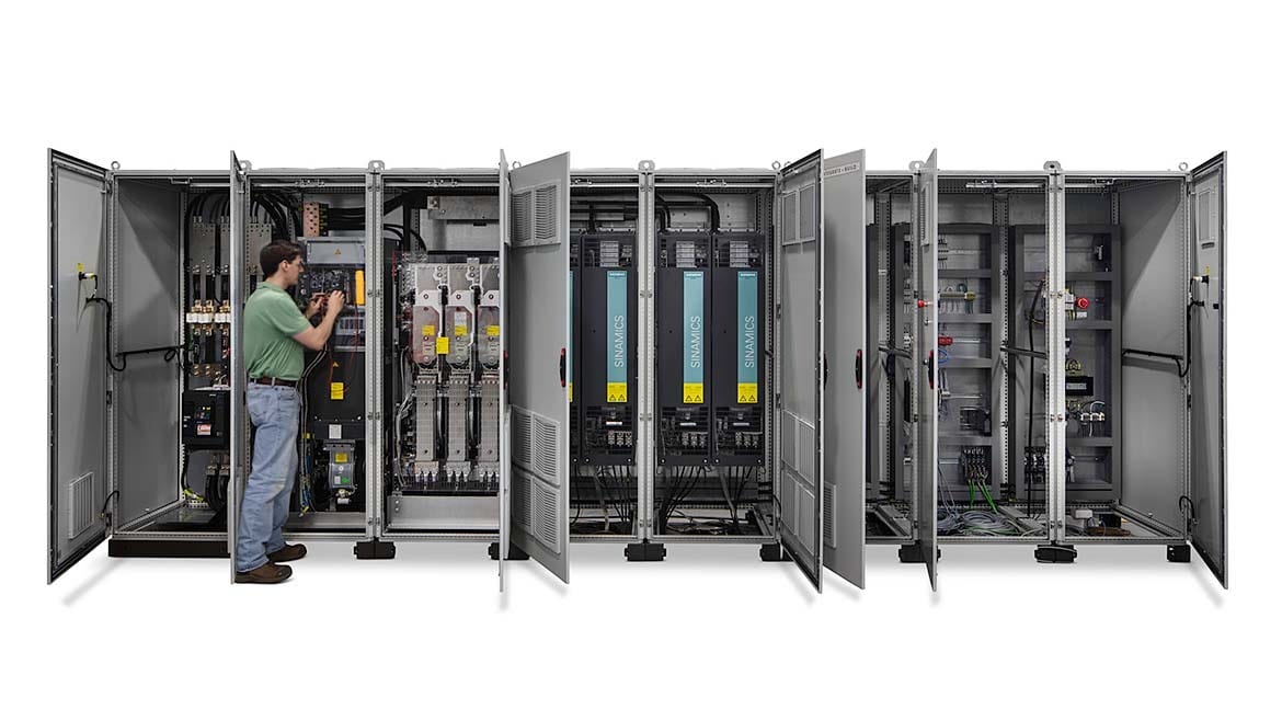

As manufacturing systems become more interconnected, they face a growing threat from cyberattacks. A particularly concerning threat involves attackers gaining remote or even onsite access to a network to hack into the local PLC network. A hacker who gains control of a local PLC network could manipulate settings, disrupt operations, or even compromise safety by taking control of critical equipment.
The first line of defense is to harden physical access to the plant, but the next critical step is to implement a Defense-in-Depth (DID) approach to cybersecurity. This involves embedding security directly into the PLC network. For many legacy systems, installing DID switches in PLC panels is an effective solution. These switches can be configured to allow access only via specific, pre-authorized ports and communication partners, effectively isolating the PLC network from other building systems. By adopting this strategy, quality professionals can proactively protect control systems, safeguard operations, and maintain the highest standards of safety and integrity.
Man working on an open electrical cabinet among a row of industrial control panels.
