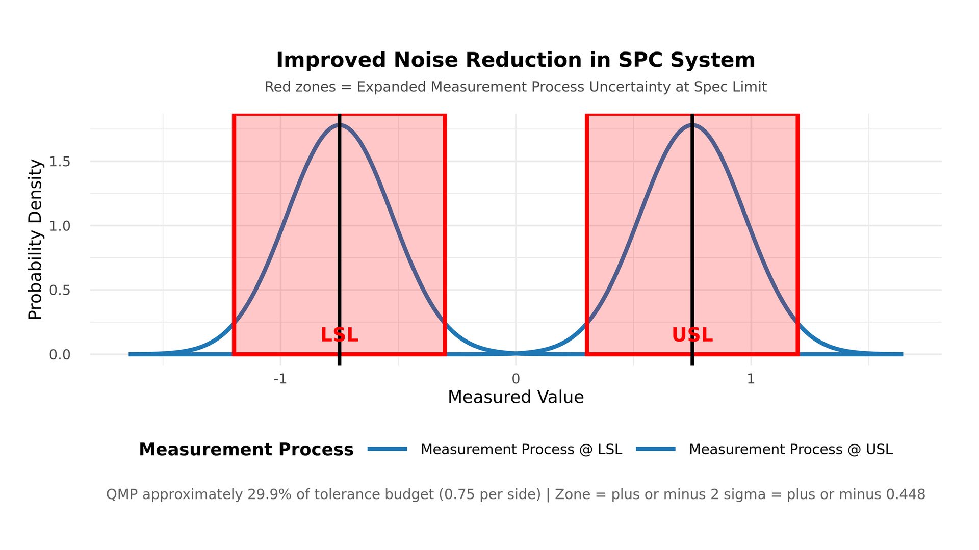

Statistical Process Control is a critical tool used in many industries to monitor complex processes that could pose a serious financial or safety risk. Decades ago, the automotive industry was looking for ways to improve productivity and reduce waste. While doing so, they determined that variation in the measurement system itself either through complex gaging fixtures or even simple dimensional inspection equipment could create a large amount of noise in the SPC system.
Excess noise in the SPC system makes analysis and problem solving more difficult because it can become harder to determine whether a part is actually passing or failing in many situations. In mass production, the excess noise in the SPC system can cause major problems for quality and production workers trying to meet strict requirements and short deadlines.

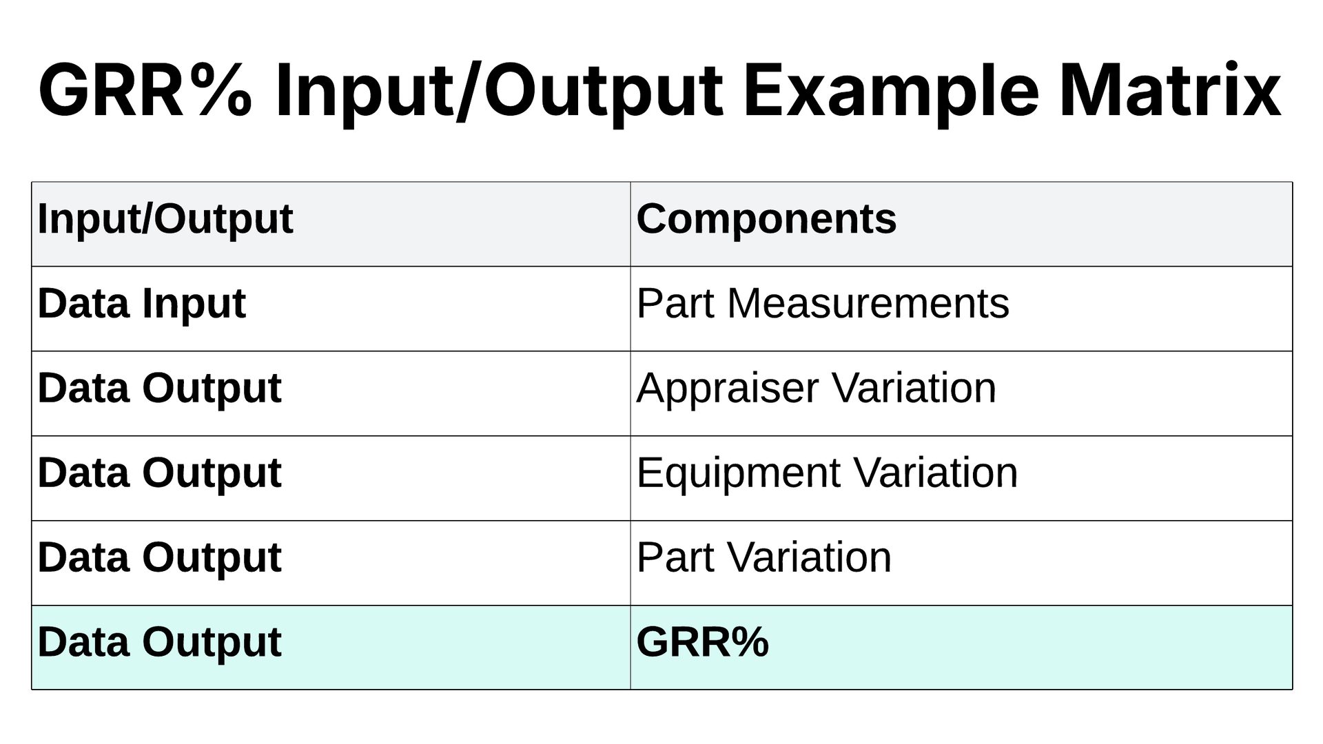

In order to address this issue, a Measurement System Analysis requirement was developed in the IATF 16949 standard, requiring many automotive factories to conduct statistical analysis on their measurement systems. This has become a routine audit finding for many factories. Measurement System Analysis currently ranks 4 in major nonconformities, according to recent data from the IATF.
The Automotive Industry Action Group developed a handbook for conducting Measurement System Analysis which has been used as a guide for not just the automotive industry, but other industries as well. Most auditors and OEM suppliers use a metric called GRR% to measure how much variation the measurement system is generating. The most common test is to use 10 parts, 3 operators, and 3 trials as the data inputs. The output tells you how much of the variation of the measurement system is caused by repeatability, reproducibility, and the parts themselves. By doing analysis, you can break the variation down into separate components to determine if the equipment or the operators are causing excessive variation. The GRR% target of less than 10% has been codified across many different standard operating procedures worldwide.
xxxxxxxxx
The handbook goes well beyond a simple GRR%. It covers linearity, bias, stability, and destructive testing, but GRR% only covers repeatability and reproducibility. It doesn’t aggregate everything into one decision metric, and it doesn’t capture temperature influences or account for testing or calibration uncertainties from the labs.

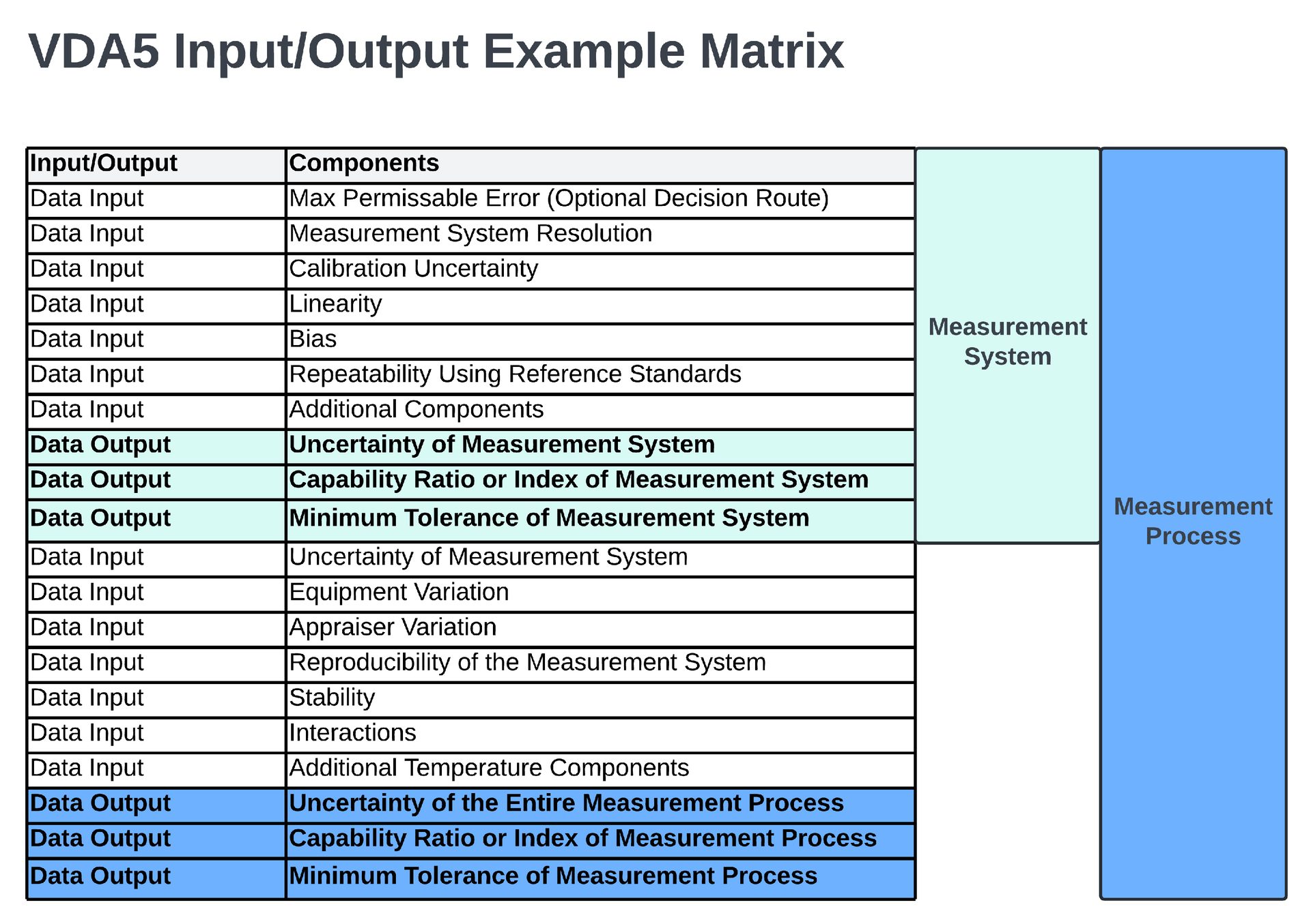

Building a VDA 5 Style Budget
A VDA 5 style uncertainty budget breaks the measurement problem into two categories: the measurement system (equipment, calibration, software, fixtures) and the measurement process (how parts are measured: operators, part interaction, environment). If you don’t need a full breakdown, you can use a Maximum Permissible Error (MPE) to simplify the model.
xxxxxxxxx
Start with the measurement system. Estimate each component’s standard uncertainty, combine them by root sum-of-squares (RSS) per GUM, and compare the result to a measurement system capability index/ratio. Then move the equipment into production and collect data on how it behaves with real parts, operators, and environment. Add those contributors to the same budget, combine again, and compare to a measurement process capability index/ratio. Most calibration labs already work with Test Uncertainty Ratio (TUR), so this approach lines up cleanly with existing lab procedures.
Because everything lives on one budget, it’s fast to see what’s driving excess noise in SPC. If the capability ratio is tight, you can spot the row that’s eating the tolerance and make a targeted change without a lot of guesswork.
For complex systems (robotic inspection, closed loop controls, long cable runs, sensors), a multi-variable budget is essential. Even something as simple as wiring and signal conditioning can add measurable variation. Modeling those terms up front cuts debug time and keeps teams from chasing process “ghosts” that are really measurement effects.

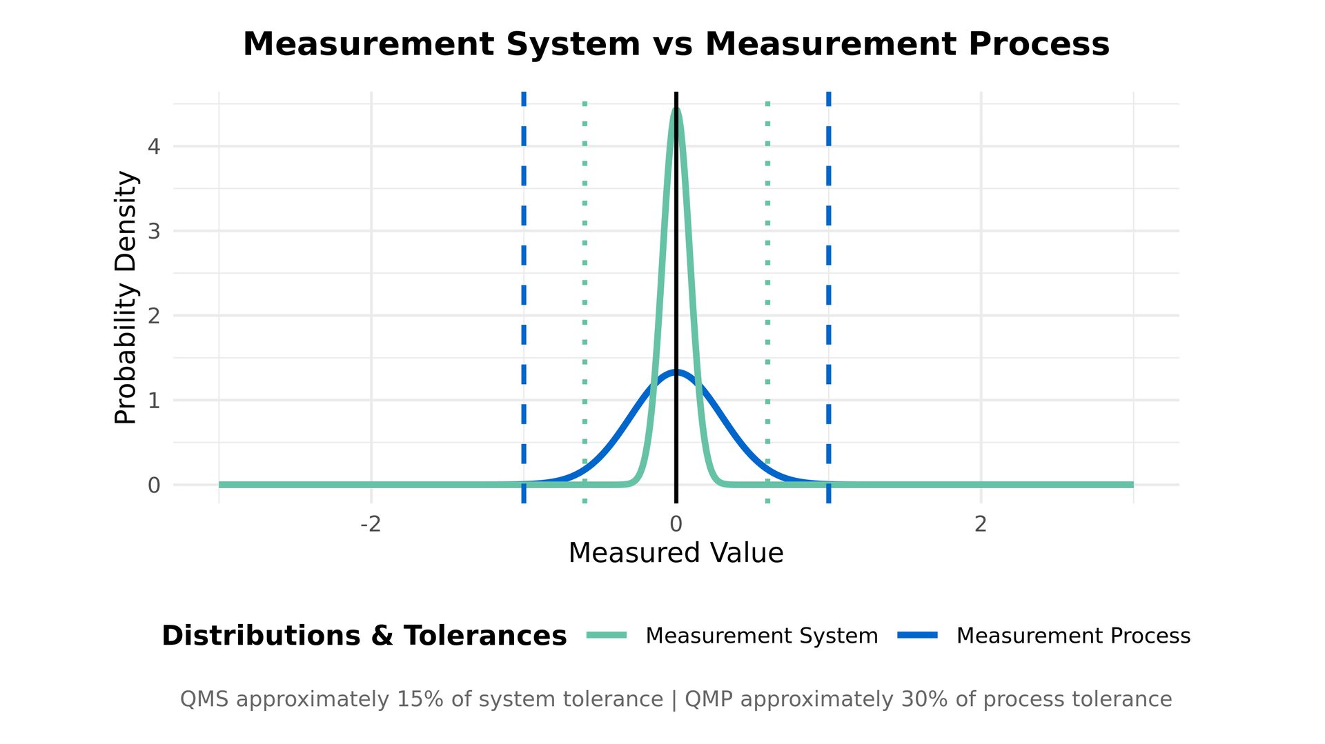

Minimum Tolerance Testing
VDA5 lets you take the inputs from your uncertainty budget and run them in reverse to get a minimum tolerance for both the measurement system and the measurement process. The common acceptance limits are that measurement uncertainty should consume up to 15% of the measurement system and 30% of the measurement process.
Here is how it works: You pull the expanded uncertainty from your budget (k=2) and solve for the smallest tolerance that still meets the limit.
Minimum Tolerance of the Measurement System = Uncertainty of Measurement System / 0.15
Minimum Tolerance of the Measurement Process = Uncertainty of Measurement Process / 0.30

If the tolerances on the drawing are smaller than the calculated minimum tolerances, there could be measurement problems once it goes to production. At this point you would flag the process for further review rather than sending it to mass production.
This testing methodology is a major cost saver because it can identify tolerancing problems before technicians start programming robots, PLC systems, and writing work instructions. If these problems were identified during mass production, it could be extremely expensive to mitigate and increase risks of audit non-conformances.
