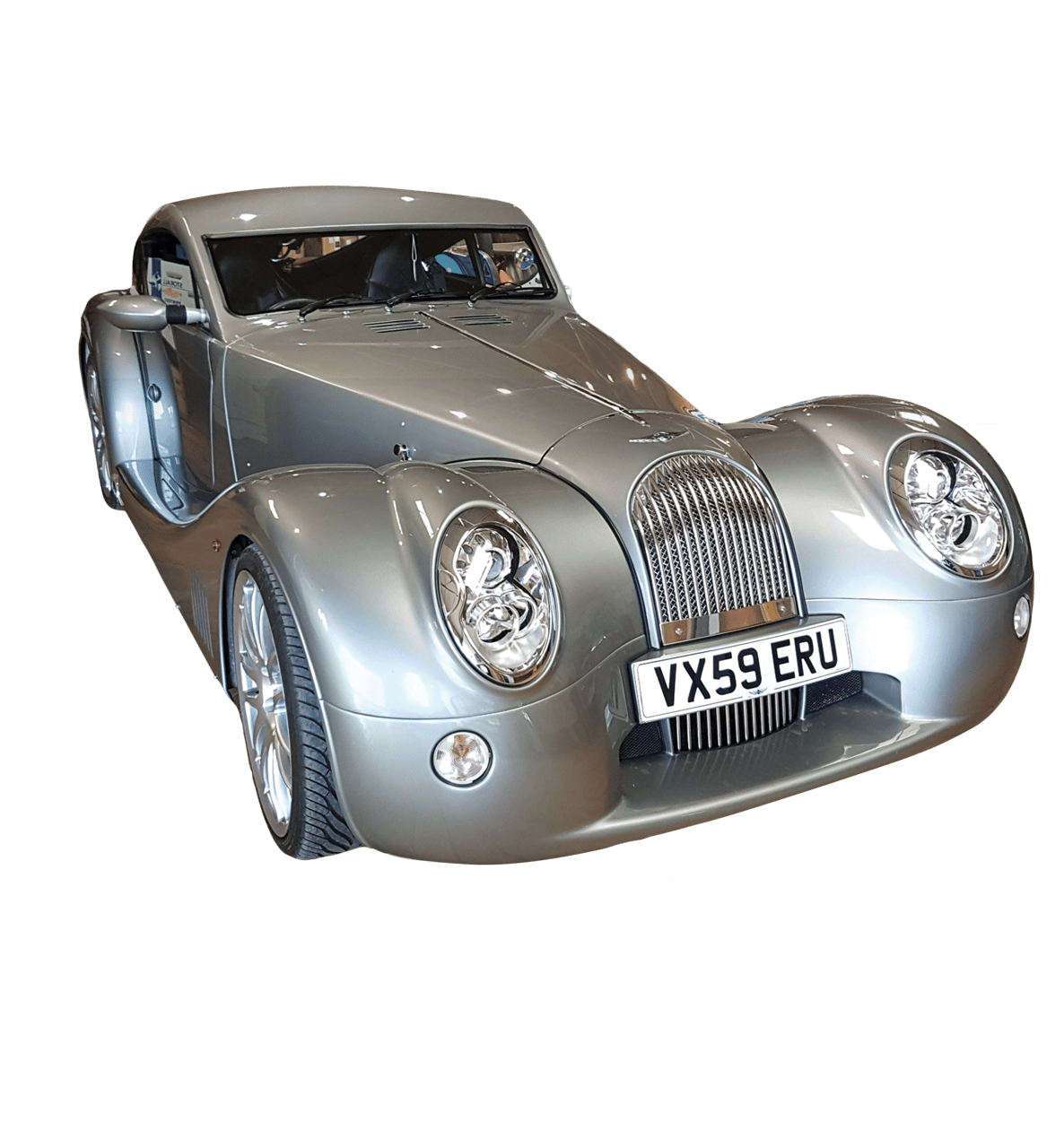

Morgan Cars has been producing high quality handcrafted motor vehicles since 1909. Today they produce their modern take on a British classic using Verisurf software to reverse engineer iconic body styling.

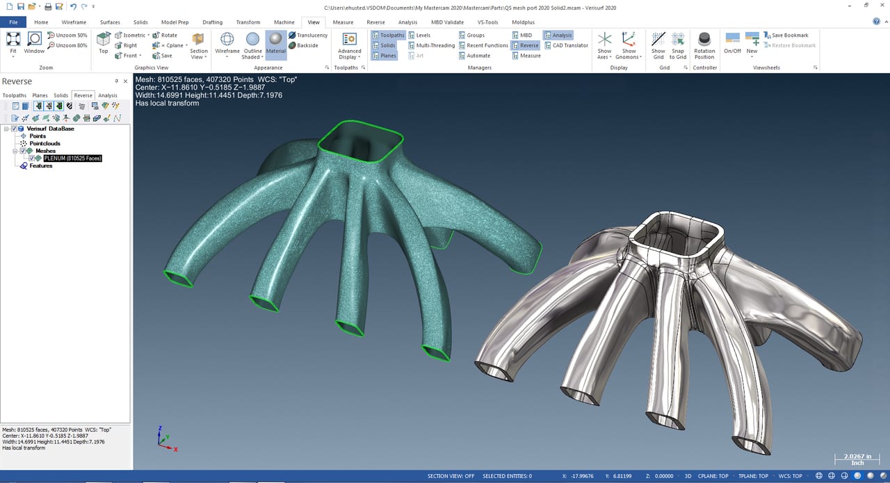

 Quick Surface is an optional tool that quickly creates high-quality surfaces from scanned meshes or STL files. The software maintains curvature continuity between adjacent surfaces and is ideal for creating smooth, freeform CAD surfaces, ideal for high-speed toolpaths, either from organic or prismatic meshes.

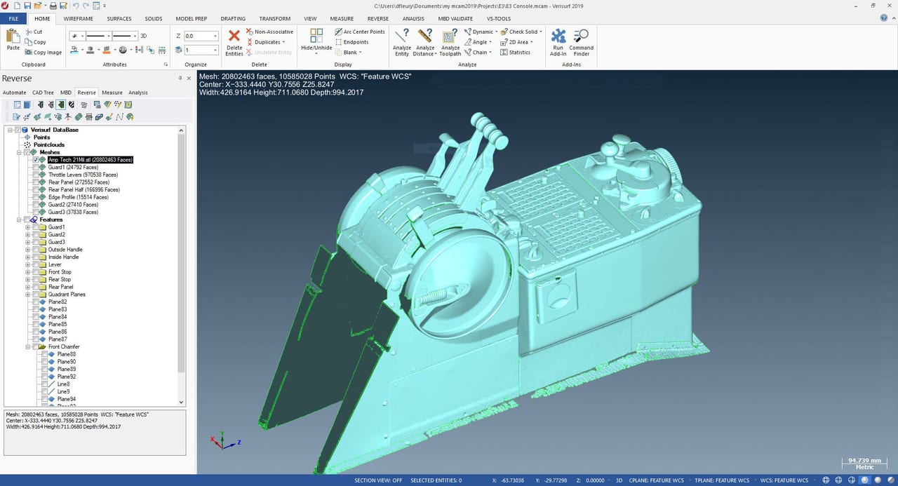

A complex profile scan was used to aid in the reverse engineering and development of a legacy Boeing E-3 Sentry throttle quadrant for use in flight simulator training. Verisurf Reverse and Verisurf CAD software was used to isolate features and create an exact tactile replica.
Software was used to isolate throttle levers and guide plates from the original surface profile scan. Note planes and edges highlighted for capture of geometry and conversion to CAD.

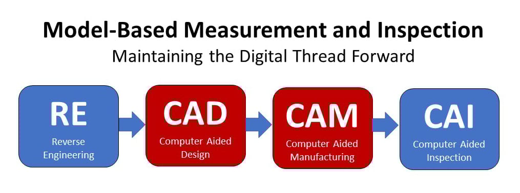

RE with MBD
You hear a lot today about concepts like digital thread, digital twin, SPC, PLM, etc. Depending on the size of the organization, types of customers or supplier requirements, they can all be important initiatives, but the one thing they have in common is Model-Based Definition (MBD). Intelligent GD&T definitions are the foundation of every CAD model to define its design intent. If this is your end goal when it comes to digital RE then you should consider a software that is based on a CAD platform and has the right tool set to go from beginning to end, from measurement input through manufacturing and quality verification. This is where CAD based measurement software extends typical RE into practical RE for manufacturing.

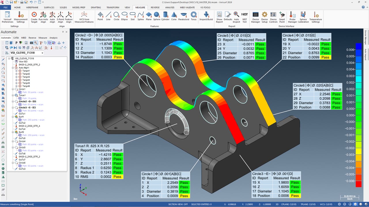

When the product definition flows from the reverse engineered CAD model through inspection and reporting, the integrity of the quality assurance process is maintained, closing the loop on design intent and implementation by feeding back to the 3D CAD authority.
CAD based RE software solutions with direct access to integrated inspection tools support model-based inspection using GD&T data. When the product definition flows from the reverse engineered CAD model through inspection and reporting, the integrity of the quality assurance process is maintained, closing the loop on design intent and implementation by feeding back to the 3D CAD authority.
Moving the Digital Thread Forward
Through the practical implementation of model-based inspection, using intelligent GD&T definitions, the last fundamental manufacturing process, inspection, is now digitally connected, providing both immediate and considerable downstream benefits, including first article inspection (FAI), and feeding statistical process control (SPC) applications to proactively catch parts trending out of tolerance, before they become scrap.
