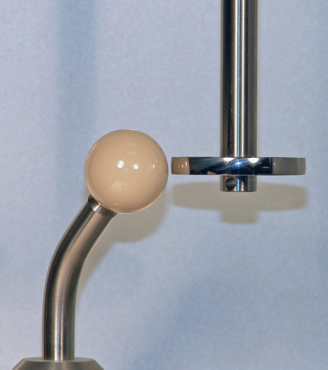

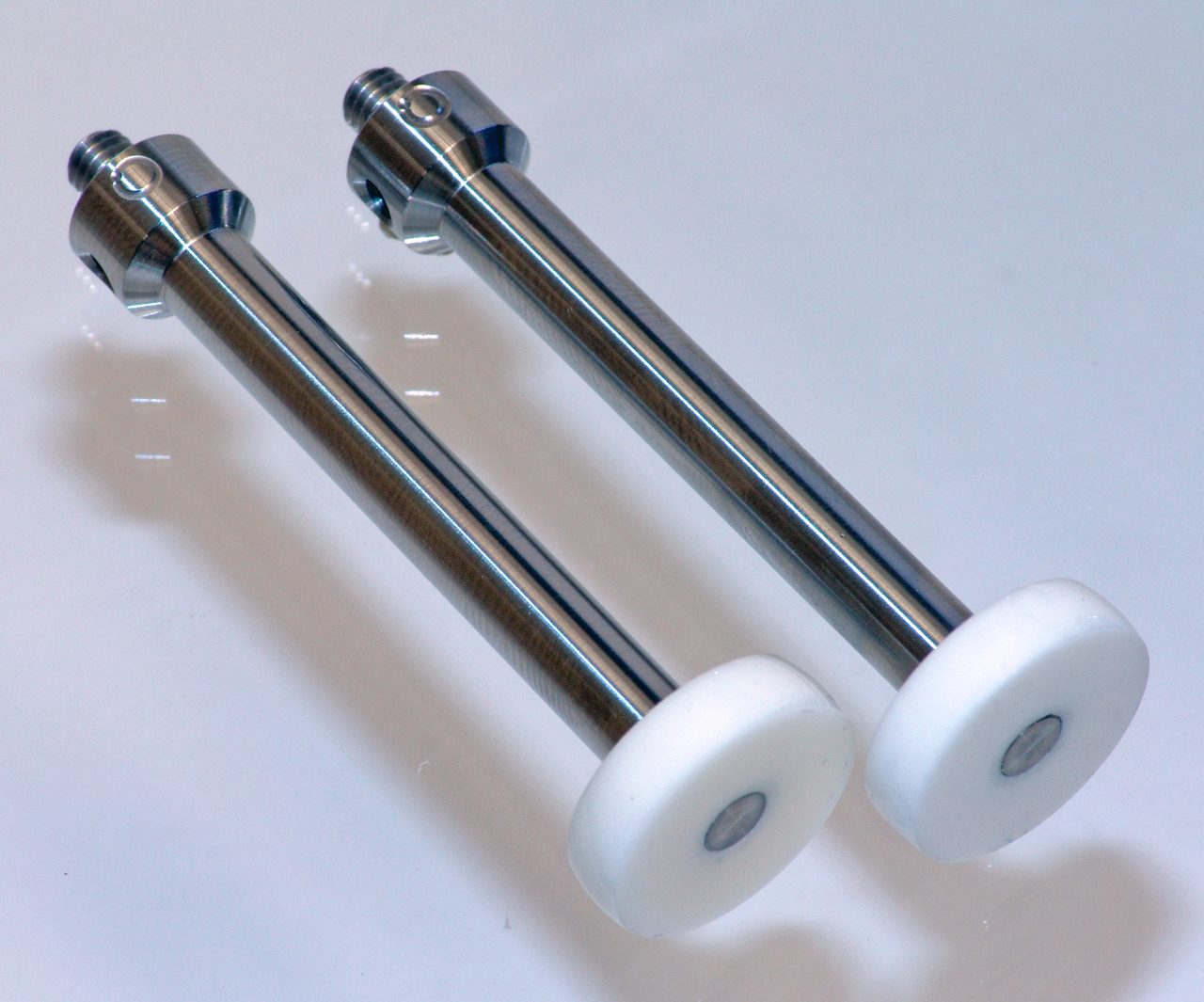

What Is a Disk Stylus?
A disk stylus is like a normal spherical stylus, except that most of the top and bottom of the sphere is removed, leaving just the middle portion remaining. (Figure 1) Like spherical styli, disks can made from many materials, including ruby, ceramic, tungsten carbide, silicon nitride, aluminum, and hardened steel. Disk diameters usually range from smaller than five millimeters to more than 50 millimeters. They can be wafer-thin, or several millimeters thick. (Figure 2)

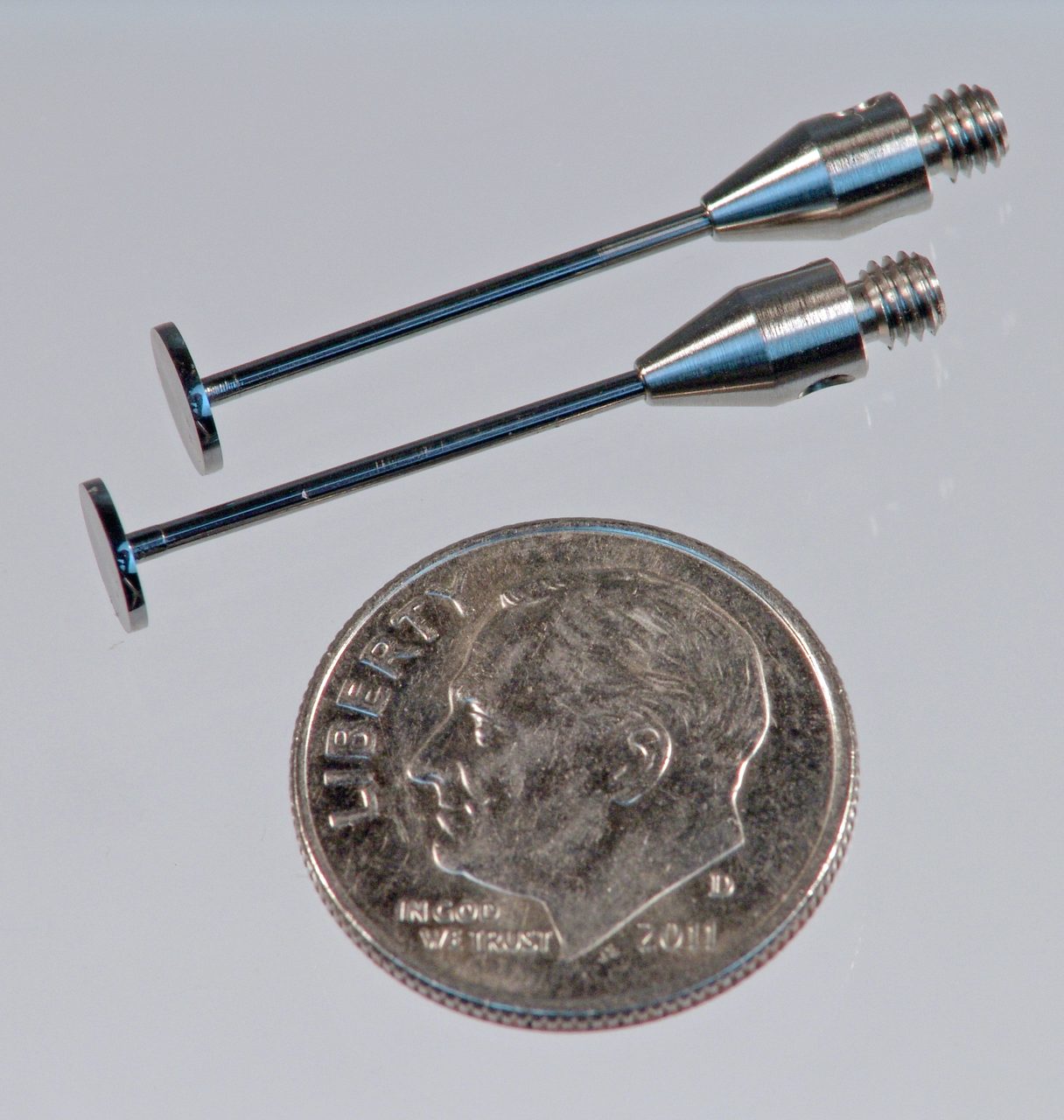

Figure 3: Inspecting an O-ring groove
How Are Disk Styli Used?
Disk styli are generally used to probe internal diameters, especially ID grooves, like O-ring seats. Disk styli are widely used to inspect hydraulic components. (Figure 3) They’re also useful for larger bore diameters because a large diameter disk can reduce overall axis motion and thus speed up inspection throughput. Disk styli can be used on measuring machines equipped with either tactile (point-to-point) or continuous scanning probe heads.

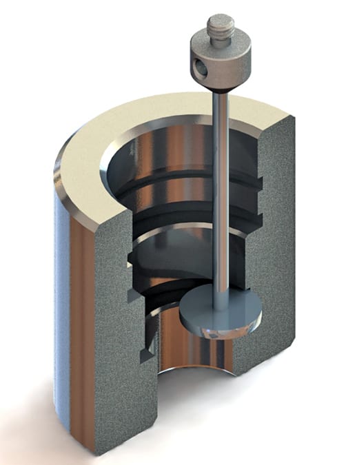

Figure 4: Disk probe qualification
How Do You Qualify a Disk Stylus?
This question gets asked so often that we’ve added it to our website. When qualifying a disk stylus, the goal is to re-create the complete sphere for the qualifying computer. If possible, you should use a reference sphere whose diameter is close to the disk’s diameter. You’ll need to touch at least twelve points on the disk, in this order. (Figure 4) First, touch four points approximately equally spaced around the disk’s midpoint, or equator. Second, move half the distance to one side of the disk, and touch four more equally spaced points all around. Finally, move to the opposite side of the equator and touch four more points equally spaced all around. Compute the result. If the standard deviation exceeds your established qualification protocol, repeat the process, adding more points at each step.
