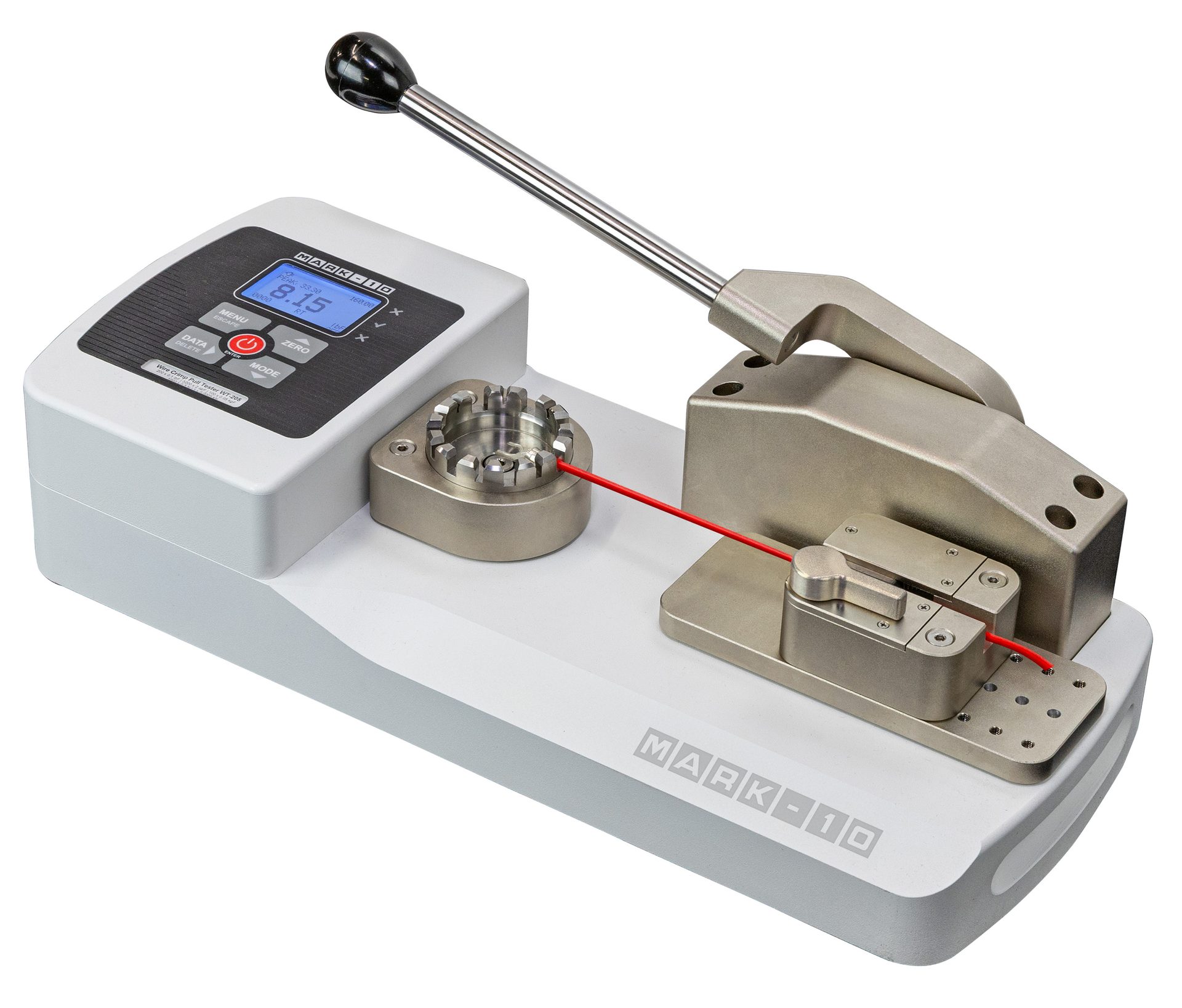

Force measurement analyzes the amount of compression (push) or tension (pull) an object experiences in order to assess its quality and performance. Testing by hand with a suitable gage or sensor is a simple and quick option, but more reliable data is achieved by benchtop systems that control the angle and speed of force actuation. One force measurement application seeing growing interest is wire terminal testing, in which a controlled pull against a crimped connection produces a force measurement, characterizing its integrity and quality.

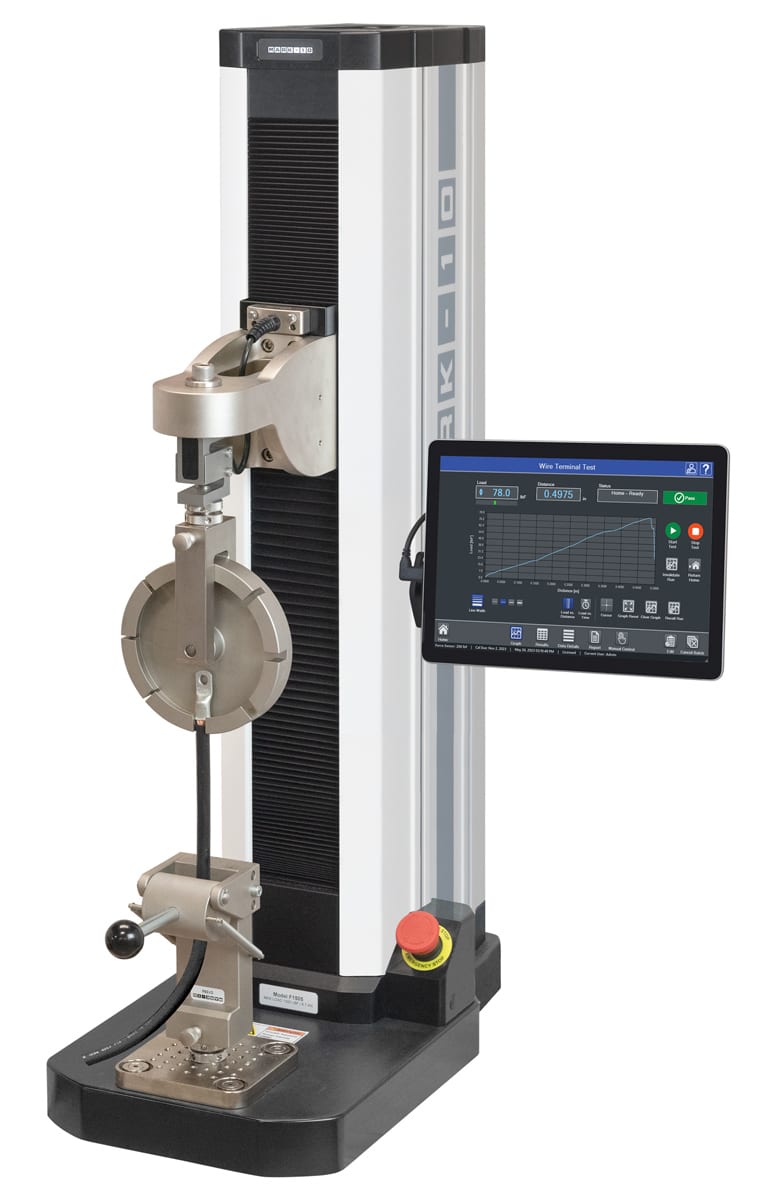

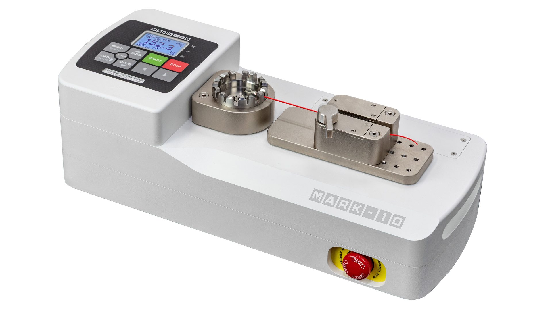

Wire terminal testers generally involve a mechanism to apply a test force, a grip to hold the terminal, a grip to hold the wire, and a load cell and electronics to process and display the data. Force results may include a date and time stamp and pass/fail indicator according to pre-configured acceptance limits.

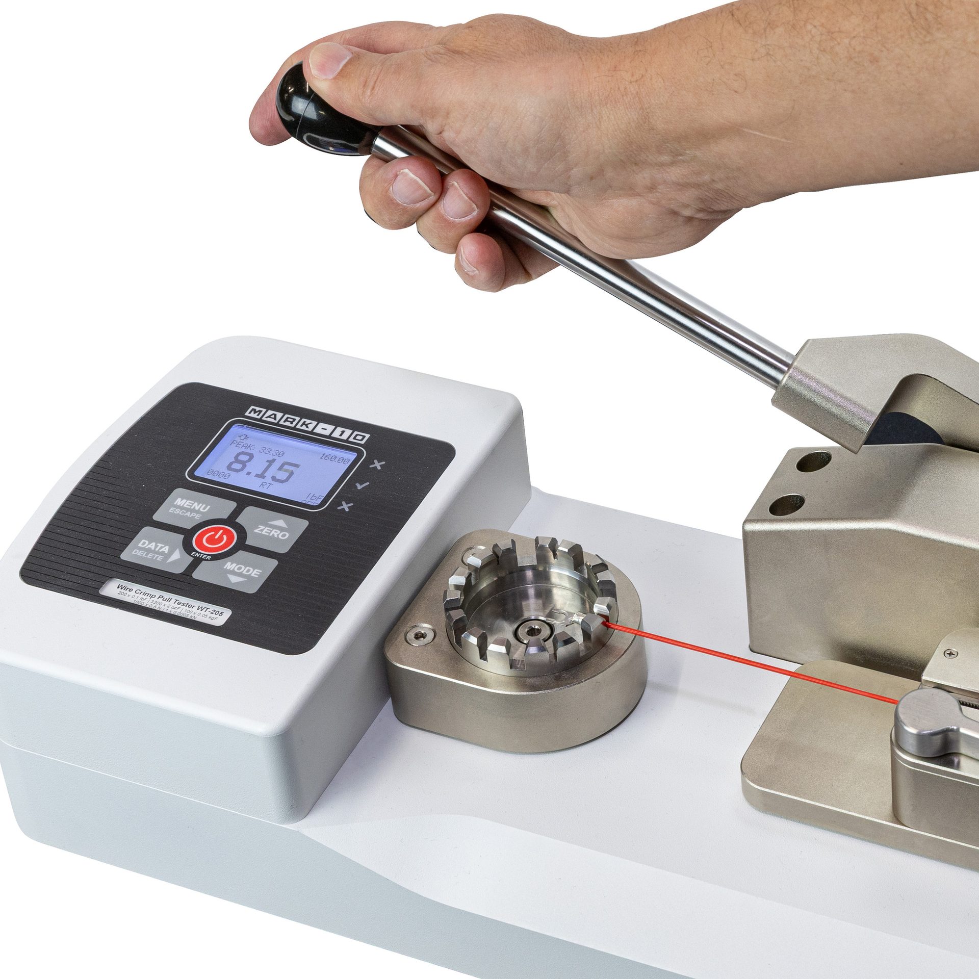

During the test, which can be conducted using either a lever- or wheel-operated manual system, or a motorized tester, the actuator speed should be controlled to yield the most repeatable possible results.

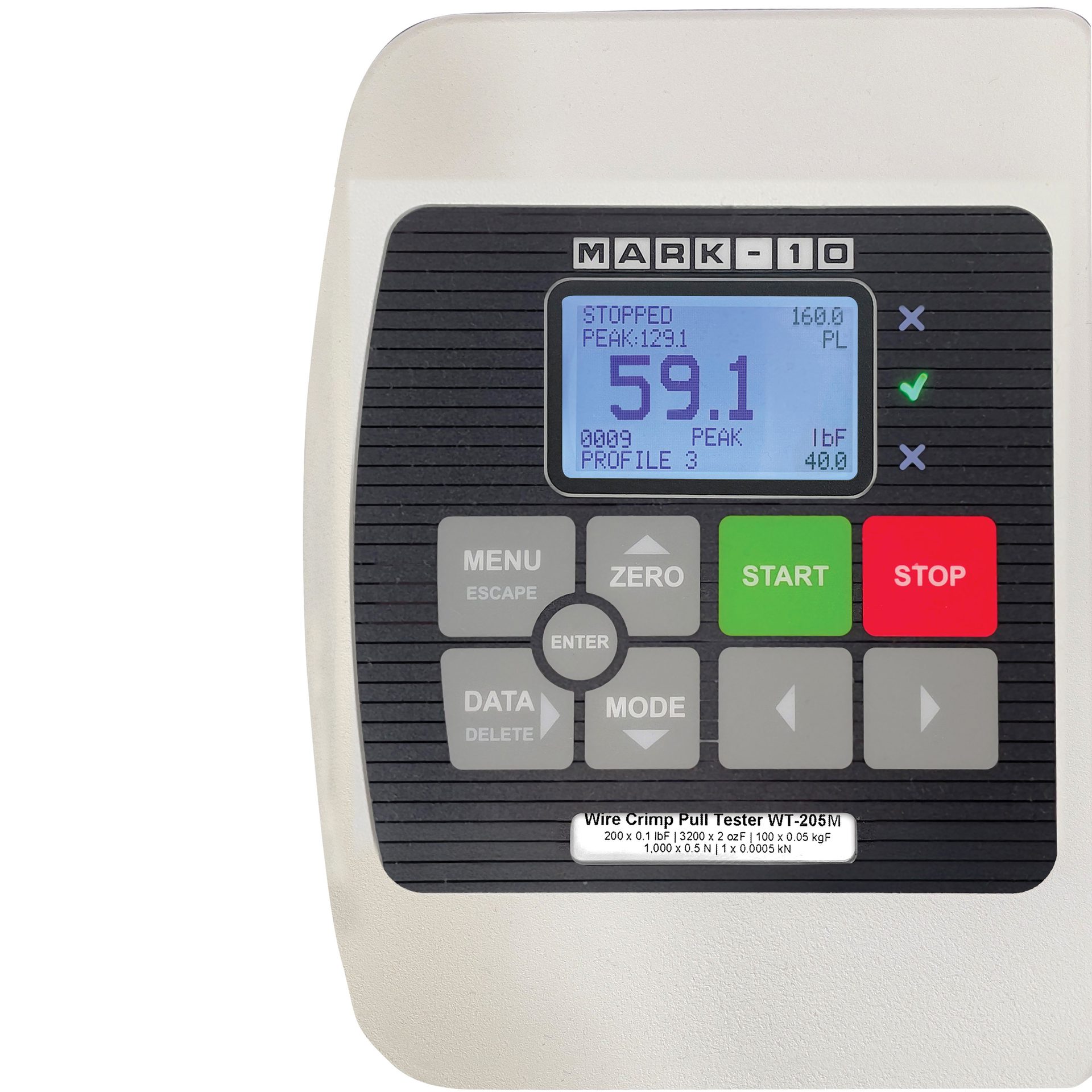

Three common test methods are (1) pull-to-failure, a destructive test which applies force until the wire separates from the terminal, (2) pull-to-load, where a sample is deemed acceptable if it remains attached at a target force, and (3) load-hold, where a sample is held at a target force for a specified amount of time. Results for these tests are typically measured in lbF (pound-force), kgF (kilogram-force), or N (Newton) units. Other data that may be included are test speed (in/min or mm/min) and location of failure, which can identify if there is an issue with the crimp or the wire itself. Results depend on several factors like wire gauge, type of terminal, crimping process and crimping tool condition, type/quality of wire, and environmental factors like temperature and humidity.

Although it may seem logical that a higher force measurement represents higher quality, it’s not always the case. Higher forces may be a symptom of over-crimping, in which incorrect or faulty tools excessively crimp the terminal. Over-crimping can be just as problematic as weak crimping and may lead to a brittle, easily broken connection. Industry testing standards like UL 486A specify the force required to pull a terminal off a wire as well as the speed of the pull. These harmonized processes allow data to be seamlessly shared amongst vendors up and down the supply chain.
