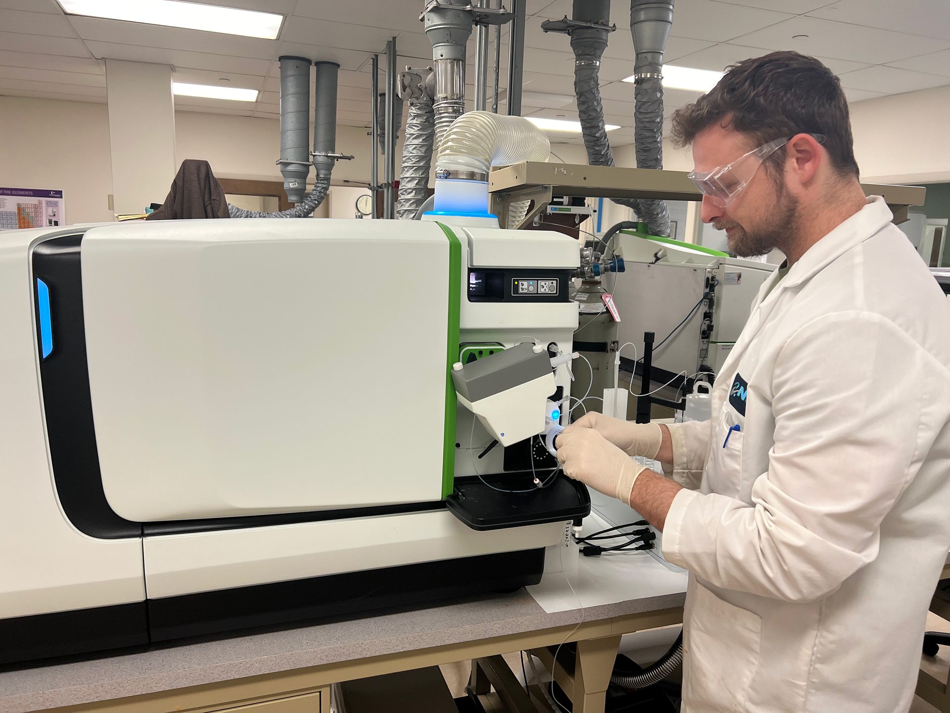

Inductively Coupled Plasma (ICP) is the most broadly applicable and is an analytical chemistry method used to detect and measure elemental composition in a wide range of materials. It covers approximately 70 elements ranging from lithium to bismuth. The metal to be measured is first dissolved into a liquid that is then analyzed for chemical composition using the ICP instrument. Figure 1 shows an image of an ICP mass spectrometer used for chemistry composition testing.
Figure 1: ICP Mass Spectrometer used for chemistry testing of metal powders for additive manufacturing.
Two other methods are used for light elements like oxygen, carbon, nitrogen, sulfur, or hydrogen. Combustion analysis rapidly decomposes the material in an oxygen-rich gas to measure the carbon and sulfur contents. Inert gas fusion uses a noble gas during heating of a sample to collect the dissolved oxygen, nitrogen, and hydrogen for detection.
By combining the ICP, combustion analysis, and inert gas fusion a full chemistry for metal additive parts and feedstocks can be determined. This analysis can reach detection levels of parts per million, and lower in some cases, for elements like titanium, nickel, niobium, or copper as well as light elements such as oxygen, carbon, hydrogen, or nitrogen.

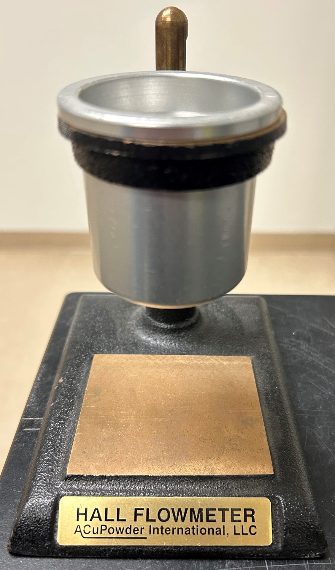

Flow rate and flowability is important because it determines how well the additive powders will consistently move through additive printers. The simplest flow rate measurement is the Hall flow rate test. In the Hall flow test, the powder is measured on how quickly a standardized volume of material passes through an orifice, much like an hourglass. Figure 2 shows an image of a Hall Flowmeter, the silver cup at the top is the metal funnel.
This is one of several conventional static funnel flow techniques and a standard test for powder flowability. Additionally, several dynamic avalanche rheometry techniques are growing in popularity and have ongoing working groups with ASTM B09 committee to develop into standard techniques. These tests come in a few forms with the most common being the rotating transparent drum that observes the avalanching behavior of the powder being tested. These dynamic powder testing techniques can generate highly reproducible data that correlates very well with various metal powder properties.

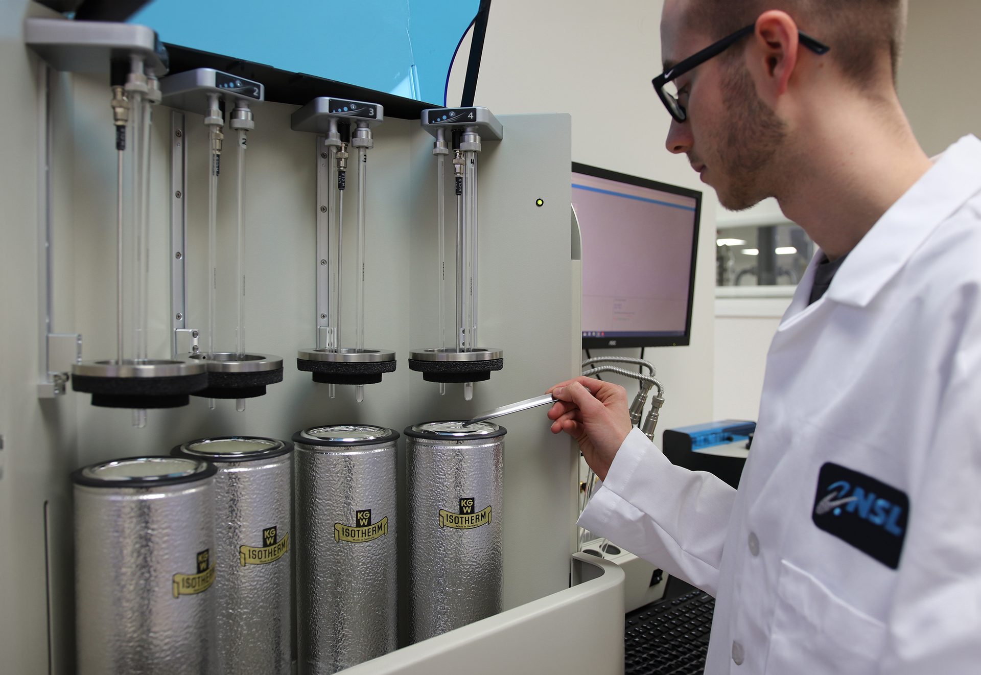

Surface area is measured by a method using the multipoint equation of Brunauer, Emmett, and Teller (BET) that utilizes nitrogen or krypton inert gas to encapsulate the particles and determine their surface area. Surface area is important because it impacts flow properties, for example sorting spherical vs. sharp features of powders. The sharp features would have more surface area and impact flow properties that can be measured using BET. Figure 3 is an image of a BET surface area analyzer instrument:

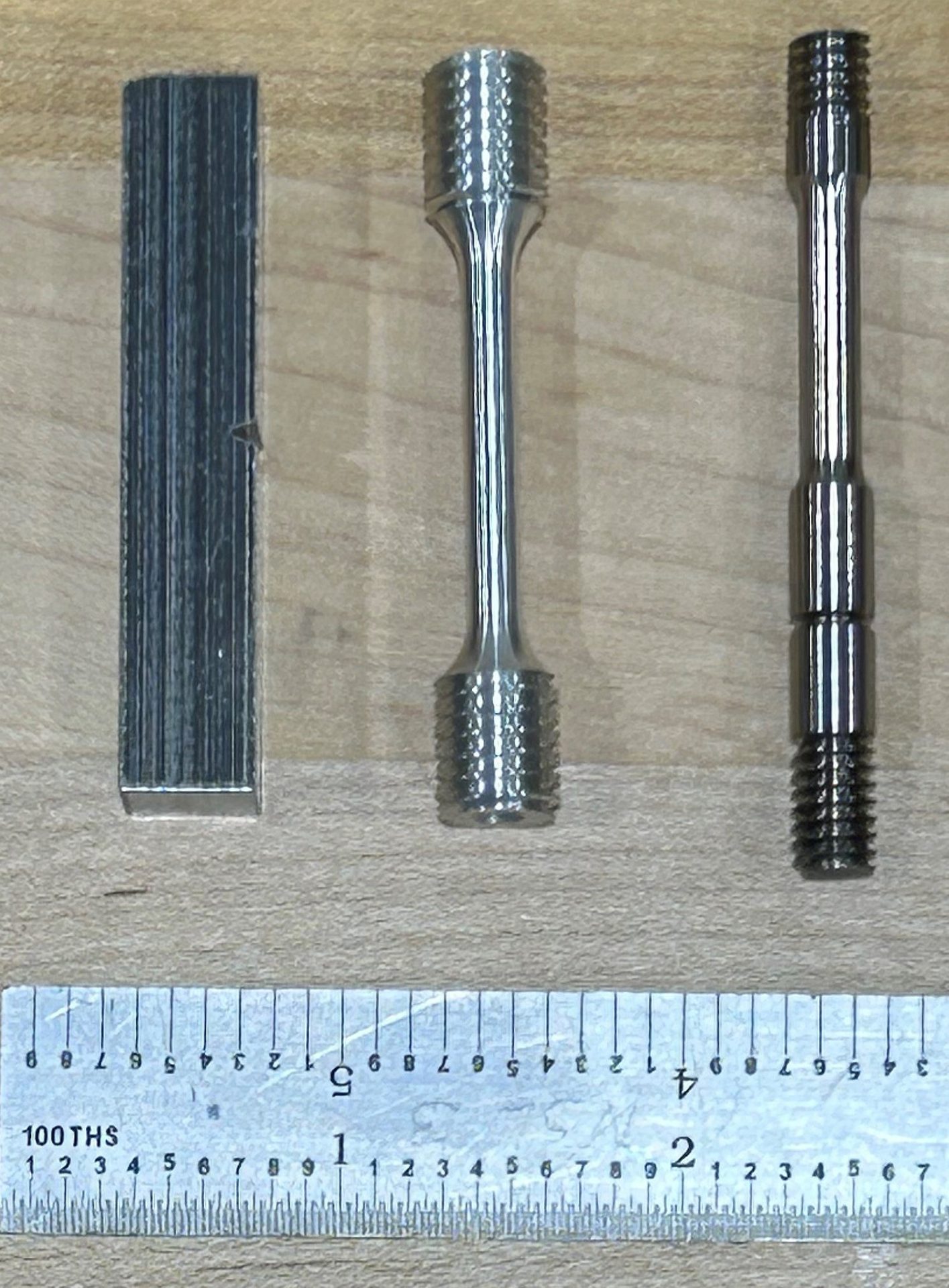

Tension testing is the most common method for testing the strength, stiffness, and ductility of metals for all applications. In conventional manufacturing, tension tests have been proven to be highly repeatable and reliable making them ideal for qualification and production monitoring for metal additive manufacturing processes. One advantage of metal printing is that the witness samples can be printed alongside the part itself, which simplifies the production and testing of samples like tension tests.
The Charpy impact test is a high strain rate test that determines the amount of energy absorbed by a material during fracture. This provides information on the malleability of materials, which helps determine the shock-absorptive properties of a material.
Figure 4: Examples of standard mechanical testing samples used for metal additive manufacturing testing including Charpy impact testing (left) round bar tensile testing (center) and combination notched stress rupture testing (right)
Elevated temperature testing for mechanical properties is critical for aerospace applications. The stress rupture test can be completed in a furnace with various configurations and loading methodologies. This includes smooth round bar tensile specimens and notches that provide information on the lifetime of a material at elevated temperatures and high stresses, like the blades of a rotating engine. Figure 4 is an image showing examples of mechanical testing for metal additive samples including Charpy impact testing, round bar tensile testing, and combination notched stress rupture testing.
