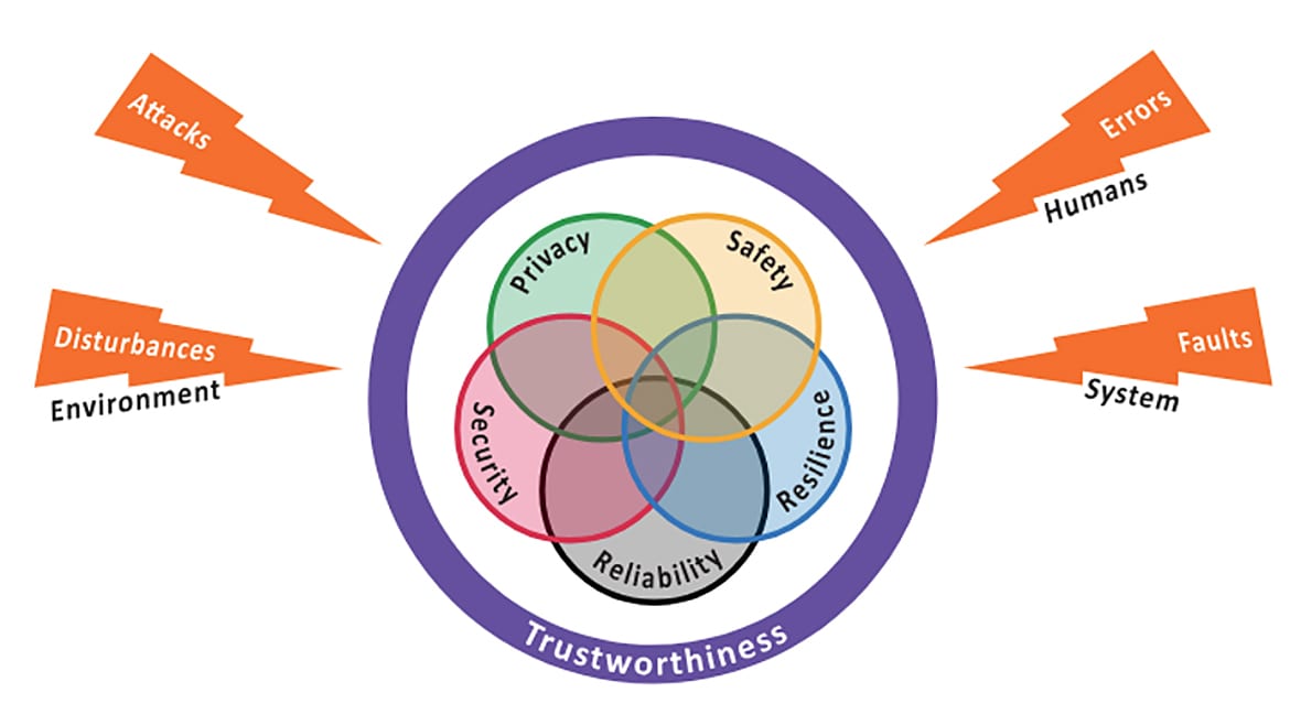

As described above, one of the six groups contained in the Capabilities Periodic Table is Trustworthiness. In terms of digital twins, Trustworthiness is directly associated with the reliability of the virtual in representing its physical counterpart. Trustworthiness is “The degree of confidence one has that the system performs as expected. Characteristics are represented by Figure 1, and include safety, security, privacy, reliability and resilience in the face of environmental disturbances, human errors, system faults and attacks”6
 Trustworthiness characteristics and threats
Figure 1. Trustworthiness characteristics and threats7

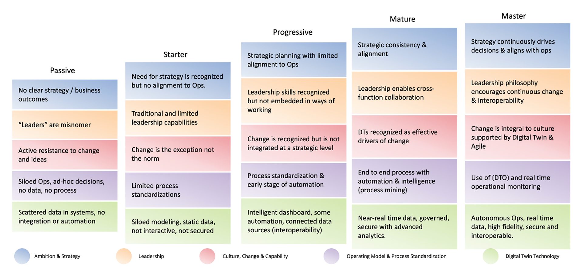

Business Maturity Model
The Business Maturity Model for Digital Twins10 assesses an organization’s ability to implement and leverage digital twins effectively. It involves multiple maturity levels and evaluates factors like digital infrastructure, data management practices, and workforce skills. The stages and levels help organizations systematically plan, implement, and enhance their digital twin capabilities, ensuring alignment with business goals and technological advancements. The model helps to calibrate and provide guidance to determine whether an organization can effectively develop and utilize digital twins to achieve its business objectives.
Figure 2. Business Maturity Model. © 2024 Digital Twin Consortium. All rights reserved

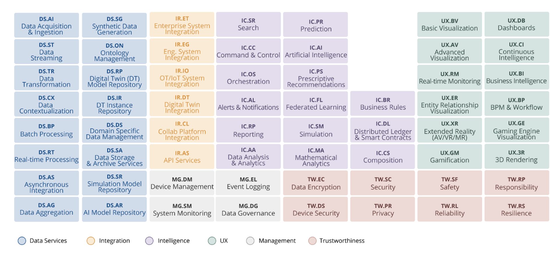

At the core of the composability framework, the Digital Twin Capabilities Periodic Table (CPT) V1.1, provides an architecture and technology agnostic definition framework that focuses on use case capabilities requirements versus the features of the technology solution. The capabilities are organized into six categories: Data Services, Integration, Intelligence, User Experience (UX), Management, and Trustworthiness. Each category encompasses a range of capabilities essential to digital twin development and subsequent lifecycle phases. The recently released CPT Version 1.1, led by the DTC Composability Framework Subgroup, introduces enhancements, including ‘Responsibility’ as a core capability, emphasizing ethical considerations, and a new ‘Search’ capability for efficient data management. Additionally, it consolidates Augmented and Virtual Reality into Extended Reality (XR) and reclassifies temporal data stores under "Domain Specific Data Management." Structured abbreviations have been adopted for quicker reference, and detailed capability mapping aids the transition from version 1.0.
Figure 3. Capabilities Periodic Table. © 2024 Digital Twin Consortium. All rights reserved
A complete Capabilities Periodic Table toolkit is provided for those looking to utilize the CPT and is publicly available at https://www.digitaltwinconsortium.org/initiatives/capabilities-periodic-table/. The toolkit includes a user guide11, worksheet, and conversion table to use the toolkit spreadsheet effectively. Looking ahead, CPT Version 2.0 aims to enhance AI interoperability, integrate geospatial computing, and improve user experience. This initiative encourages community collaboration to shape future updates, highlighting the consortium’s collective effort in advancing digital twin technology.12

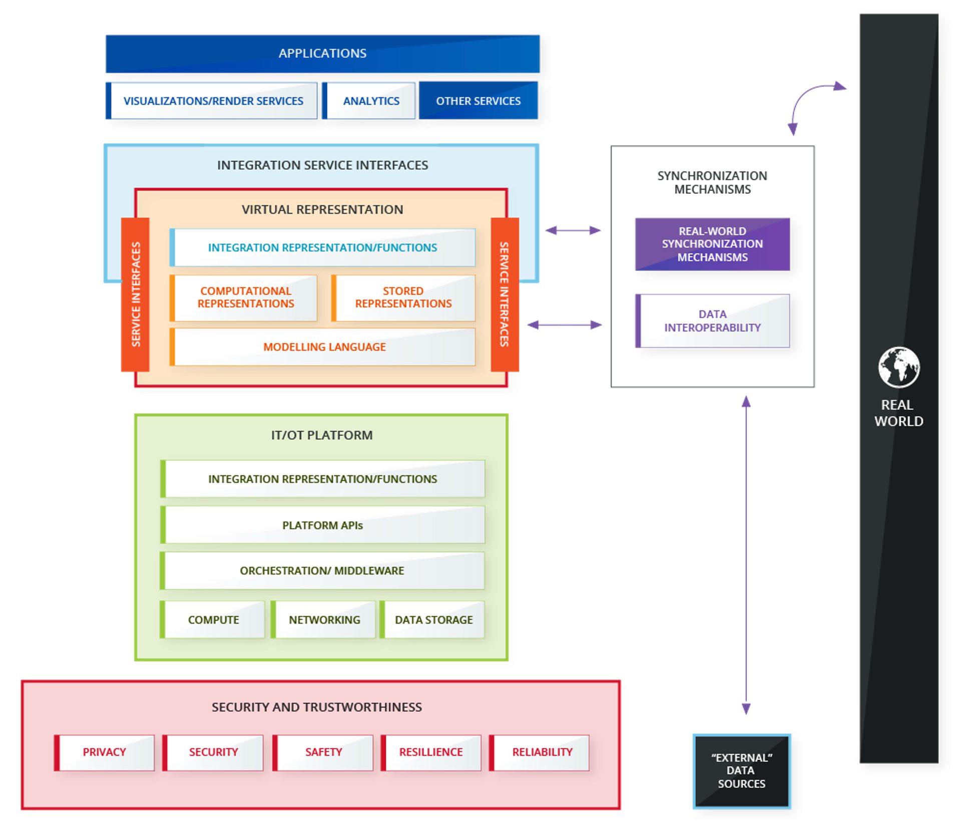

Platform Stack Architectural Framework - Architectural Considerations
The Platform Stack Architectural Framework White Paper by the Digital Twin Consortium, https://www.digitaltwinconsortium.org/platform-stack-architectural-fram-formework-an-introductory-guide-form/,outlines the essential concepts, capabilities, and components to develop digital twin systems. It discusses the foundational requirements for real-time data integration, virtual representation, and synchronization between physical and virtual entities. The paper defines criteria for qualifying digital twin systems, highlights the importance of security and IT/OT integration, and provides reference architectures for building systems-of-systems with composable twins. Additionally, it presents practical use cases across various industries and aligns the framework with other industry standards and approaches, such as RAMI Industry 4.0 and cloud-based architectures, to ensure interoperability and effective implementation.
Figure 4. Platform Stack Architectural Framework. © 2024 Digital Twin Consortium. All rights reserved

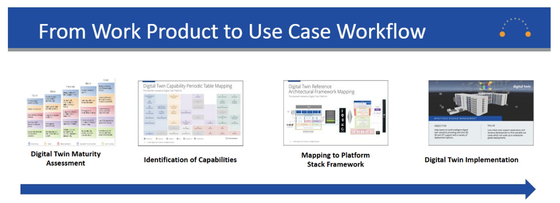

Composable Framework Workflow
The Business Maturity Model, Capabilities Periodic Table, and Platform Stack Architectural Framework combine to provide a holistic view and Composable Framework Workflow for digital twin development and implementation focusing on key quality attributes. The workflow spans the entire Digital Twin Lifecycle, from planning to deployment to operation, maintenance, and decommissioning. When developing a digital twin, it is advisable to begin with a specific use case and determine the purpose the digital twin needs to serve for that use case. Once this is established, the data and capabilities requirements can be identified using the Capabilities Periodic Table and then mapped to the Platform Stack Architectural Framework. Technology and vendor selection can be done once these steps have been completed (Mckee, 2024). Oftentimes, this process is done in reverse, which can produce undesirable results.
Figure 5. Composable Framework Workflow. © 2024 Digital Twin Consortium. All rights reserved
