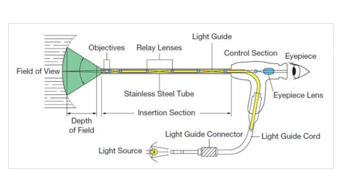

Several industries have utilized RVI/T including borescope (rigid and flexible) and videoscope.

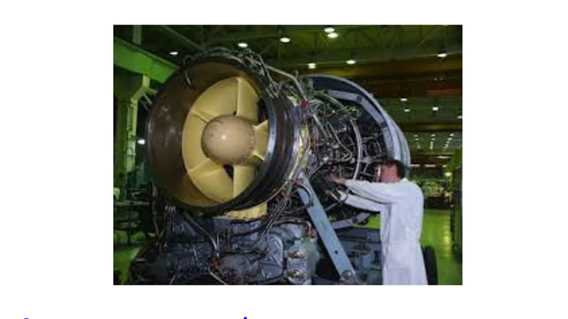

Aerospace jet engines are inspected by videoscopes.

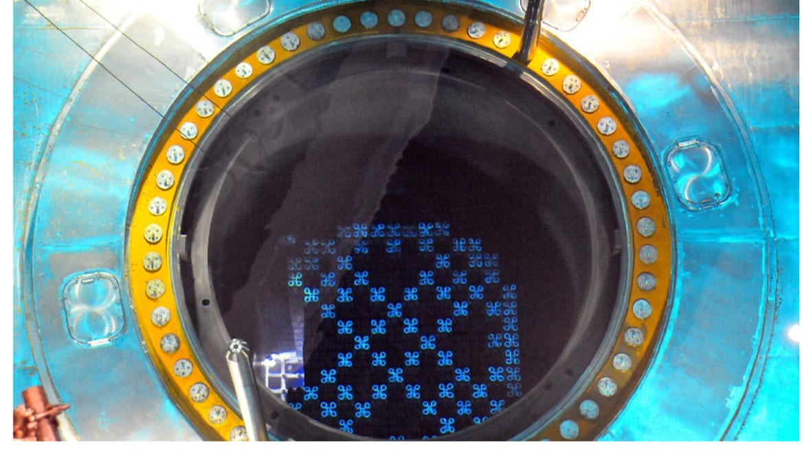

Nuclear power plants utilized remote visual testing for the In-Service Inspection (ISI), ASME Section XI programs. This includes reactor vessel internals and removable components which are inspected by remote underwater cameras. Some on a pole and some within remote operating vehicles (ROVs). The top of reactor vessels (PWRs) has been inspected by RVI crawlers looking for leaking control rod penetrations in high radiation areas with hard to access configurations.

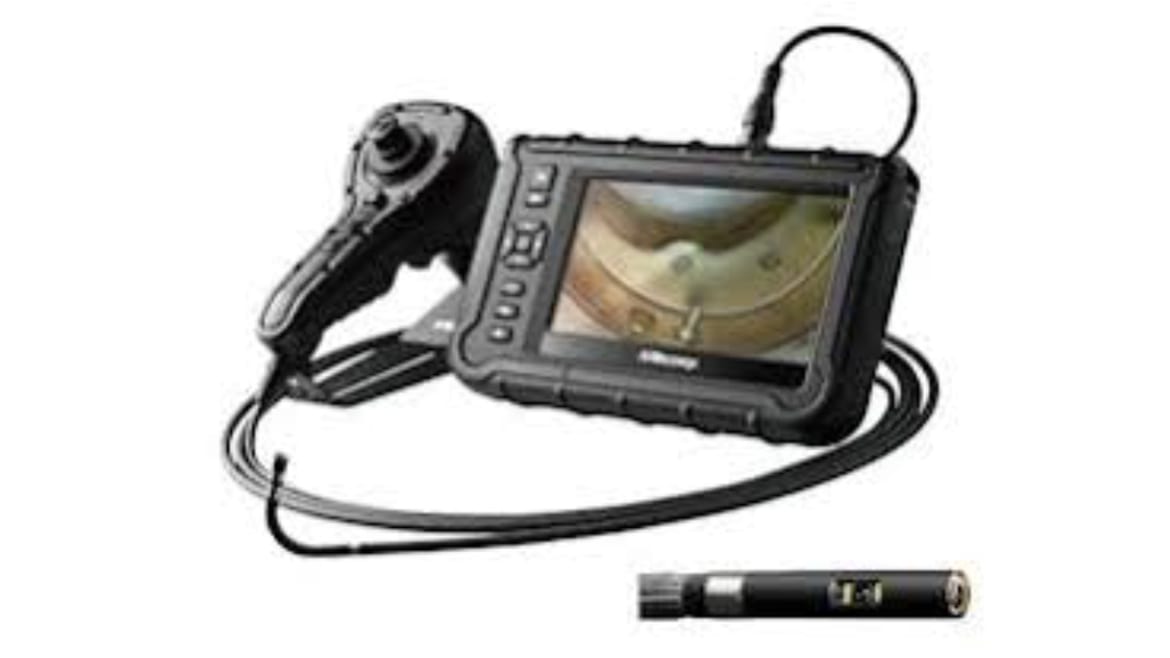

Borescope

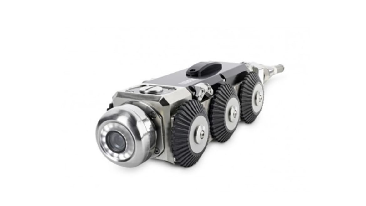

Sanitation system piping has been inspected by rover wheeled devices.
Industrial Rovver™

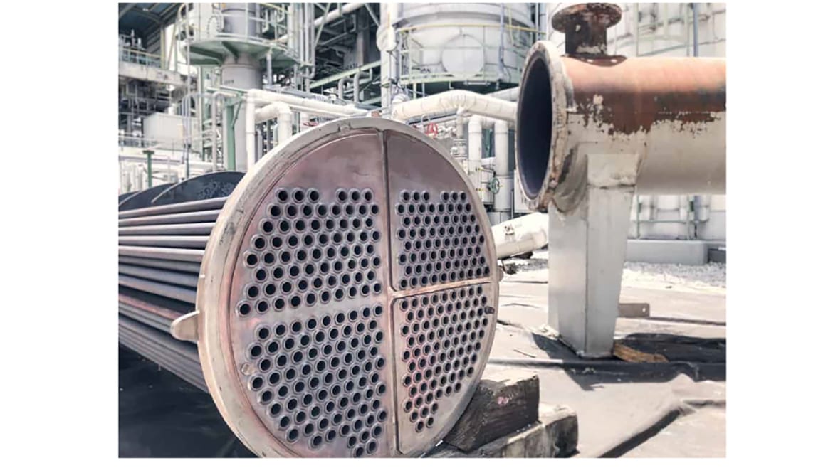

Power plant heat exchanger tubing IDs are inspected by push tube cameras. Size of tubing is determining factor in selecting size of video probe to be utilized.
Jet Engine Remote Visual Inspection
Video Borescope for jet engine internals
Videoscope

Reactor Vessel Internals
Heat Exchanger Tubes

Remote Operated Vehicular Under Water Cameras for Reactor Vessel Insternals
Underwater Cameras in high radiation environments

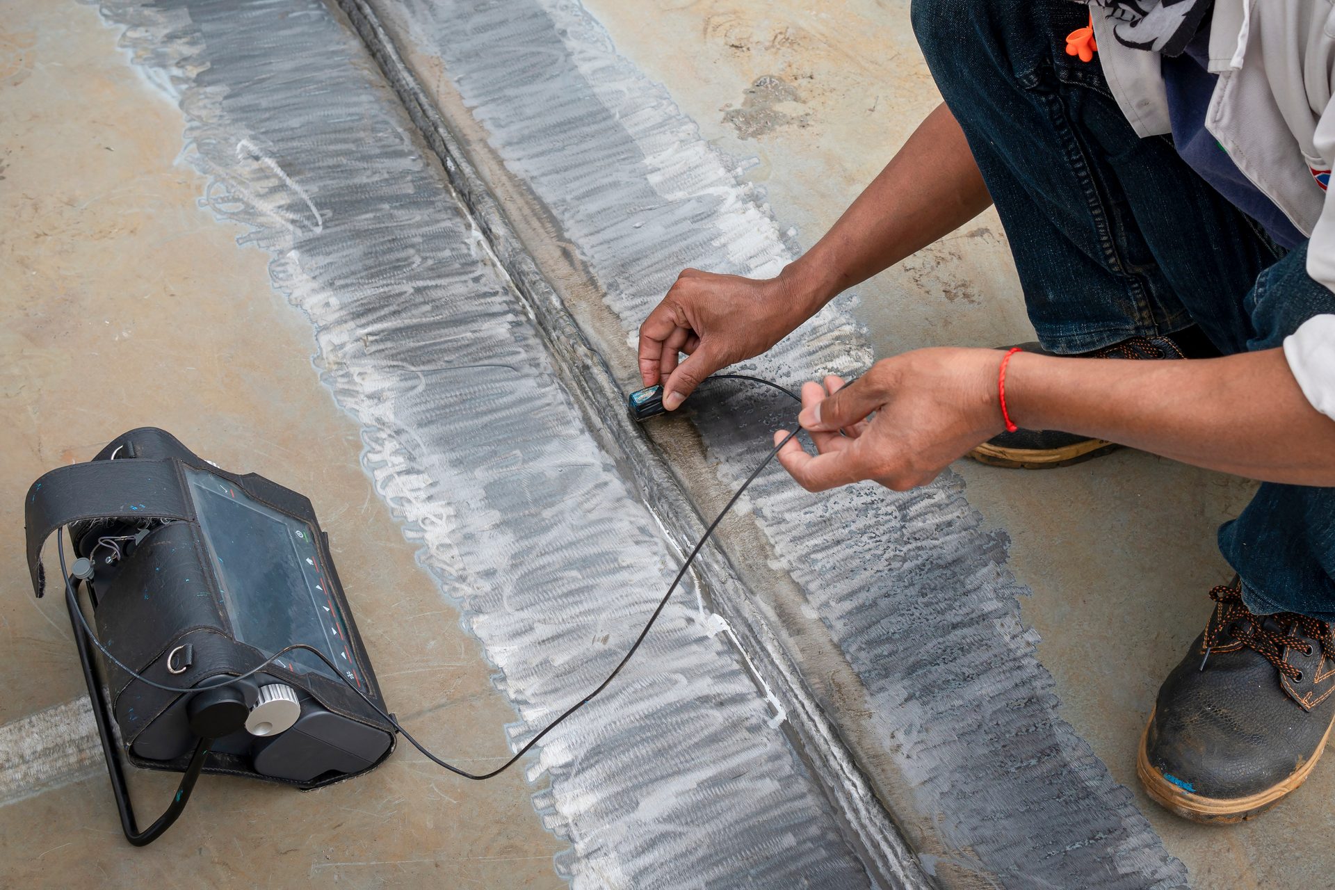

ULTRASONIC TESTING (UT)
Ultrasonic testing (UT) by phased array transducers is the biggest difference to come along in recent times. The big difference between conventional UT and phased array UT is the transducer. Conventional UT’s use single-element transducers or paired element transducers, one for transmitting and one for receiving, to generate and receive ultrasonic sound waves. When using a single frequency and angle ultrasonic transducer multiple change out of the transducer and angle wedge utilized would be needed to achieve maximum coverage and optimum angle to best reflect of the surface of the discontinuity being sought. This is very time consuming. With phased array UT the single pass over an area of interest can yield multiple angles and frequencies to assure the optimum ability to detect various oriented and surface reflective conditions needed to detect discontinuities.
Automated ultrasonic testing (AUT) uses mechanized scanners that are computer controlled to move transducers over the surface of the material being inspected. As the transducer moves, the computerized system acquires ultrasonic inspection data from a predefined programed pattern.

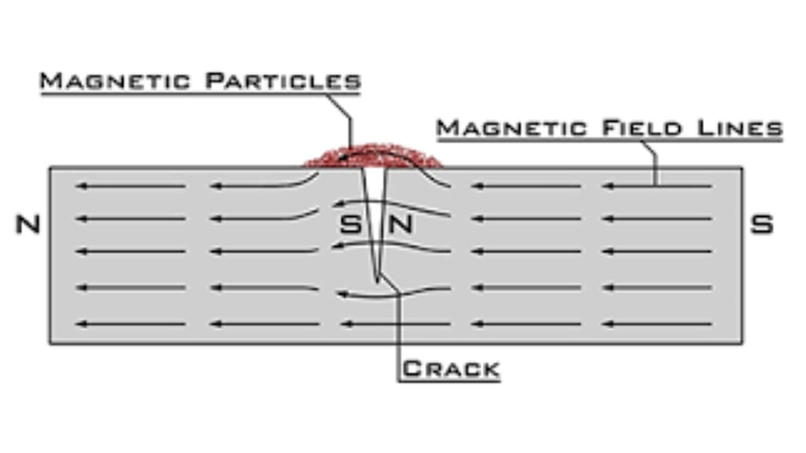

Magnetic Particle Testing

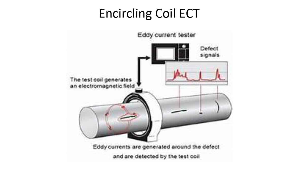

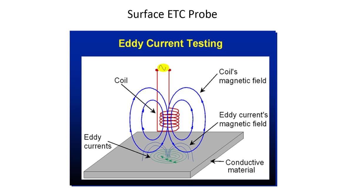

If inspecting a solid object with an encircling coil, only the surface is being examined. Conversely, if the eddy current coil is in a probe inserted to a tube and the thickness of the tube wall is less than the effective penetrating depth of the electro-magnetic energy, then it may be classified as volumetric.

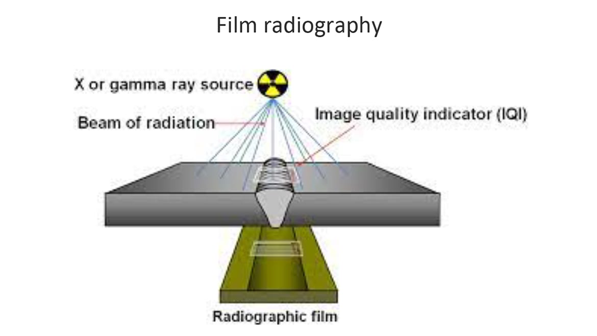

Film radiography

Surface ETC Probe
EDDY CURRENT TESTING (ECT)
Automated inspection eddy current is ideally suited to inspection automation particularly of so called rotationally symmetric components as it is a non-contact technique where coupling is not needed, and no-effluent is produced.

Encircling Coil ECT
