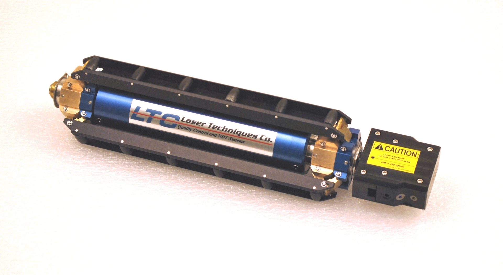

For roughly the past 25 years, a laser-based NDT method, referred to as laser profilometry (LP), has progressively become accepted as an accurate and reliable solution to many challenging NDT applications. In many cases, laser bore inspection systems provide a superior alternative to conventional mechanical gages and camera-based systems. Laser profiling sensors have significantly larger measurement ranges than air gages and mechanical star gages. They can rapidly scan the gun tube surface in a non-contact manner, generating high-resolution, three-dimensional images that are quantitative and highly accurate. These sensors project a tiny laser spot onto the part surface and operate on the principle of optical triangulation or laser interferometry. LP sensors can acquire millions of samples per scan, and data can be evaluated using any of several analysis and 3D visualization software packages. Test results can also be automatically post-processed and displayed in a graphical or tabular summary report.

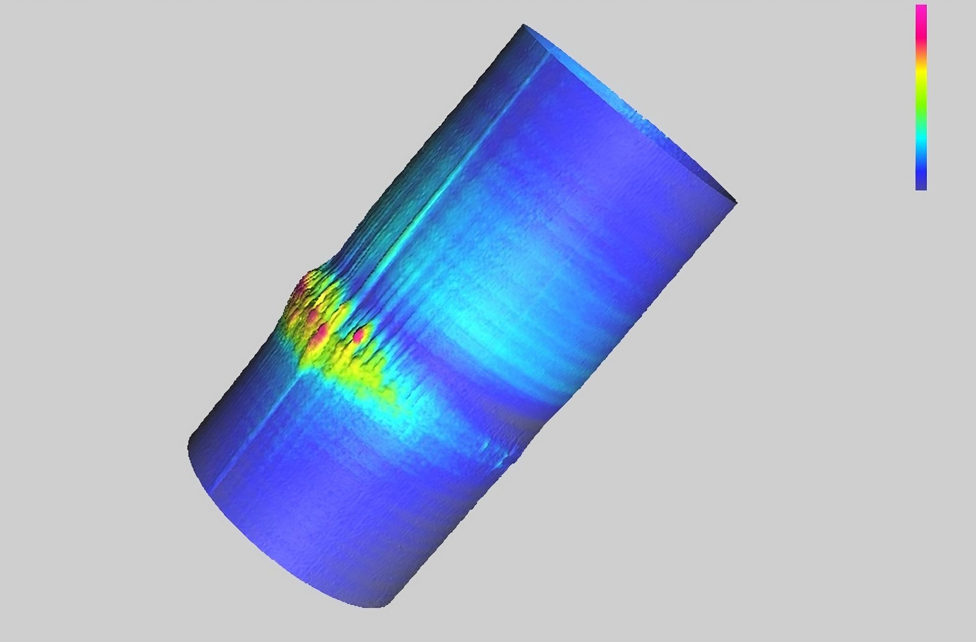

Failure mechanisms such as erosion, pitting and corrosion can shorten the life of a system and create a potentially dangerous situation for the operator. Coupling automatic feature detection software with Laser-based NDT data can allow operators to rapidly process large volumes of data and efficiently produce reliable test results.

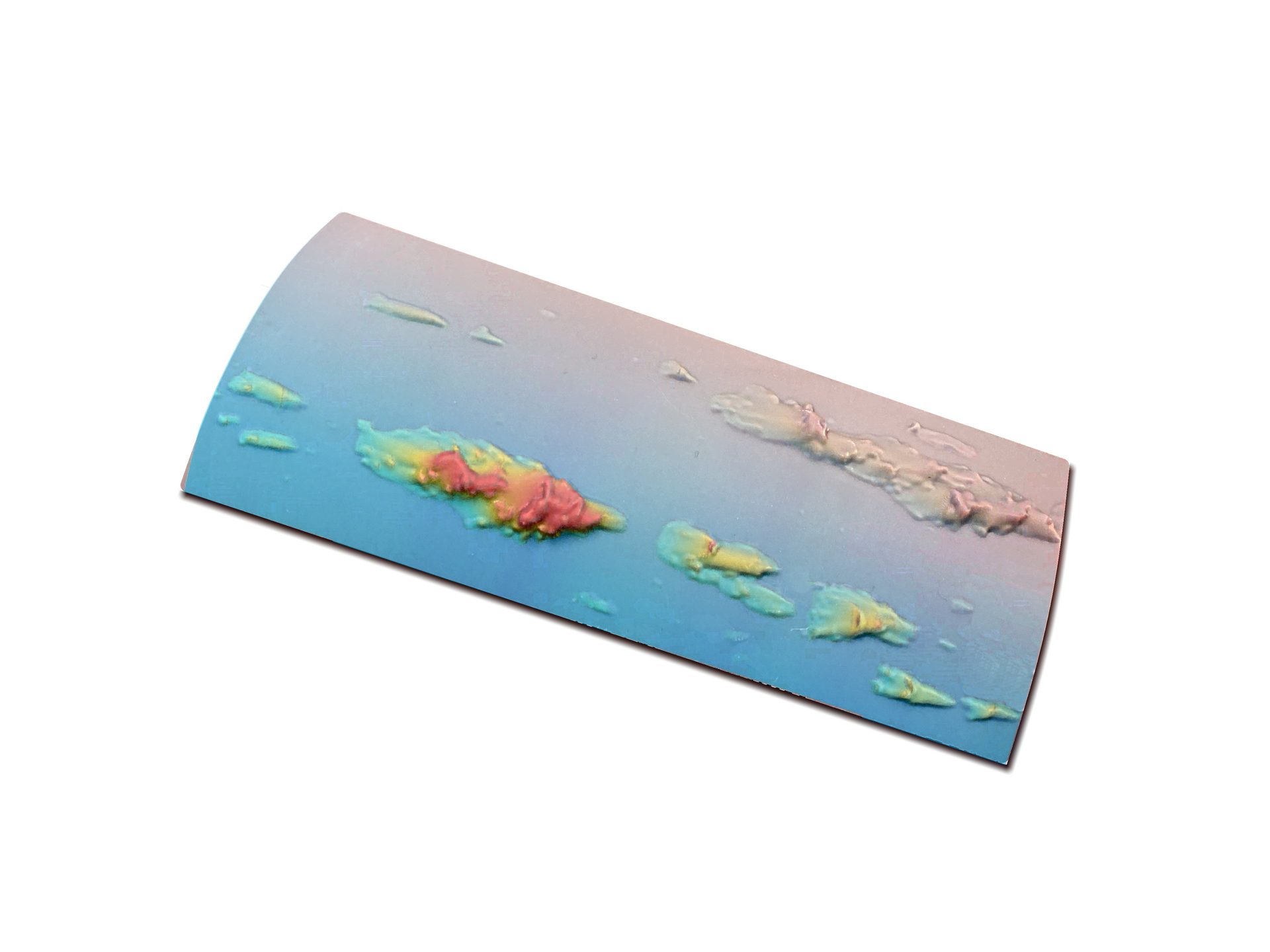

Laser-based NDT methods are often used in highly challenging applications such as rocket thruster inspection, gas generator injection stems, composite overwrapped pressure vessels (COPVs) and jet engine turbine rotor bores. In these and other cases, the test article is high value and safety-critical. Because laser-based profilometry is non-contact and highly precise, it can provide solutions to extremely challenging applications.
One example of an automated, laser-based scanning system is in use by a major aircraft engine manufacturer. Until recently, operators would conduct visual maintenance inspections using a simple borescope. If operators visually located potential erosion or pitting, they would then make a rubber replica of the feature, then cut it into small sections that would be measured with an optical comparator. The detection of features greater than a few thousandths of an inch in depth could require the component to be re-worked at great expense, or condemned altogether. This process is time-consuming and subject to the operator’s judgement and visual acuity. By converting over to a laser-based profilometry method, inspection times are reduced and quantitative results are now generated that are not subject to operator judgement.

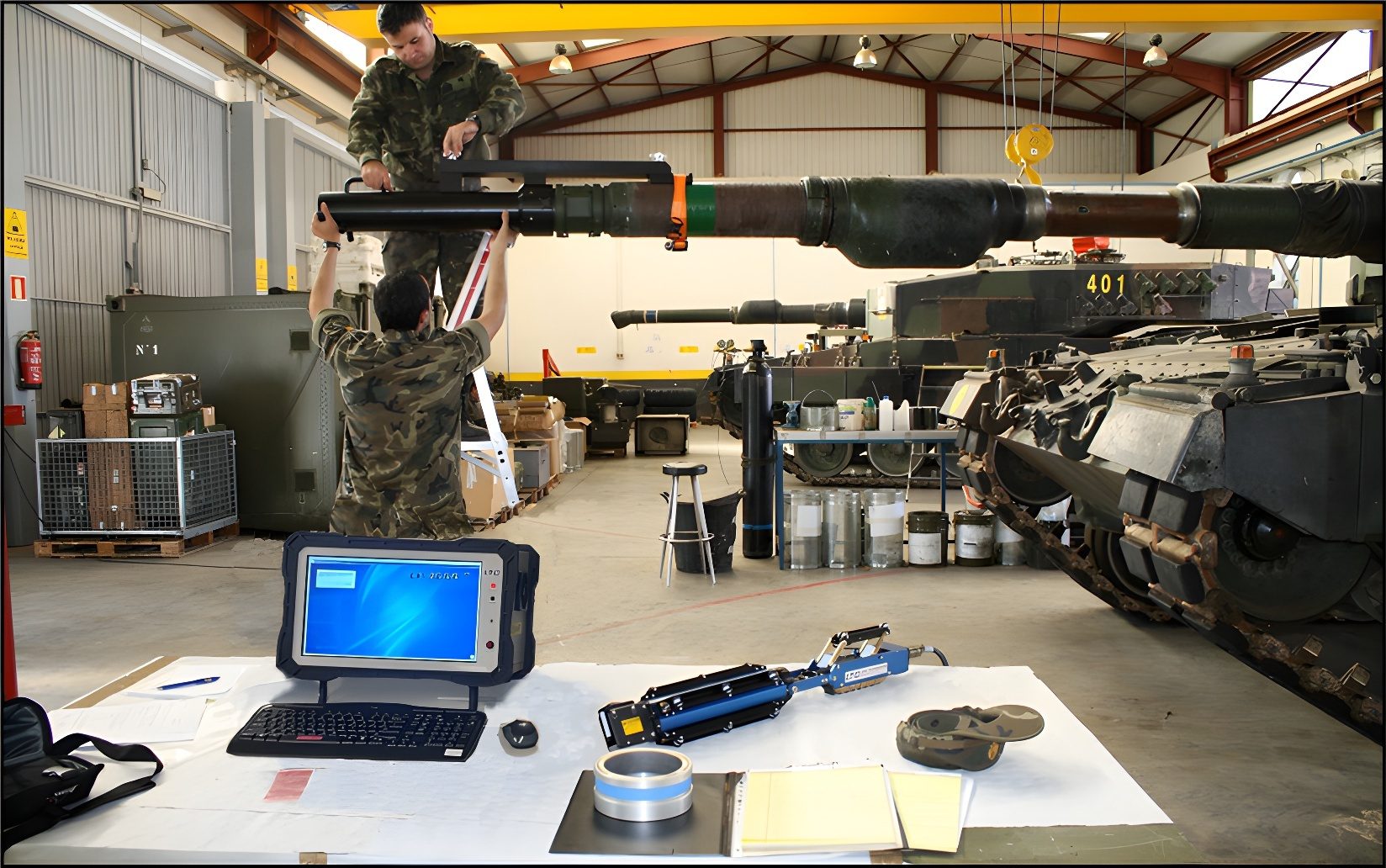

In 2003, a civilian engineer working at Yuma Army Proving Ground, Mr. David Le, became aware of the work the author was doing in the field of laser-based NDT. Mr. Le, a Level III in several NDT methods, saw the potential of applying Laser-based NDT methods to weapons inspection and virtually single-handedly drove the introduction of Laser-based NDT methods for both quality control and field maintenance applications for the U.S. Defense industry. Today, every cannon and howitzer barrel manufactured by the U.S. Army is inspected using laser testing methods, with high-resolution surface maps of the entire barrel inner surface instead of a few measurements over the barrel length. The technology is now used for small, medium, and large caliber weapon systems in the U.S. and over 22 other countries.
