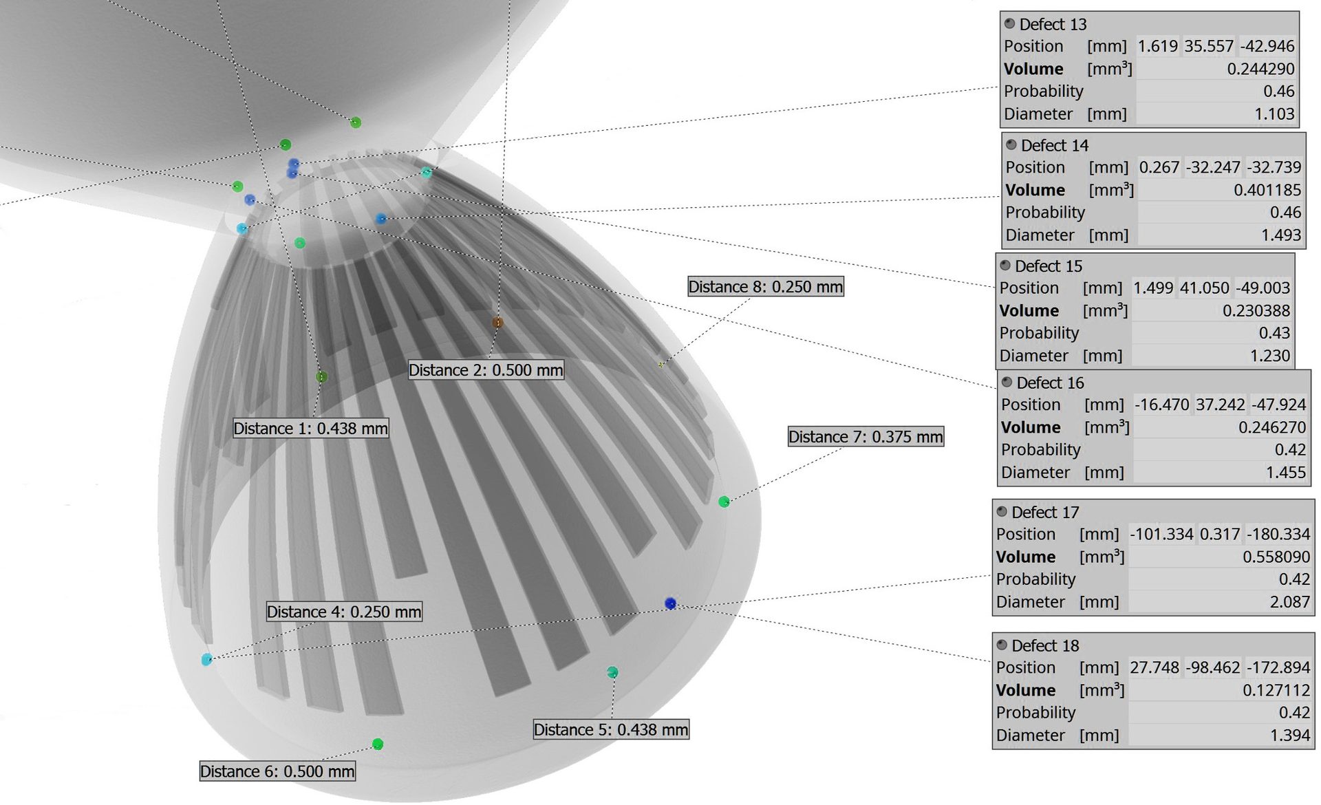

Missiles, Rockets, and Torpedoes
The complex and high-performance nature of missiles, rockets, and torpedoes necessitates precise inspection techniques to ensure operational readiness and reliability. CT X-ray NDT enables inspectors to conduct thorough assessments of these aerospace and maritime weapons systems without compromising their integrity. By examining internal components such as guidance systems, propulsion mechanisms, and warheads, CT scanning can identify defects, anomalies, or assembly errors that may affect performance or safety. This technology plays a crucial role in quality assurance processes, helping to mitigate risks and enhance mission success rates.
Slope
Defect location in additively manufactured rocket nozzle

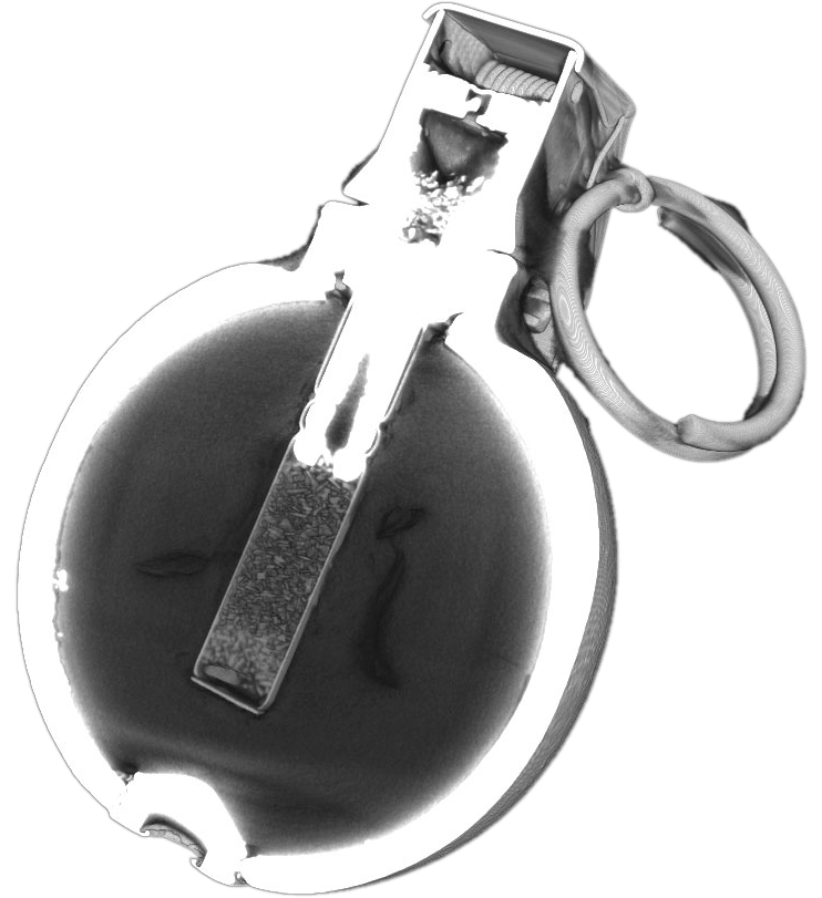

Bombs, Mines, and Grenades
The detection and disposal of explosive devices presents significant challenges for military and security forces worldwide. CT X-ray NDT offers a valuable tool for inspecting bombs, mines and grenades, allowing for detailed analysis of their internal components and explosive payloads. By generating precise images of circuitry, detonators, and casing structures, CT scanning enables inspectors to assess the integrity and functionality of these devices without resorting to destructive methods. This capability enhances the safety and effectiveness of bomb disposal operations, reducing the risk of accidental detonations and casualties.
Inert grenade casing cross sectional image

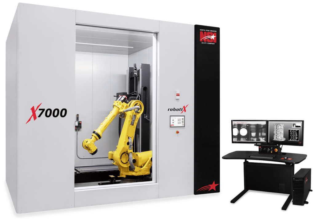

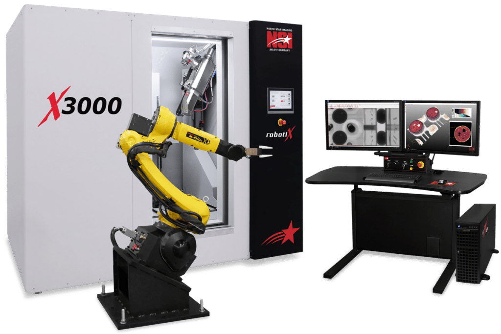

Integration of Robotics with CT X-ray Systems
In modern semi-automated manufacturing environments, integrating robotics with CT X-ray systems significantly enhances quality control processes.
Robotics can precisely handle, load, and position components for CT scanning, reducing human error, increasing throughput, and in the case of ballistics handling, increasing safety. Automated systems can consistently align objects, ensuring optimal imaging angles and reducing variability in inspection results.
The combination of robotics and CT X-ray systems enables continuous and efficient inspection processes. Automated systems can operate around the clock, increasing inspection throughput and reducing bottlenecks in the production line. This integration is particularly beneficial for high-volume manufacturing environments where speed and consistency are paramount.
Furniture, Product
Automotive tire, Wheel, Gadget
Robotic system examples with part loaders and manipulators
