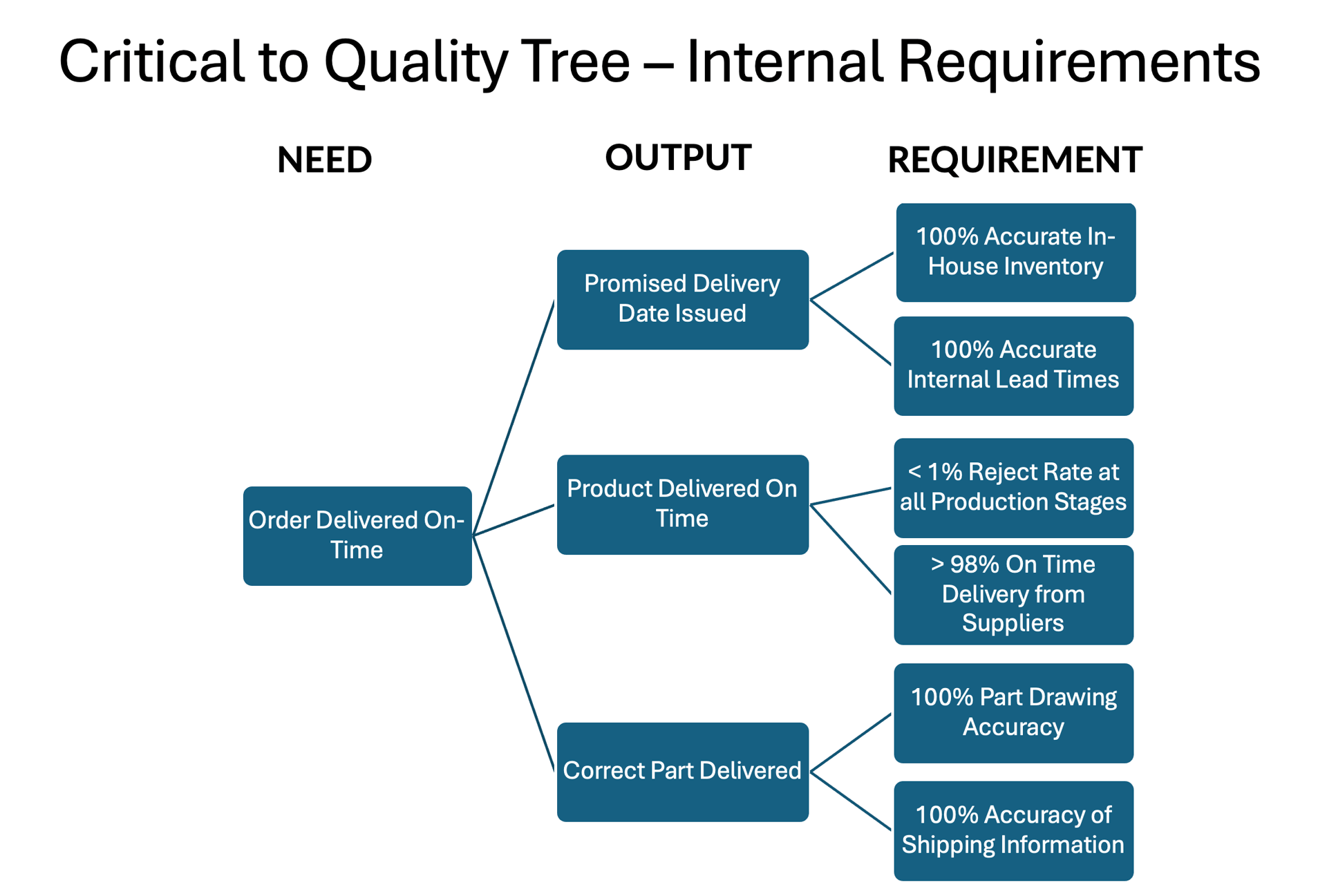

This begs the question: how well are the quality standards for your organization understood by the people accountable to meet them? Fortunately for quality managers, there are a number of effective tools to ground the quality team, and the rest of the organization, in what standards are the most important. One of these tools, directly from the Lean playbook, is called the “Critical to Quality Tree” or simply, the CTQ tree. It’s a straightforward tool that can drive critical conversations, ultimately serving as a corporate compass. It’s a starting point for the hotel we visited in Cuba.
The CTQ tree begins with examining “the Voice of the Customer.” Customers can be internal or external to the organization. If they are external, then reliable research is important to identification of preferences versus aversions. Once identified, these needs are prioritized and, most essential, quantified in terms of outputs and specifications. “Guest elevators assessed and serviced no less than once per month,” might be an internal requirement, while “Internet accessibility by guests available no less than 95% of the time,” might be an external requirement. “If addressing the needs of both internal and external customers, separate CTQ trees might be needed,” suggests Darren Dolcemascolo from EMS Consulting Group, a consulting and training firm specializing in lean principles.
Critical To Quality
Sample Critical to Quality Tree from a manufacturer of medical supplies (Courtesy of EMS Consulting Group, Inc)
Quantifying requirements leads to performance metrics and these metrics, for organizations that are truly focused on operational excellence, eventually find their way into a Control Plan. Ultimately, the goal is to be able to readily say “met vs. not met” for each requirement at regular intervals.
