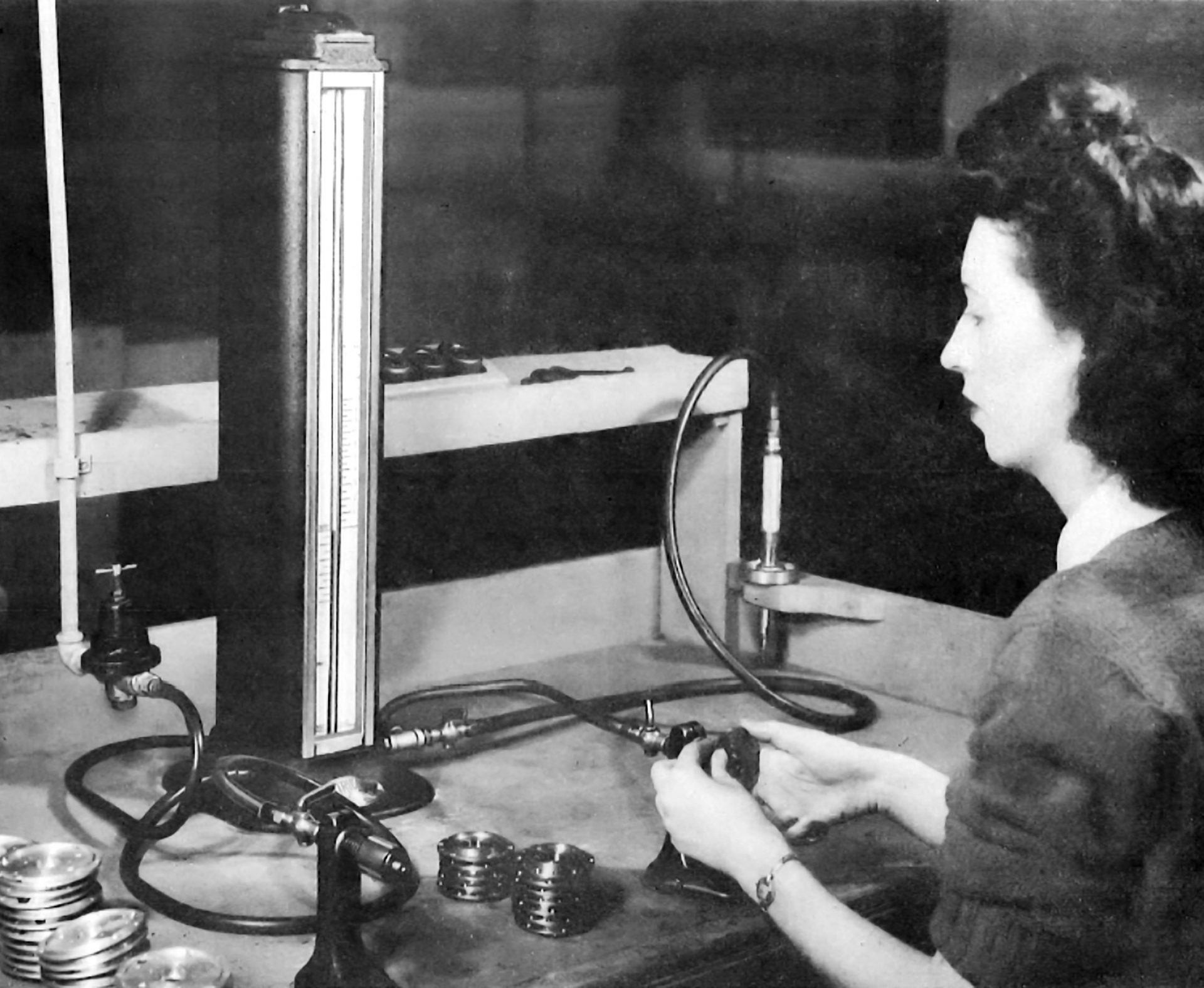

In the ‘40s, air gaging might have been considered the greatest thing since sliced bread. While sliced bread was busy becoming mainstream, air gaging brought just as exciting a breakthrough to the shop floor. You see, at this time—long before electronic probes and amplifiers—it was very difficult to achieve a 50u”/1um resolution on the shop floor. The most common readout used at the time was dial indicators or dial comparators. However, being mechanical, they had issues when used at the point of manufacture, including wear, repeatability, contamination, lack of robustness, etc.
When air gaging was introduced, it provided the first high-performance 50u”/1um or better gaging on the shop floor. In fact, air gaging provided two breakthroughs for dimensional measurement. The one most of us are familiar with today is the use of small orifices or jets built into tooling and used for dimensional comparison. The other and often forgotten technology was the air probe—a contact probe very similar to the LVDT probes common today—but functioned by the contact tip of the probe opening and closing a tapered valve in its body. About 30 years ago, this technology began to be replaced by LVDTs/digital probes/digital indicators that were becoming more robust and economical.

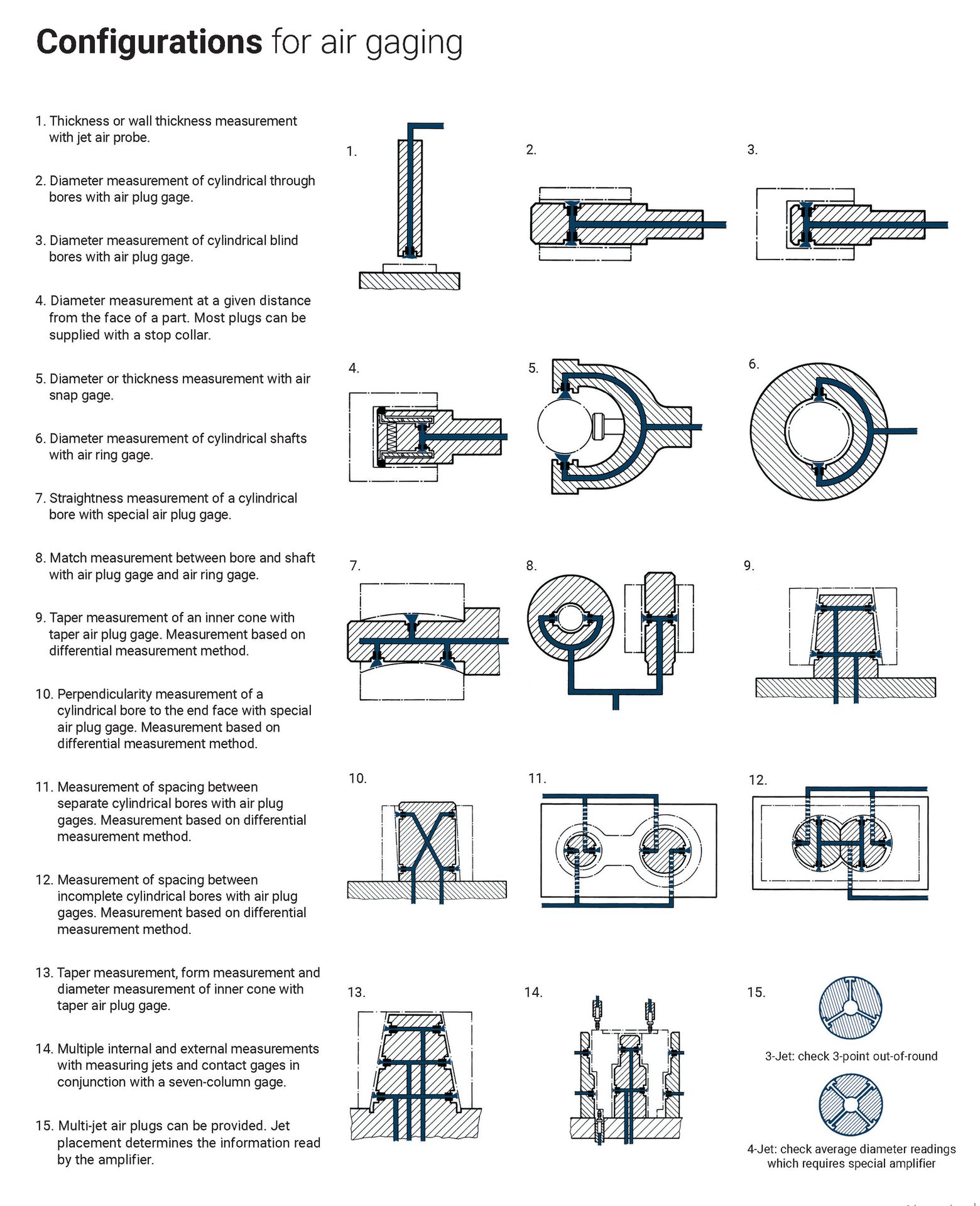

Basically, since air gaging is based on the laws of physics and fluid characteristics, these laws don’t change. An air gage works on the principle of back pressure, which occurs when a solid surface restricts pressurized air from the jet. Today’s air gaging systems still use this pressure phenomenon to measure distance. But, of course, an air jet is more than just a small hole. It is really a precision hole created with many knowns: its size; a controlled surface around the jet; a known depth from the surface of the tool holding it; and a built-in air escape system.
The configurations for air gaging chart below shows many types of relational checks that a combination of air jets can perform. In some cases, the air jets can be combined pneumatically to perform the measurement, as with an air plug. But each jet also can be combined in an external processor to measure diameters, tapers, bend, and twist from the same jets. This type of chart can be found in air gaging catalogs going back decades.

Air gaging was introduced long before digital displays. The original display consisted of water levels in glass tubes, a bobbin floating in a tapered glass tube, or some form of a mechanical-based analog dial. Most air gaging is still based on the magnification derived from the actual length of the analog dial compared to the movement seen by the air tool. Thus, the typical magnification referred to on a lot of air tooling, such as 2500:1 or 5000:1, for example, comes from the analog dial’s length.

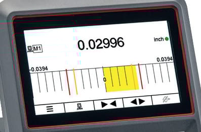

One of the latest breakthroughs in digital readouts is that the displays are becoming as high resolution as some of the best TVs today with similar refresh rates. In the past, displays have tried to simulate an analog display, but often the results were marginal, with LEDs skipping while trying to keep up with the reading. But with today’s display capabilities, an analog simulation is just as sharp and crisp as an analog meter.

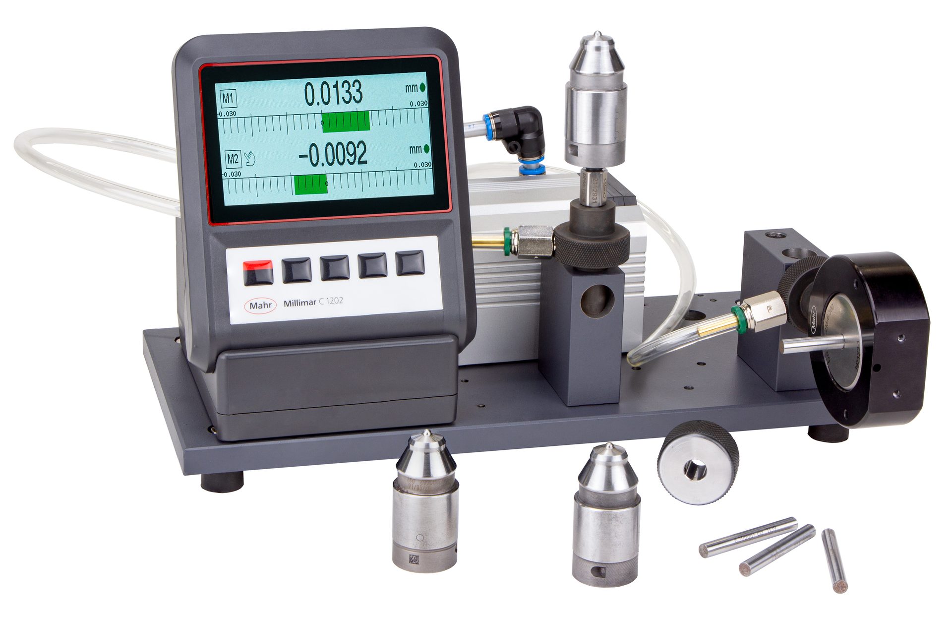

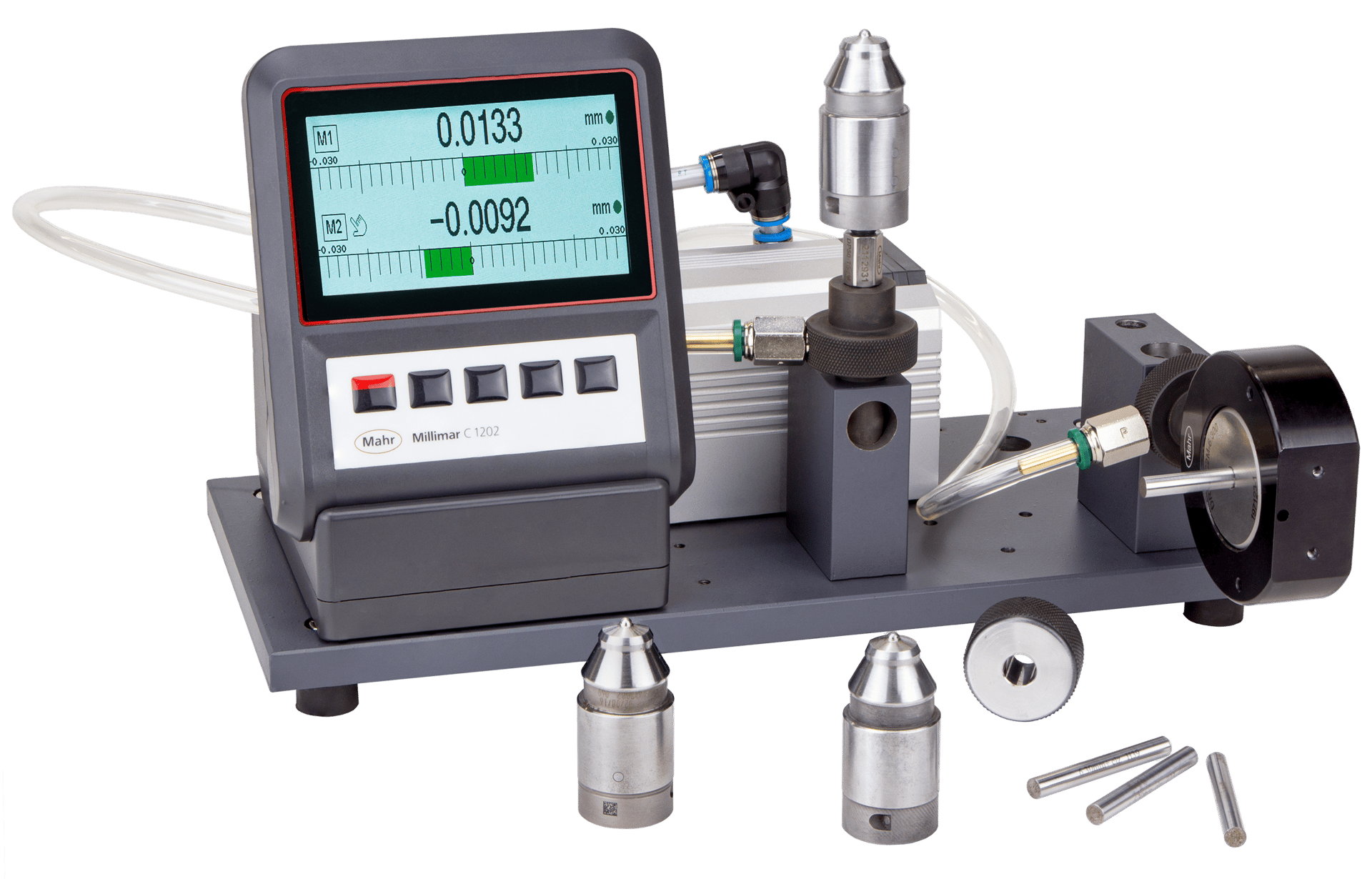

Many of the air gage readouts that have been available for decades were single-use, dedicated to the tooling systems. This could be a good thing at times because it was simple; users would get used to their operation and easily multiply through the workshop. However, on the downside, if that job requirement disappeared, the display, while still functional, had no use until a similar application came along.

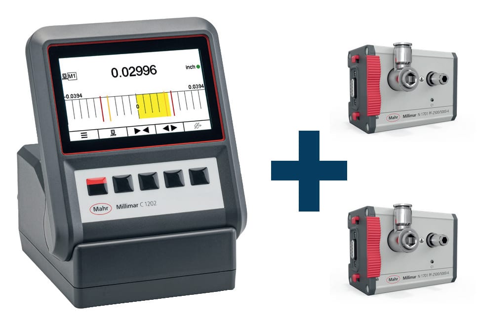

As with the tooling and improvements, changes in performance and added value are also seen in readout systems. With the new and high-volume production of electronics, one can purchase next-generation displays for less cost than mechanical meters being manufactured now. This provides an added incentive to move to digital displays.
Additionally, digital bench amplifiers for air systems are no longer dedicated to air. Instead, more systems are designed to have a modern, powerful, full-featured display “base unit.” This allows the user to configure the base unit with the type of input needed for the application, whether air, LVDT, or digital probe. As previously noted, since air tooling has not changed much in the past 80 years, it is possible to make significant digital display updates at prices less than the old system may have been purchased for. The value comes from better performance, features that simplify the part classification for the user, and built-in data-sharing capabilities for process monitoring.
Air Gaging
However, upgrading is not limited to the same manufacturer tooling. Since we know air tooling works on the same laws of physics, all manufacturers’ tooling is very similar. Therefore, the potential exists to get a readout upgrade for the user. And since these digital systems have much more capabilities, it is simple to move from single- or dual-master step up with the same system, again, based on the similarities of all manufacturers’ tooling.
But another option for these newer modular systems with universal bases is that they can be made an air gage system for one application. Then, if that job goes away, it can be turned into an electronic LVDT-based display by reconfiguration.

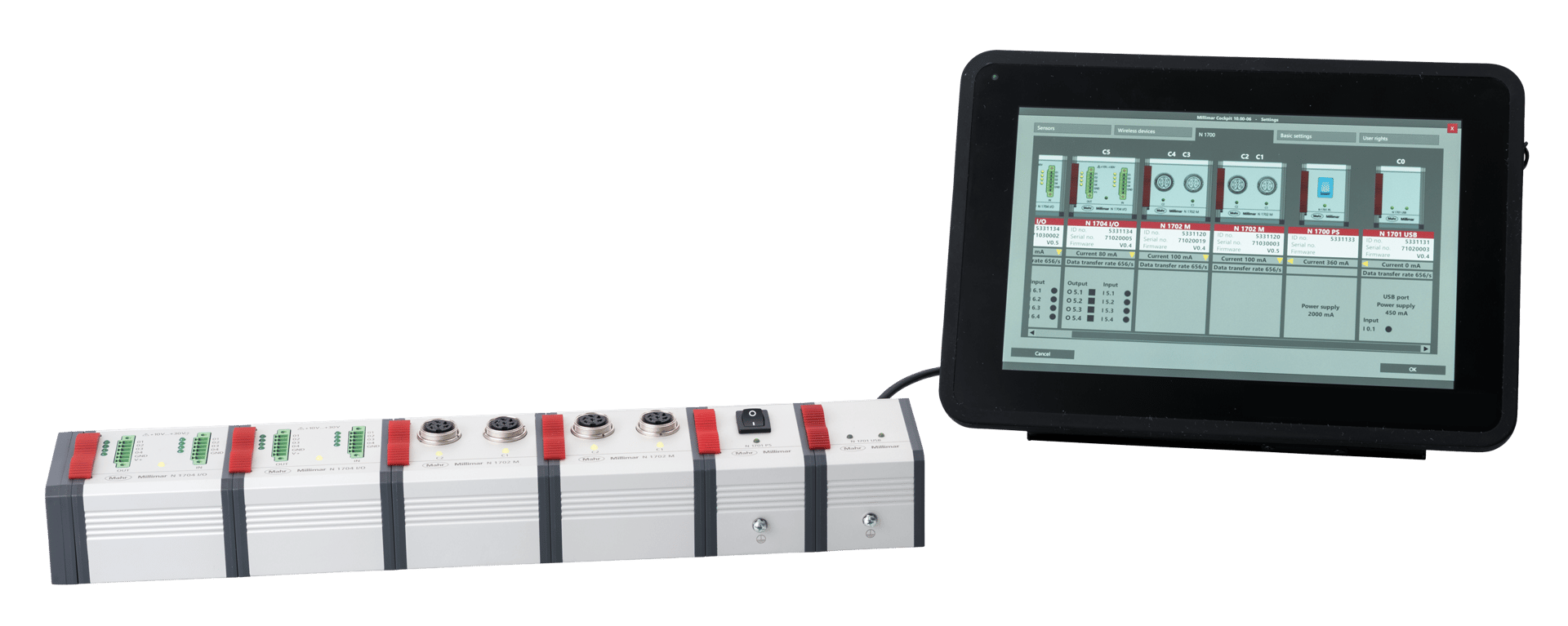

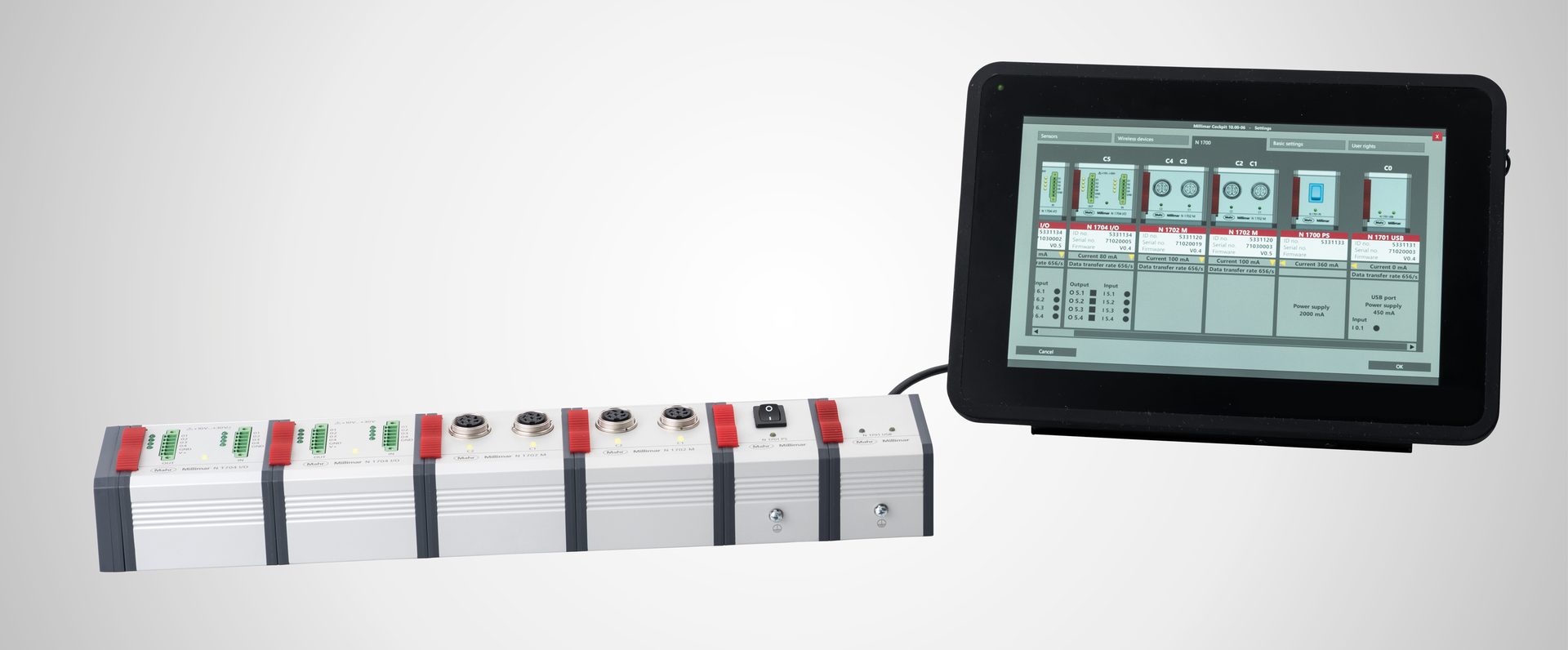

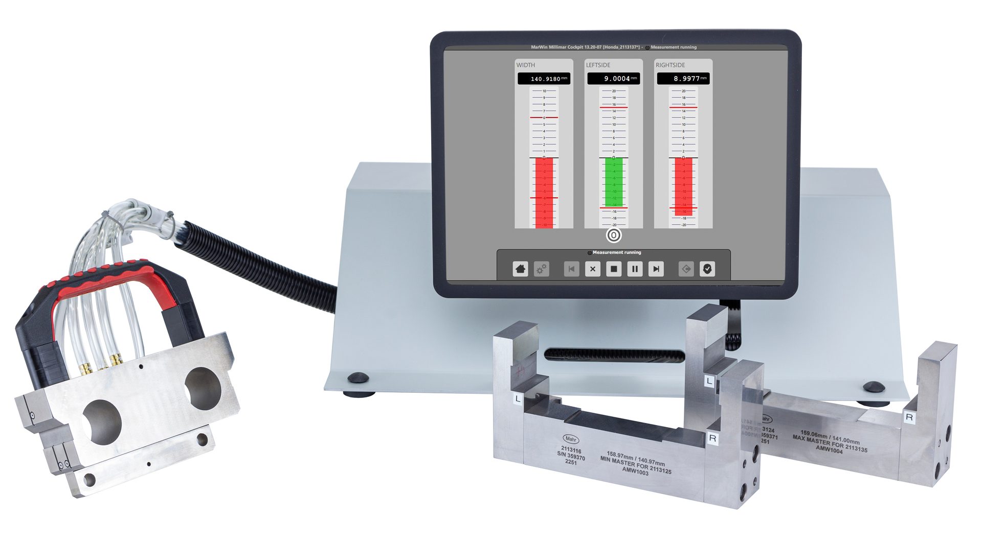

Walk around any shop today, and it is not unimaginable that there is a PC at every workstation, along with one, two, or three dedicated bench amplifiers used to make checks on the parts being manufactured. While the standalone bench amplifier is busy qualifying parts, more often than not, the PC may be used for more simple mundane tasks such as emails, a time clock, tracking part and process trends from data, or surfing the web for Amazon bargains.
The point is that there are now options to reconfigure this whole workstation. As with the above, we learned that single interface modules could change a display from air to LVDT input. When connected through a standard USB interface, these same modules can turn that partially used workstation PC into a powerful gaging bench amplifier or intelligent gaging station. Now, instead of having several standalone air gages and LVDT-style bench amplifiers, the gaging computer has the interfaces available to configure all these input types.
Air Gaging
Air Gaging
Air Gaging
Air Gaging
H3-Subhead Goes Here
P - Main body. paragraph of text goes here. Main body. paragraph of text goes here. Main body. paragraph of text goes here. www.linkgoeshere.com
  • Bullets
This is where less becomes more for the gaging process. The computer now provides the visual indication for the operator to look at individual displays and watch the changing tolerance colors and the data being acquired. And because the gaging computer is most likely already networked and communicating with other systems, data and measurement results can flow seamlessly within the factory. Thus, the gaging computer has become the display, data collection device, results classifier, and overall guide to the measuring process while in the background, information is being shared transparently with the user.
Once a single workstation is updated with modules taking up less bench space or even none should the module be mounted behind or under, it can be the start of a work department value update. All the old and potentially discontinued displays are replaced as part requirements are changed, input modules can be reconfigured, and since everything is networked, part programs and data can be shared in one central location.
