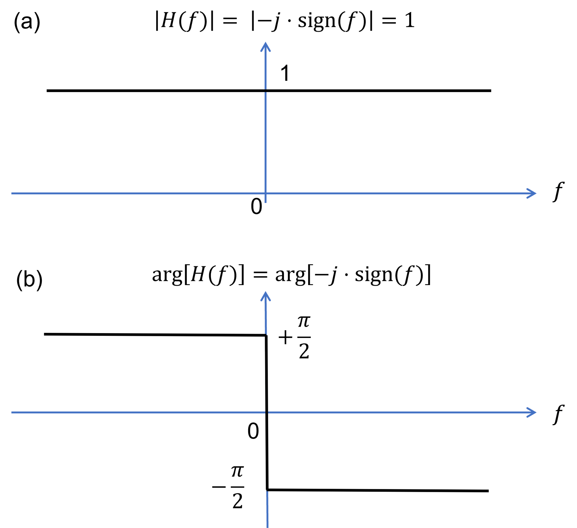

In comparison to typical signal filters, think of the Hilbert transform like an “all-pass” filter, as all frequencies are allowed through. What it does change is the phase relationship of the various frequencies of the signal.
Without going into too much mathematical detail, when the Hilbert transform is applied, it’s as though the instrument operator has shifted the original signal in phase by 𝜋/2 radians. Figure 1 shows the behavior of a Hilbert transform in the frequency domain (transfer function), keeping the signal amplitude unchanged (Figure 1(a)) and shifting its phase by 𝜋/2 radians (Figure 1(b)).
Slope, Rectangle
Figure 1. Transfer function of a Hilbert transform: (a) amplitude and (b) phase

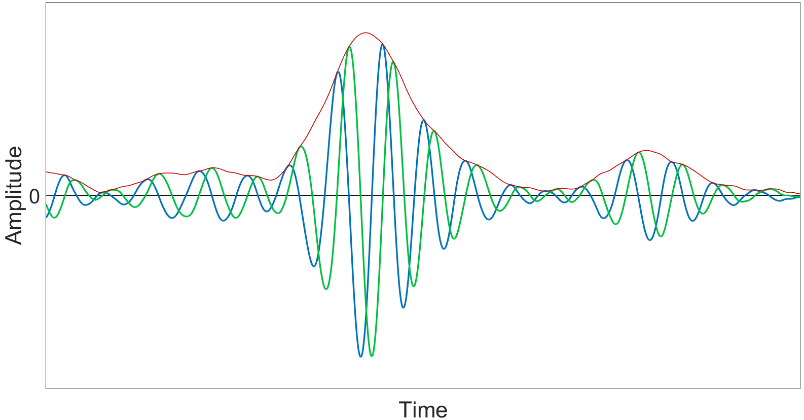

This is useful for generating an accurate envelope. As shown in Figure 2, all three components are represented:
  • In blue, the “normal” in-phase signal, or original A-scan
  • In green, the + and − 𝜋/2 or quadrature components, thanks to the Hilbert transform
  • In red, the traced envelope over both signals
Plot, Slope, Font
Figure 2. The in-phase A-scan signal (blue), the Hilbert transform + and − 𝜋/2 or quadrature components (green) and the TFM envelope over both signals (red)

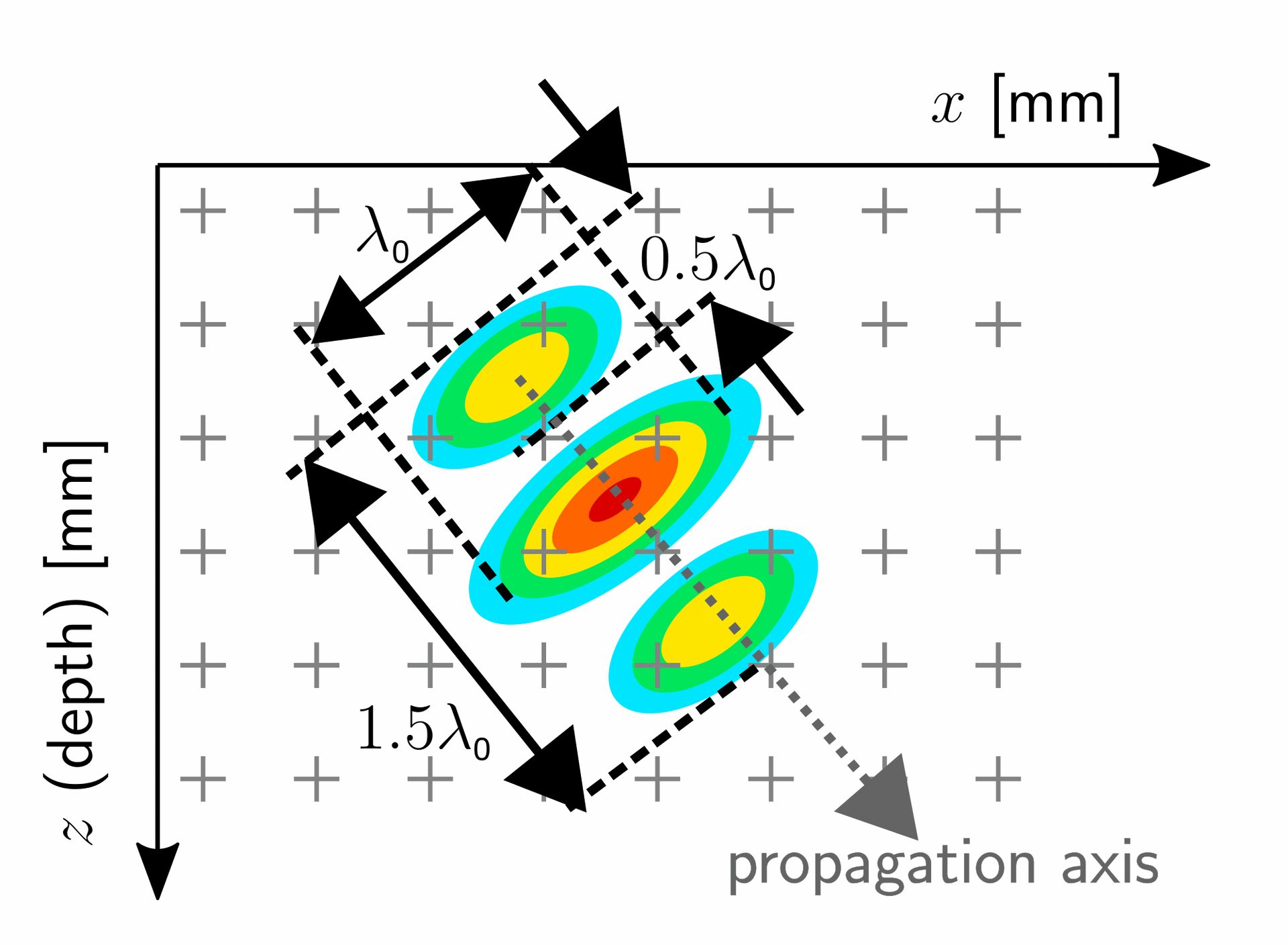

Depending on the digitizing frequency in PA or grid resolution in TFM, the maximum amplitude of a signal can be missed, resulting in the wrong amplitude in the digitized signal. A higher digitizing frequency or a finer grid resolution helps reduce amplitude errors.
AF requirements are in place to make sure that the size of each pixel in the TFM grid fits the size of the wavelength. The size ratio of a pixel versus the wavelength of the ultrasonic beam is important. Too large a pixel could miss the peak amplitude, just like a digitizing frequency that is too low might miss the peak in a conventional phased array signal.
Font, Slope
Figure 3. Color scale representation of the rectified amplitude TFM image of a hypothetical point scatterer using a common large bandwidth pulsed signal (λ0 = probe central wavelength)
Figure 3 illustrates this pixel versus wavelength size problem. Since the true maximum amplitude (small red ellipse) is located between the measurement points of the grid (gray plus signs), it will not be measured when processing the TFM image. Rather, a lower amplitude (yellow ellipse) will be calculated as the maximum. This error in maximum amplitude caused by the coarse grid resolution could result in a flaw size overestimation (when using amplitude-based sizing techniques).
The AF value is the variation in decibels (dB) between the true maximum amplitude (red ellipse in Figure 3) and the maximum amplitude measured by the TFM grid, which in this example is represented by the yellow ellipse. The standard requirement in TFM codes is an AF value of no more than 2 dB.

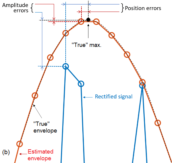

The Hilbert-transform-based TFM envelope offers a notable improvement in amplitude fidelity versus the “normal” or original rectified A-scan signal (Figure 4). The sampling rate required to achieve the same amplitude fidelity is much lower when working from the signal envelope (in red) than from the rectified signal (in blue).
In phased array ultrasonic testing, a digitizing frequency of five times the frequency of the probe is used to avoid amplitude errors. The same logic applies for TFM, where five samples per period, or per wavelength (lambda/5), is considered sufficient to avoid amplitude errors greater than 2 dB.
Rectangle, Slope, Organism, Plot, Font, Line
Slope, Rectangle, Font
Figure 4. Envelope (red) versus rectified A-scan (blue) maximum amplitude error margins

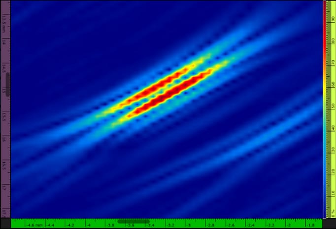

With standard TFM with oscillation based on rectified A-scan signals, we can sometimes see “doubling” of the signal. The strictly positive values and signal oscillation leads to two maximums in the example shown in Figure 5, but only one maximum when using the TFM envelope.
Colorfulness, Azure, Rectangle
Colorfulness, Blue
Figure 5. TFM images of a side-drilled hole―both with a 0.08 mm (λ/8.1) grid resolution and 108.7% maximum amplitude settings―using rectified amplitude and with signal oscillation (left) and using the TFM envelop (right)
In this way, the TFM envelope also facilitates proper sizing and positioning of the defect. The doubling oscillations of standard TFM do not provide any relevant information on the indication. They are due to the frequency characteristics of the probe, i.e., the central frequency and bandwidth, not caused by the defect itself. Applying the TFM envelope rids the image of this superfluous information to concentrate the indication analysis on only relevant signals, enabling a better estimation of the position and amplitude.
