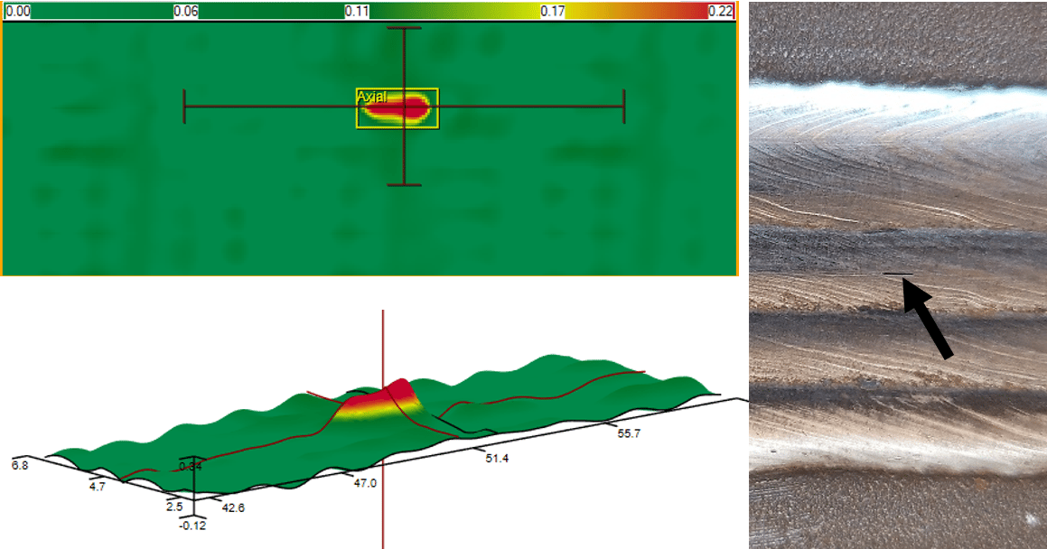

ECA is an electromagnetic testing technique based on the same principles as eddy current testing (ECT). An array of small sensors allows the detection of small cracks, porosities, corrosion pitting, weld flaws, and manufacturing defects present in conductive surfaces. Compared to visual inspection techniques such as penetrant testing and magnetic testing, ECA has the advantage of recording and archiving digital data while being less operator-dependent for the detection of submillimeter flaws. It also requires less surface preparation, no couplant, and can detect subsurface flaws that would be invisible to visual inspection. The main advantage of ECA over traditional ECT is that it can contain dozens or even hundreds of customizable sensors, allowing wide coverage and a much faster and repeatable inspection.
Figure 2: Detection of a small axial crack indication in a carbon steel weld using ECA
