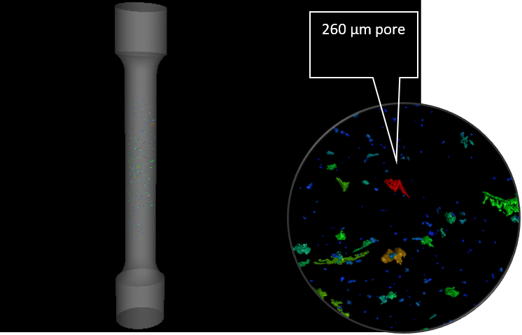

Pore analysis on a tensile test sample. Source: VisiConsult

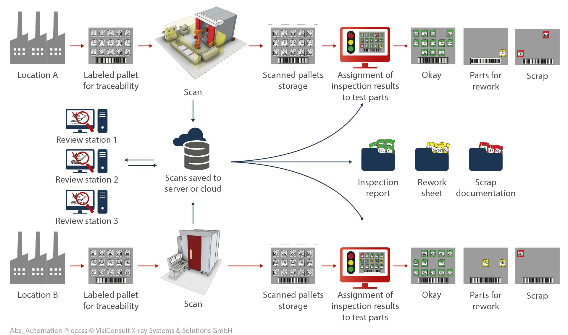

Scenario of a Smart Factory.
In the context of NDE 4.0 and the establishment of a smart factory, the idea of manufacturing components using additive manufacturing (AM) techniques is an obvious one.

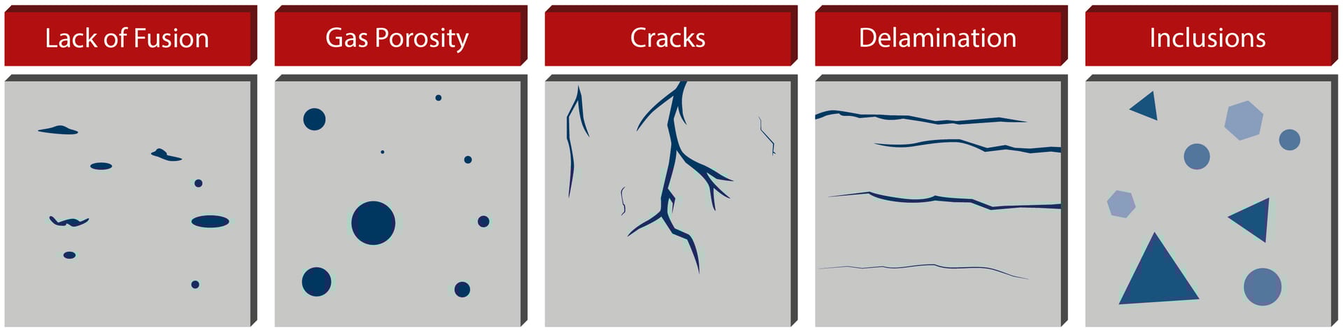

Besides well-known defect types like pores, cracks and inclusions, AM often leads to typical irregularities such as delamination and lack-of-fusion pores. Lack-of-fusion pores occur when loose powder is not melted during the 3D printing process. This may happen when the power of the laser of the 3D printer was locally too low for some reason, e.g., if the laser diode has a failure or material spatter is present in the powder bed.
Facial expression, Rectangle, Azure, Font
Typical types of irregularities of AM components. Source: VisiConsult
Generally, gas pores and inclusions are easily detected, whereas cracks and delamination are only found if they are penetrated in the same direction of their propagation. The lack-of-fusion pores are similar to flat or oval gas pores and therefore they also can be seen in their direction of the longer axis better than from the others, but due to the fact that they are filled by loose powder their contrast is very low and will become even lower the smaller they are. With Robotic CT, the scan trajectory can be adapted to the propagation direction easily.
