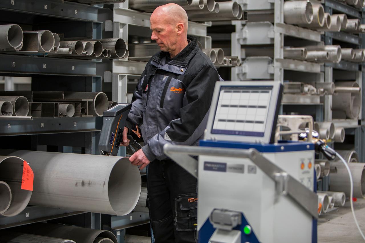

Workwear
Mobile OES is a key technology to address positive material identification’s role in Quality 4.0.
