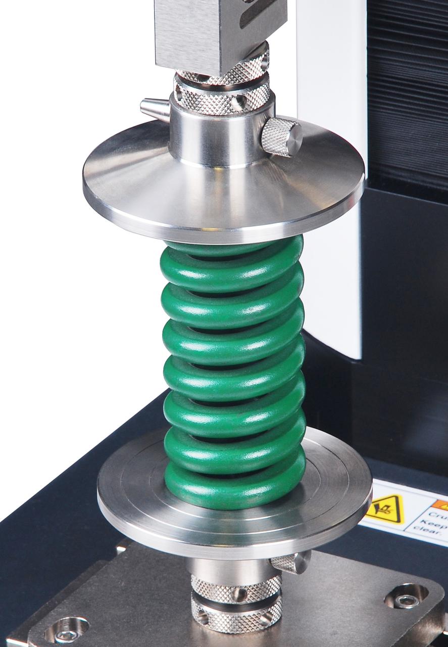

Compression Spring Testing: Springs are essential components in everything from pens to mattress to automobiles. To ensure optimal performance, a compression force is applied to determine corresponding force. Several parameters are often measured, including spring rate, spring force, force at a given deflection, and deflection at a given force. Understanding the mechanical performance of a spring is critical in specifying which spring to use in a product design.

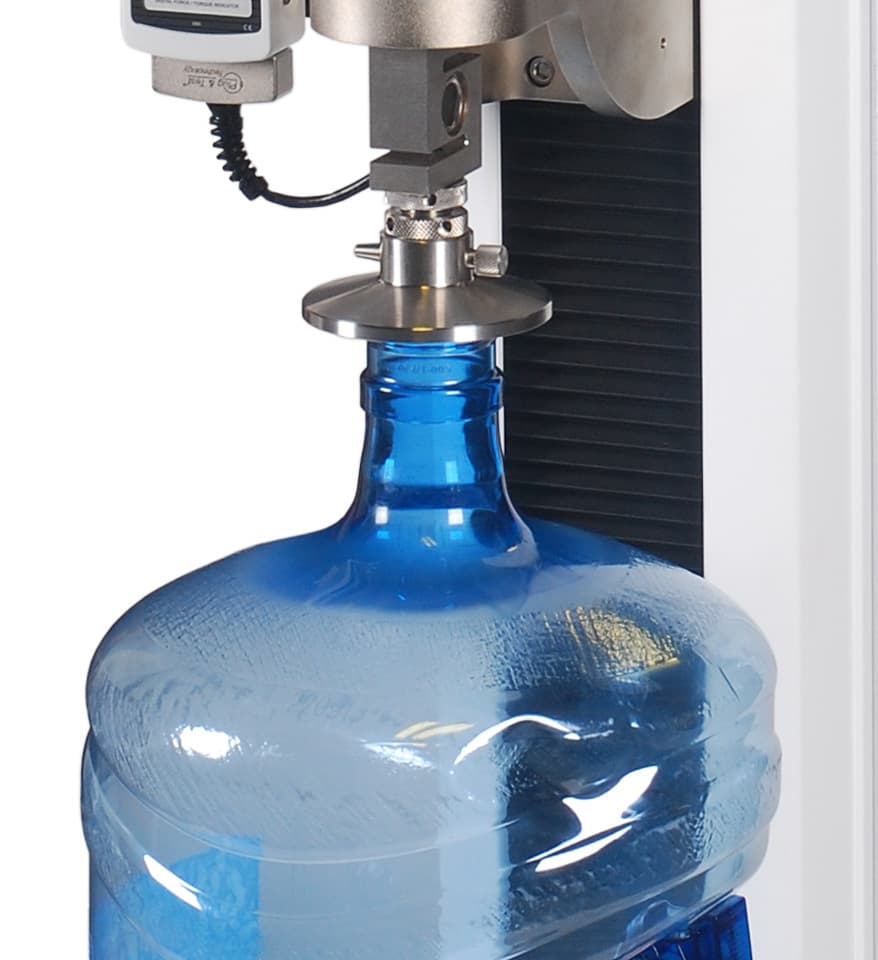

Top Load Testing: Top load testing is popular for packaging, beverage, and consumer products manufacturers. Bottles, containers, cans, and cartons are required to resist compression loads that could damage them. In top load testing, a compression force is applied until it deforms by a specified amount or collapses. An example of such testing is measuring the top load on a common water cooler bottle. Such measurements must meet minimum standards to prevent damage to the bottle or its contents during transportation or customer handling. The results of a top load test can identify failures in the molding process or in the formulation of the material.

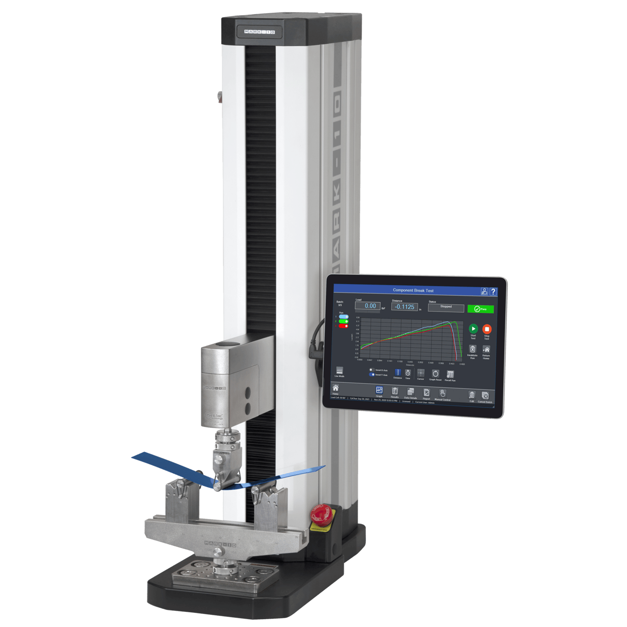

Bend Testing: Bend testing subjects plastics, wood, carbon fiber, and other materials to compression forces at three or four points. The resulting deflection and compression forces are measured, and used to quantify strength, elasticity, and other characteristics. This information helps materials producers meet specifications and assist other manufacturers in specifying materials in their designs.
A compression force tester can determine bending characteristics via a 3- or 4-point bend test.

Compression spring testing yields important data for spring manufacturers and the design engineers who specify their use in a product.

A multi-step test editor allows the user to customize a series of motion control and data collection steps particular to the application.
A variety of results are calculated in compression testing software, such as maximum load, load at maximum distance, delta distance, height, and others.

To avoid buckling or rupture in the field, plastic water bottles are subjected to a top load compression test.
