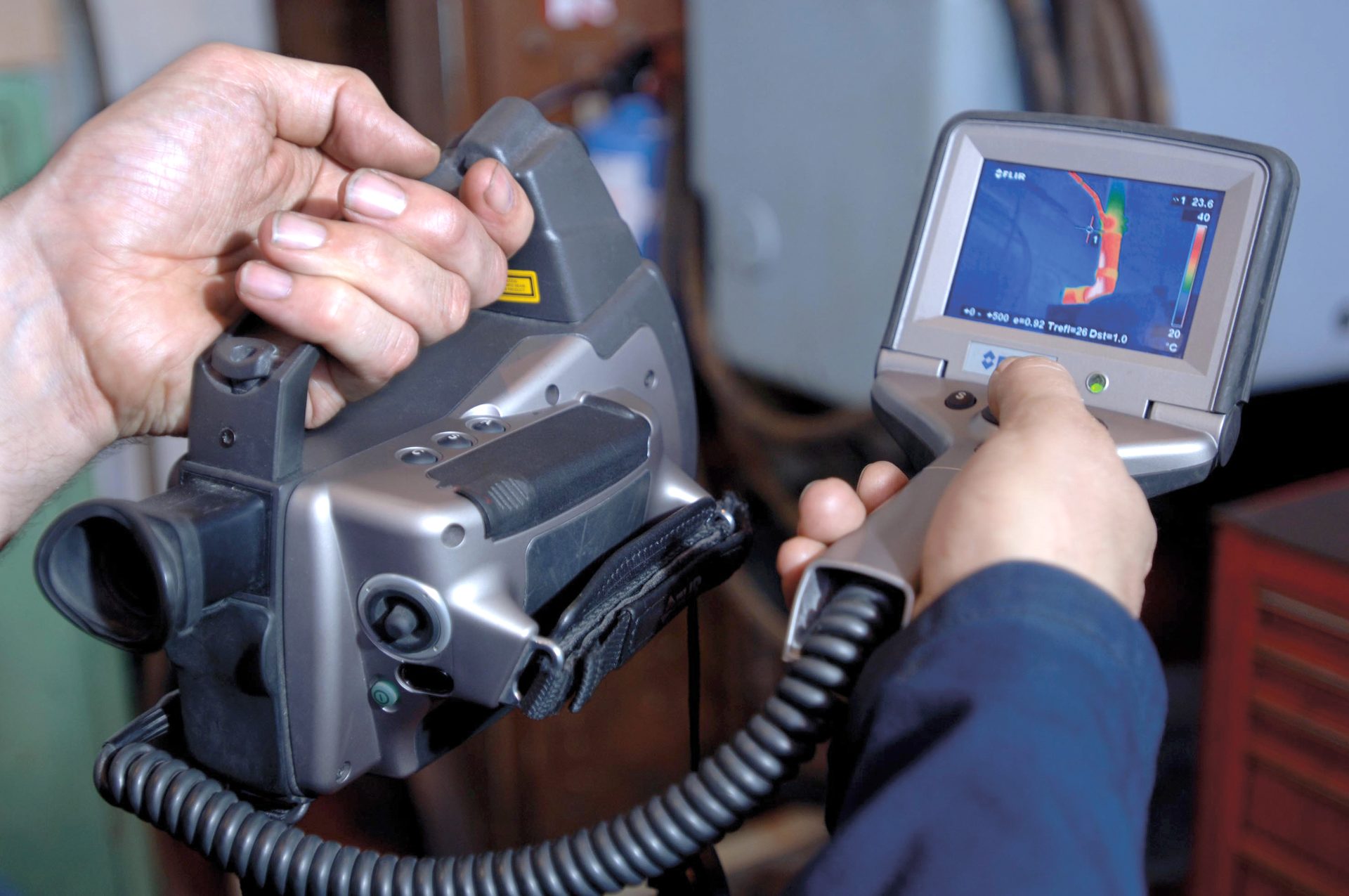

Hands operating two thermal imaging cameras, one displaying temperature on its screen.
Face-to-face delivery at approved training centers remains the cornerstone of practical training, logged experience and practical examinations . Courtesy of RWE/BINDT
