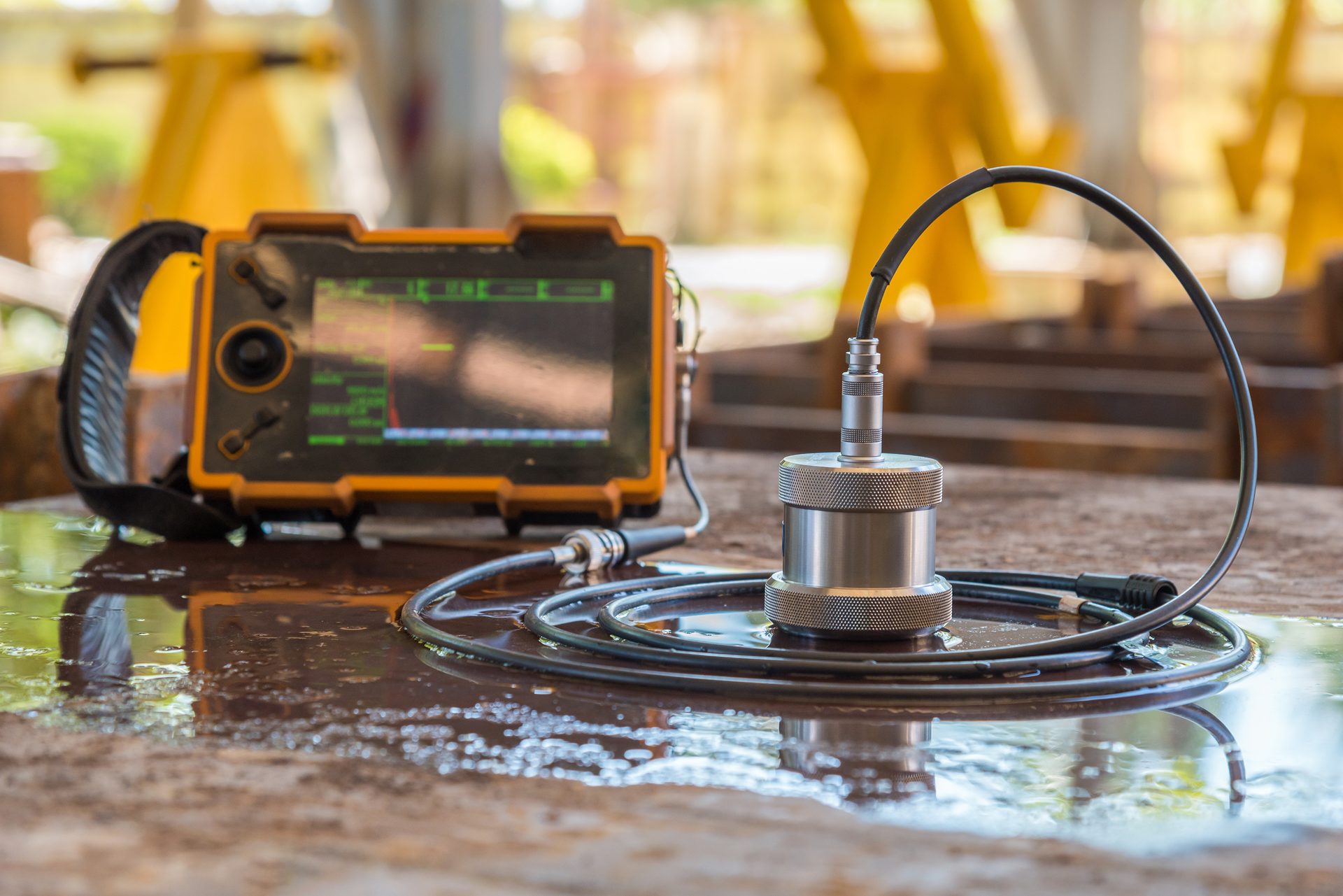

Ultrasonic testing equipment, including a flaw detector and transducer, on a wet surface.
