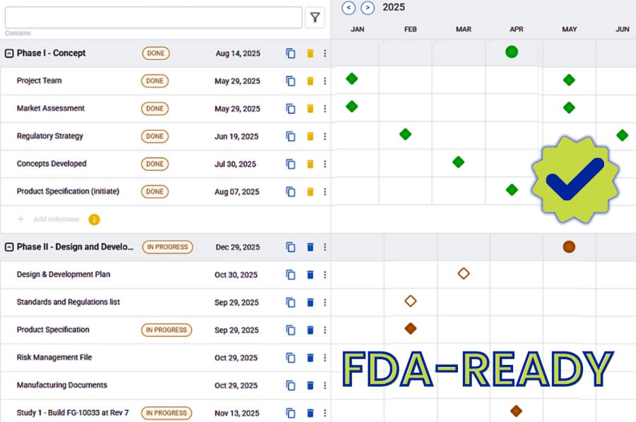

A project management Gantt chart and calendar timeline with a large 'FDA-READY' text overlay.
Source: Enlil
