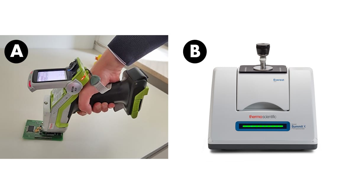

Hence, all electronic consumer goods value chain stakeholders must have easy-to-use screening technologies at their disposal to maximize the number of items analyzed, and electronic consumer goods value chain stakeholders must have easy-to-use screening technologies at their disposal to maximize the number of items analyzed and limit the risk of non-compliance. Handheld x-ray fluorescence spectrometry (XRF) (Figure 1a) and Fourier Transform Infrared spectroscopy (FT-IR) (Figure 1b) are two easy-to-use, nondestructive, and cost-effective technologies that can be used for screening purposes of heavy metals, brominated flame retardants, and phthalates.
Handheld XRF analyzer, FT-IR spectrometer

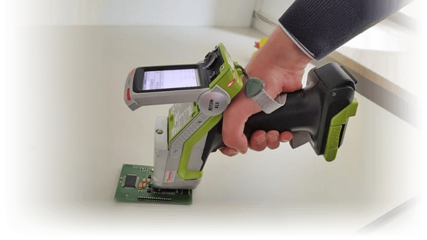

Figure 1: a) Handheld XRF analyzer (Thermo ScientificTM NitonTM XL5 Plus Handheld XRF Analyzer) analyzing components on printed circuit board b) FT-IR spectrometer (Thermo ScientificTM NicoletTM Summit TM X Spectrometer) with an ATR accessory (Thermo Scientific™ Everest Diamond ATR Accessory)

Although the analysis is fully nondestructive, the operator may require disassembling the product when a homogeneous unit cannot be isolated using the standard (diameter 8 mm) or the small (diameter 3 mm) measurement spot. For better ergonomics, small-sized samples or electronic parts such as printed circuit boards (PCBs) can also be analyzed using a test stand, which converts the analyzer into a small benchtop unit and provides laboratory-like conditions.

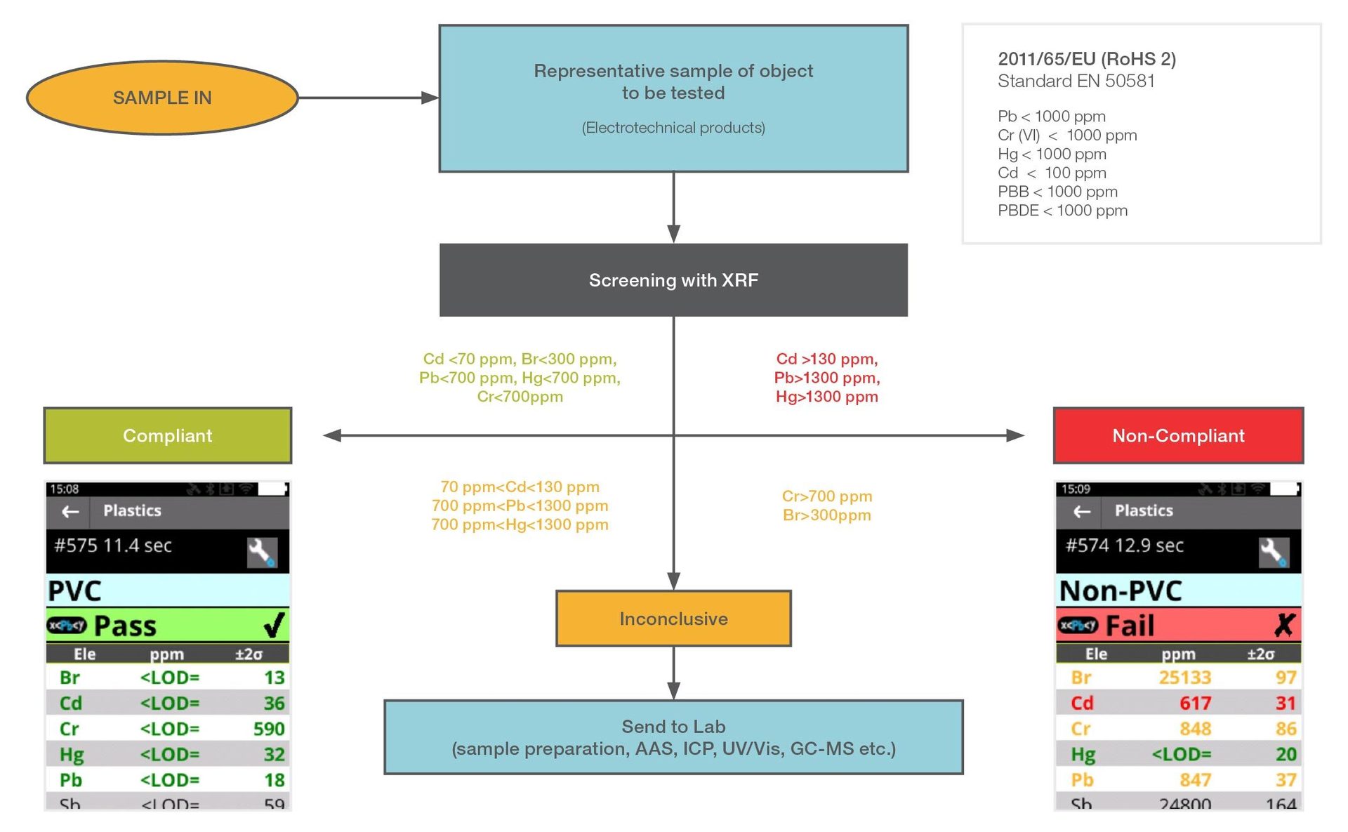

Using handheld XRF, manufacturers, importers, and retailers can implement a standardized screening protocol according to IEC 6232-3-1 [2] or ASTM F2617-15 [3] to verify compliance with electronic and electric devices and reduce the chances that non-compliant products will enter the manufacturing process or reach the store shelves.
Figure 2: XRF analysis screening logic for Pb, Cr VI, Hg, Cd, PBB, and PBDE according to standard IEC 62321 [1]

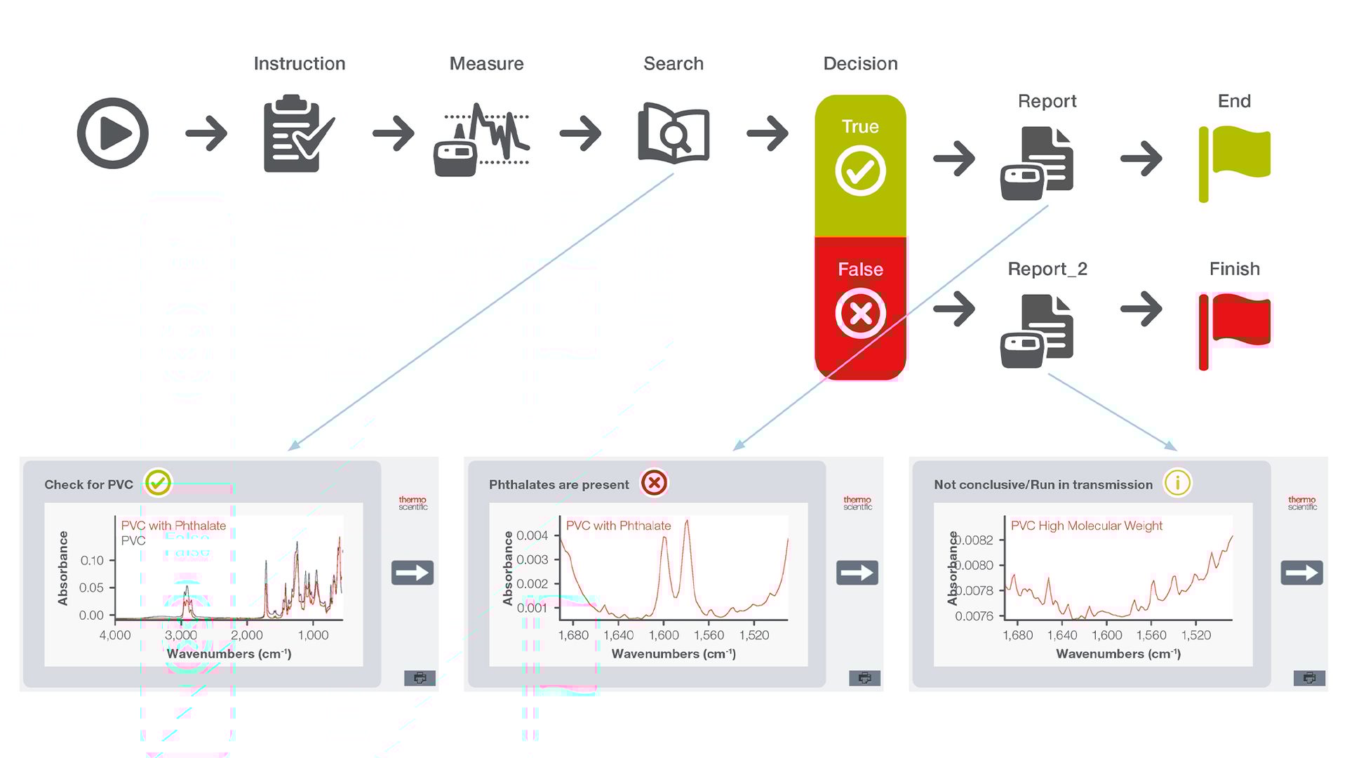

The general workflow for phthalate screening via FT-IR starts with an ATR measurement followed by a transmission-based measurement, if needed, for samples with lower concentrations of phthalates. First, the identification of the polymer type via ATR sampling is performed and in the example in Figure 3, it is found to be PVC. The second step, to follow the RoHS regulations, is to run a method to quantify the level of phthalates. When the concentration of total phthalate is high, generally at a single percent level and above, then the item/sample will be classified as non-RoHS-compliant. Alternatively, suppose no phthalates are detected via the ATR sampling method. In that case, the PVC sample is then pressed to about a 500 µm thick film and analyzed in transmission mode to increase the sensitivity (sub-one percent) for detecting and quantifying possible phthalates. If the measured concentration is below 1000 ppm, the result is a ‘negative’ or passing report, or if the concentration of the phthalate is above the 1000 ppm level, the result is ‘positive’ or a failing sample due to the RoHS compliant regulations. If the analysis remains inconclusive, further investigations in the laboratory using liquid chromatography with ultraviolet detector or thermal desorption mass spectrometry coupled will be necessary to obtain the result.
Figure 3: Representative workflow for phthalate analysis using FT-IR spectroscopy
