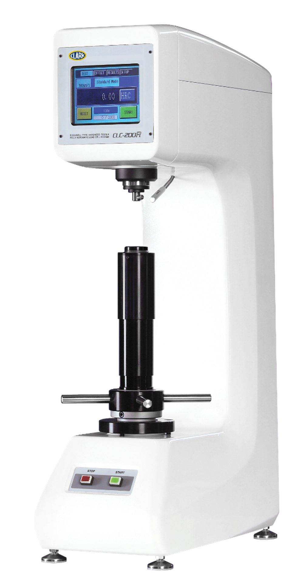

ASTM International1, founded in 1898 as The American Society for Testing and Materials, is the primary standard developing organization in the Western Hemisphere. Brinell was standardized as ASTM E10 in 1924, Rockwell as ASTM E18 in 1932, and Vickers as ASTM E92 in 1952. These three standards all described stationary hardness testing machines intended to be installed in one place (e.g. metrology laboratory, quality inspection station) due to their design and construction. The robustness of these fixed-location machines has led to the respective standards to be used for material specifications. A main drawback to these methods is that they require the specimen under test to have opposite sides that are parallel and fit inside the machine. Industry quickly realized the need for a portable solution and developed other methods accordingly.

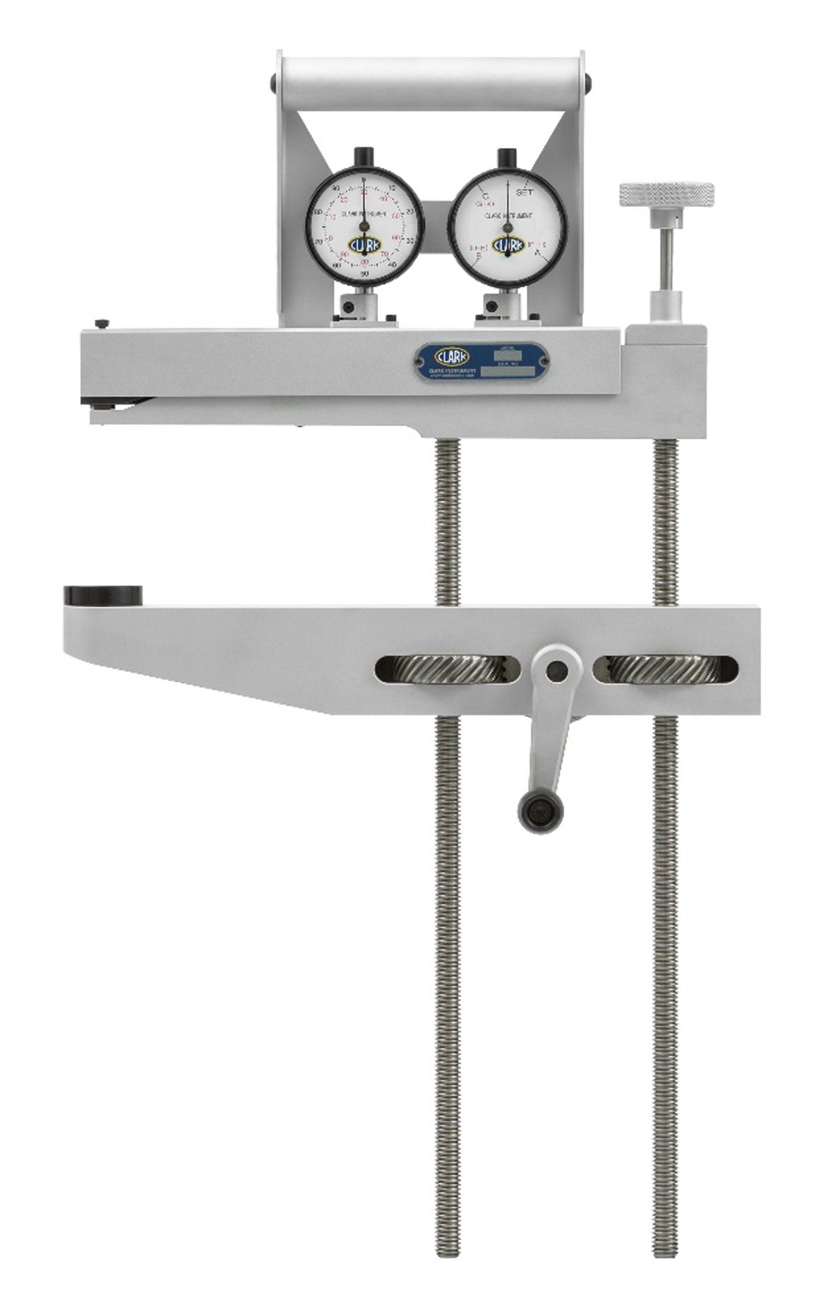

Image 2 – Typical modern portable Rockwell machine that conforms to ASTM E110. Photo courtesy of Sun-Tec Corporation, Novi. MI
Image 1 – Typical modern fixed-location Rockwell machine that conforms to ASTM E18. Photo courtesy of Sun-Tec Corporation, Novi. MI
Portable machines that follow the Rockwell and Brinell test principles using the same indenters and test forces are standardized under ASTM E110. These devices generally resemble a clamp to hold the machine in position on the specimen and provide support for the test forces. Adaptations for larger testing pieces are available such as larger clamps or chains. Test forces are generally applied mechanically for testing machines that follow Rockwell, but hydraulics are usually used for those that follow Brinell due to the much higher test forces.
A portable hardness testing machine that conforms to E110 is generally considered to be less accurate than the fixed-location machines not only due to the challenges of alignment with the test surface (indentation must be normal to the surface), but also because one or more parameters of the machine cannot be directly verified. Direct verification is important because it assures the user that the results are not just a coincidence of errors and that the test is performed with precision. This means that portable hardness testing machines that follow E110 should not be used for material certifications because they do not meet the more stringent requirements of the ASTM standards E10 and E18. Rather, E110 hardness testing machines are quite helpful for in-process testing or testing of parts that cannot be tested in a fixed-location machine. For an E110 Brinell testing machine, this means testing large castings, plates, and forgings where access is available to the opposite side of the piece. E110 Rockwell machines are used on thinner materials like fabricated or machined metals where the smaller indentation is advantageous.

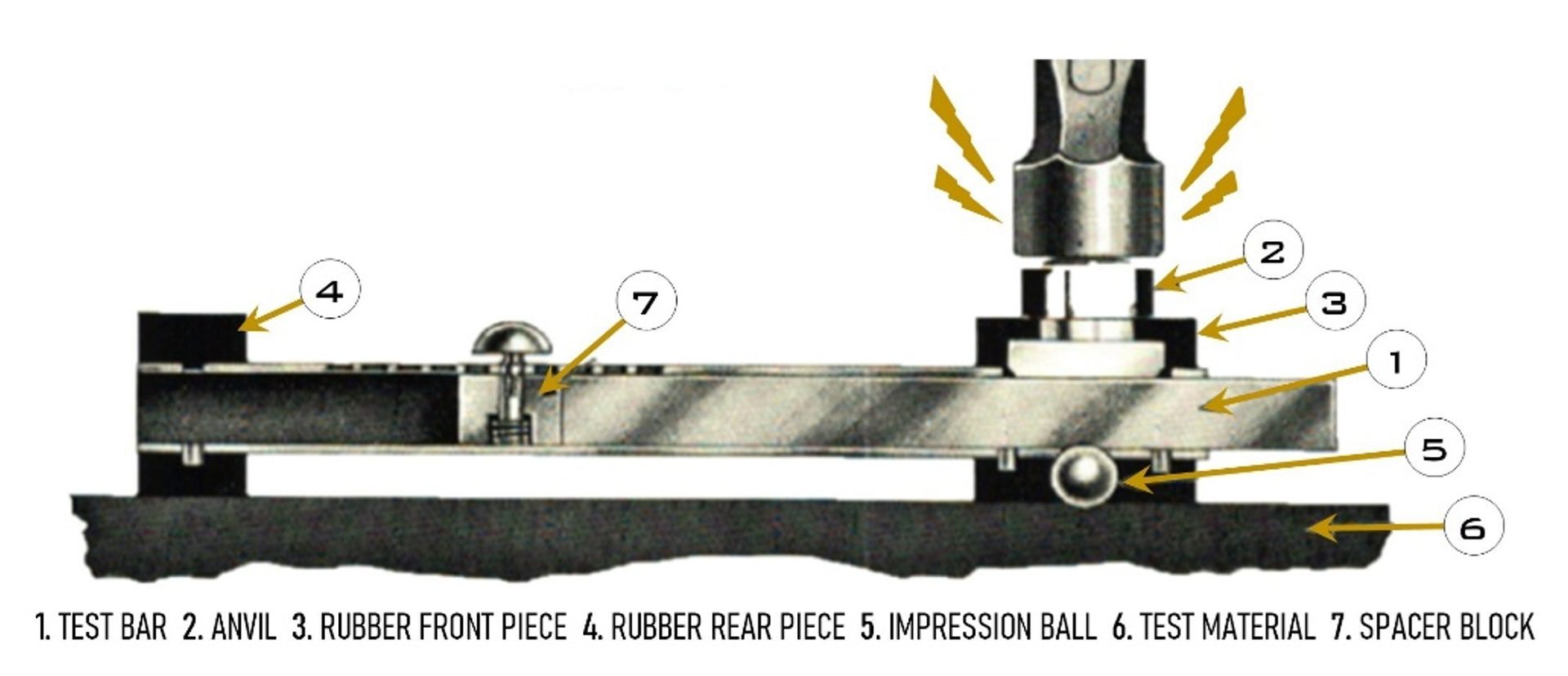

The railroad industry could not use these types of clamping hardness machines on the rail welds because of the lack of access to opposite sides so they developed a comparative testing machine that is standardized under ASTM A833. These machines use a reference bar of known hardness that is inserted into an apparatus that holds a hardened steel ball between the reference bar and the surface under test. The test force is applied by hitting the holder with a hammer of sufficient mass. This results in two indentations – one on the reference bar and one on the specimen under test. The Brinell hardness number is calculated from measuring and comparing the diameters of the resulting indentations. This test method is simple to use and therefore quite popular. The comparative nature of the test allows it to be used on even thinner parts as long as no bulging is seen on the opposite side of the specimen under test, and it does not require access to opposite sides to support the test force. This makes it great for testing the same things as Brinell (e.g. plates, castings, forgings) and then more.
Typical A833 comparative hardness testing machine
Image 3 – Typical A833 comparative hardness testing machine. Image courtesy of Teleweld, Streator, IL.
Pipeline work is one of the more common applications of ASTM A833, but it is often misused in some cases. The ball indenter will give good results on the parent metal of a pipe. However, some inspectors also try to use it to measure hardness of the heat affected zones on welds. This is not a valid application because the indentation is too large and the measurement will include some of the base metal as well as the heat affected zone. Users should always confirm that the indentation is fully within the area of interest and that there is adequate spacing to any edge.

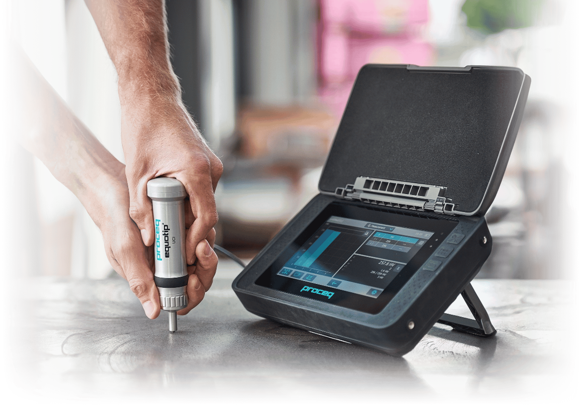

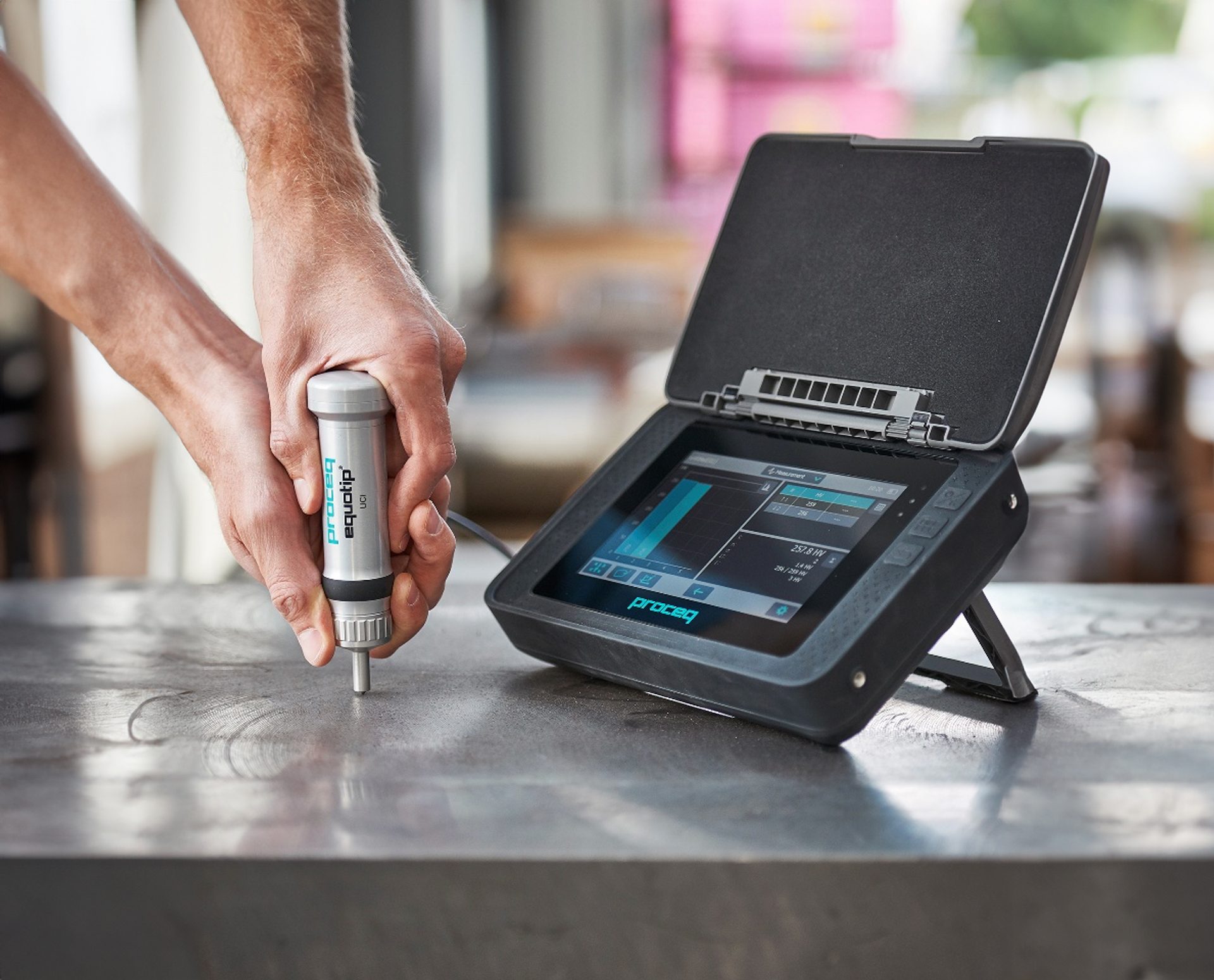

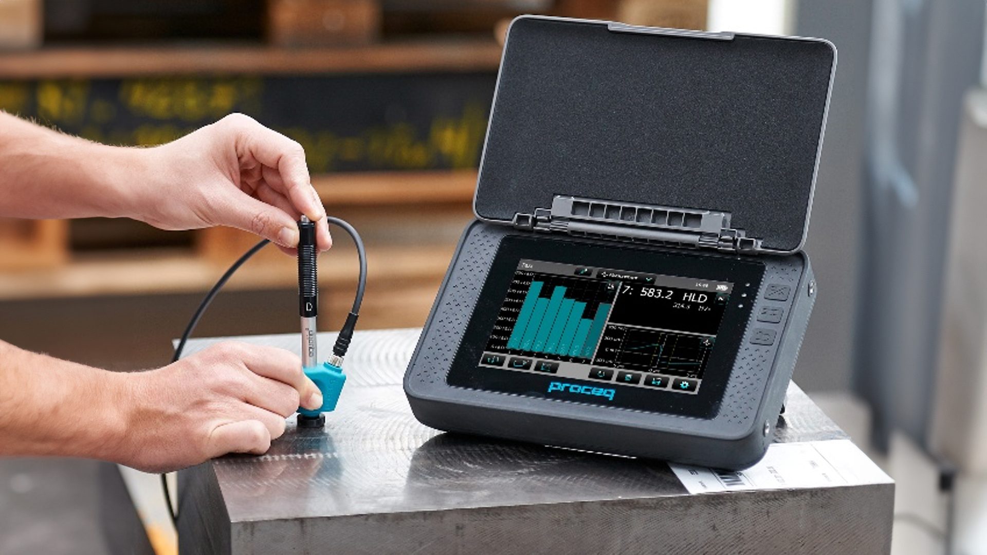

The UCI (Ultrasonic Contact Impedance) test method standardized as ASTM A1038 is a comparative hardness test method that commonly uses a Vickers indenter, but the size of the indentation is not measured optically like in traditional Vickers testing. Rather, the indentation is measured by a frequency shift of the probe tip. A UCI probe has the indenter fixed to the end of a steel rod that is excited into resonance in the ultrasonic frequency range. The test force is set by the probe, either mechanically with springs and switches or by use of a load cell, generally with a load of 1kg, 5 kg or 10 kg. The natural resonance frequency is measured by the instrument as the probe is pressed into the surface by the user until the total test force is achieved. The resonant frequency of the tip shifts as the indenter penetrates the surface. Hard materials have a smaller indentation and corresponding small frequency shift while softer materials have a larger indentation and frequency shift. The frequency shift is measured when the test force is achieved, and the hardness is then calculated from the measured frequency shift.

It is important to note that this comparative method of measuring hardness is very dependent on the elastic modulus of the specimen under test. Devices are typically calibrated by the manufacturer for a metal with elastic modulus of 210 GPa, so they must be verified for proper operation on material within 5 GPa of the manufacturer’s calibration. Then they must be adjusted for the elastic modulus of the material under test, which can be easily done on a specimen of the material that has a known hardness measured by a fixed-location hardness testing machine. The UCI test method can be used most anywhere, as long as the specimen thickness at the point of test has a minimum thickness of 2 to 3 millimeters. It is also independent of the effects of gravity at test forces of 1 kg and higher. All this means it is excellent for testing the heat affected zones of welds for proper post weld heat treatment, machined parts of all sorts, and even castings and forgings.
