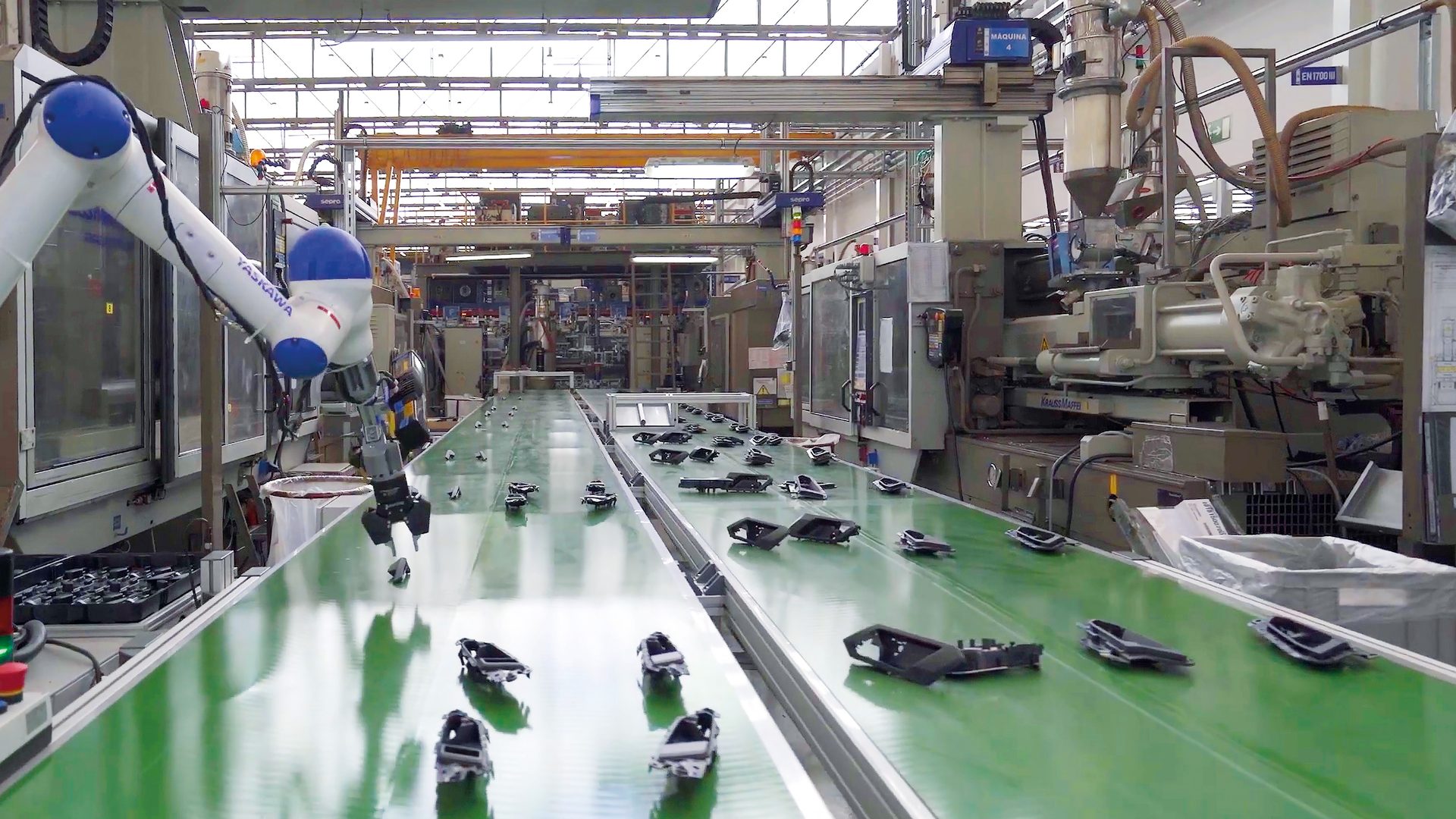

Robotic arm picking from conveyor belt

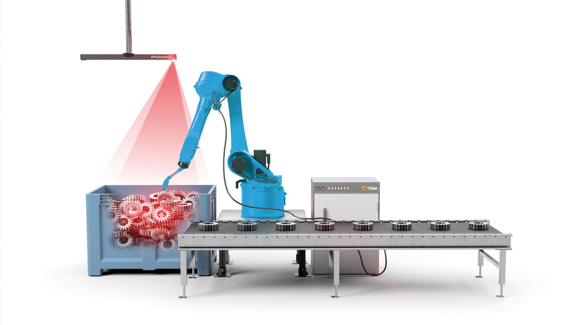

From my company’s experience, the key hurdle is the camera’s perspective. Traditional single-perspective scanning often fails to capture all necessary details, leading to missed parts and longer cycle times. To overcome this, my team developed a technology module that combines scans from multiple perspectives.
For instance, multiple static sensors can be calibrated to the primary sensor, allowing for sequential scans that cover the entire scene. A primary sensor is calibrated with the robot, while secondary sensors are aligned relative to the primary one. Each sensor captures data sequentially, creating a complete and detailed view of the object.
This approach excels at challenging localization, eliminating blind spots, reducing errors, and speeding up processes. It captures thin, C- or L-shaped metal sheets, shiny or reflective surfaces, bins with compartments, and even self-occluded objects that traditional methods struggle to handle. This way, we can assure a timely 100% rate of bin unloading, which is what automakers have been striving to achieve for many years with legacy automated or human-led bin picking. Addressing this one friction point alone will lead to significant gains in production capacity and output.
