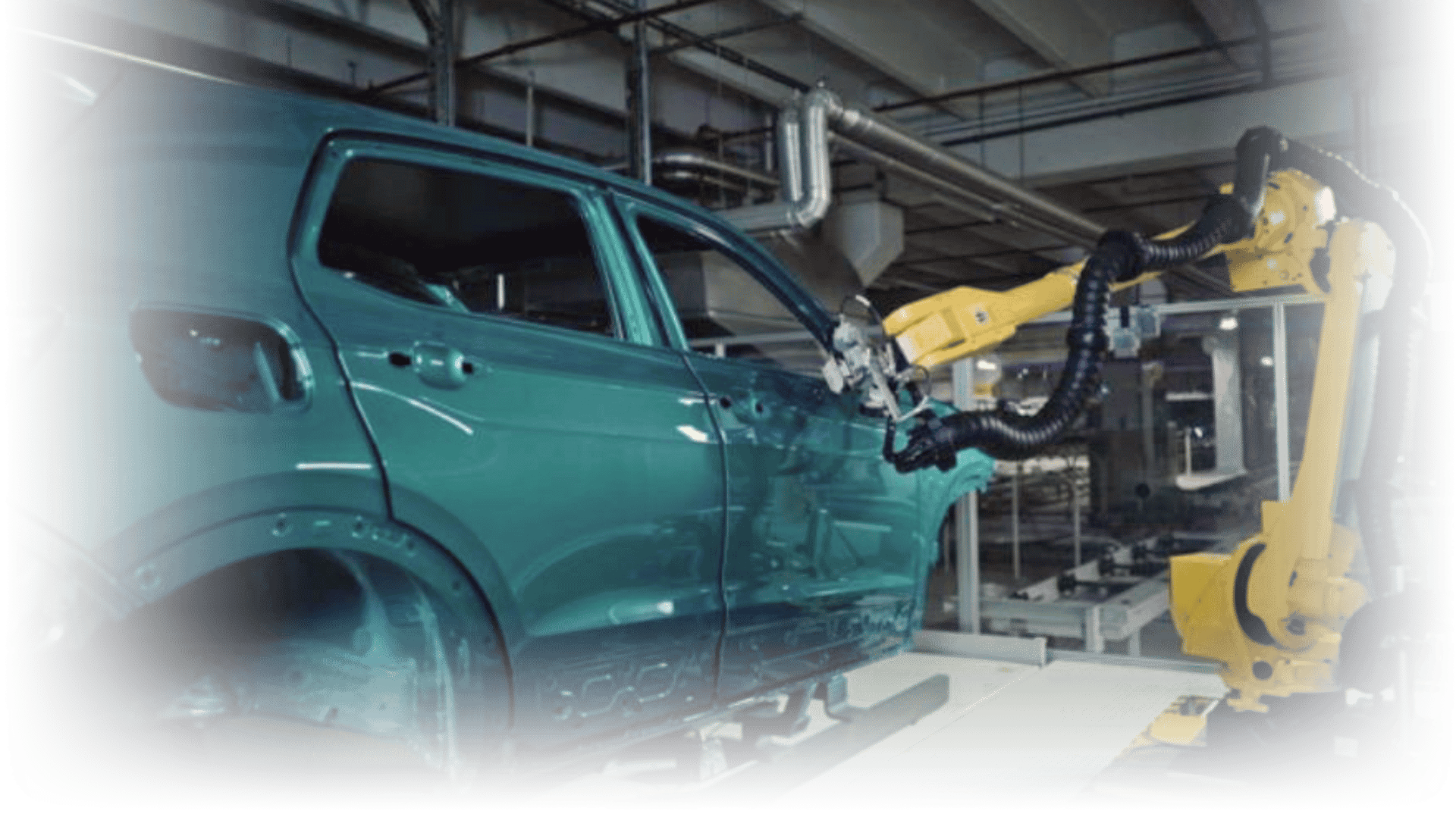

A THz sensor mounted on a robotic arm inspecting paint quality of a car on a production line
Currently, the most common application of THz is to monitor coatings and multilayer structures. By Mira Naftaly

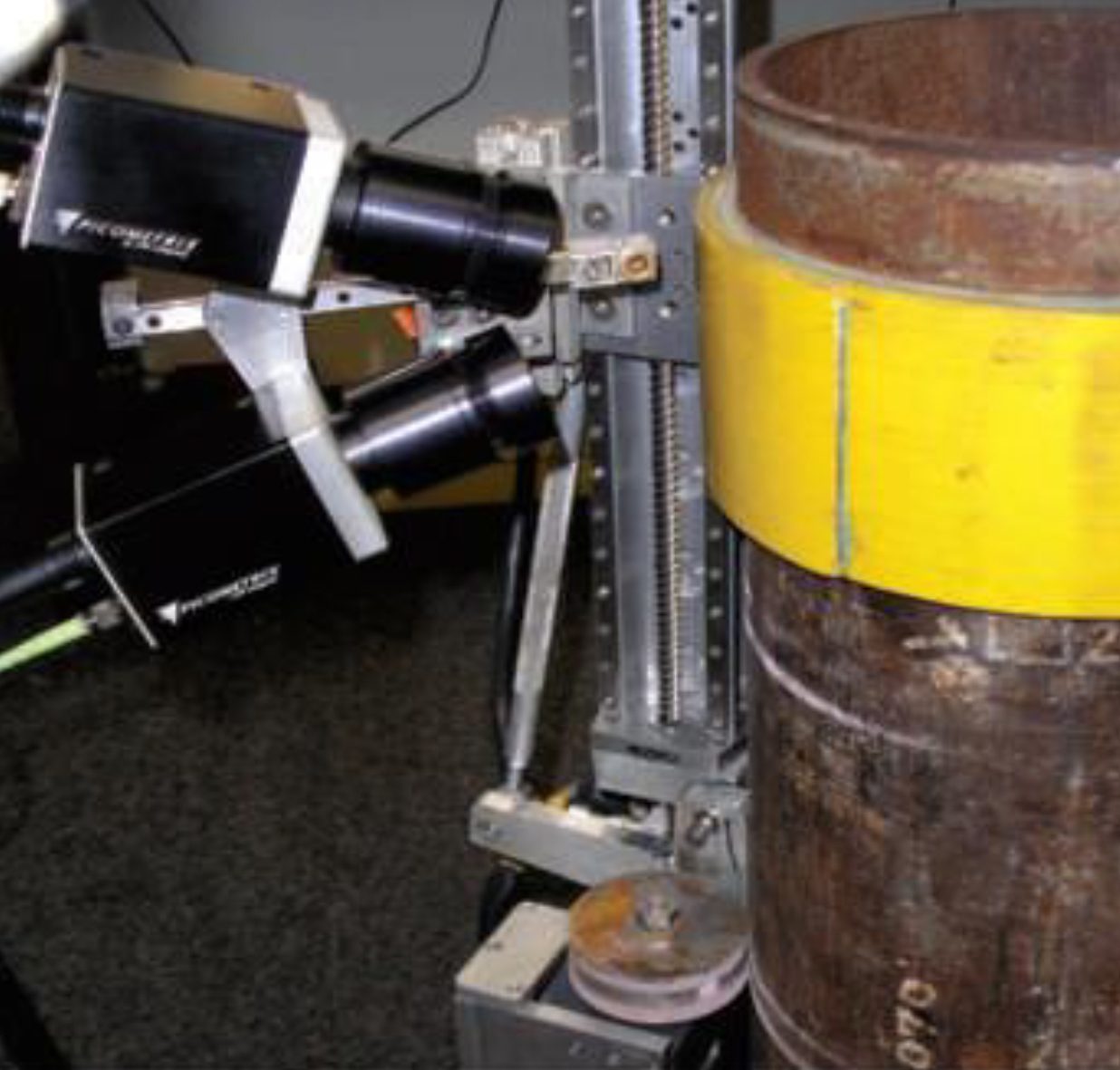

A rail-mounted THz scanner checking pipe integrity, quality of insulation and the presence of corrosion under insulation

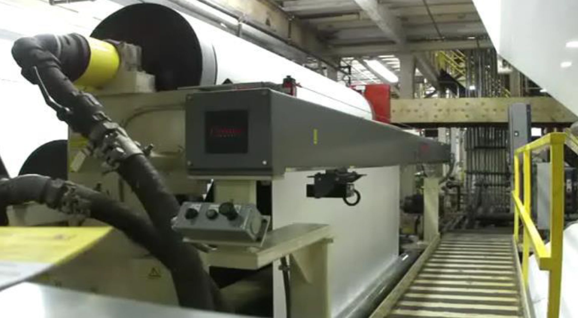

A rail-mounted THz sensor inspecting the quality of polymer sheet on a roll-to-roll machine
Currently, the most common application of THz is to monitor coatings and multilayer structures, where it can reveal uniformity of multiple layers and layer thickness, layer adhesion, delamination or debonds, corrosion or damage under coatings and water ingress into or under coatings. THz systems have been installed on many automotive production lines to monitor the quality of paint, for example. Recently, THz has been deployed in electric battery production to monitor the uniformity and quality of electrode structures.
THz can be used to examine a wide variety of materials, such as polymers, adhesives, chemicals, food or pharmaceuticals. Because it reveals material properties, THz can detect density, crystallinity or polymerization, curing effects, compositional variations, additive content and porosity. By tracking variations in properties, it can reveal degradation, wear and moisture content. By mapping internal reflections off interfaces, THz can image defects, cracks, inclusions and air bubbles.

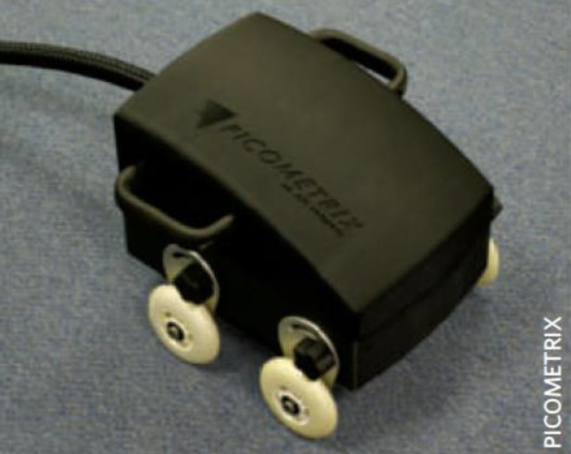

Mobile THz radome scanner

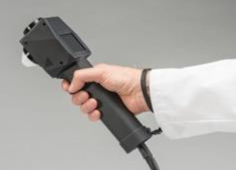

Hand-held THz sensor for industrial inspection
